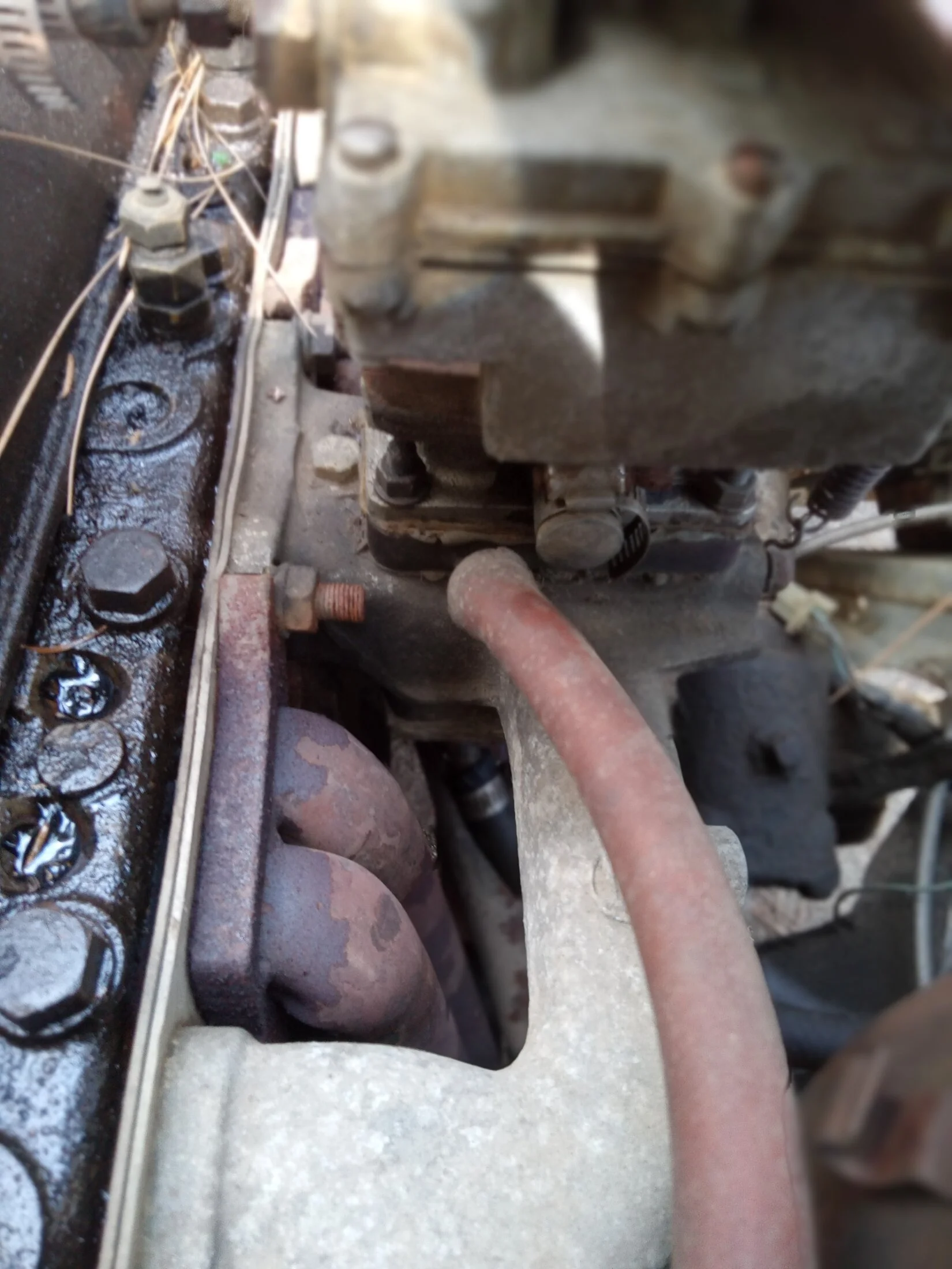

Final 2F build
This was more or less my inspiration for the design
I think I used 1/4 flat aluminium flat plate and 1/2" brass fittings 90 from home despot. I got the metric bolts from them too, I cut the gasket from a sheet of heavy gasket paper from NAPA. This was done in about 1991.

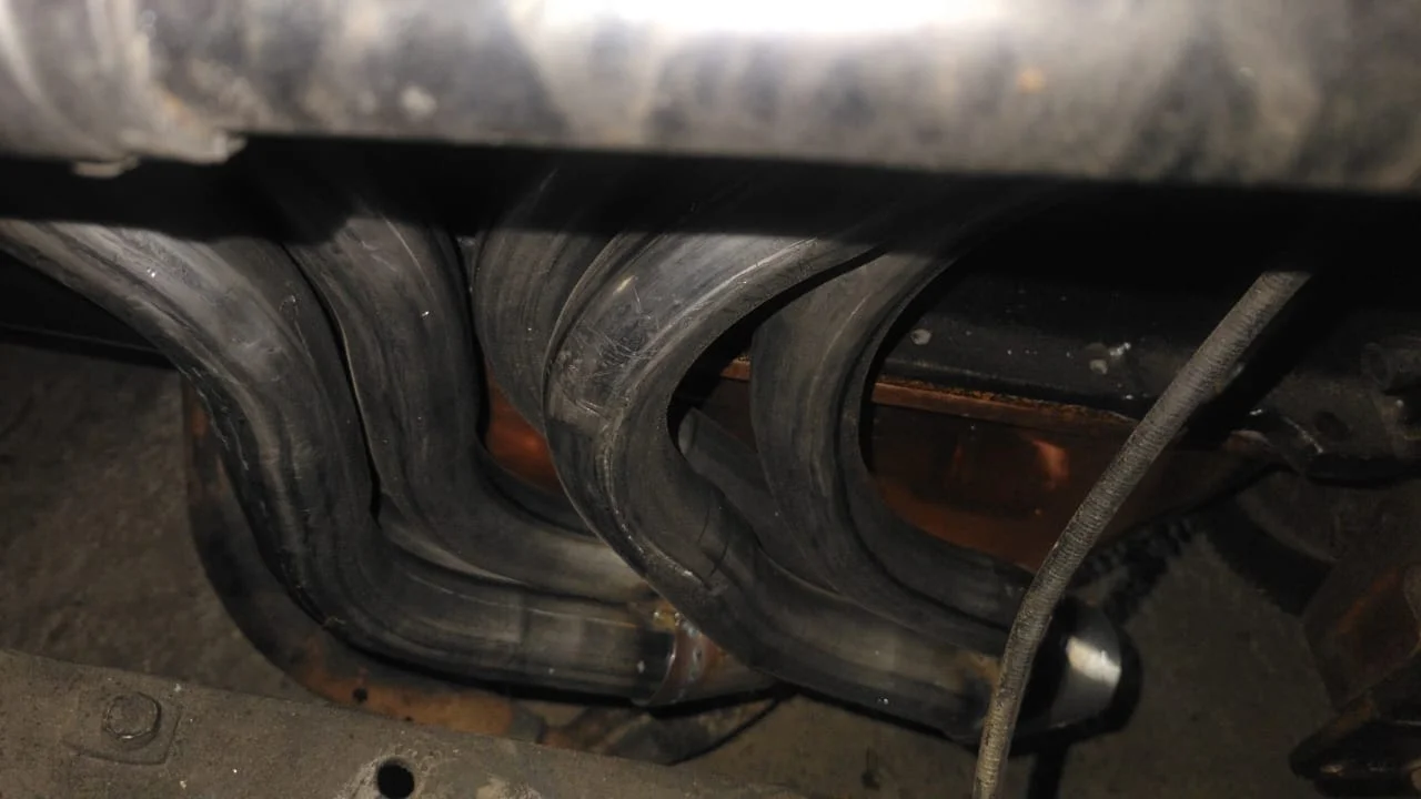

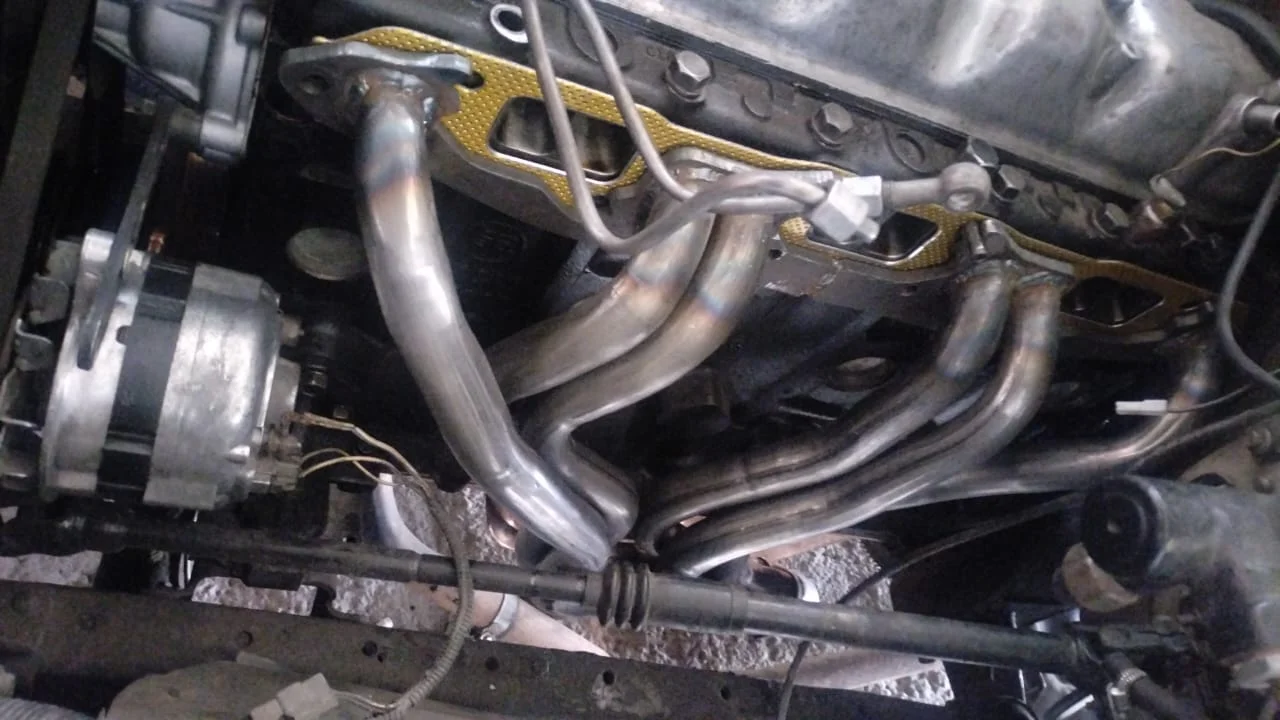

If you think you might need carburator heat turn it because if you wait too long it might not work. When I move to the hill I would ice the carb on the long grade to town in the winter. I built a fluid heat riser for the intake due to running a header. Problem solved - I can't recall icing up since.
You mean de ice? Average temp here's sbout 68 so not too worried. The other way, that stainless header's going to get hot...

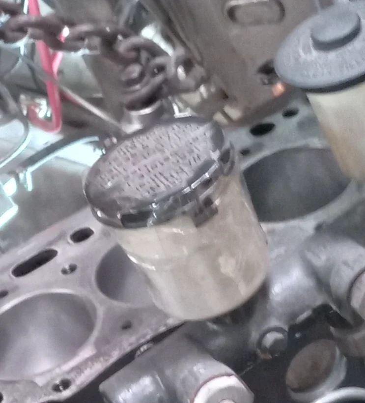

My mechanic, so thoughtful: "Here, I'll just relieve you of your master cylinder cap and tape my old one down, ok? Thanks in advance."
