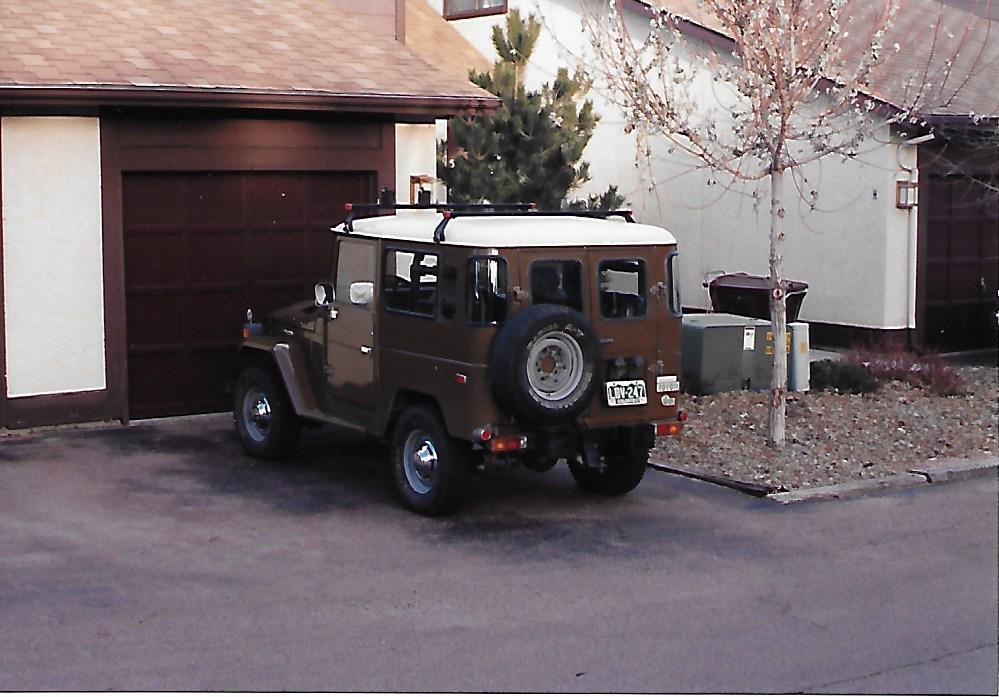

I bought my '78 FJ40 in Aug. of '90 when it was a mere 12 years old. Paid $3500 and it had 78K miles and was a Texas truck with several owners, now in Colorado. On the offroad test drive, it growled through a bunch of nasty ditches and seemed unstoppable, and I scratched the paint on the test drive. I was smitten. It looked ok, but was sandblasted and rusty in various small spots. The rear sill had already been replaced with a 2x2 steel tube. Patina wasn't a thing back then.

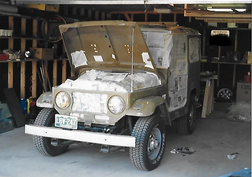

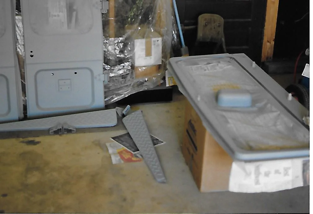

In 1991, I painted it myself in my garage, after reading many library books on 'how to paint your car'. I spent $400 on a DeVilbiss JGA paint gun, Kondar primer/surfacer, and Dupont single stage paint, mixed a few shades off by a paint shop that didn't try very hard. I recall spending 80+ hours of time prepping and painting, and it looked great - one tiny run, no fisheyes, decent gloss, etc. I had touched up a few cars before that, but the result was luck over smarts. My sanding and chip filling was pretty awful, and my bondo was lumpy in spots.

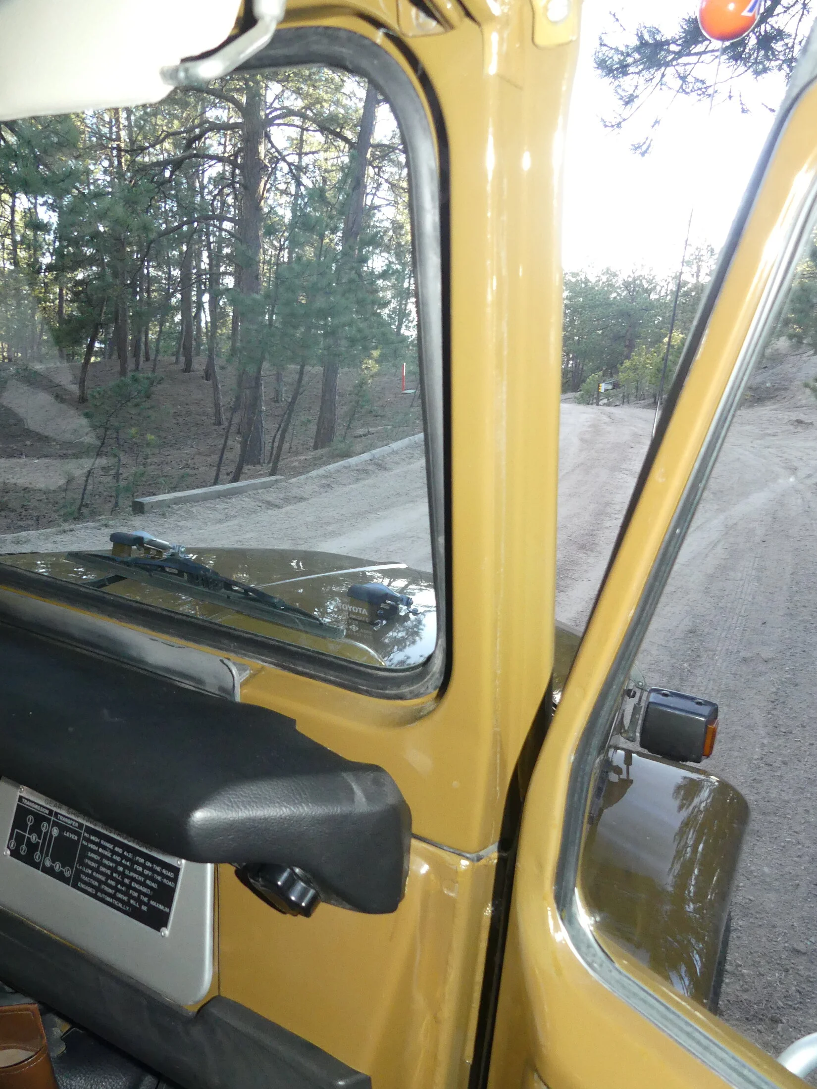

First photo is 'as purchased'. The rest show the paint job in my garage (Iikely violating neighborhood covenants). There were no bezel police back then (or Internet), so the bezel is indeed upside down.

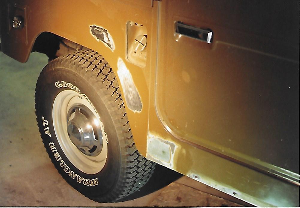

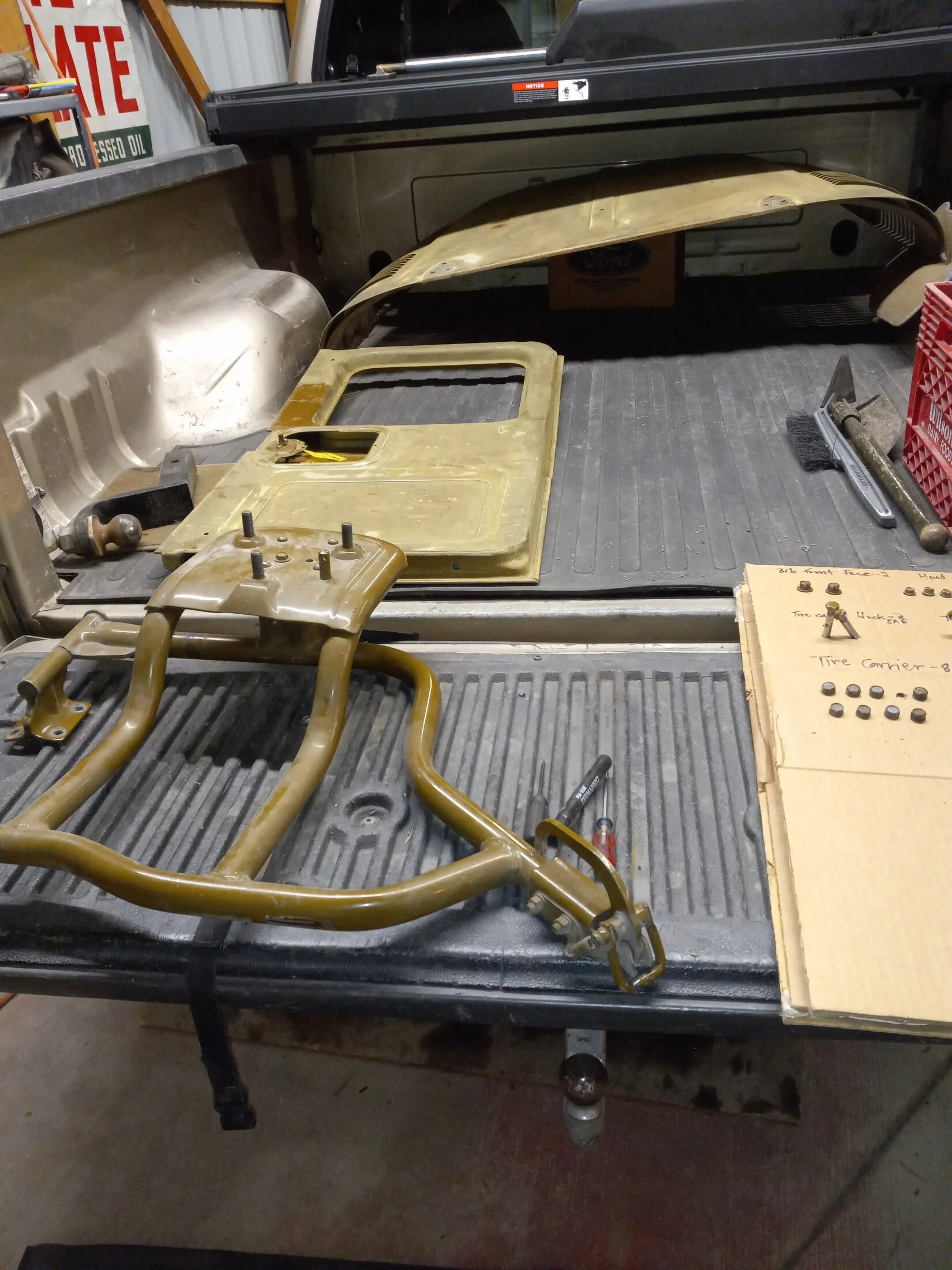

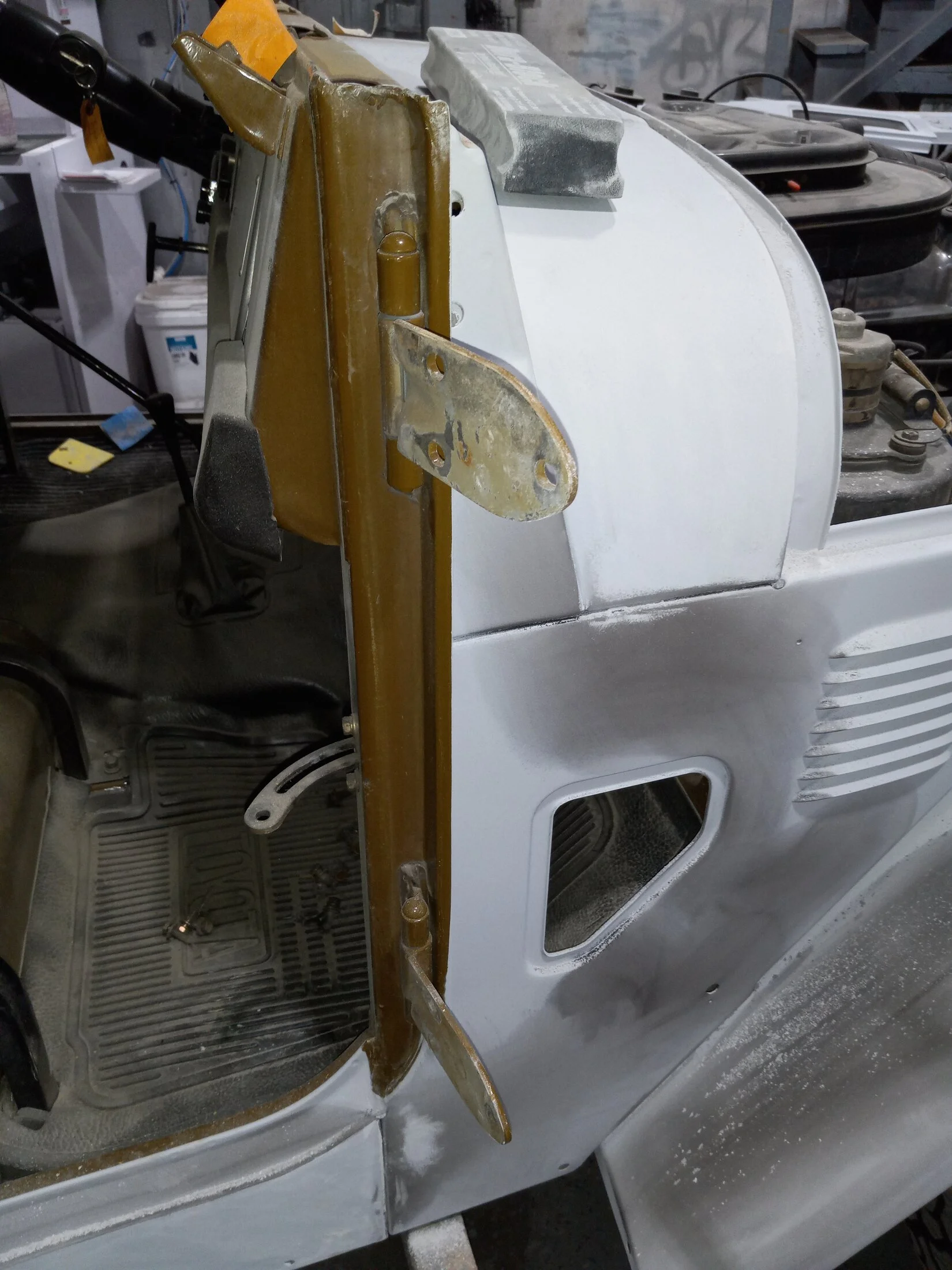

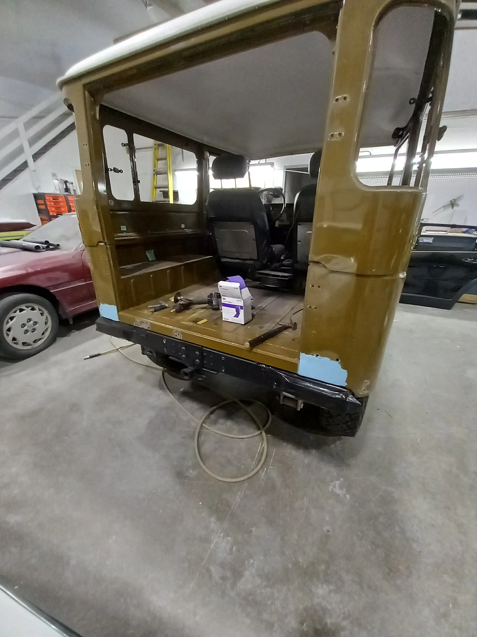

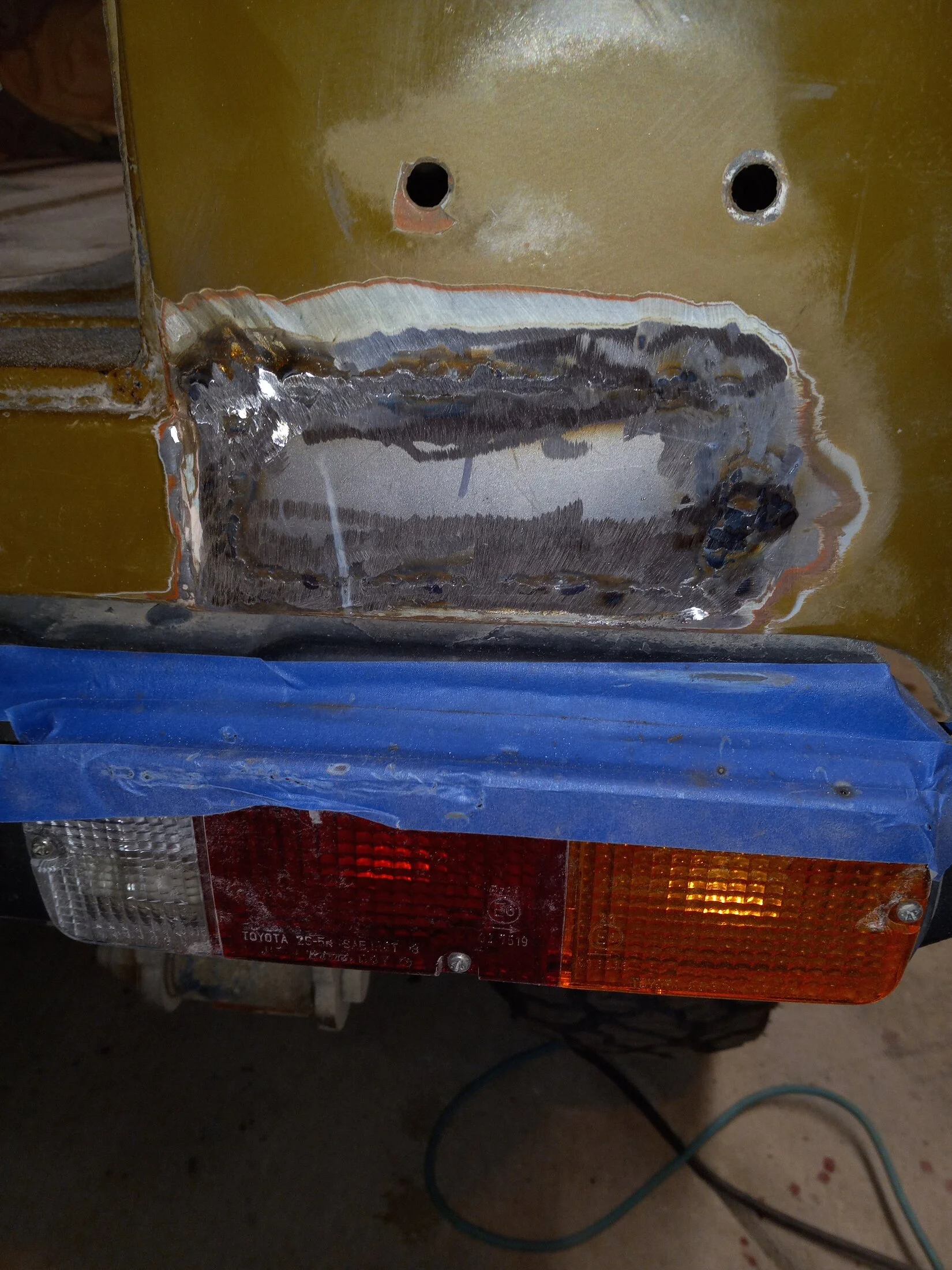

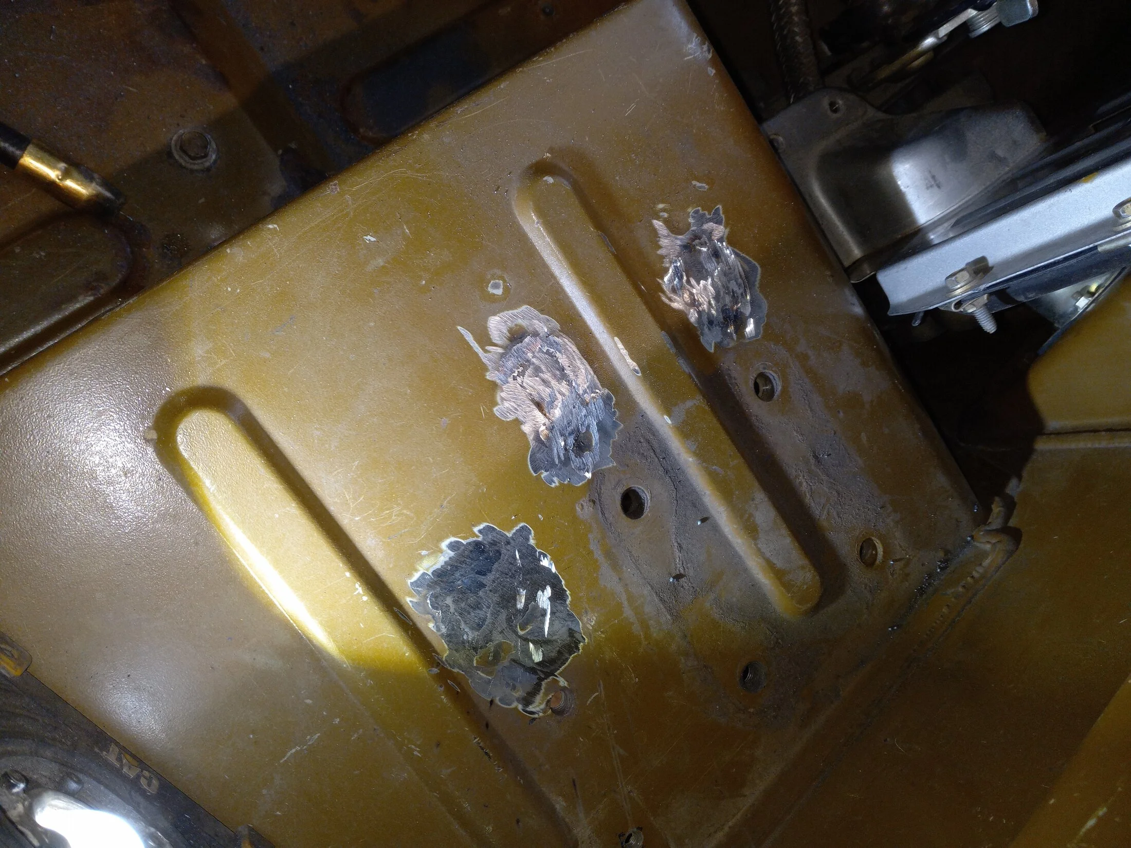

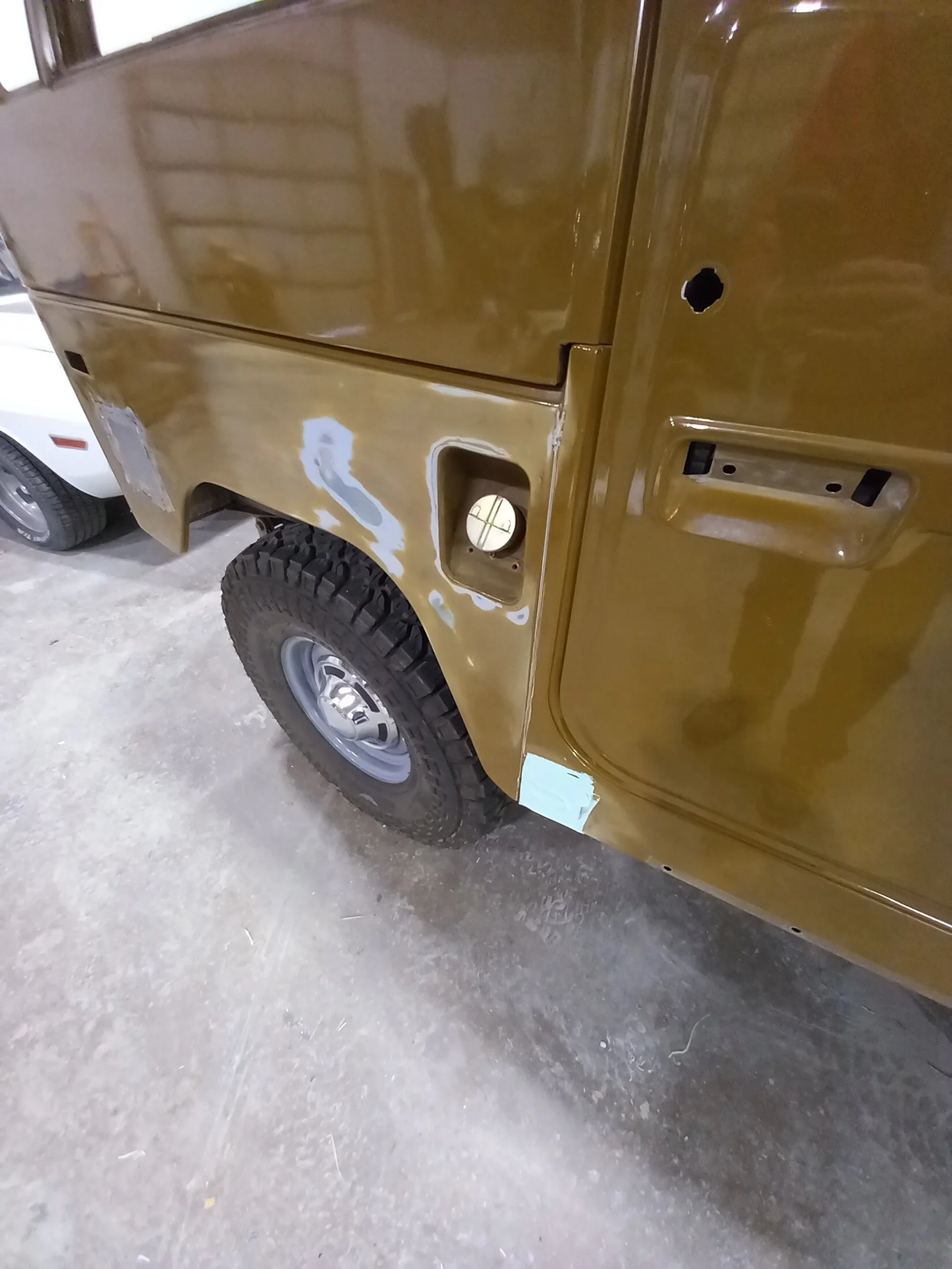

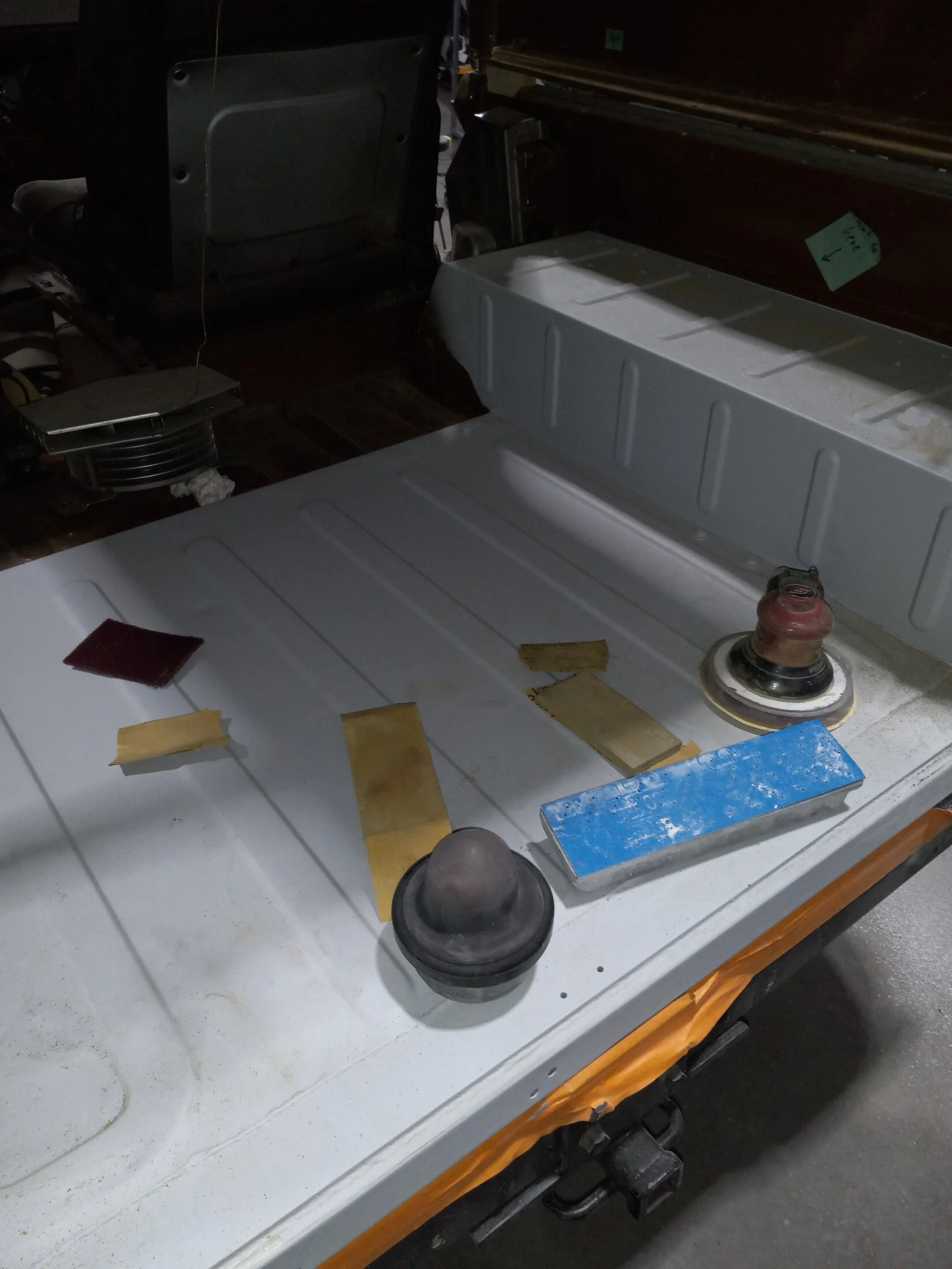

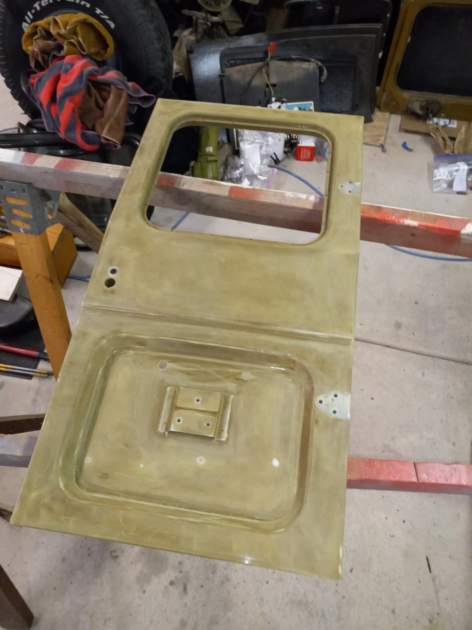

So, in Oct. '24, I spent ~40 hours disassembling the truck (as I did in 1991). I sanded many panels removed all the doors, hood, glass, trim, etc. I welded new metal in all the rust holes, I gutted the ambulance doors and cargo area, as I wanted the rear floor and inner fenders painted. Here are some prep photos.
I removed the ConFerr aux gas tank and welded a plate over the gas filler hole in the fender. I horribly warped the rear fender, so the body guy cut my patch, flattened it, and rewelded it - I paid him extra. I had a perfect 1976 hood in my barn, and prepped and sanded that. All hinges, bolts, etc. removed, sanded, labeled, etc.

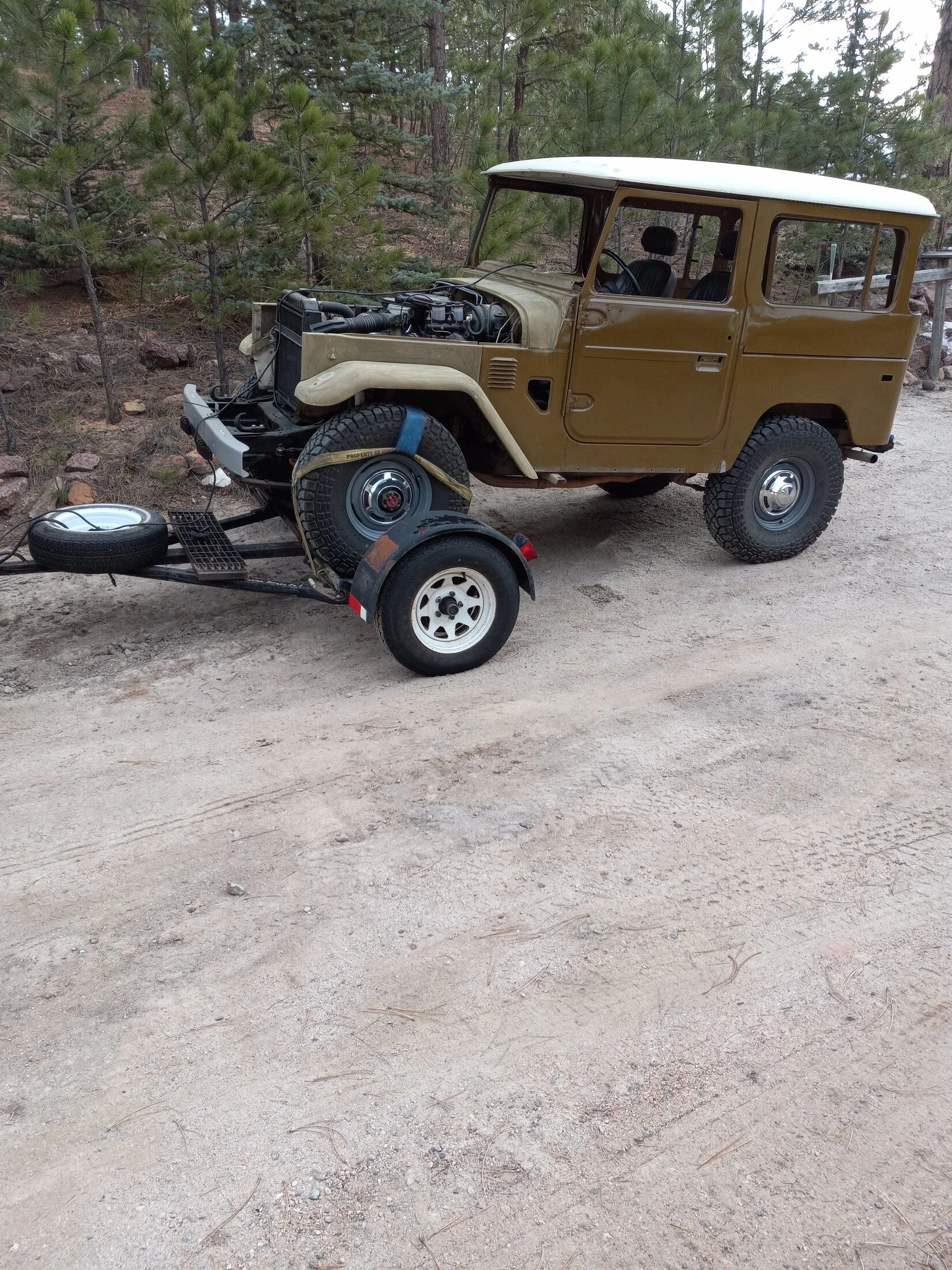

I dolly-towed the truck to the shop in mid November, 2024. By December 11, they had made, well, very little progress. By December 20, a little more. Then, of course, the holidays. Then the painter got COVID, then he had a week of jury duty, then he got hit in the face with a front strut that plummeted from a Jeep Cherokee on the lift.... so the '2 to 4' week paint job was naturally extending into months.

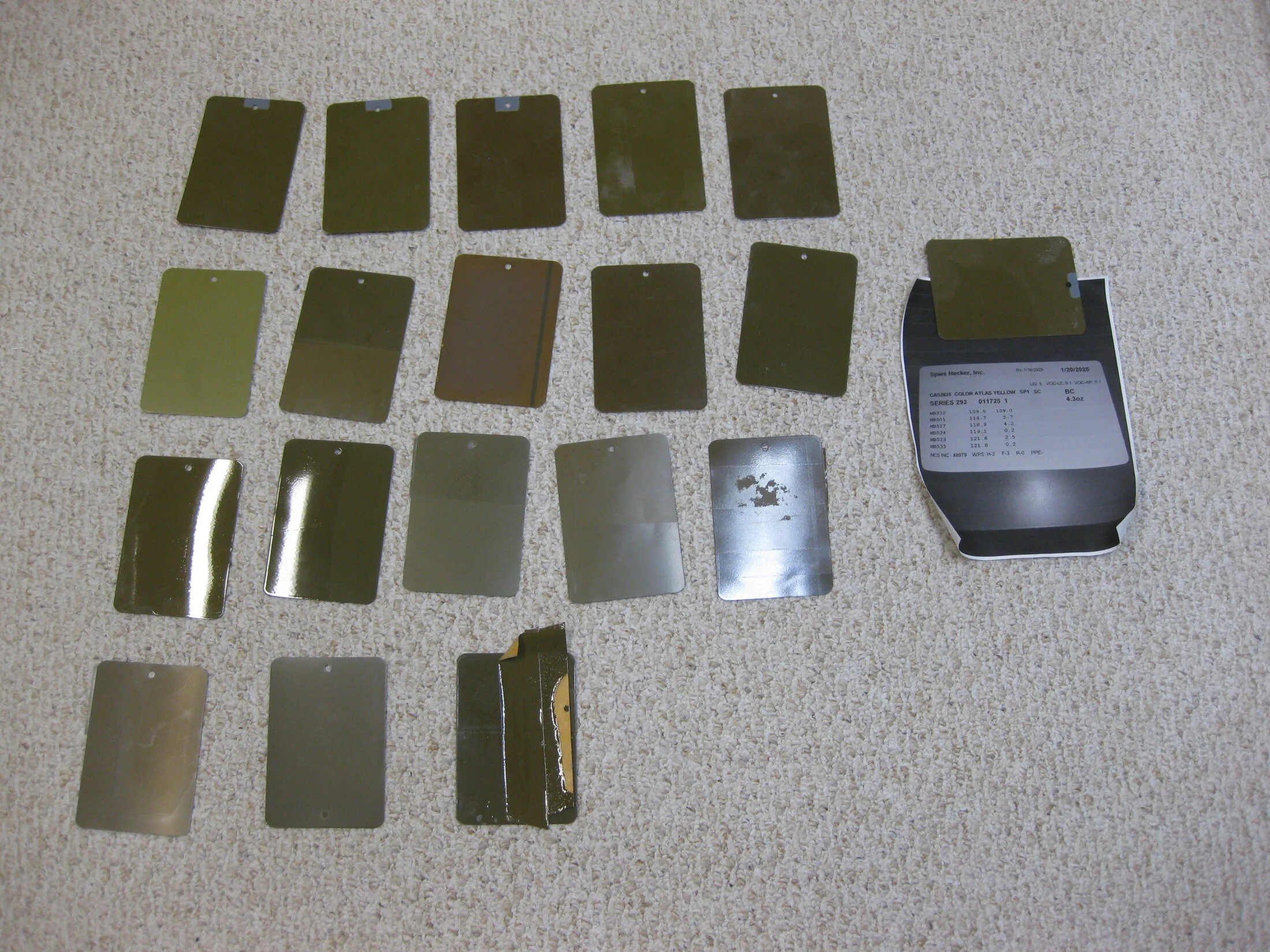

Now enter the month of 'paint matching hell'. My painter guy was a perfectionist on color match. My home-brew 1991 job was 2 shades off, at least. He uses Axalta (Spies Hecker base-clear system) and the factory 'formula' for 653 Olive came out exactly the same wrong shade that it did in 1991. So, he got out his color matching camera and started matching.
After 2 weeks of trying, he put the corporate folks onto the matching and they spent a week and didn't get much closer. After another week, we had a perfect match - in sunlight. Under different lighting (indoor, LED), it looks a little different.
The painter explained that without metallic flake or pearlescent pigments, there is nothing to fool the eye, so this solid Olive color was just difficult to match. See all the metal sprayout cards? The rightmost one (on the paper) was the winner. I'm very happy with the color match, but this added a month to the job.

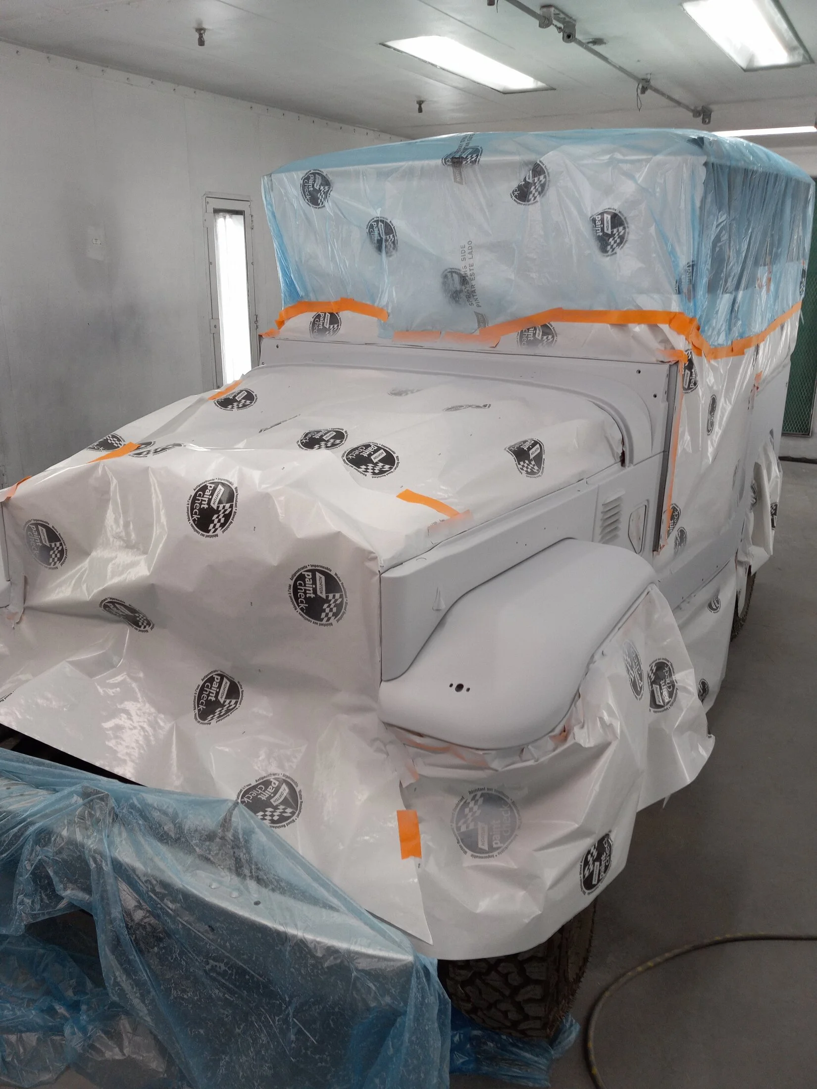

So, to bring this paint saga to a close, in Feb. of '25, they were nearly done with the body and could start spraying. They told me they couldn't bear to paint the shabby inside rear floor without more prep, so they prepped it nicely. I asked for no seam sealer on the side seams, since it always cracks, and they honored that.

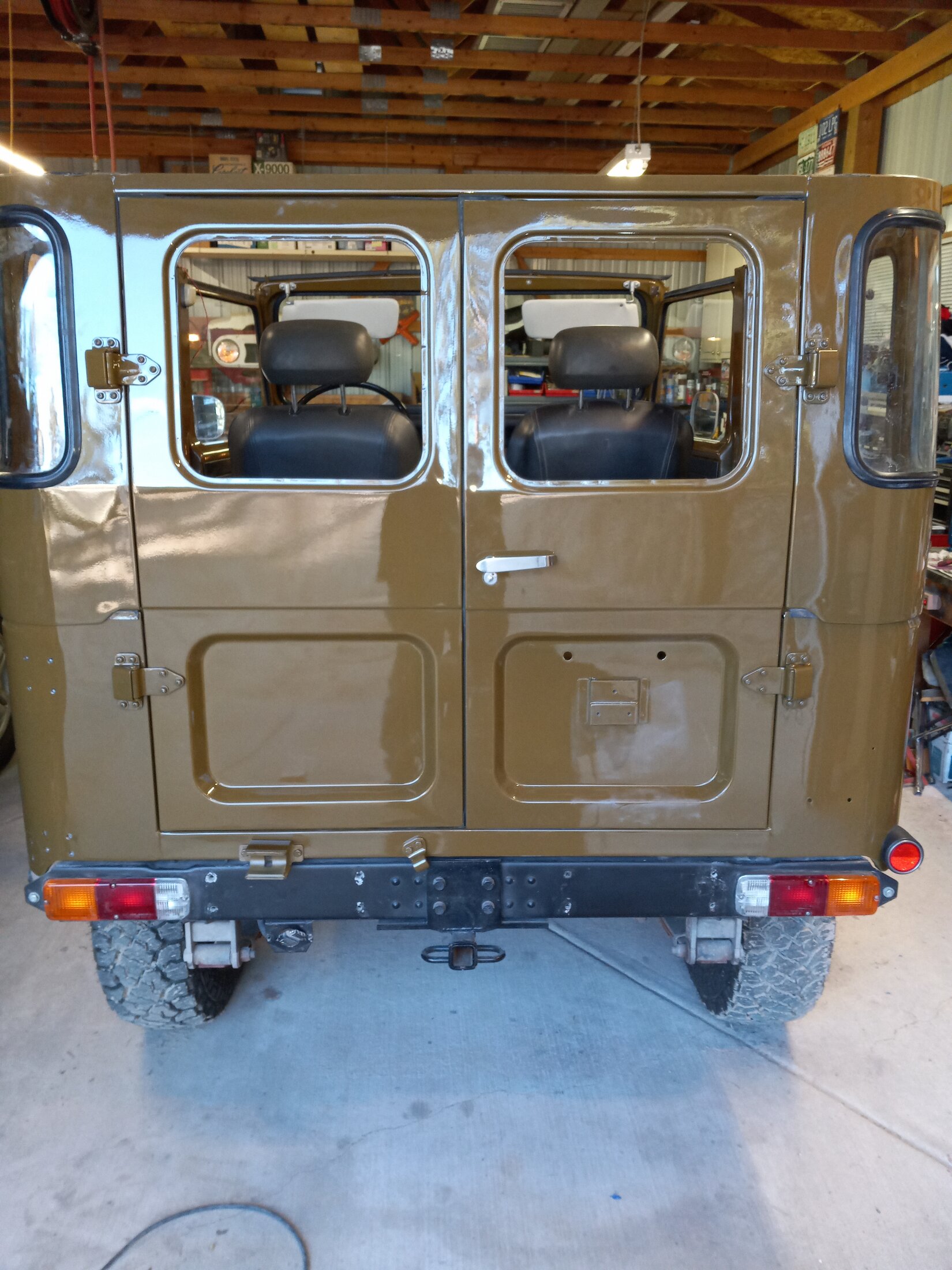

So, in Mid-March, dolly towed the gleaming truck back home, instructed them to repaint some hinges and hood hooks that needed more paint, and brought home the doors, bib, hood, tire carrier, bolts, hinges, and all the other futzley pieces.

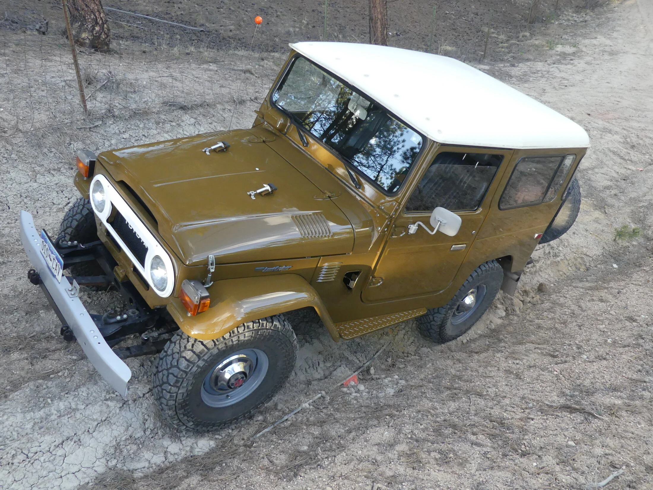

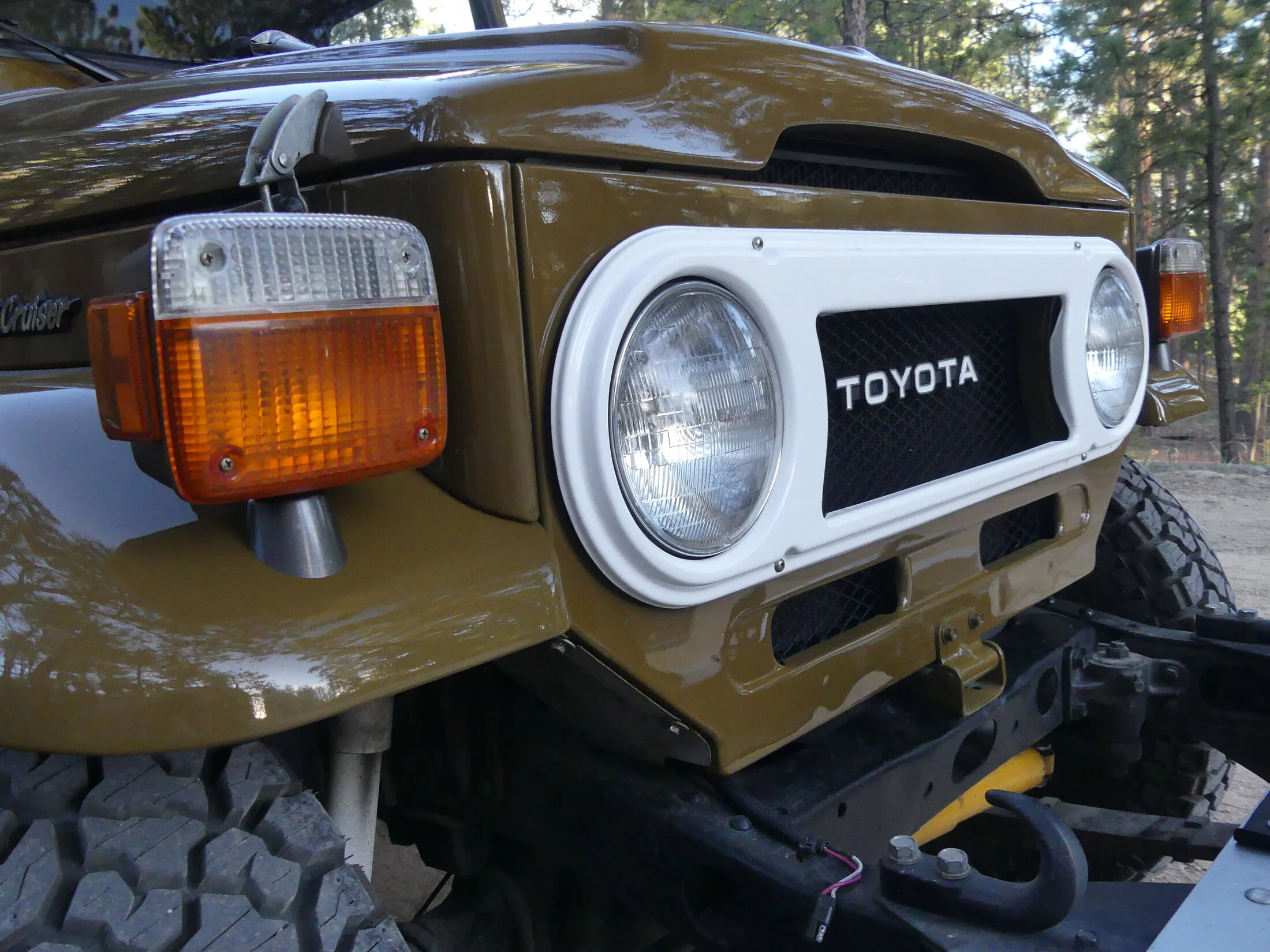

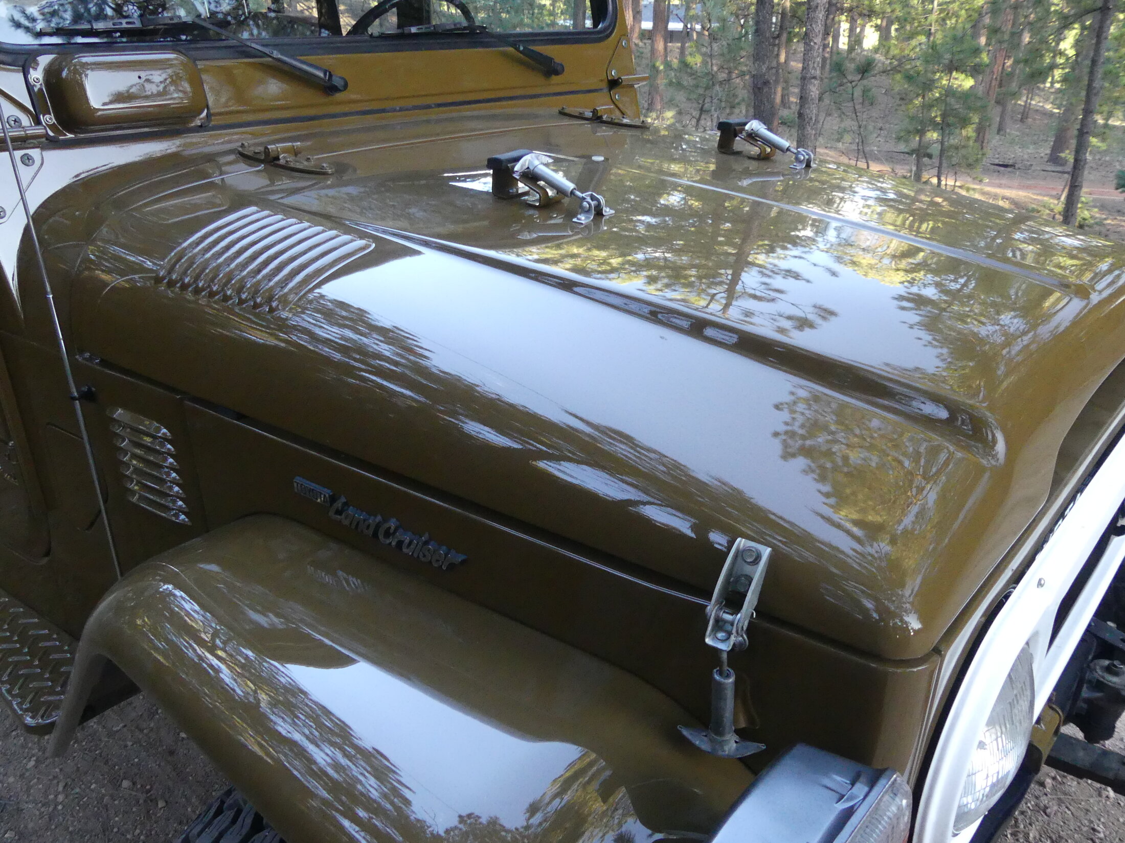

The result is that the truck has a nice glow about it, and they left a little orange peel and as many OEM spot-welds as they could. The last photo shows the windshield frame (repainted) versus the non-repainted dashboard and door. Pretty much a perfect match.
The final paint shop bill was $7K (I had told them 6K +/- $1K) and they earned it. Took 4 months and many trips to the body shop for consulting, but they were easy to work with and we had more laughs than scowls. They pointed out that they had two, $500 cans of a base color product into this shoot, along with the clear coat, primer, and other materials.

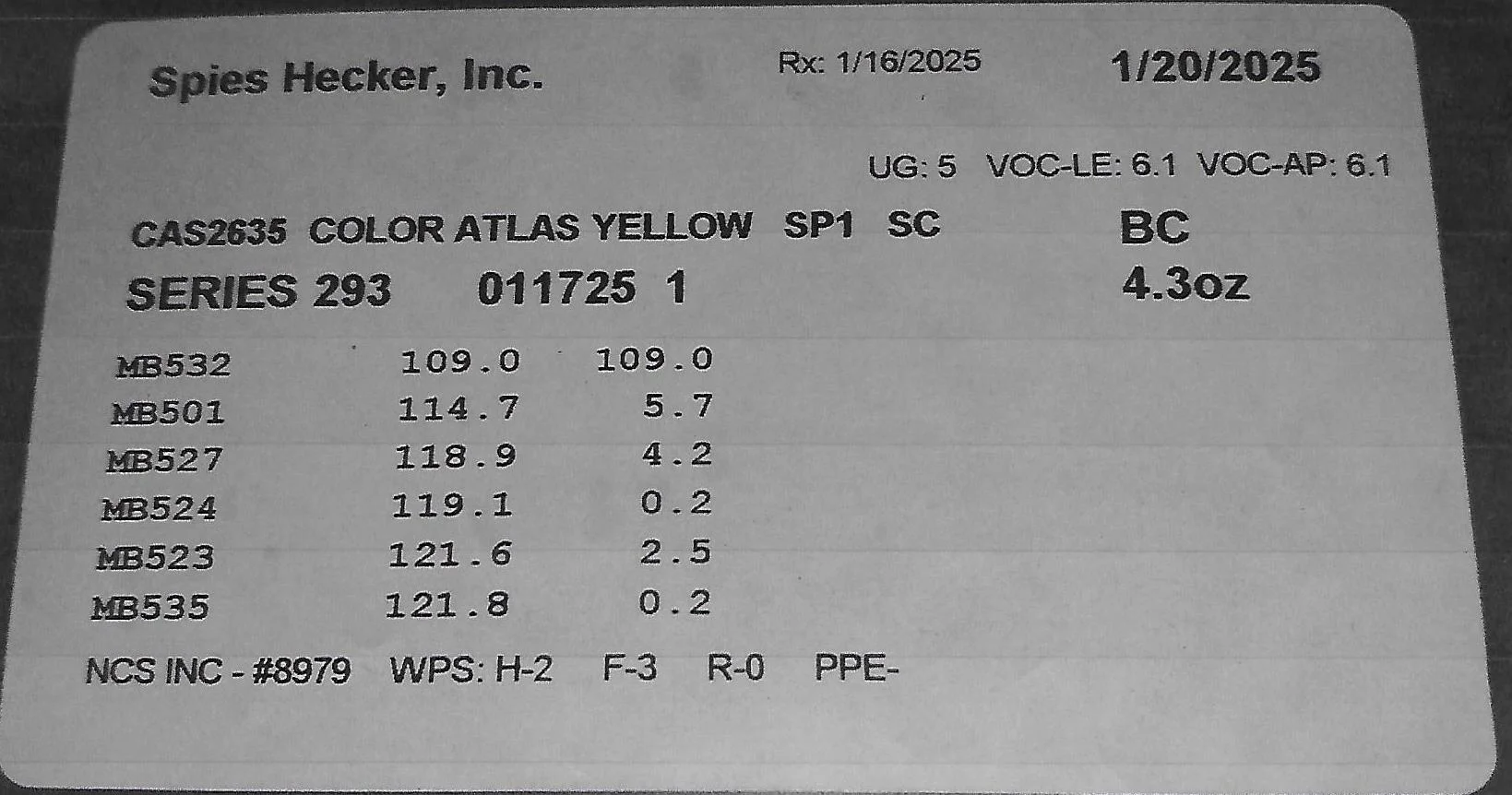

any chance you have a clearer image of that paint card/formula?

Attached is a scan of the paint mix for Spies Hecker (Axalta) base coat. The quantities shown are for a 4 oz. sample, and can be scaled up for a larger quantity of paint. The actual color may vary depending on the tint of the base coat, and the painter determined that 4x coats of base were needed to get the proper color.
