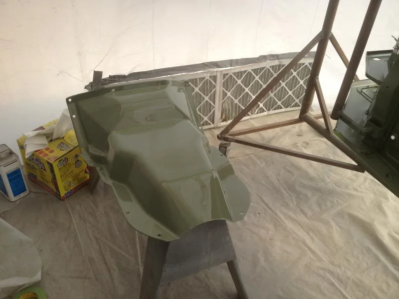

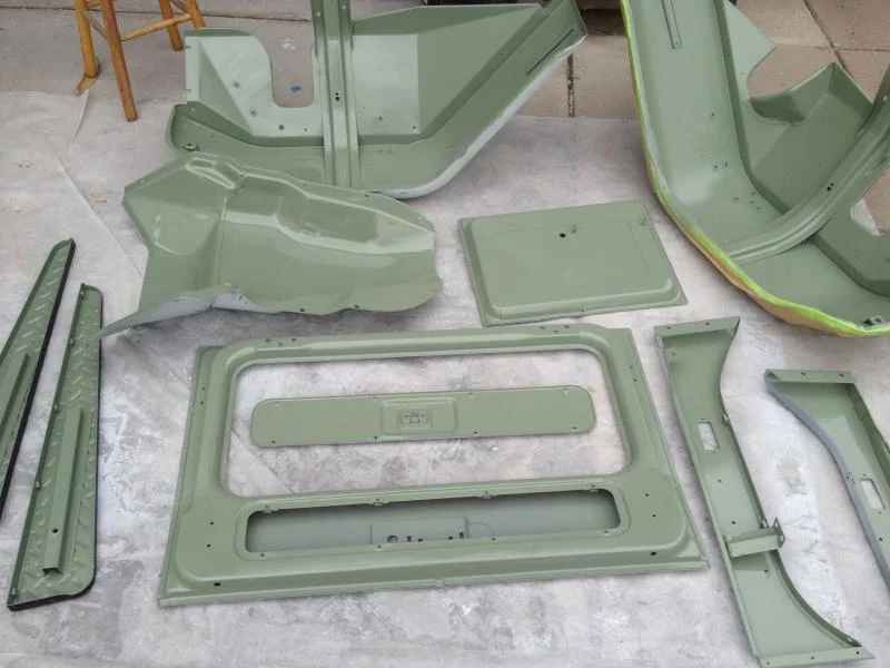

Ready for yet another round of block sanding. I made a smaller version of my plastic paint booth using a 10x10 easy-up for when I need to shoot smaller individual parts. It goes up and tears down much faster than the big one.

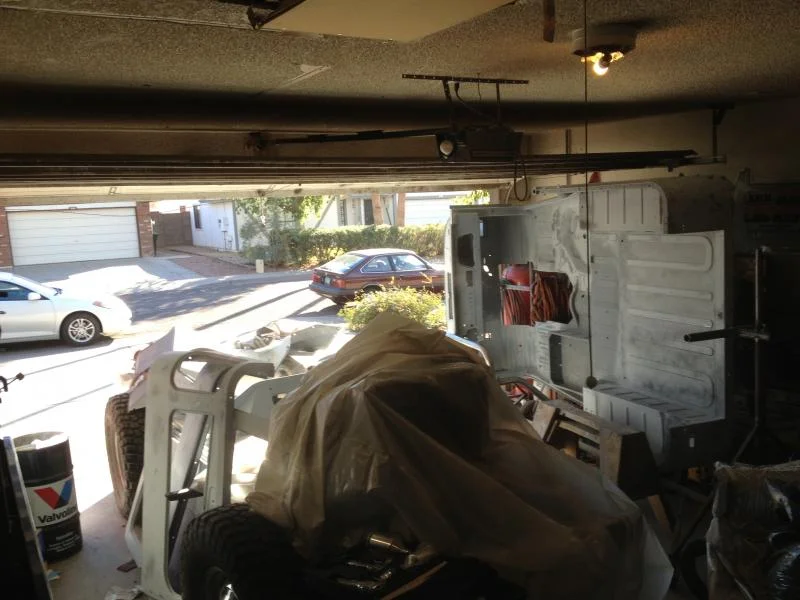

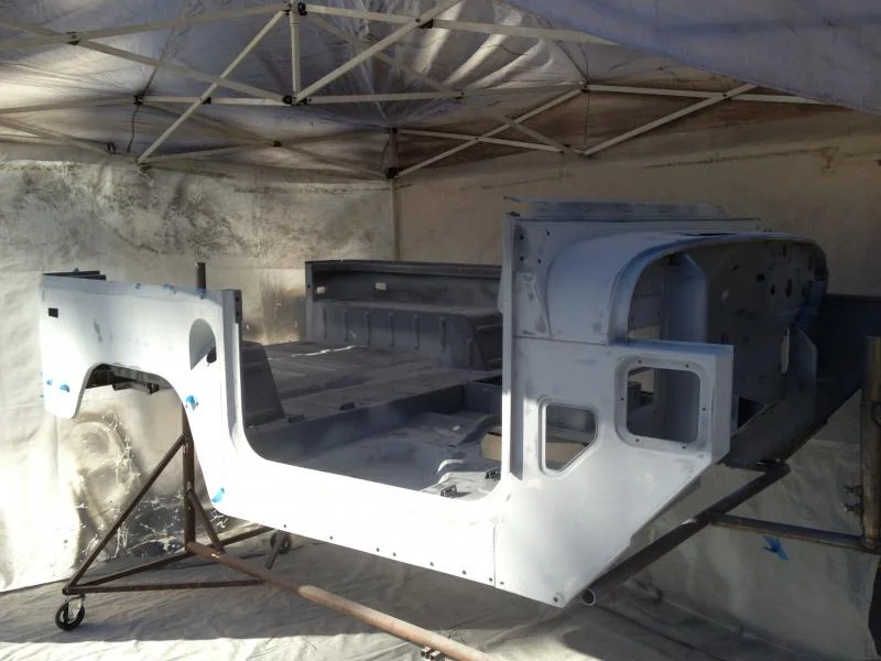

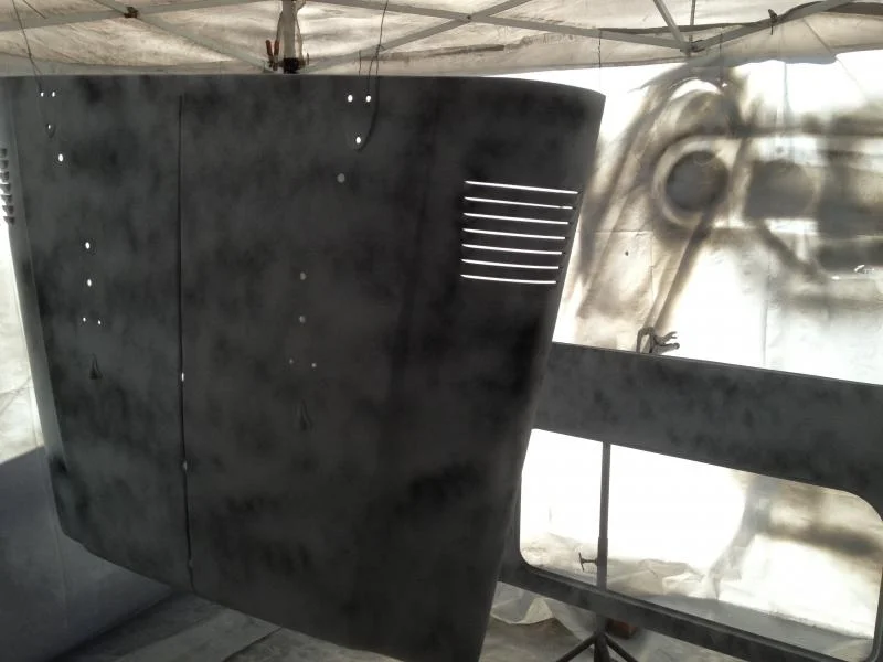

I haven't posted an update in a while, mainly because I have just been doing body work and the amount of time I have had to work on it has been limited to weekends lately. The rotisserie has worked out great, I cannot imagine working without it. You can position the body exactly how you want it to work the most comfortably, especially on the interior and inside the wheel wells. It also helps with storage, as space is limited in a two car garage when it is full of body parts being worked on. I have several pieces ready for paint, and I think I am getting down to the last coat of high build primer on most everything else.

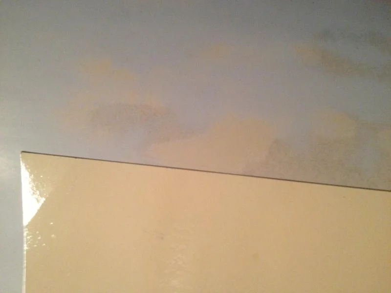

Finally! It is ready to paint. I chose Fashion Green for the body and Shell Ivory for the roof and headlight bezel. A friend of mine, a body shop manager and painter extraordinaire, has volunteered to help me shoot it this coming weekend. I did some spray-outs yesterday. At first the Shell Ivory looks really tan, like it has too much red, but out under a blue sky it lightens up quite a bit and I think it will look almost white up on the roof.

From all of the research I have done, I believe these are original colors. Although mine came Capri Blue originally, Fashion Green was available from 1968 to 1971. Since 1970 models did not have a color code stamped anywhere on them, the fact that it is in not the color it left the factory in doesn't bother me.
The chart attached below is shows that the proper roof color is Shell Ivory. My sprayout of that color matches my original roof color well. Like many, mine had been repainted, but I found the original color when I was repairing it.

The paint is PPG Deltron Concept (DCC) Single stage acrylic urethane. I got samples from the paint store and shot the paint onto card stock made for that purpose.
