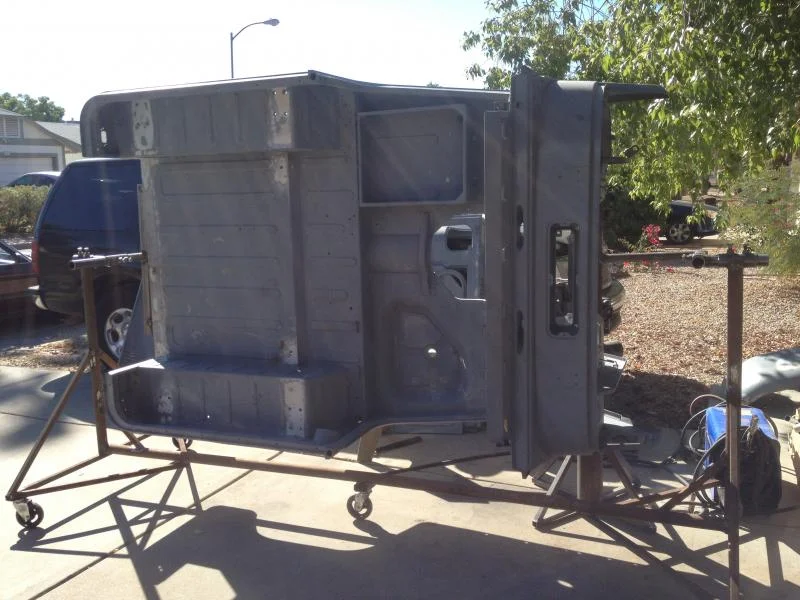

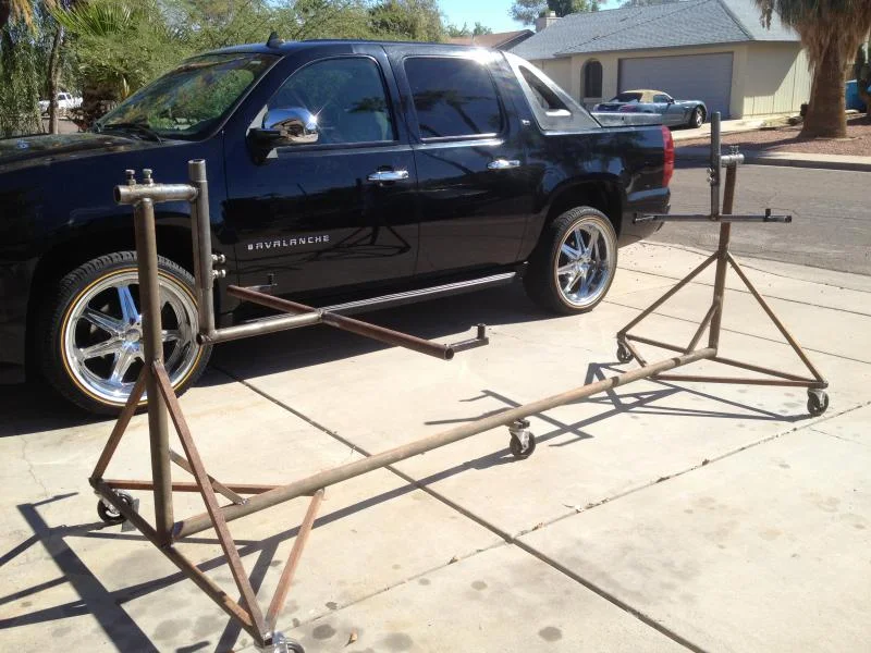

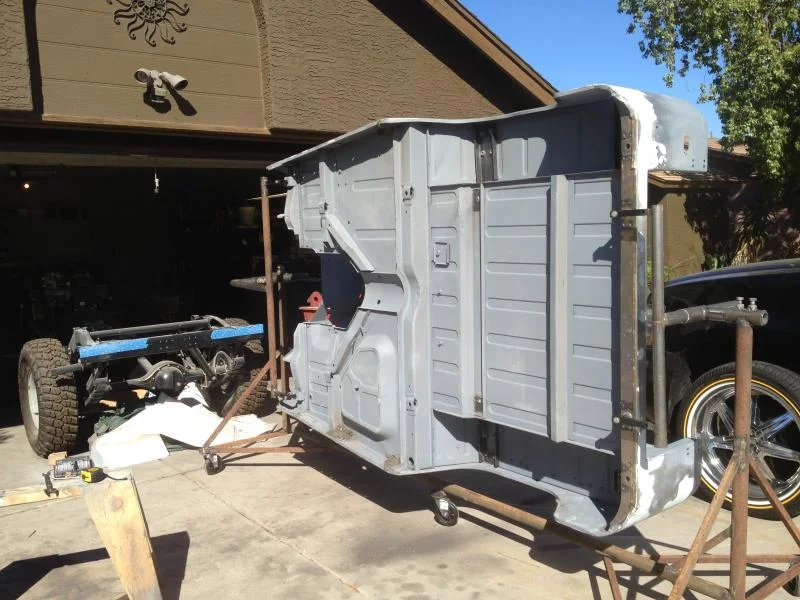

I needed a break from sanding, so today's project was a rotisserie for the tub. I used some old rusty tubing that I had laying alongside the house and some steel from my scrap bin. I am in to it for about 40 bucks for the casters from Harbor Freight. I guessed pretty close on the C/G as you can rotate the tub 360* one handed.
Very nice! Nothing beats easy access.
