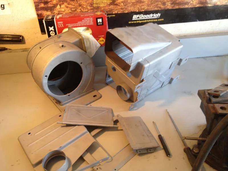

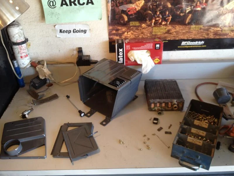

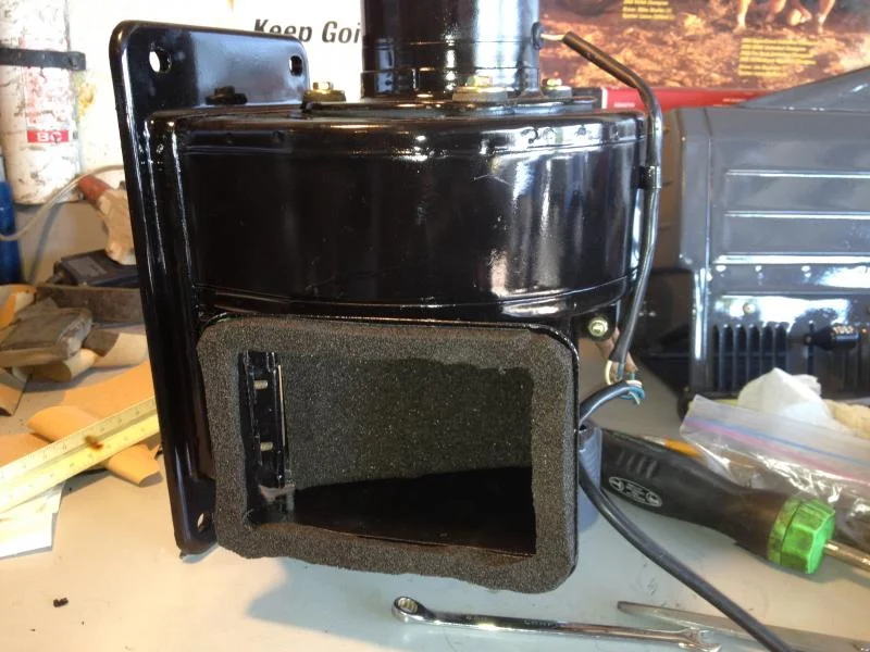

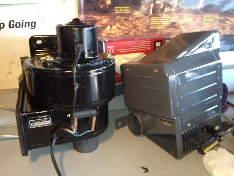

I got the heater put together. After soaking the heater core in CLR, bead blasting and painting everything, I cut foam seals from leftover OEM Toyota stuff I had collected from work. Before bead blasting I had removed the original decals and then reattached when I was done.

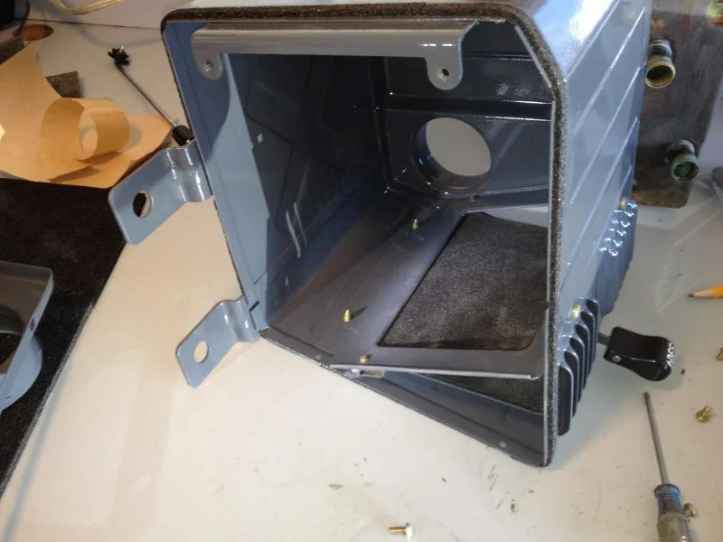

On the recirculation door in the fan housing, I cut the foam about 1/4" too big on three sides (excluding the hinge side). I put the foam on both sides of the door, allowing them to stick together back to back around the edge. This looks like it will seal the door much better.
:clap:
I didn't see where you said what color you used for the gray... Just rustolium?
Yes, it is Rustolium charcoal grey. I had considered getting the color custom mixed, as the original grey color seemed kinda odd, but the Rustolium is pretty close, just a shade lighter.

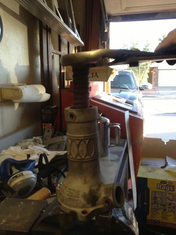

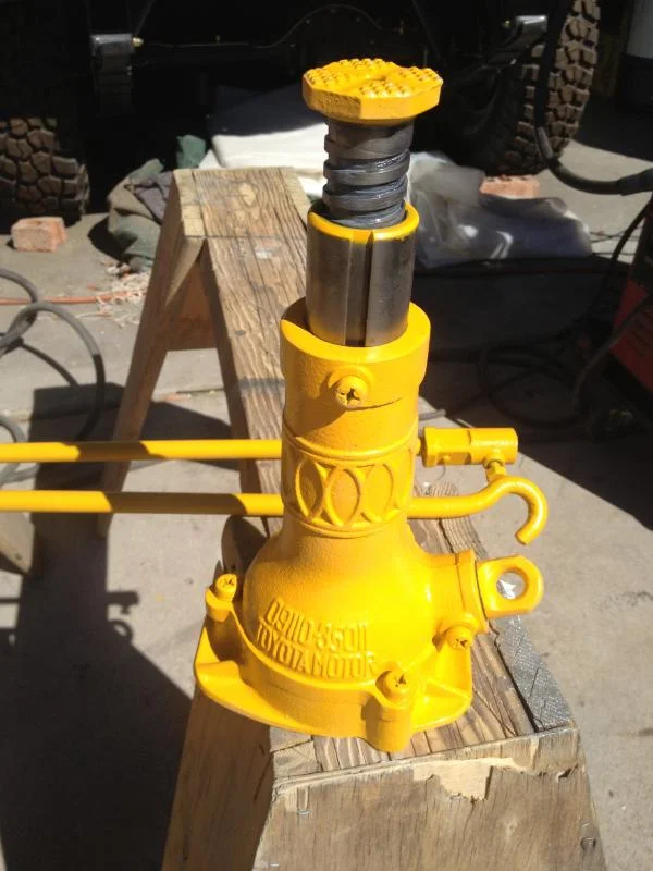

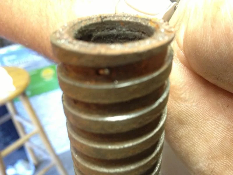

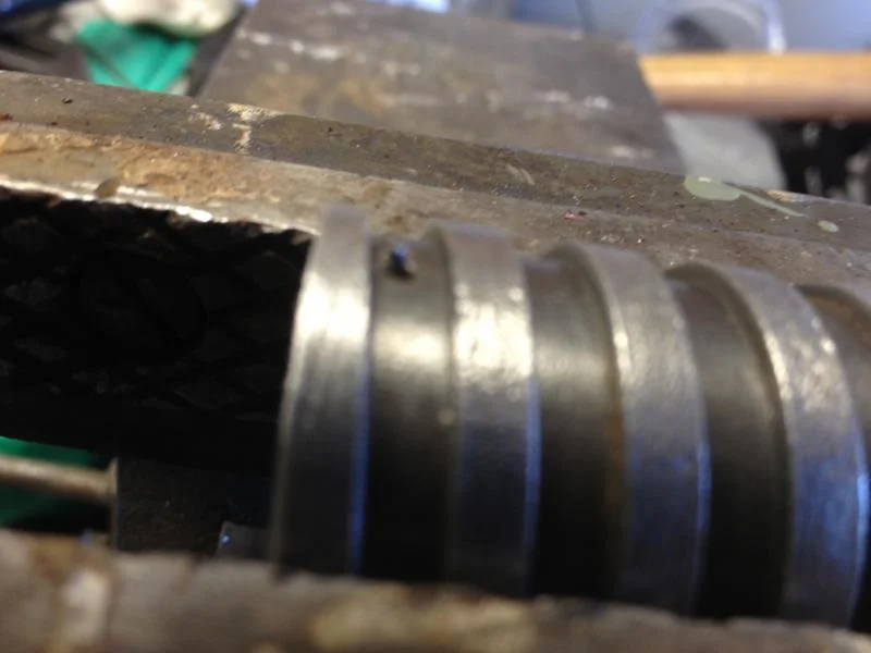

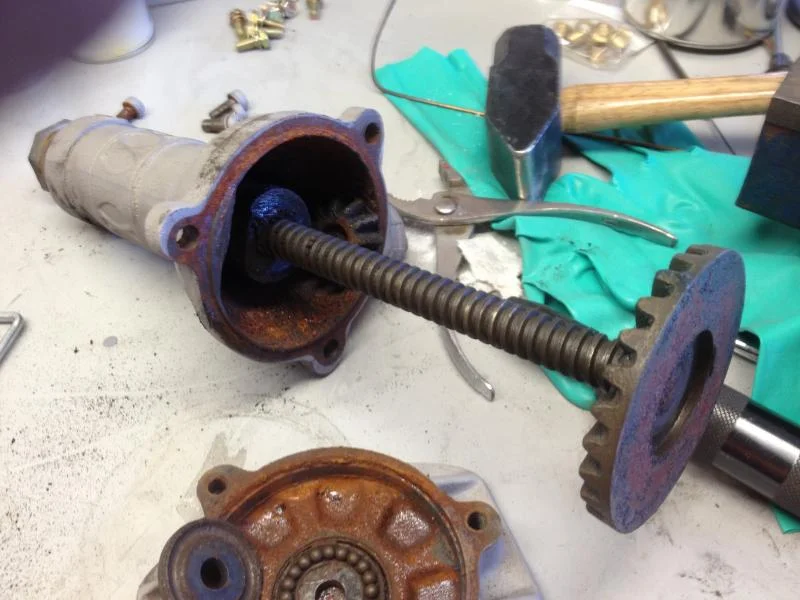

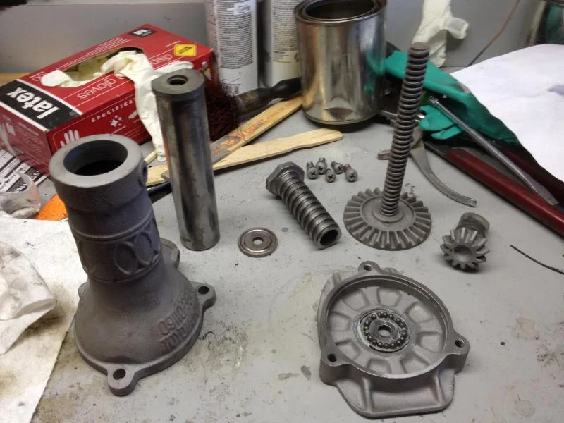

to get the main post out of the upper housing, you need to remove the top piece that threads in the top. There is a little spring clip that allows the top part to thread in, but not all of the way out. I clamped the post in a vice and used a big channel lock pliers to force it past the spring clip and unscrew it from the post. After I cleaned things up, I just straightened the bent clip to re-install it.

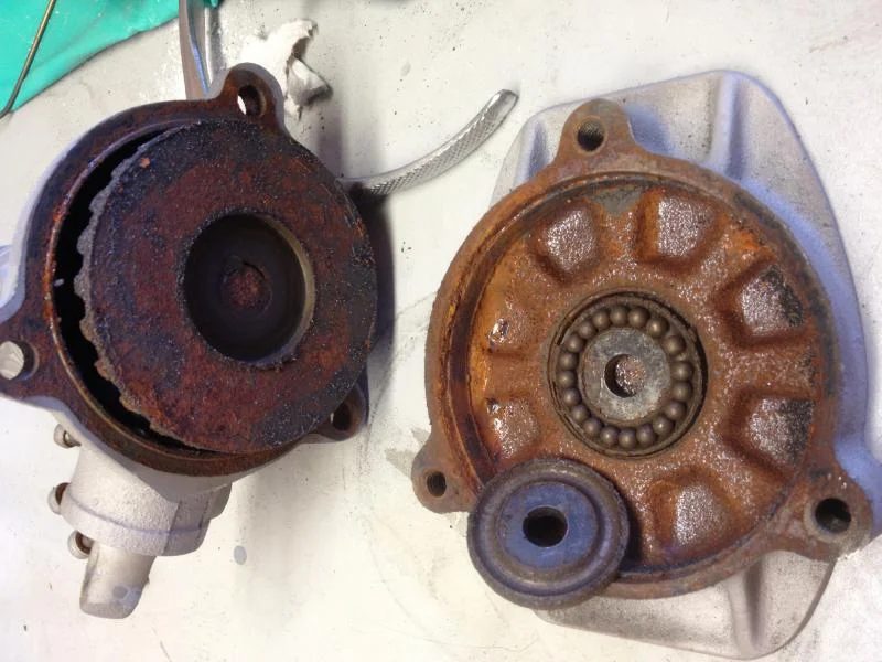

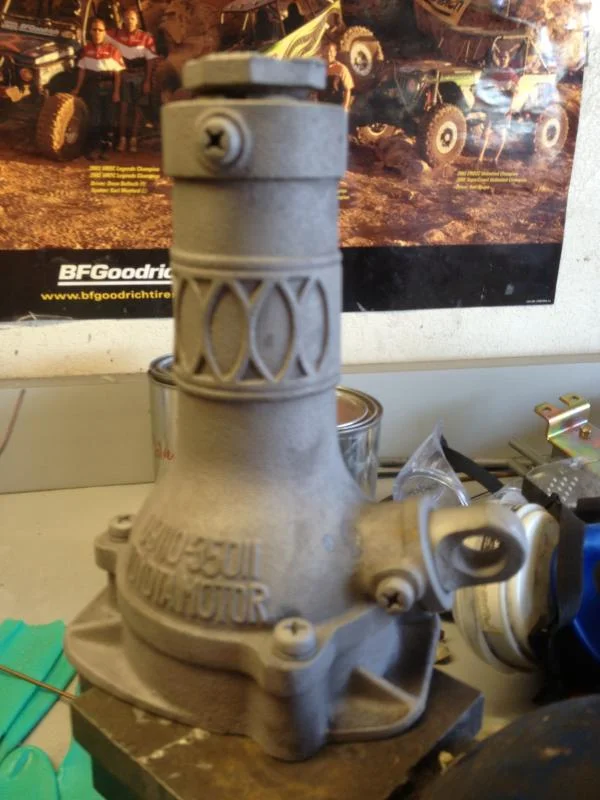

I media blasted the cast areas and cleaned up the machined surfaces on the wire wheel. I then coated everything with Teflon grease and reassembled the jack. I used Duplicolor school bus yellow to paint it.
