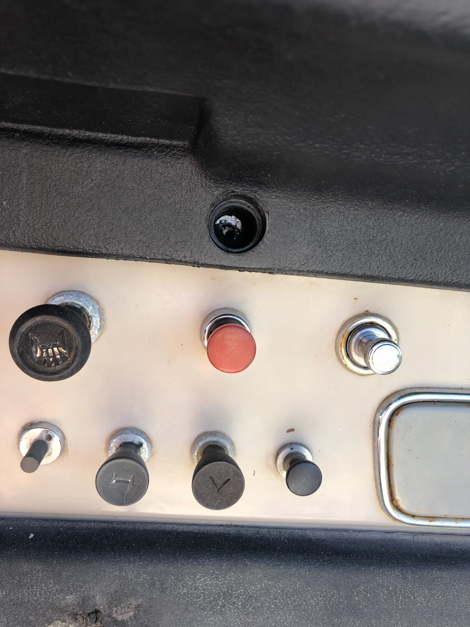

The logo on the knob is used for both hand throttle and choke, but they vary on use. Later models use a slightly modified version of that symbol for hand throttle.

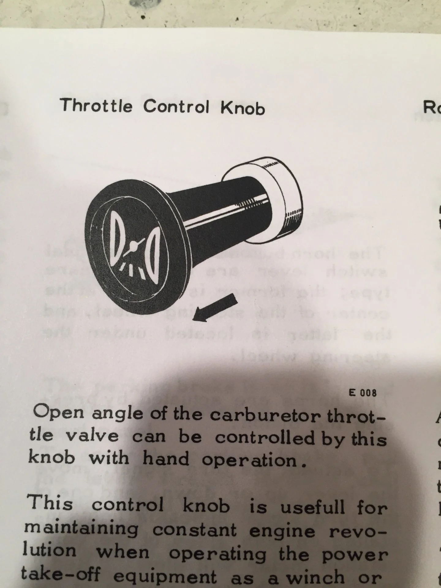

From Owners Manual:

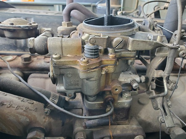

Here is a photo with a possible example of hand throttle cable routing for the 3/69-9/69 carb....see the cable going through the slot. That same member, @MDH33 posted elsewhere that both the accelerator cable and hand throttle cable are secured with the same bracket/clamp on the '69 model year carbs in question here.
This is starting to make some sense. I'd assumed my carb was original because it's an April 1970 date. It was likely a replacement though. I have the remnants of that dual clamp bracket that was rigged up on my 1970 carb to hold the incorrect accelerator cable.

Yeah, that's my pic above. The 3/69-9/69 carb does have the long hand throttle cable going directly to the carb. I'll get a pic of the carb on the bench so you can see the linkage more clearly.
Here's a pic from my 69 manual.

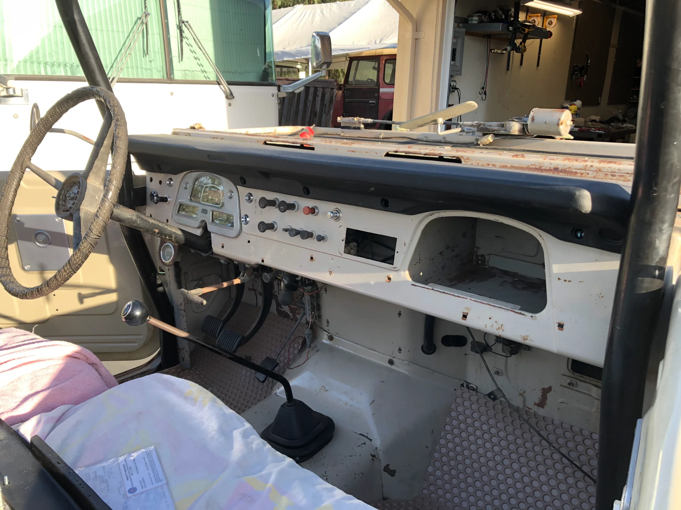

Here's my dash, you can see the choke and throttle knobs
