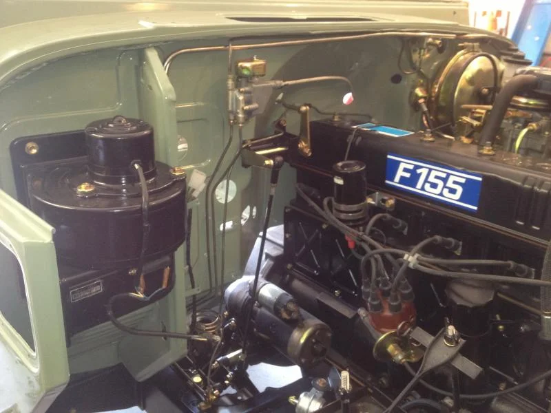

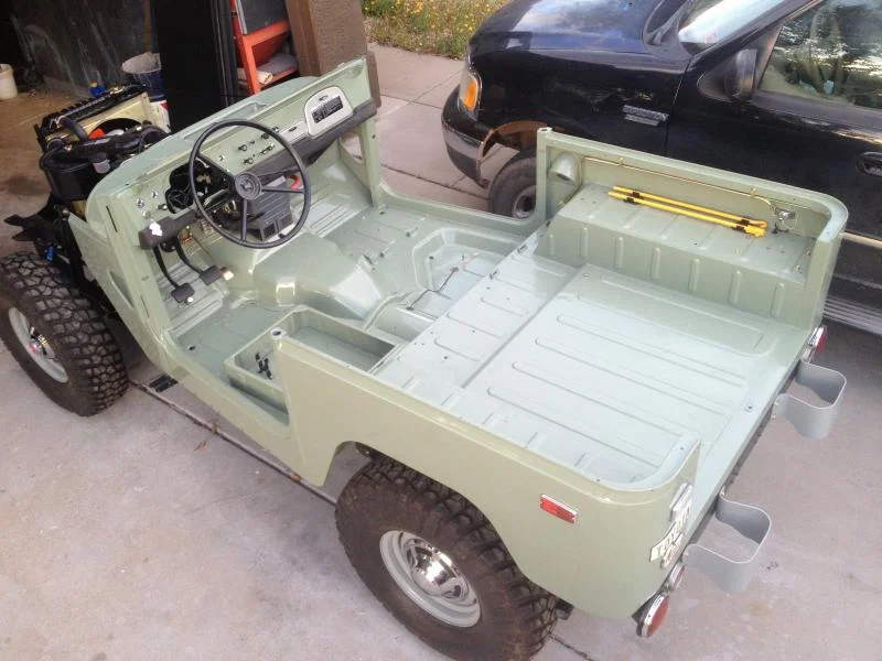

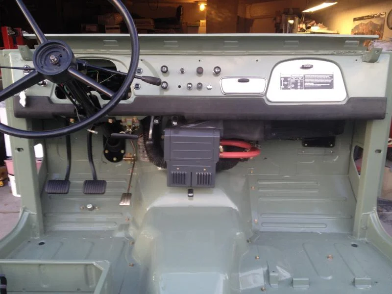

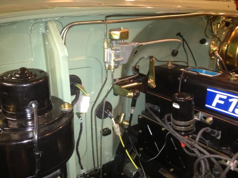

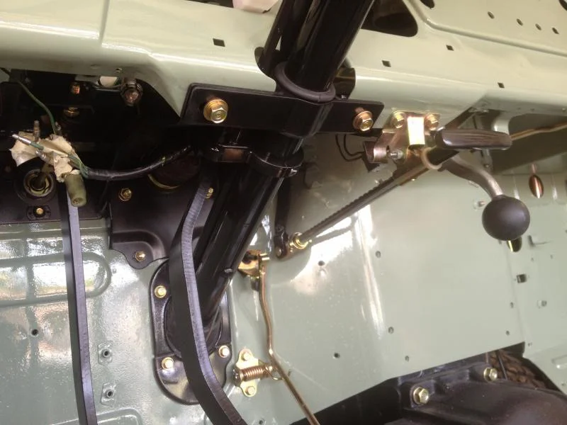

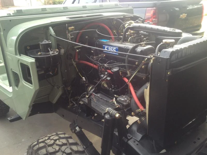

I made some good progress this weekend. The brakes and clutch are done, as well as the steering and shift linkage. Even though everything was bagged and tagged, I spend the majority of my time looking for things or trying to remember how they go back together.
You have no idea how much use I'm getting out of these reassembly photos. I thought I took all the pics I could ever hope for when I tore my truck apart. But, even with all the shots i took, there were a few things that I just didn't capture. Also, since my truck was a V8 hack job, I didn't have the advantage of seeing how the engine compartment should look. I'm really looking forward to seeing this come together.

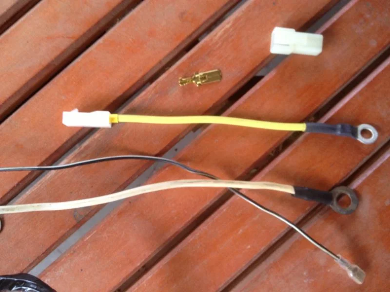

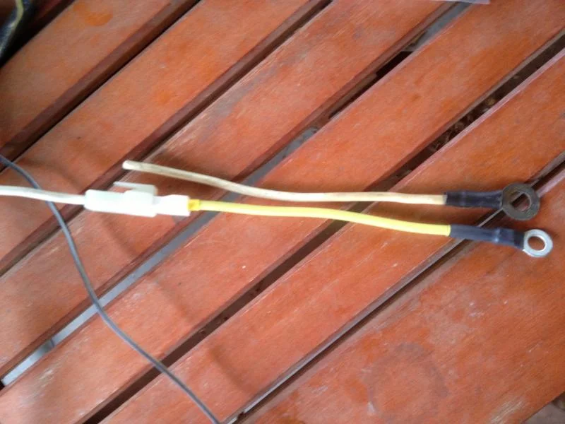

I finished up the wiring harness, and to prevent another melt down I installed a fusible link. Coolerman provided me with the fuse link and the connector. Since it is a critical connection, I soldered the terminal on to the harness. It attached to the starter like the original did.

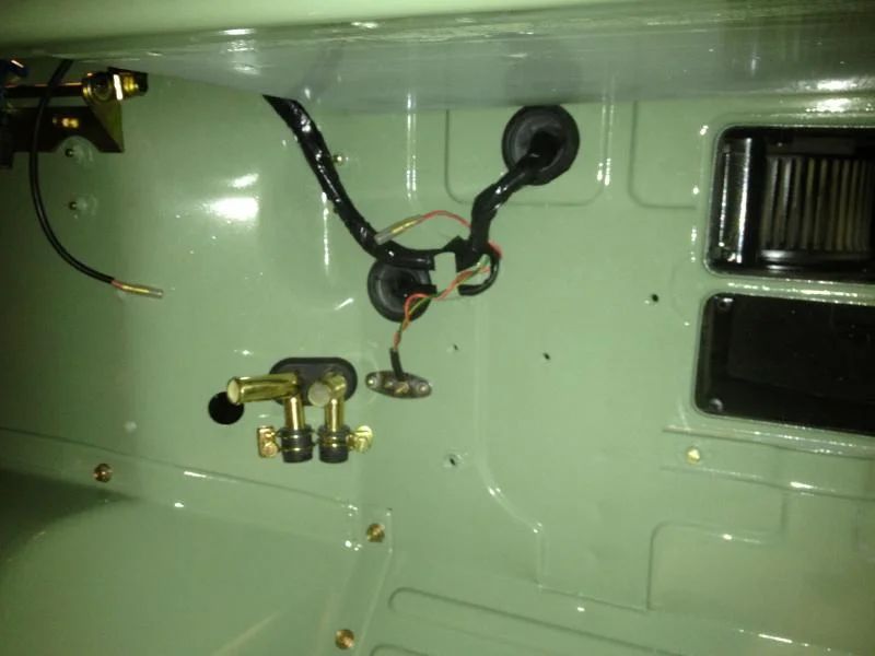

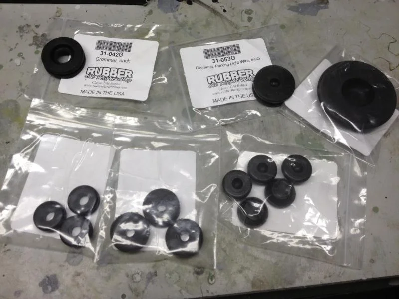

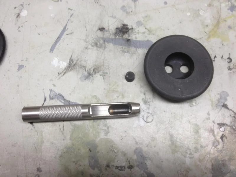

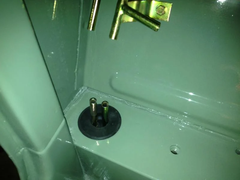

I ordered a bunch of grommets and body plugs from www.rubbertherightway.com, I had to make a grommet for the emissions lines that come out near the filler neck. I used a 1 1/2" body plug and put two holes in it with a 5/16" hole punch.

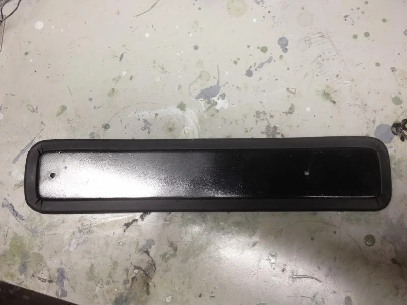

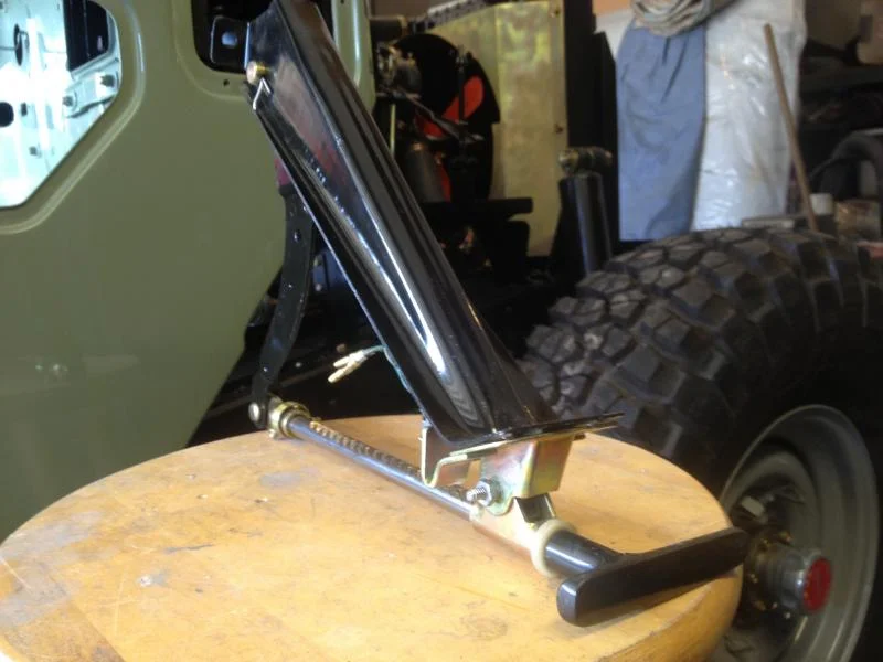

QUOTE=zags;7496072]I bent up the new supports in my home-made plate brake. I use rotary broaches instead of drill bits in sheet metal and lighter plate. They make fast, perfectly round holes with no flash clean up. The new support is much beefier than the original.[/QUOTE]
Do you have a better pic of how you made the bending brake???
Do you have a better pic of how you made the bending brake???[/QUOTE]
I will try to post some pics when I get home.
