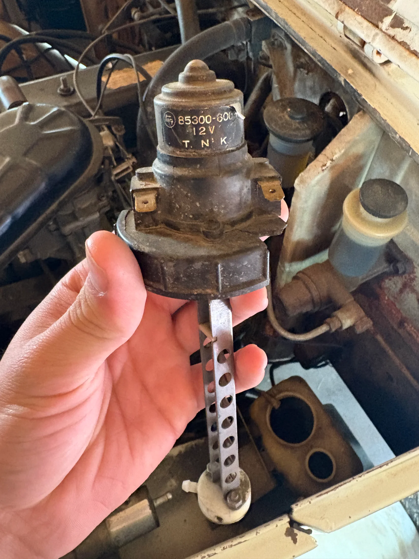

Hey there, I have been working on electrical on my 1970 fj40 and I’m nearing completion. There are a few gremlins I have yet to figure out.
my wiper fluid pump is broken and I can’t seem to find another like mine on the internet even with a part number search. This is what it looks like. Any help on identifying and what my options are for a new one would be appreciated
There are cheap parasitotic pumps on Amoron. $10. They can run dry without damage. Plug into your tank and hose to nozzles.
I going to adapt a gallon jug for windshield juice
That particular setup is unicorn rare to find with the screw on lid intact. I think I have a couple. But to be honest, even if it isn’t cracked today, there’s no guarantee that it won’t crack the first time you try to use it. That’s why they updated the design.
Interesting. Does the pump itself work alright? I was thinking of 3d printing a screw lid so I can keep the original pump. But If it’s not good, I won’t bother
Straight dope: unless you’re aiming for concours restoration with plans for immediate resale, save yourself some headaches and buy the generic one SOR sells.
