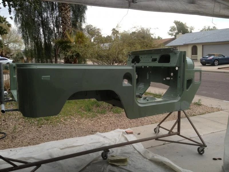

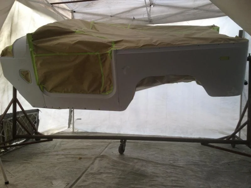

Getting close to finishing the paint. The painter that offered to help me paint flaked out on me, so I have been painting it in my driveway. Also, I noticed that the paint for the roof that was supposed to be Shell Ivory is actually Shell. So instead of paint for my roof, I have a quart of paint for an '83 Tecel. :mad: I actually thanked the paint guy for going the extra mile and doing the research to find the right color for me, just to find that he just mixed something that sounded close.

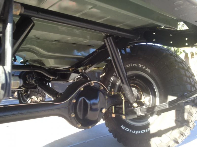

OMG, I love all of the work!! I love the fact that you made some of your tools, and could use them on this project!! no stone unturned on this one!!! That drive train looks amazing, everything is so fresh and clean I can see what some of those things were that mine were missing. I was just wondering the other day what the yellow letters on the side of the trans said! Keep up the good work! I also love that color, and I love your detail when it comes to paint. The booth, taping to avoid over spray, nothing left that you hadn't thought of!! **Subscribed** :-D

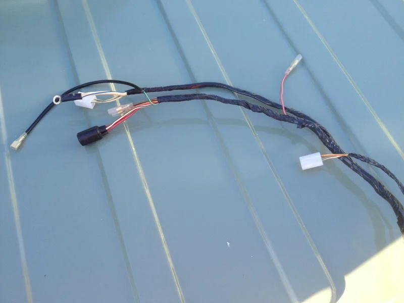

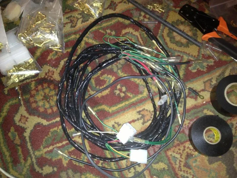

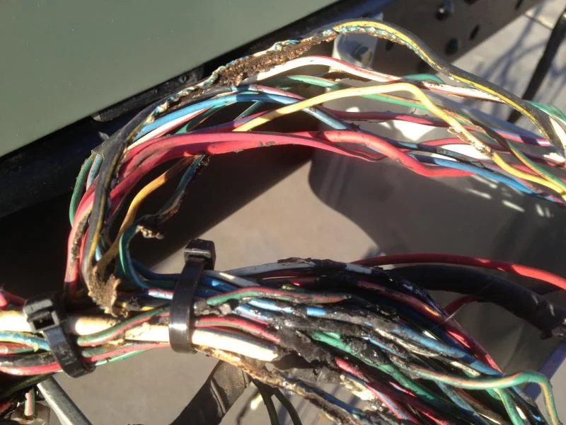

I have been working on the wiring harnesses while I am sitting in front of the TV in the evenings. I have been replacing all of the terminals and connectors, then re-wrapping everything. Good thing I have been too, because I ran into this melted mess near the fuse box. I'll be cutting out the cooked chunks of wiring and soldering in replacement sections.
