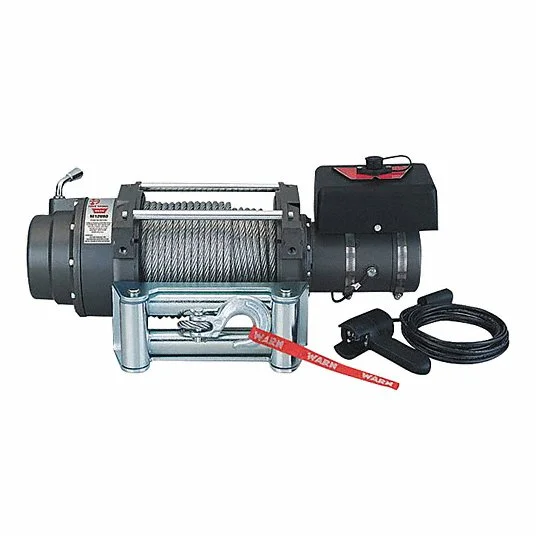

This is what I was referring to earlier, Warn discontinued these cable parts decades ago. I needed them as well and gave up on the Bellevue winch after finding out how hard it was to find them. Better off with an all electric winch. I have one similar to this planetary style one on my 40, it doesn't stick up as much as the 8274.
THANK YOU! That's what I wanted / needed to know. What model did you get, and how satisfied are you with it?

I have an Aussie knock off of a Warn 10k called a T-max, no idea if they are still sold here in the states. Absolutely
no issues for the last 15 years, it always works when needed. As I said before I rarely use it, the 40 hasn't been stuck in years where it requires a winch pull. Somebody designed these Land Cruisers so well that with a decent driver, they go just about anywhere. I will eventually spool on synthetic line and then use soft shackles but for right now with limited use, the cable works fine for me. Good luck!

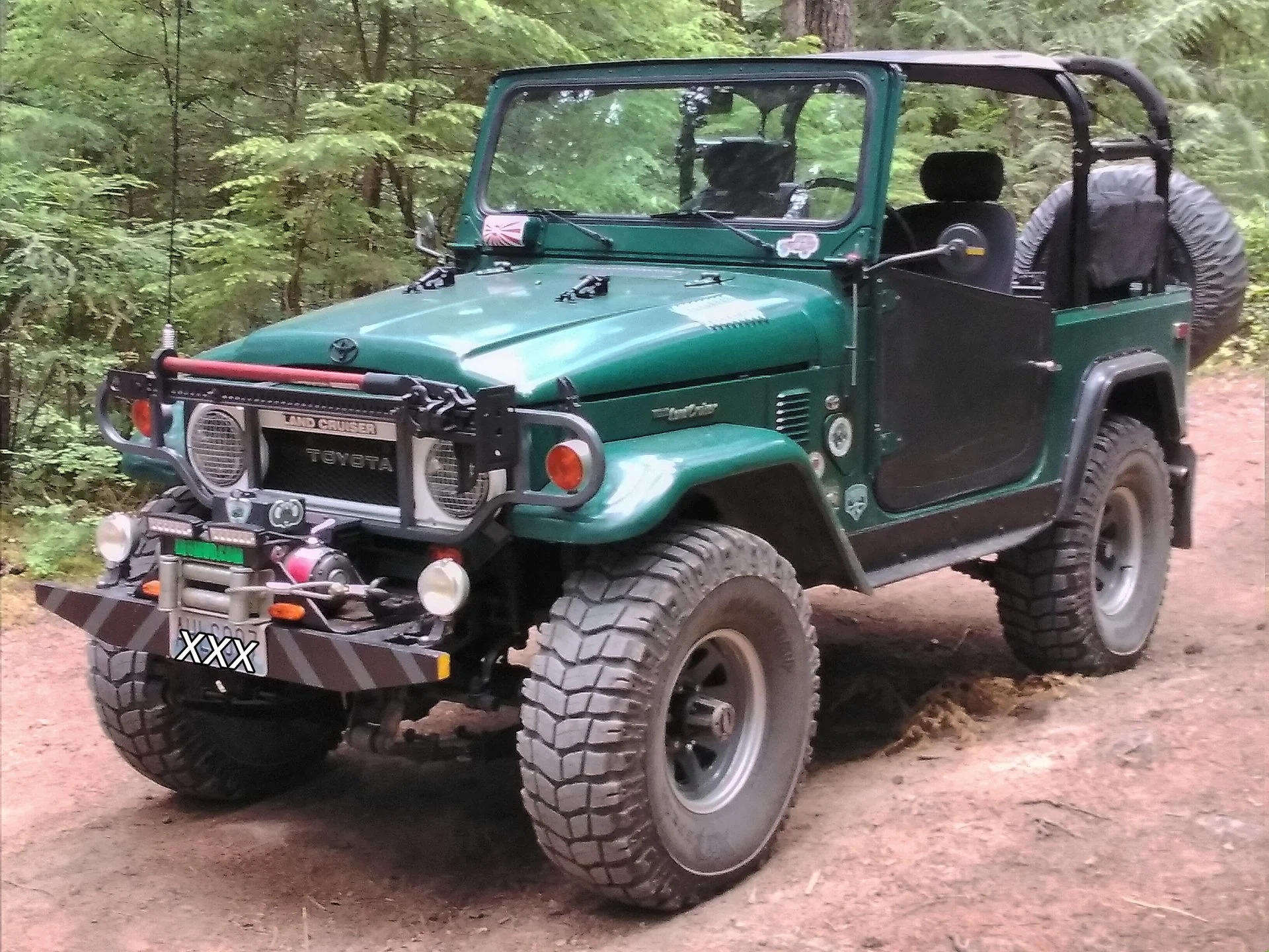

I'd like a wider bumper to at least offer some protection to the tires
Protect the tires from what? Big nasty rocks? I like a narrow bumper that doesn't get hung up on whatever I'm trying to drive over.

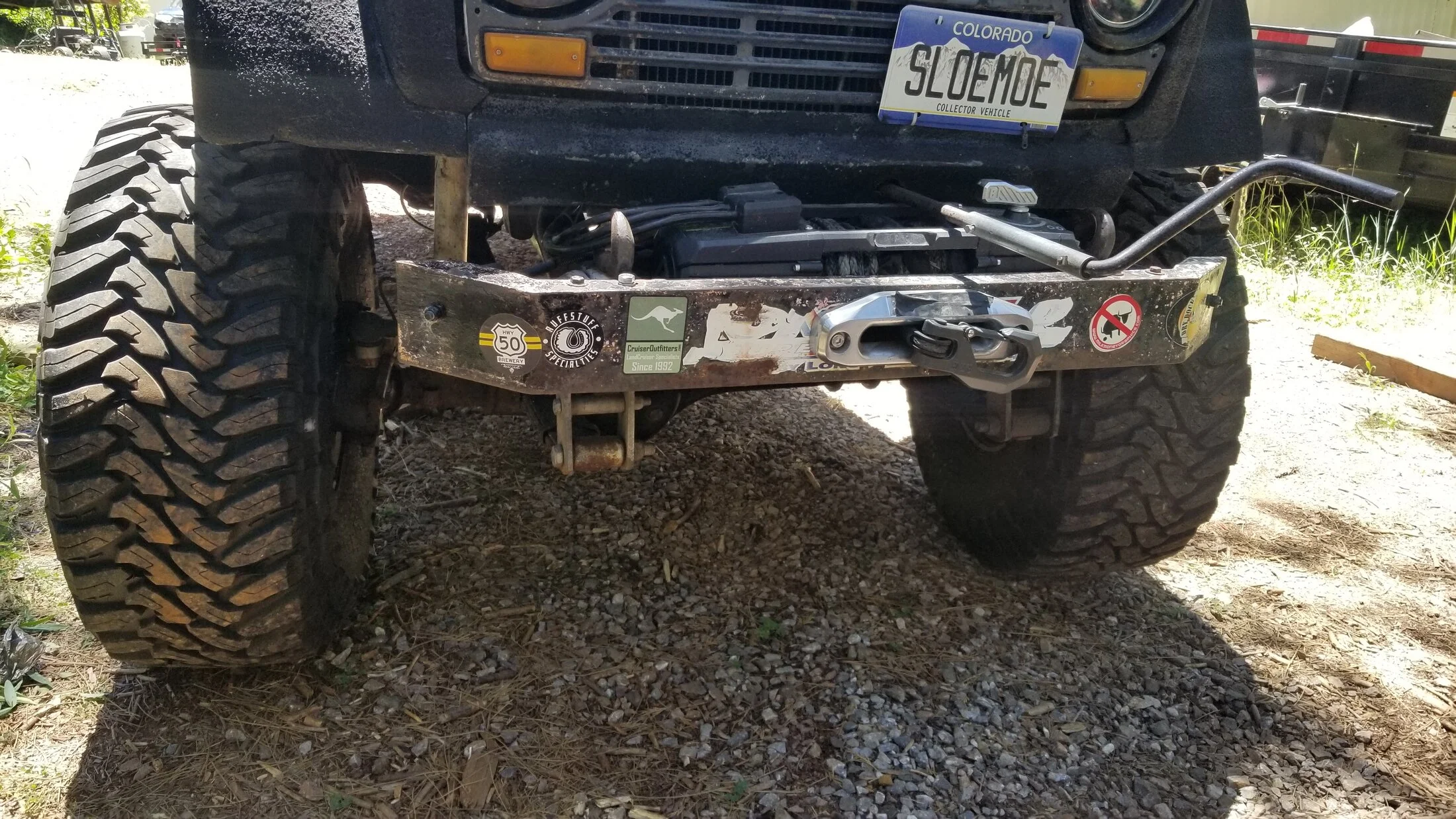

Anyway, I needed a low profile winch because I still use my hand crank and didn't want to cover the hole it goes into. The harbor freight winch was cheap, on sale and fit. It works pretty well too.

Putting a wider bumper on to "protect" your tires is kinda like disconnecting your driveshafts to protect your diffs. ;)
