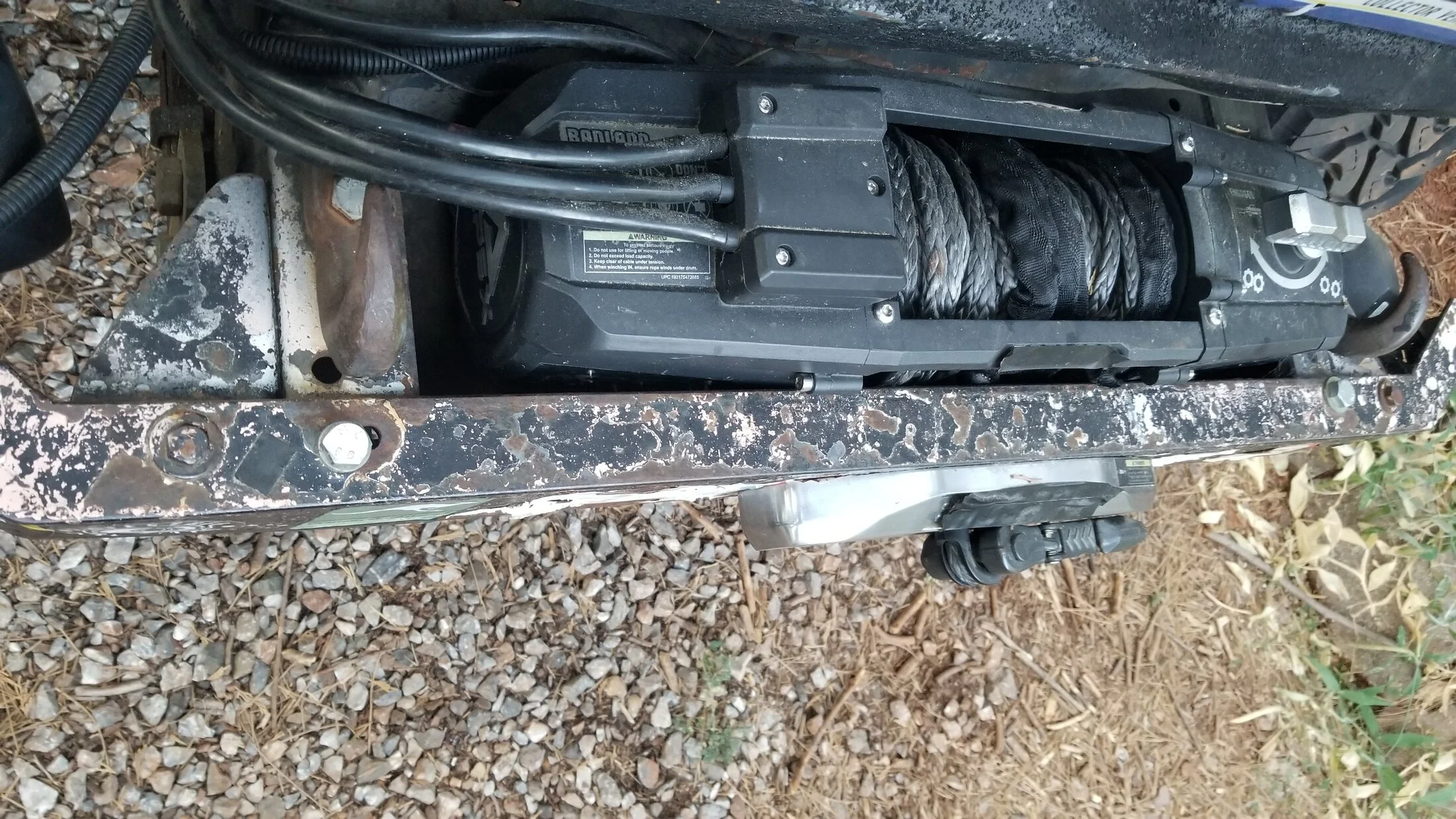

Protect the tires from what? Big nasty rocks? I like a narrow bumper that doesn't get hung up on whatever I'm trying to drive over.
Anyway, I needed a low profile winch because I still use my hand crank and didn't want to cover the hole it goes into. The harbor freight winch was cheap, on sale and fit. It works pretty well too.

I absolutely LOVE the low profile of your winch!

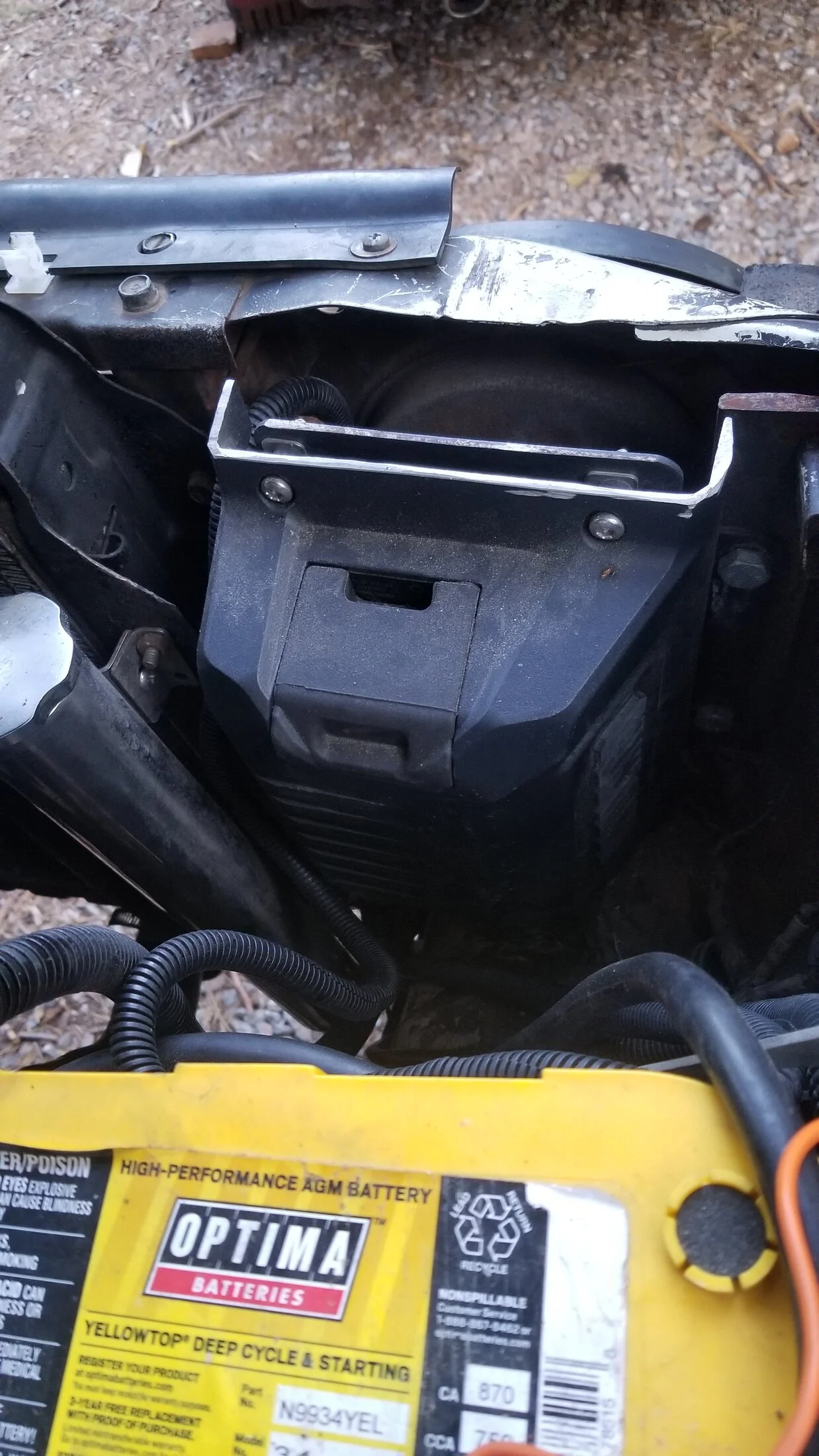

Secretly, to make that low profile (which I love), I located the control box in the engine bay (which I do not love but can live with). I mounted it just behind the passenger side headlight.
It's a badlands apex 12000#.

THAT is brilliant!!! Having never had a winch before, I didn't know you could do that, but now that you told me, I'm going to do the exact same thing!

You're far too kind. It's not my idea, been done before, the included directions tell you how to do it.
Do not do the exact same thing. We do not have the exact same vehicles or the exact same bumpers or the exact same anything. There's not a lot of spare room under your hood. Look at it and imagine a big black box hard mounted somewhere. Somewhere near the winch. You'd probably have to move something, like an overflow bottle or a horn or something more difficult to move or remove. Do some research. Dimensions are usually posted. Go to your local store and look at the winch. Take a tape measure. Then look at your rig some more, visualize putting them together.
