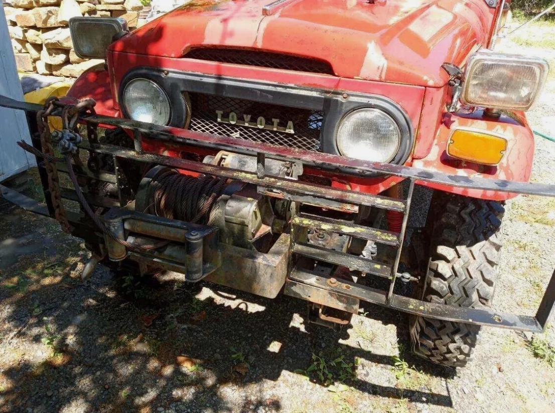

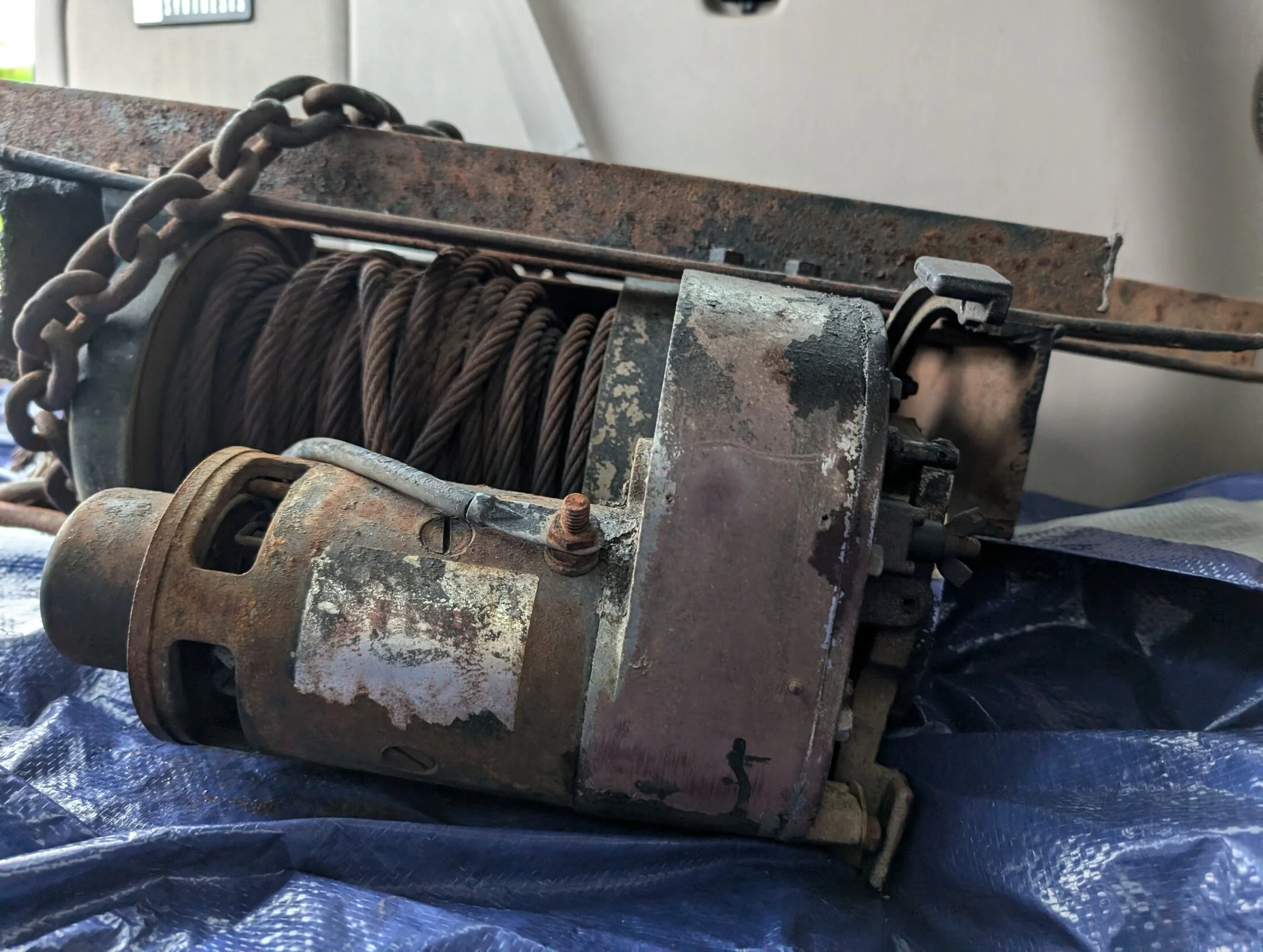

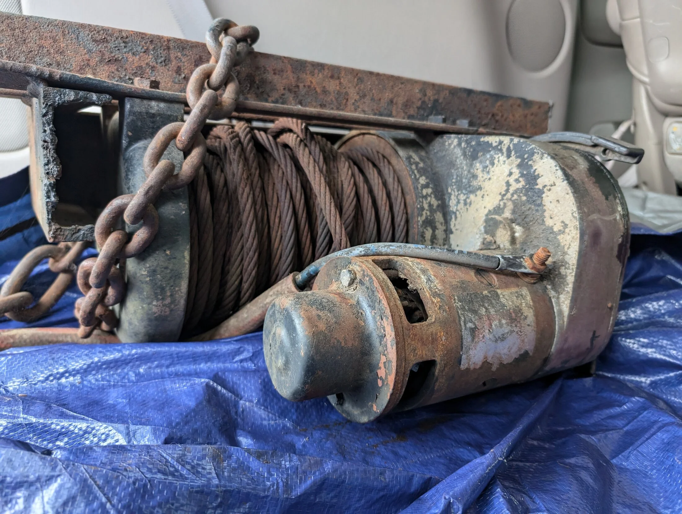

I have never had a winch before, and I would greatly value and appreciate advice from those of you that have and use them.
When I recently bought my first FJ40 it came with a gigantic electric winch on the front. I've looked and can't see a name plate or info on it, probably because a previous owner got carried away with black paint and painted it too. And no controller for it.
What I do know is that it took me and another grown man, and we had to really grunt, to pick this massive beast up and move it out of the way. It is HEAVY!!!
Tomorrow I was planning to take it locally to have it tested to see if it even works, before risking a hernia or another ruptured disc trying to put it back on the FJ40 after the paint is done.
But now I'm wondering... even if it works, if it's THAT heavy, is it worth it? I think back to a 35 inch tube TV and how much it weighed & the picture quality versus the cost of a 65 inch TV today that weighs a fraction of the amount and has a 4K picture.
So my question for you guys is, should I just punt and buy a new one? Something that would weigh a fraction of the weight with better pulling power? Has time & technology helped winches like it has TV's?
And the guy that is supposed to test it said he and his wife both have winches and he highly recommended the synthetic rope. That surprised me. He said it weighs less and is just as strong as cable.
What say you? Attached are some pics of "the beast" that weighs as much as an elephant! Sorry, I think the last couple of pics it is upside down in my van, and I may have noticed an info plate but it's raining so I'll check it out later.
Thank you!

That winch is old tech and I agree a 8274 is a great winch I just rebuilt my first one and it was very satisfying. The 8274 weighs almost 50lbs without cable on them but are very reliable and super strong. Buy a used one and rebuild the brake and reseal it. Then enjoy years of use.
I tried and failed to rebuild a Bellevue winch 20 years ago. No parts are available from Warn anymore unfortunately. Junk it and go with an 8274 if you like that unit. Not a popular opinion here but I personally went with a stronger 10k pound planetary winch. Mainly so I can drag out full size hillbilly trucks stuck in the mud with my little 40. Also makes a great stump puller. I have never needed it off road to "unstick" myself though and hope I never do. To each their own but I do believe it's better to have a winch and not need it than not have one and be stuck. 😃
As the others said that is a Bellevue, so an 8274 that others are recommending isn’t going to be any lighter.
Personally if you aren’t going to use it I don’t see the point of having the +200lbs of winch and heavier duty bumper on the front of the truck all the time. They do drive nicer without them.

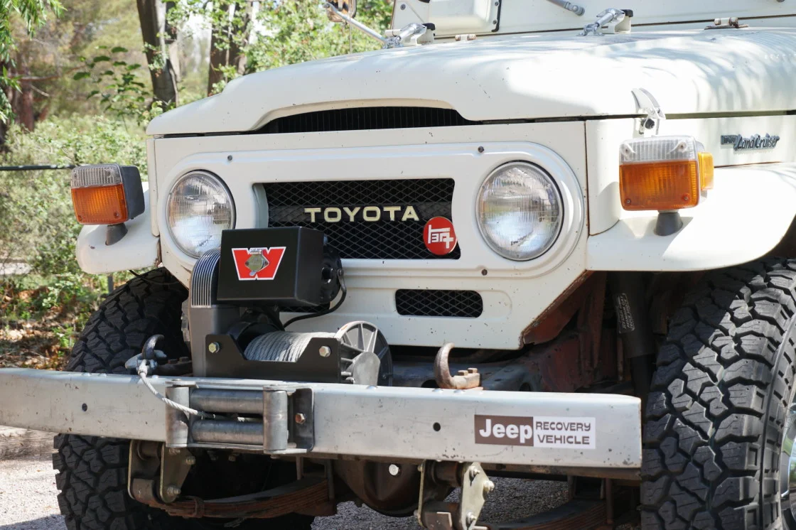

This is all good advice for you to consider. When I bought my second 40 it had a Warn 8274 :
Five years later I decided to rebuild and install on my latest 40:
In my humble opinion, ya can't beat the Warn 8274 cool factor - drop the mic - BOOM :cool:
This is all good advice for you to consider. When I bought my second 40 it had a Warn 8274 :View attachment 3664058
