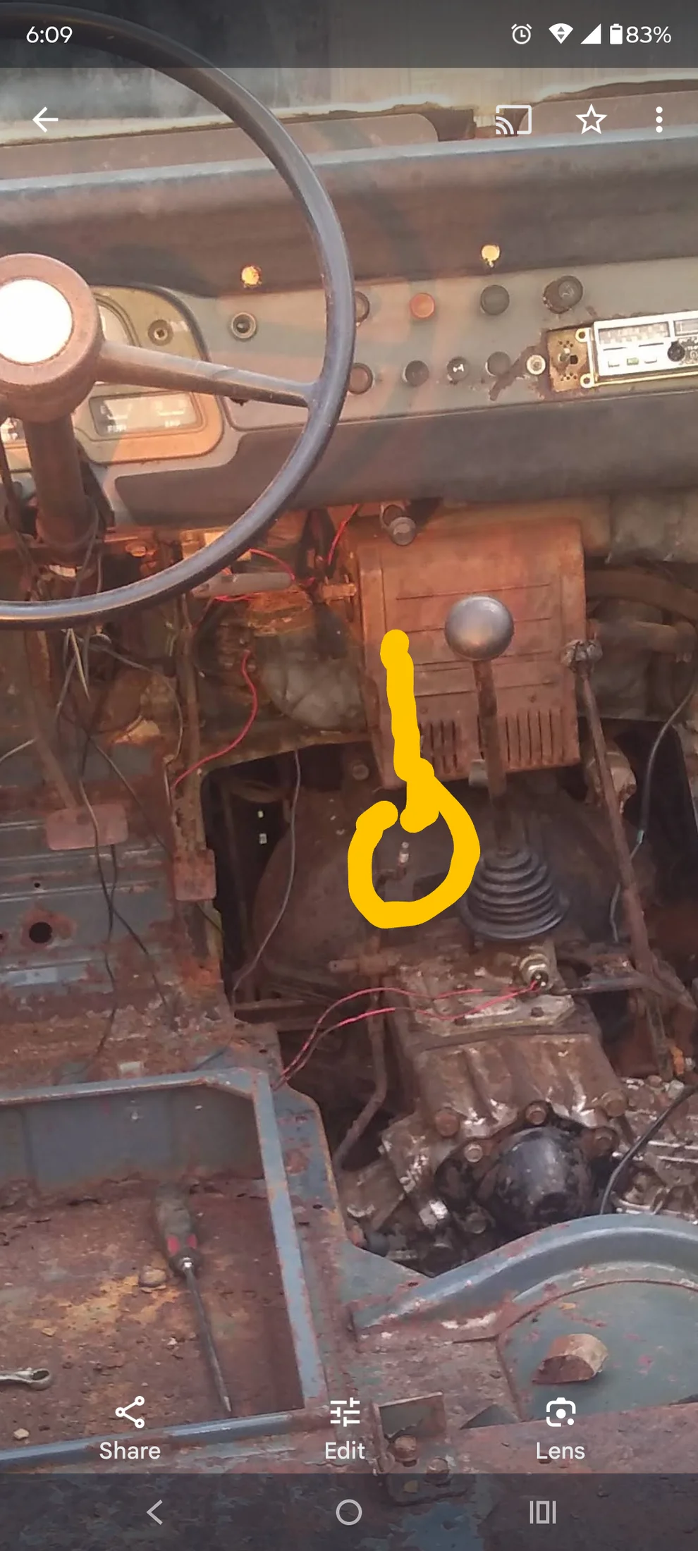

Any ideas for unlocking a locked pto winch? It doesn’t do anything. When I put the transfercase in high it locks the driveshaft but it still doesn’t spin the winch. The free spool mechanism is also locked up. Thanks!

I don’t even know really how to engage it. If I put the transfer case in high the driveshaft locks up to the pto then if I put it in gear the car moves. I’m not sure if I’m missing a lever or something

There should be a small lever with a flap lock out to engage the PTO on the floor down by the gas pedal area.

Put the winch on gear put transfer case in neutral. Put transmission in gear. Winch spins slow in first gear spins faster in 2 and 3. Winch spins backwards in reverse
