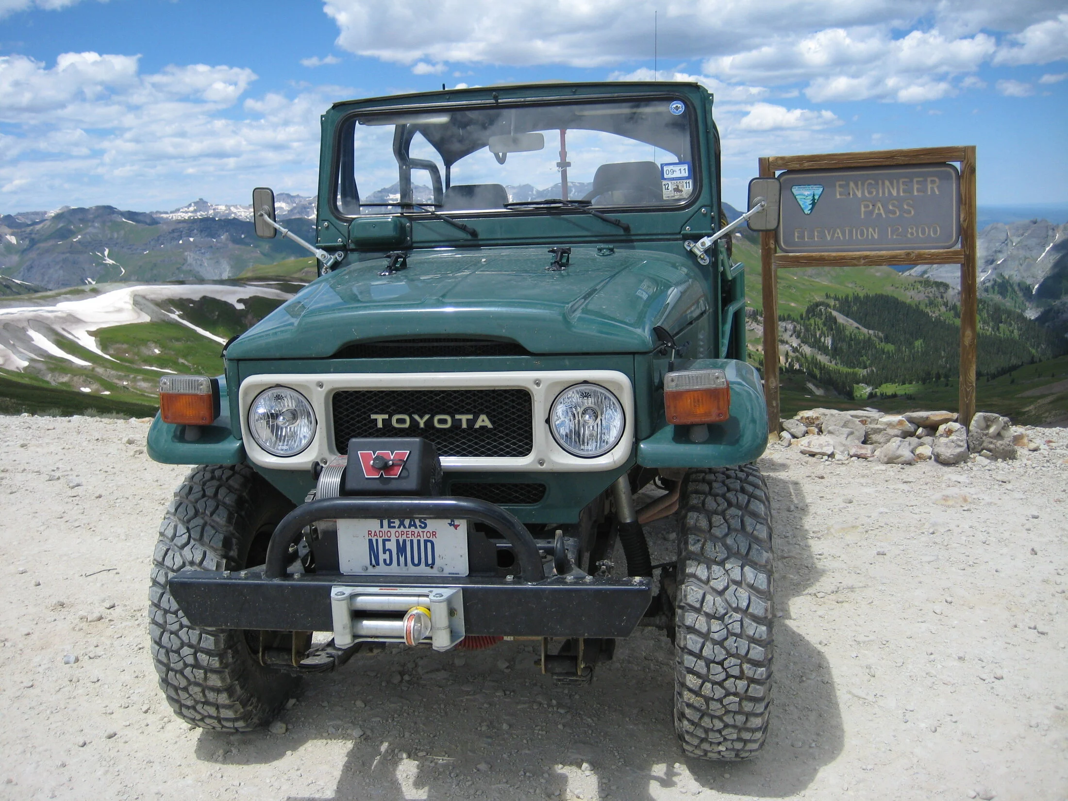

Pics borrowed from MUD.
Yes there’s multiple low profile Warn winches. You’d just have to hop on their website and determine what you want to spend and need/want capacity wise. Then either purchase new or find a good used model.
However there’s also multiple lower profile 8274 mounts/bumpers. I honestly think it’s hard to beat the styling, reliability, capacity and line speed in one winch like a 8274. Which is why (in my humble opinion) you see them as the most popular winch on the front of a 40 series and dare I say many other brands. It’s been continuously produced since 1974 with only minor tweaks and upgraded electronics that alone says a lot.
