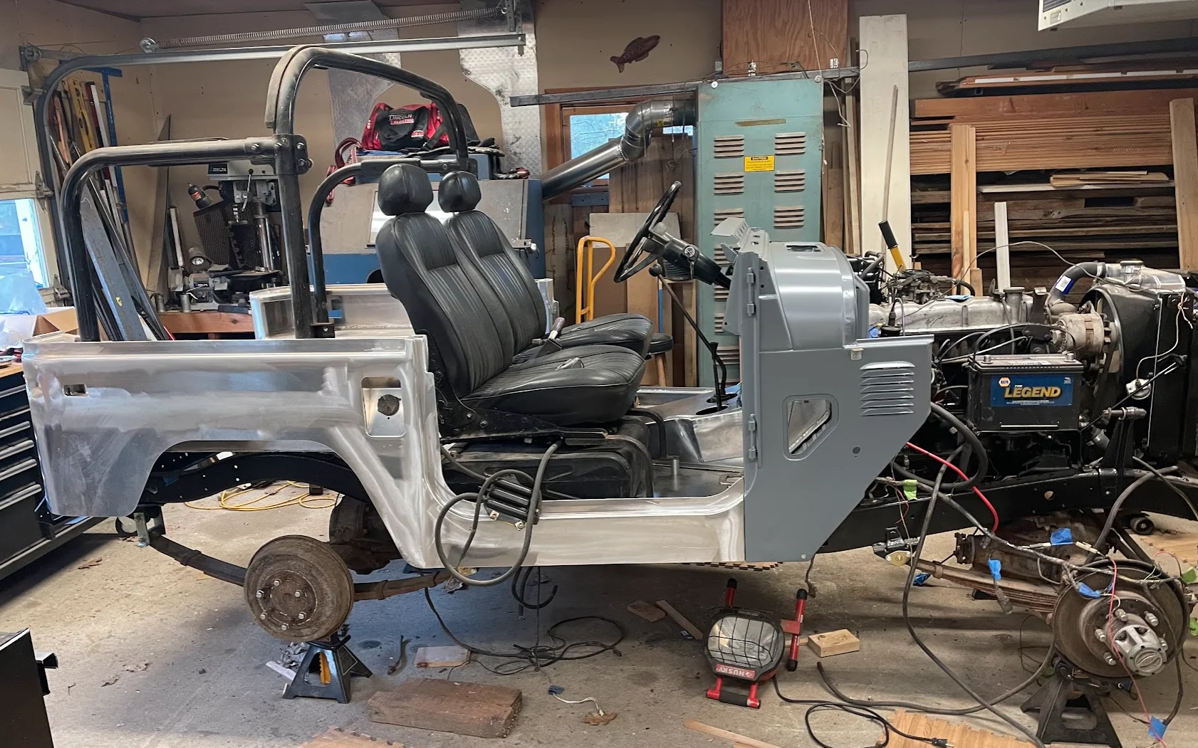

Still in body work purgatory. Opening every cavity to clean it out and remove rust before I start re-assembly. Found some PO had dropped a screwdriver down the post hole for the hard top. I played the most excellent… Wild Stallions! game of operation and retrieved it. No way in hell I’m letting some Philips Head screwdriver violate my restoration. I may have left it if I knew it was a JIS.

Two public service announcements: 1) do not put any undercoating or bedliner type product under your 40. It just traps water and causes more rust (my opinion, take it or leave it) and it makes repairs more difficult,. 2) this is a my bad situation. I sandblasted the tub. Don’t do that. It gets into all the seams and cavities and isn’t worth it. If I had to do over again I would have the tub chemical dipped. Oh well, next time.

I am neighbors with @PitterPatter in body work purgatory. I might actually be worse off. Maybe should’ve done aqualu but I wanted to learn welding and am not a quitter.
Pick your battles. I was in the same position and decided to go with the aqualu tub. If I had tried to fix the body, I would still be working on welding and grinding, rather than driving and enjoying. There are plenty of small areas on the cowl and forward (and the top and doors if you are running them) that will need welding, and there is plenty of other stuff that will need your attention and time.

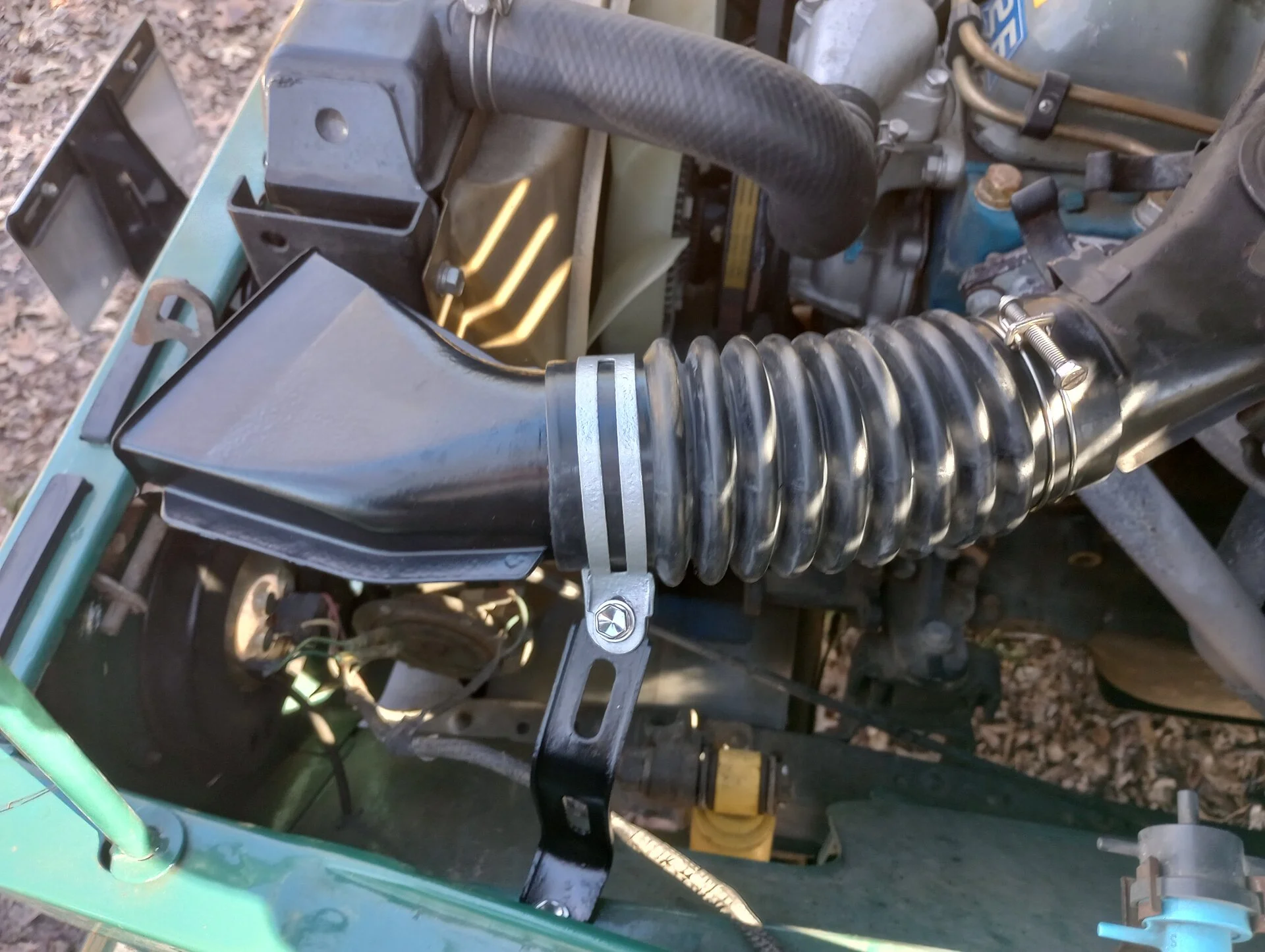

And now for what I all have been waiting for :) @hyhpe got me an air intake horn, which was the very last piece I needed to complete my air intake. It's really nice and powder coated, fanciest paint on my 40 :). I also got pieces from CruiserParts.net and CityRacer. I know it's in my head, but I swear it runs better now!

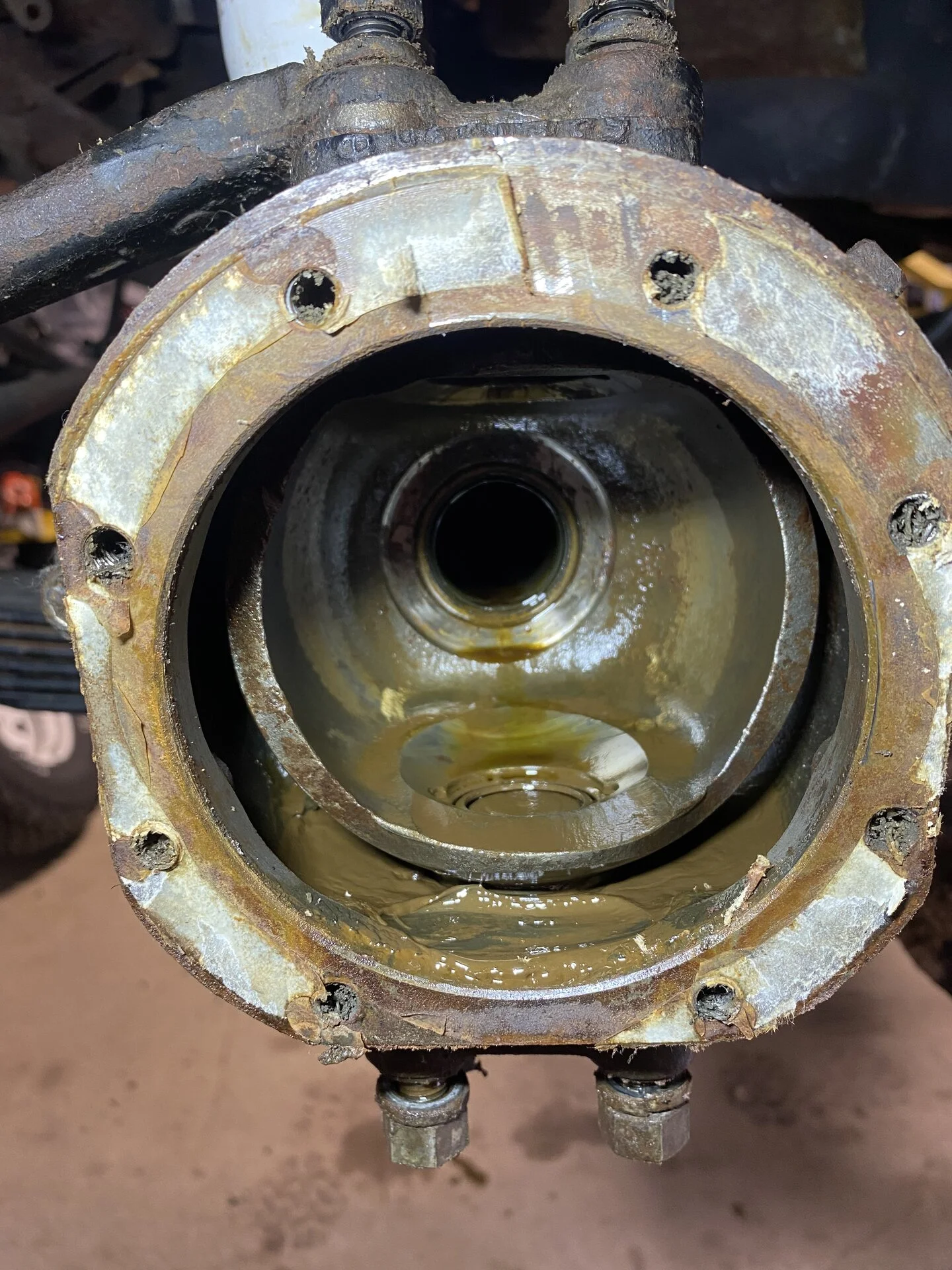

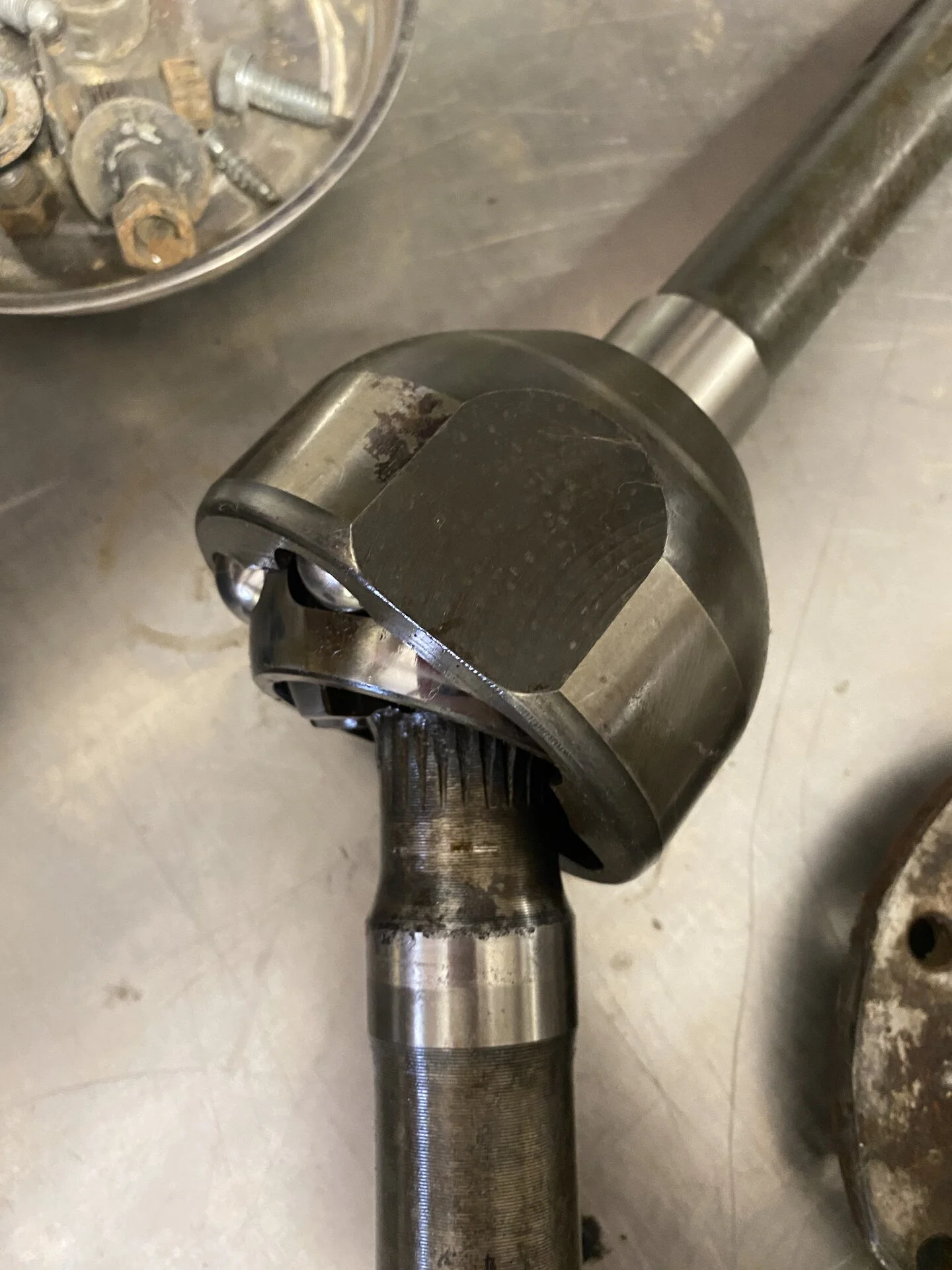

I’d been waiting see if the knuckles leaked or not. I pressure washed the knuckles/axles mostly clean. The brakes had been rebuilt by the PO and it appeared the knuckles had been rebuilt. I’ve put around 500 hundred miles of road and a couple miles in 4wd to get fluids moving. A couple weeks ago, I saw a leak on the pavement and thought the axle seal had finally gone since a significant amount of fluid leaked out of the axle. During a short drive back home, I lost the front brakes. Turns out the leak was brake fluid from the front drum.
Parts in hand, I started the knuckle rebuild today and found a slightly muddy knuckle on the passenger side and a nearly empty knuckle on the drivers side. No damage to the balls in the birfield, trunion bearings were good and the inner axle seal surface looked good. Also, found some metal slivers, shavings and mud settled in the axle tube near the inner seal.

Congrats. Finding that hose clamp and bracket is nearly impossible
