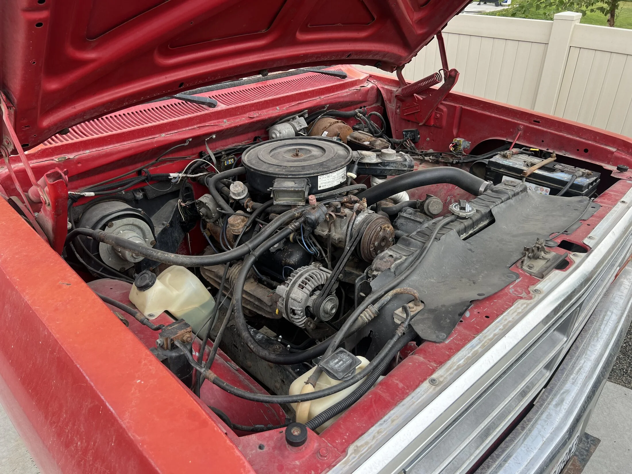

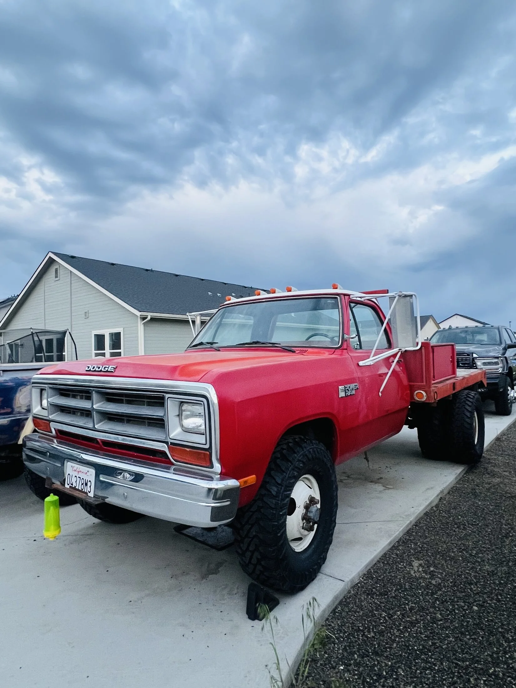

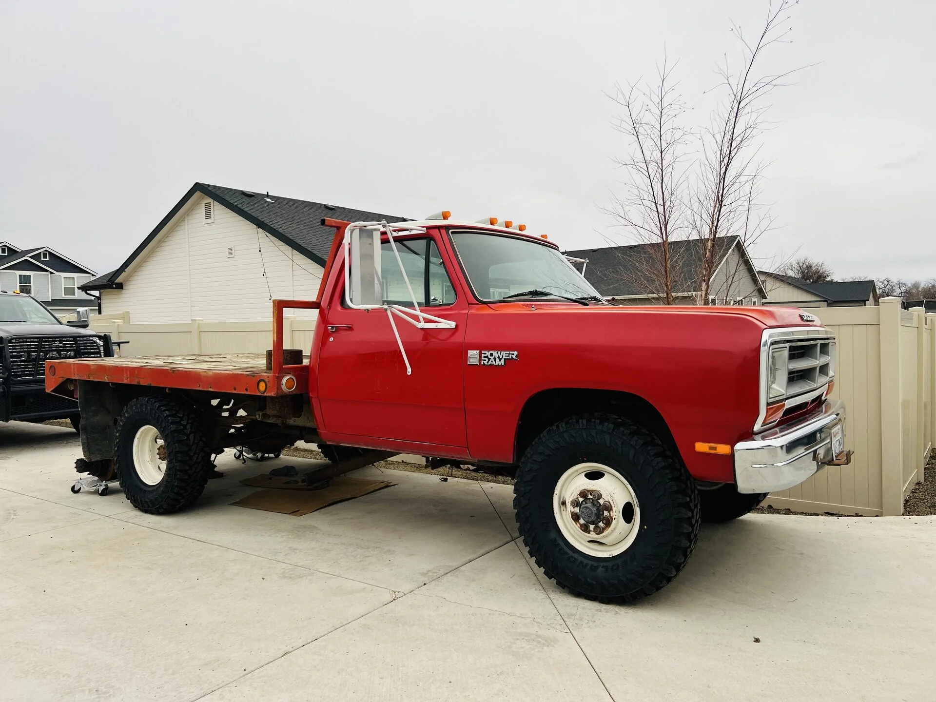

1987 W350 Cab & Chassis. It is a retired California Fish and Game truck that thankfully didn't get the common floor/roof rust. Currently a 360 with Np435/Np205.
Plans are sorta simple, I picked up a full width dana 70 rear axle to swap out the cab & chassis D70. Next is where I'm debating....2.5" or 4" and then 33s or 35s. Truck will maintain the stock coined wheels, just add rear spacers. Once its relatively cleaned up to my liking, it'll be time to swap in a 12v.
Back when I first picked it up during the summer my buddy was kind enough to let it sit in Reno while I was overseas. While I had Christmas break, I took a very quick day and a half 1300 mile jaunt from Idaho to the SF bay area and back with a couple stops at In n Out, a semi-ok but the only decent burrito between Idaho and Winnemucca....I finally have the truck and axle here.
I'm slowly starting to clean it up and removed the Fish & Game vinyl. Overall the paint is pretty good considering its past life so I will only be cleaning it up, no repaints. The tray....will probably get a coat of black paint and either relocate the box or get a different box, not too sure yet.

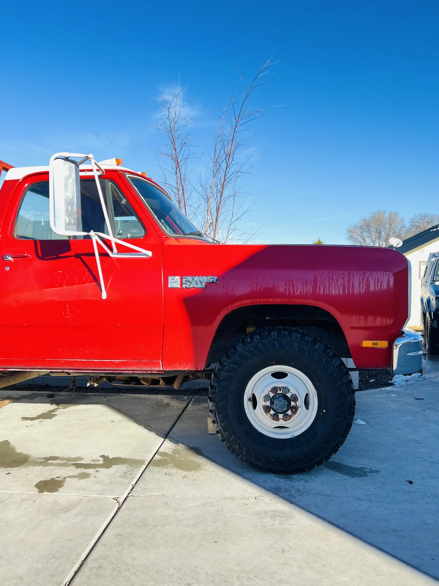

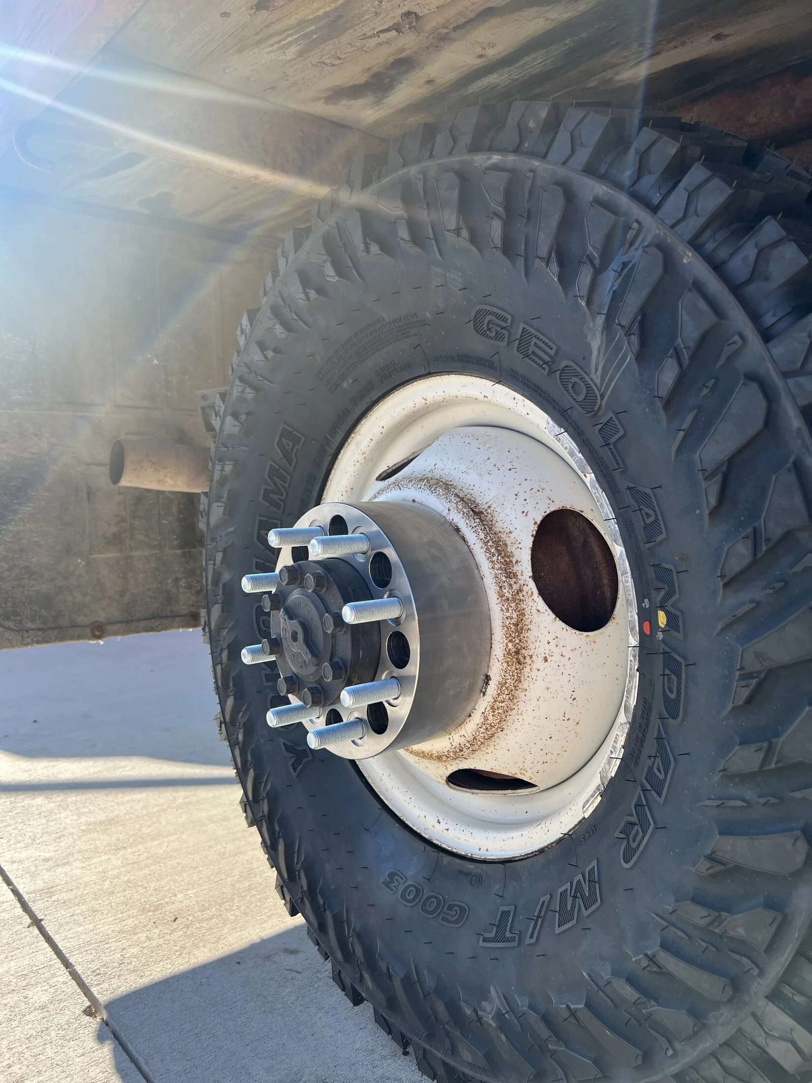

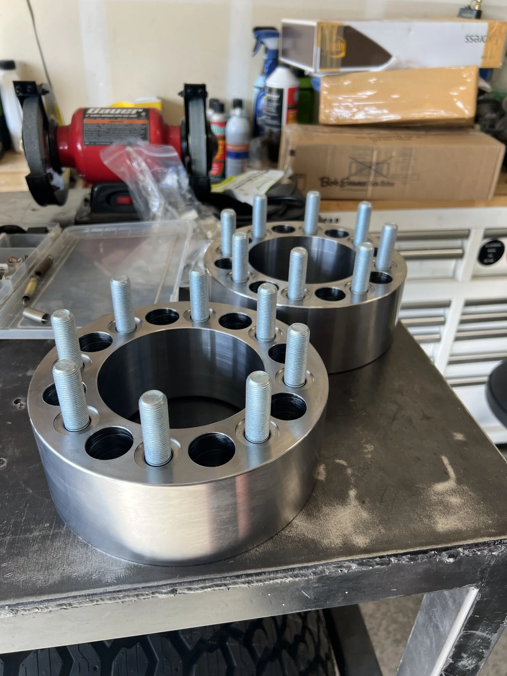

Slowly but surely tires are showing up, 7 weeks out for the rear spacers to arrive…. These will fit real nice, very happy I didn’t opt for 33s.

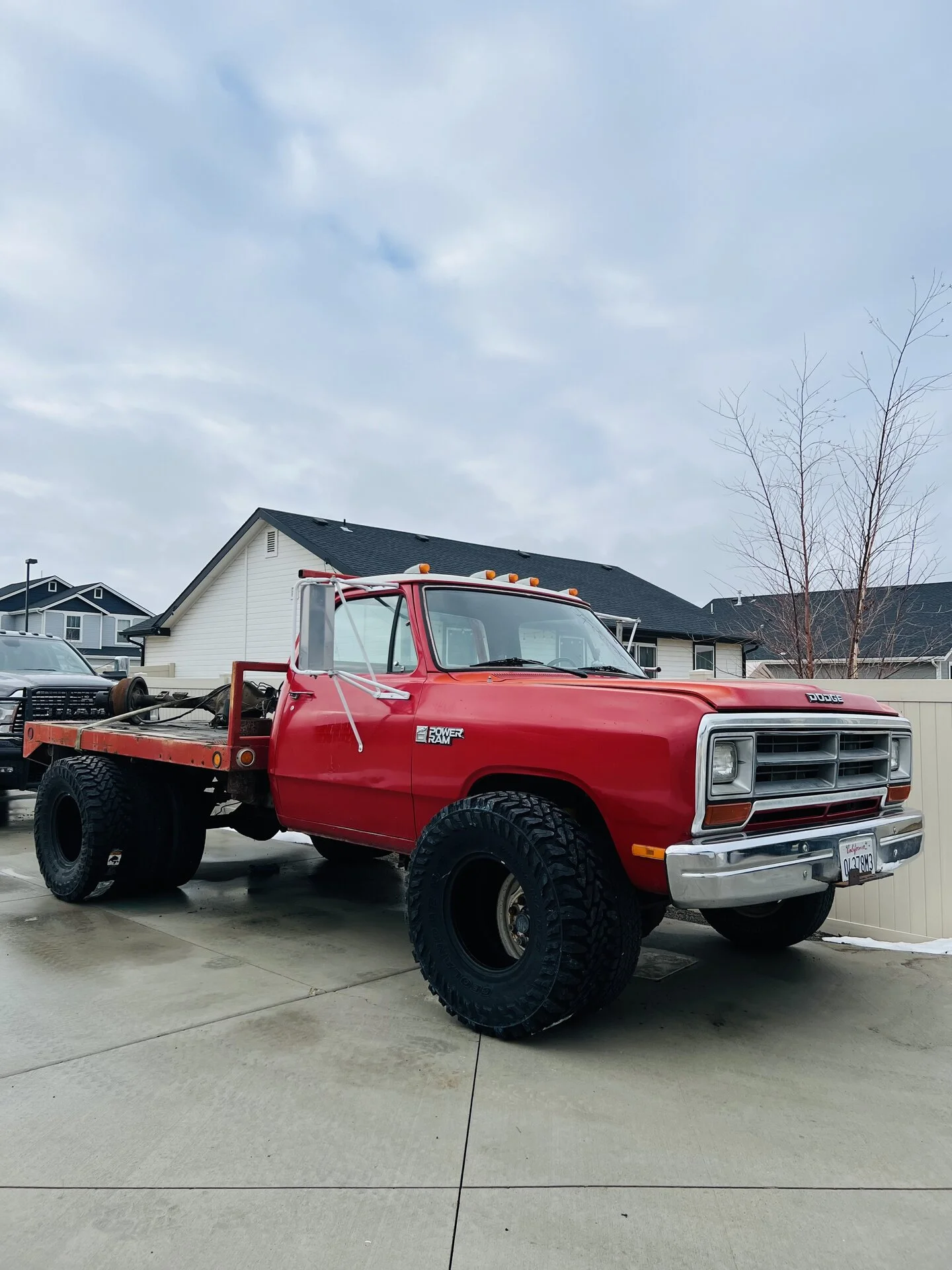

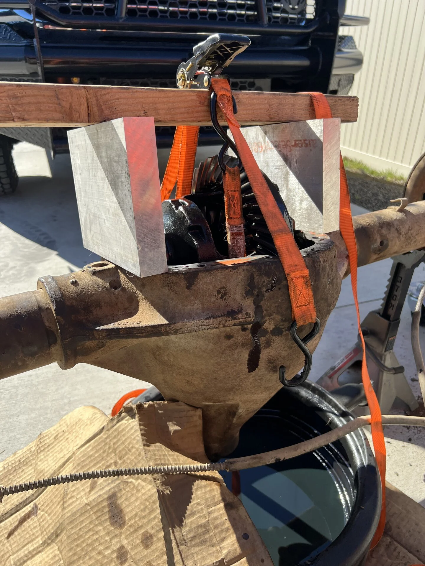

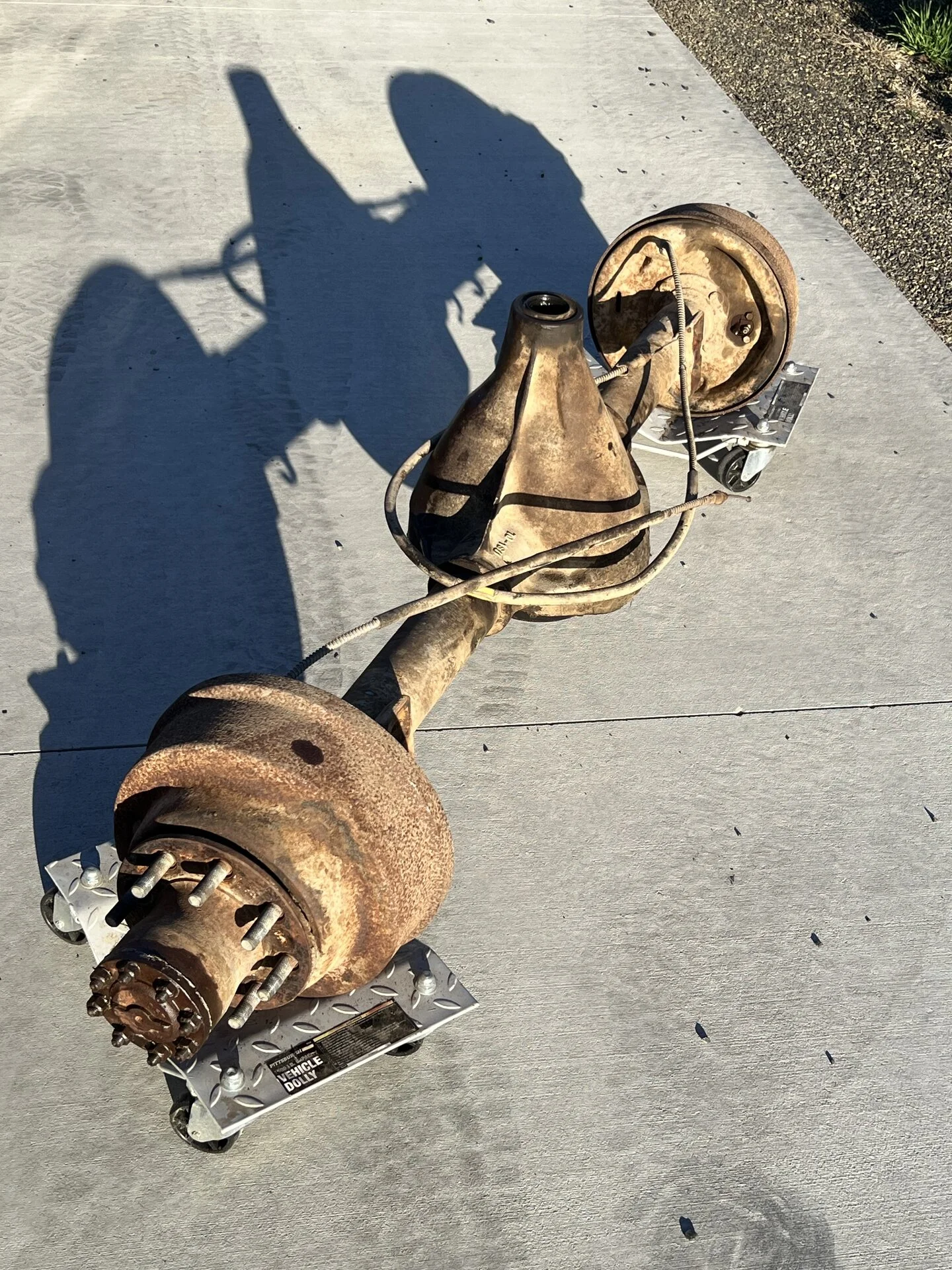

Baby steps....rear axle is loose, I just need some time/light to actually swap over and then swap yokes/install new pinion seal. Once the '93 axle is installed, the rear outers will push out 2.5" then the spacers will kick it another 3"....so for those that are athletes, not mathletes.....5.5" more poke out back.
Good news….no lift needed, but it will get 2.5” front and 1” rear bump.

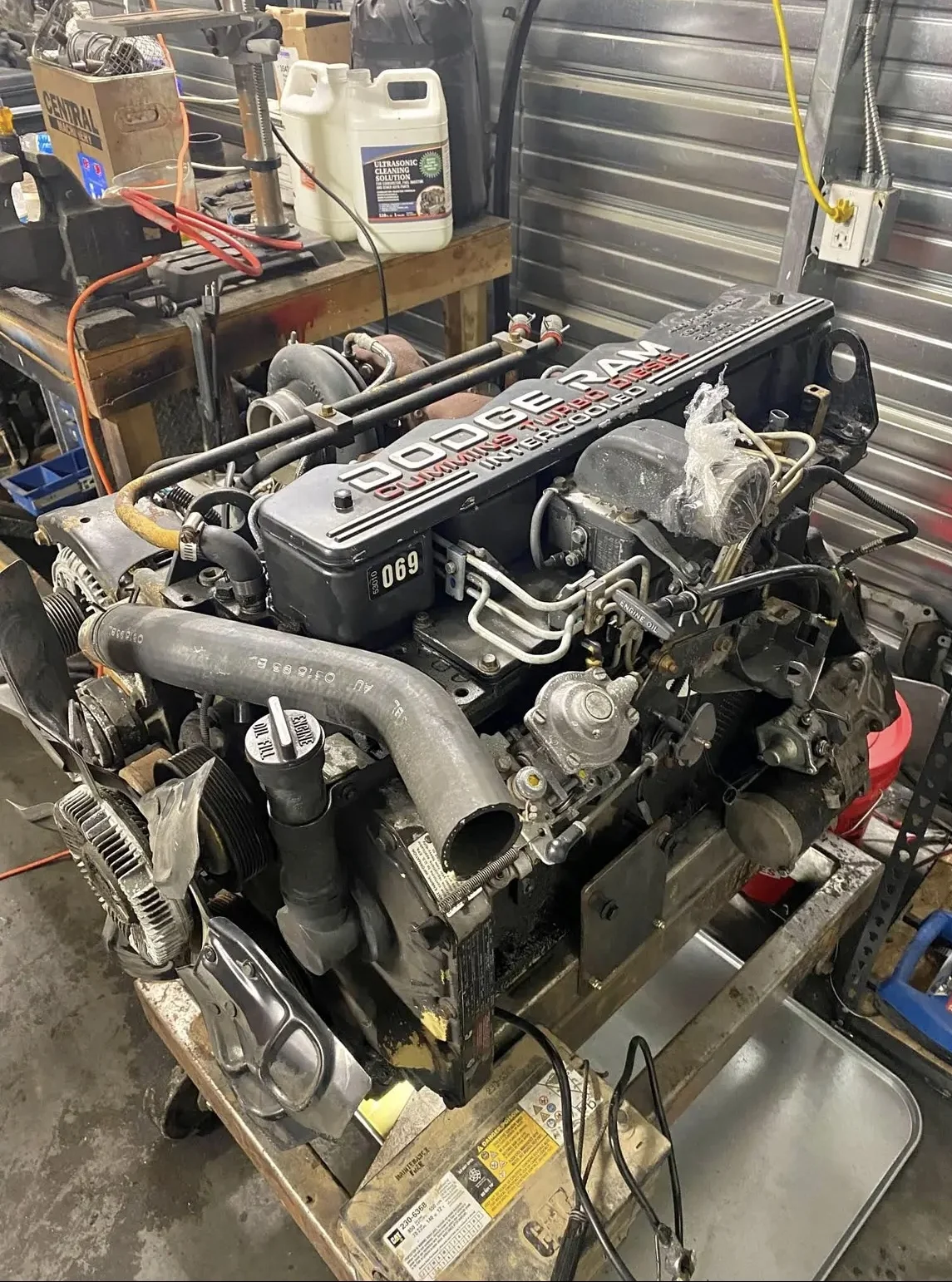

Motor will just get cleaned up , injectors, turn up the fuel with a HE351CW. 900ft lbs is the goal so it’s a nice reliable truck with ac.

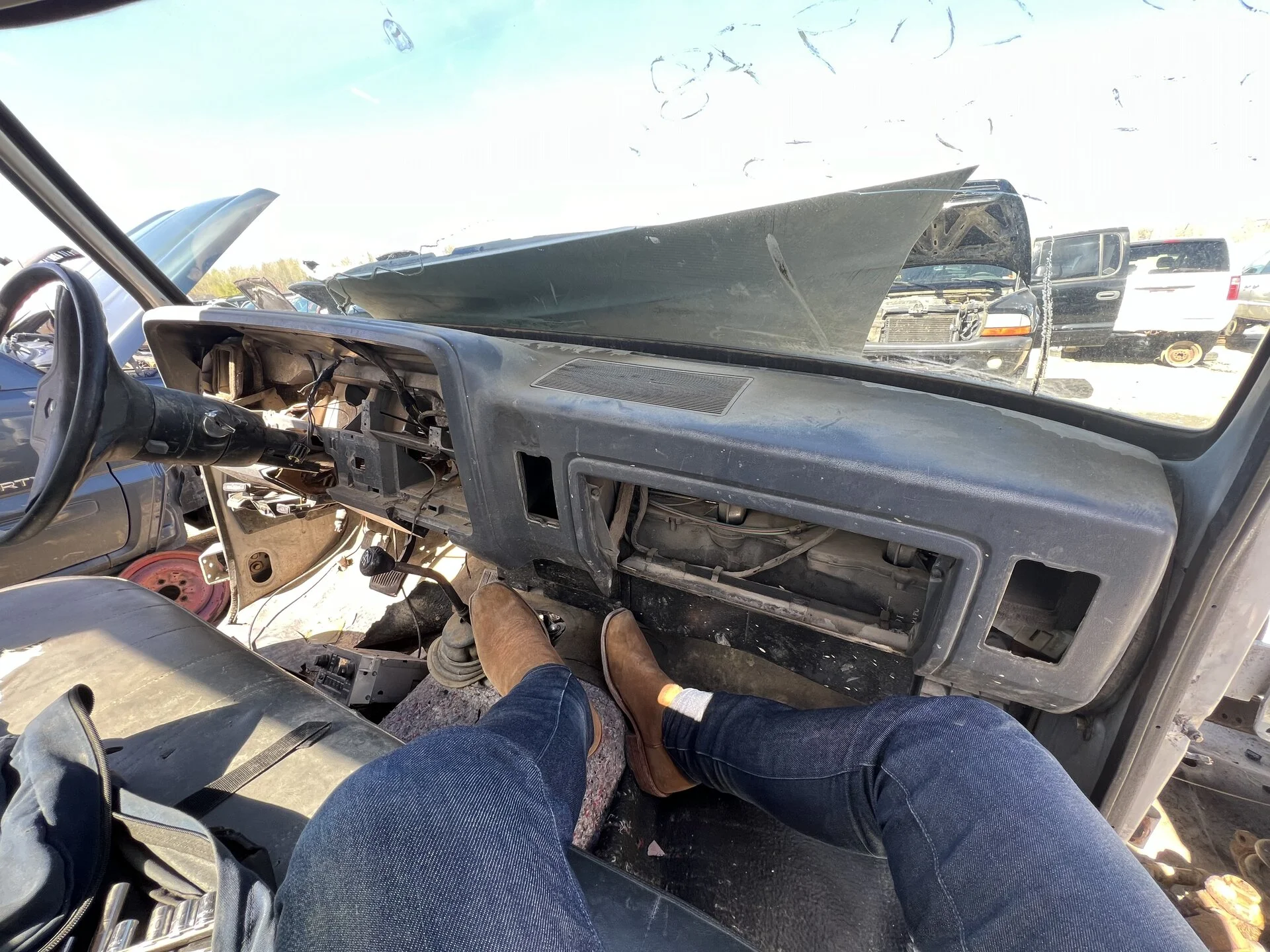

Also found a mint gray dash at the junkyard so I yanked everything to change interior color to gray.

Intercooled 6BT w/ HE351

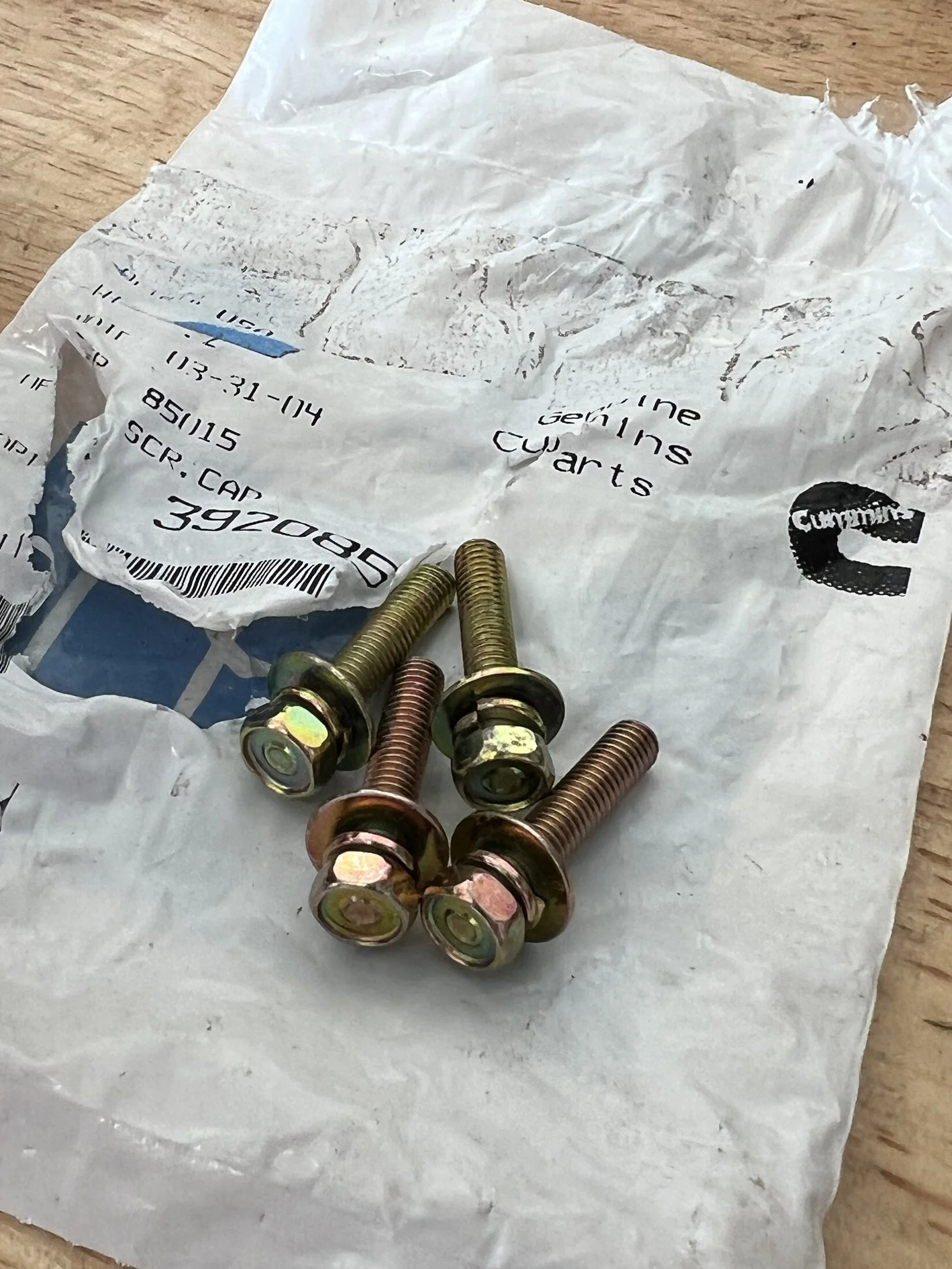

And I found some nos yellow cad hardware….I couldn’t help myself

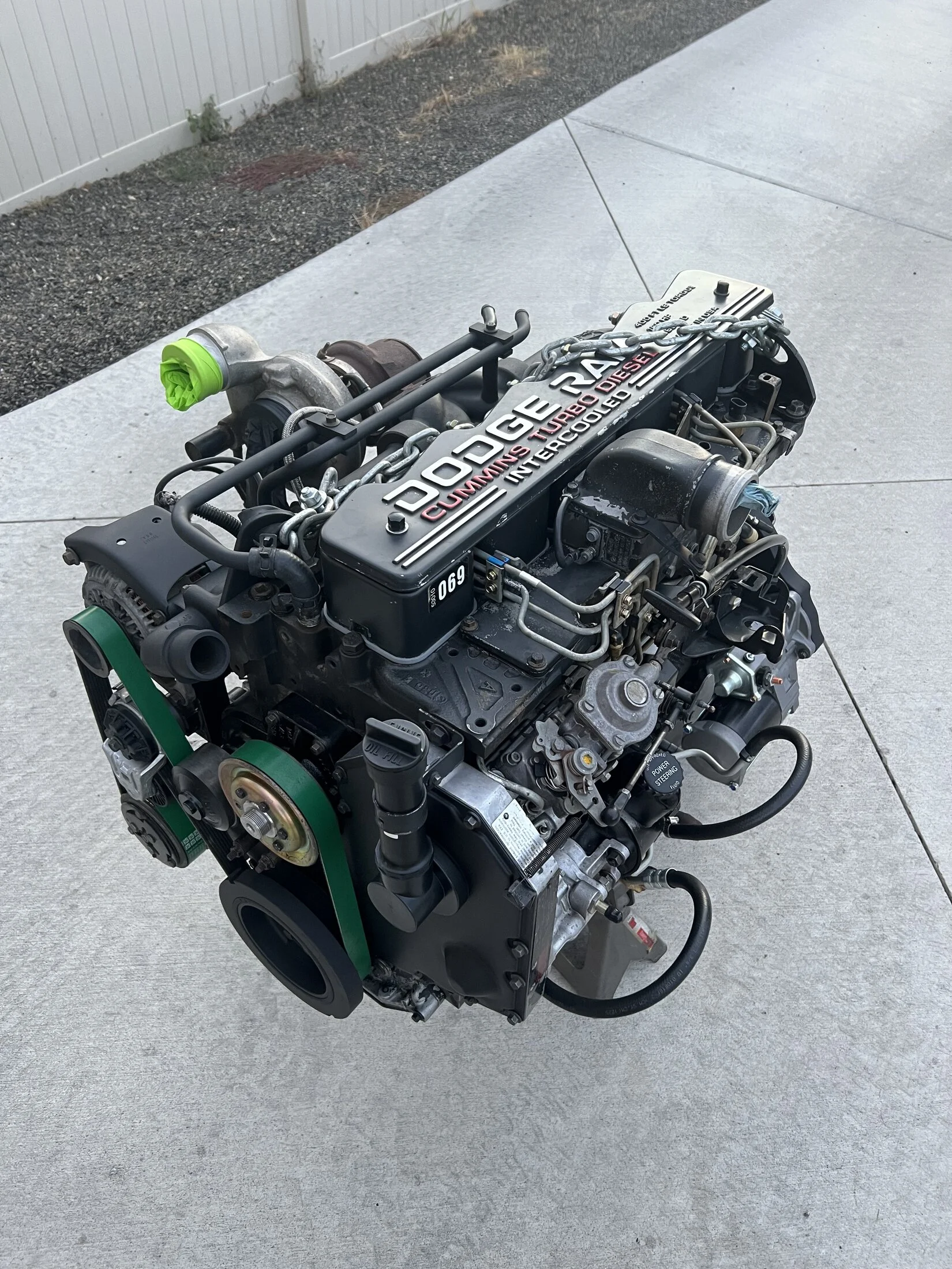

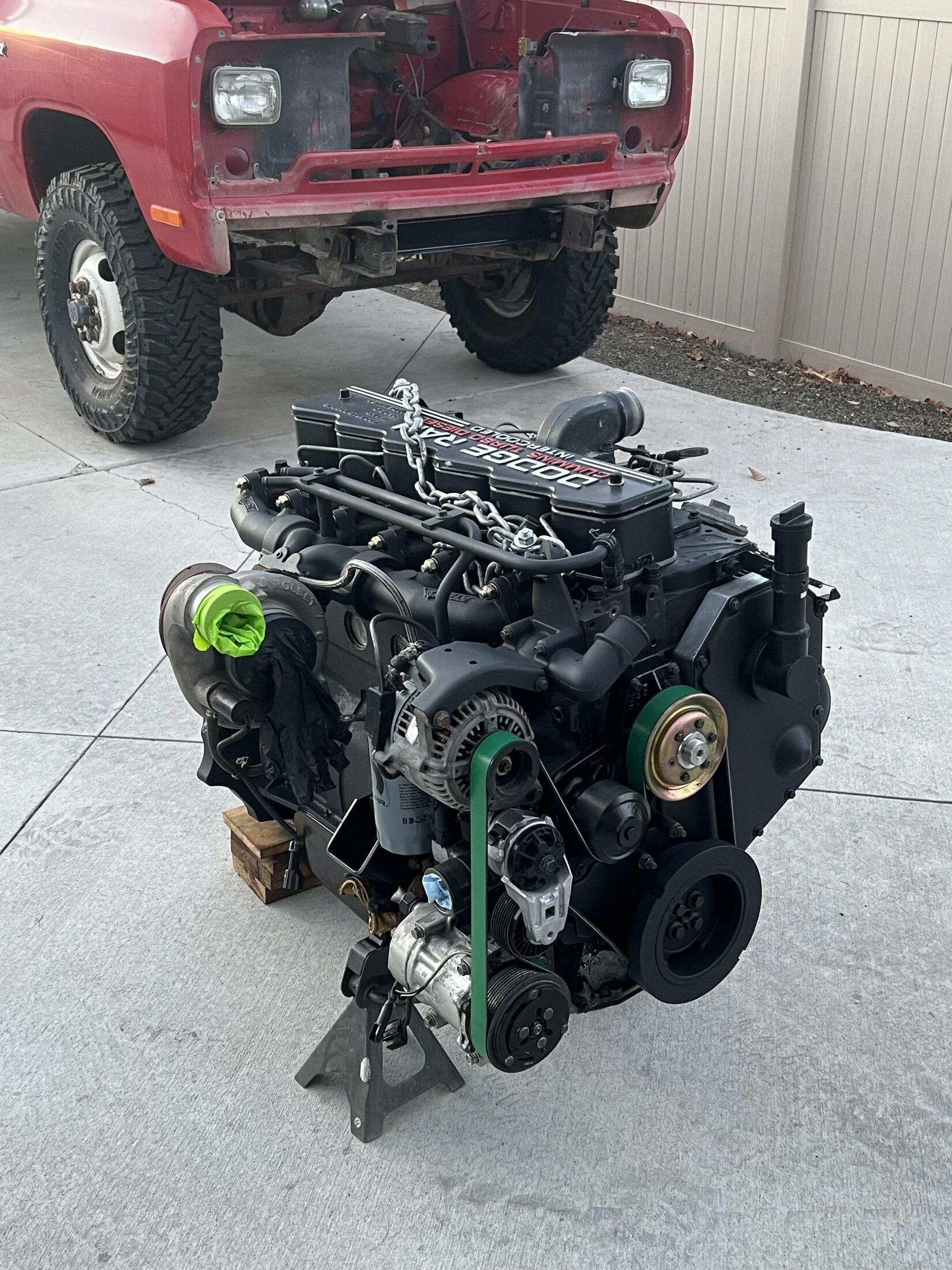

More effort....not a lot of in depth pics, just moving along. Motor is now complete and ready to go in the truck....hopefully this week once the firewall paint dries.
When people complain about the cost of Toyota parts....I recommend looking at the cost of 6BT oem parts....it's higher and made in nearly every country. The castings are quite nice in comparison to Aisin. I do hope that I can get the wiring sorted out - plan is to use the 12v glow system out of a 1HD/HZ since they both share a 12v grid heater.
Still have to clock the turbo, fingers crossed I can keep the factory wastegate without interference......

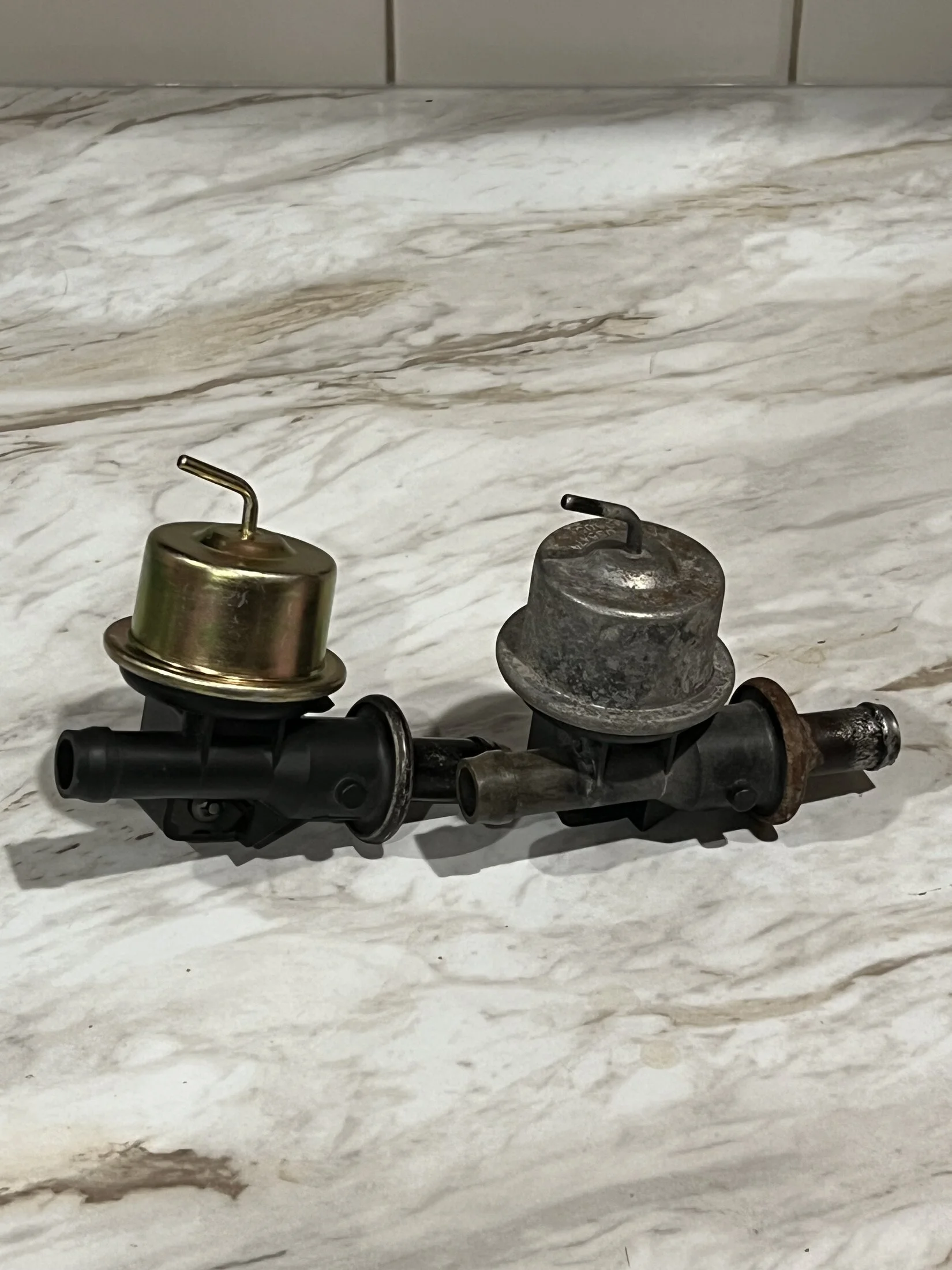

First NOS part arrived for reassembly….
Heater valve! The current ones are junk in comparison. Original still sealed up but since I found this - I preferred not having a leak later.

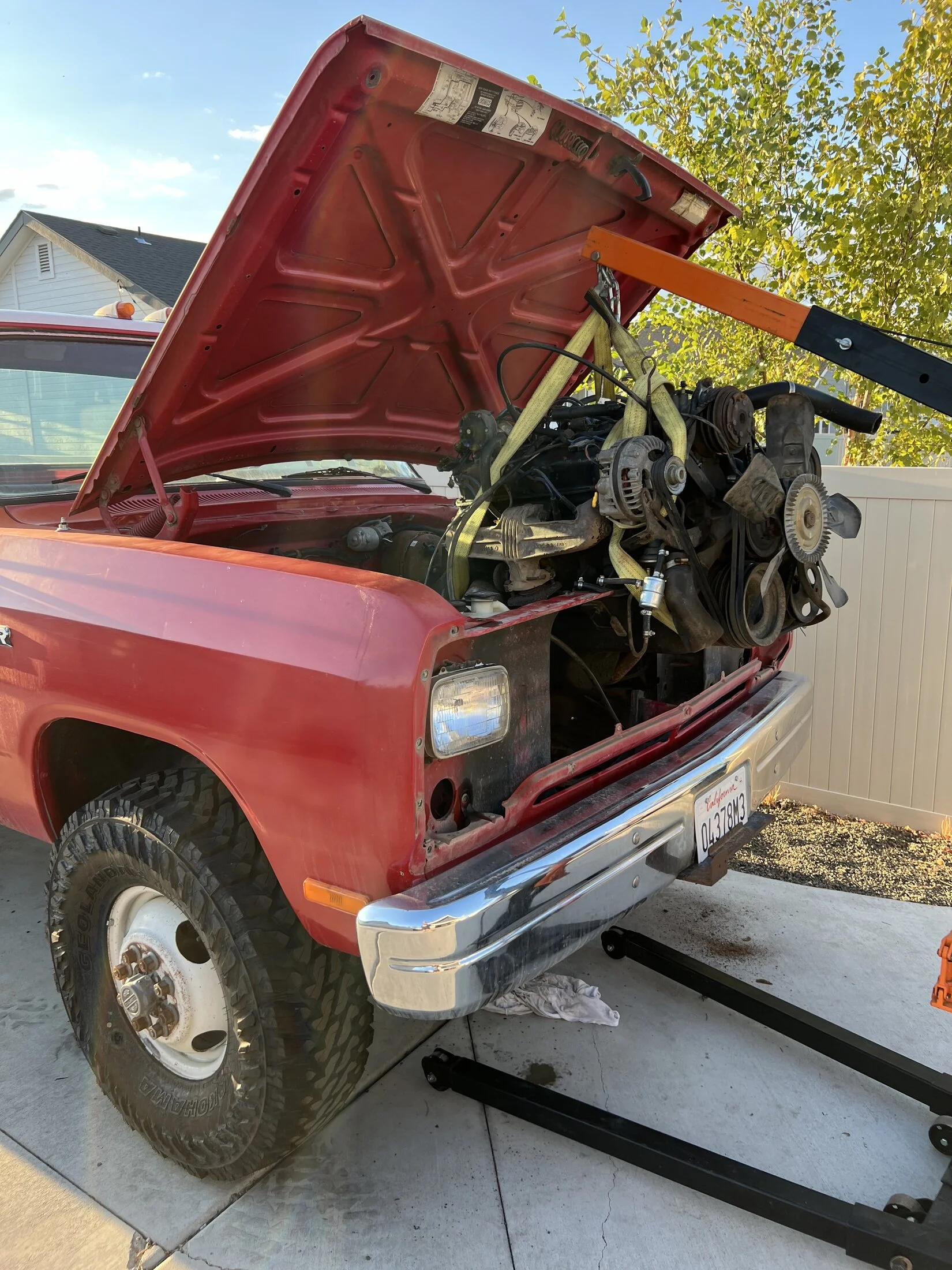

Then the motor came out to get setup to drop in, thankfully @The Machinist and my neighbor were kind enough to lend a hand while setting it in….no pictures though, it was dark.
Thankfully the motor has both Nippon Denso alternator and a remanufactured Denso starter….just need to start hashing out this Toyota glow system next.
