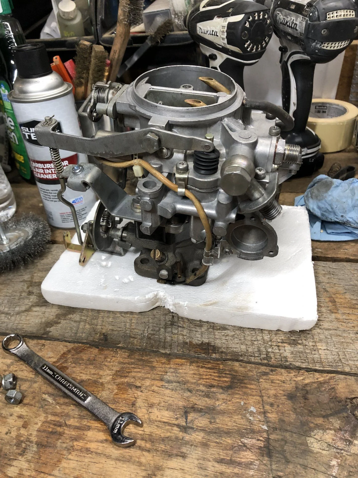

- Sent 2 of the 4 carbs to @FJ40Jim to be rebuilt into one "bionic carb"

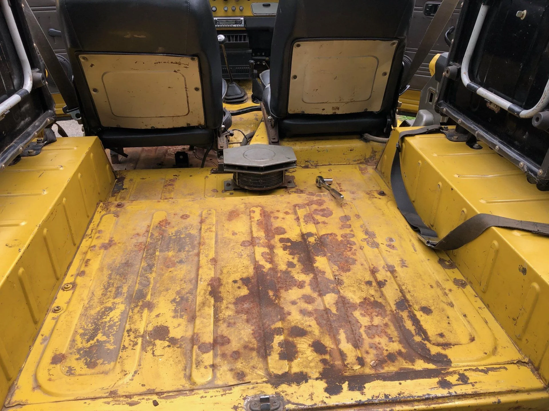

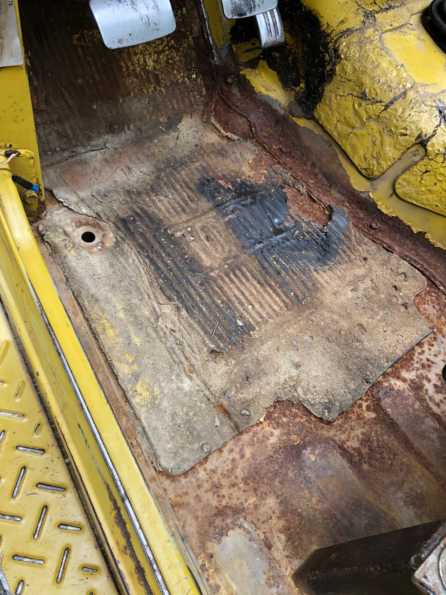

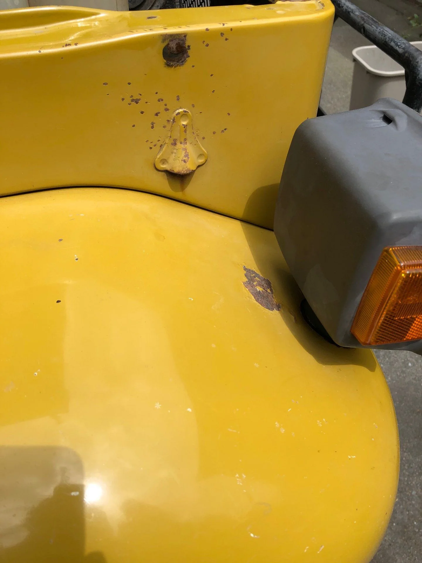

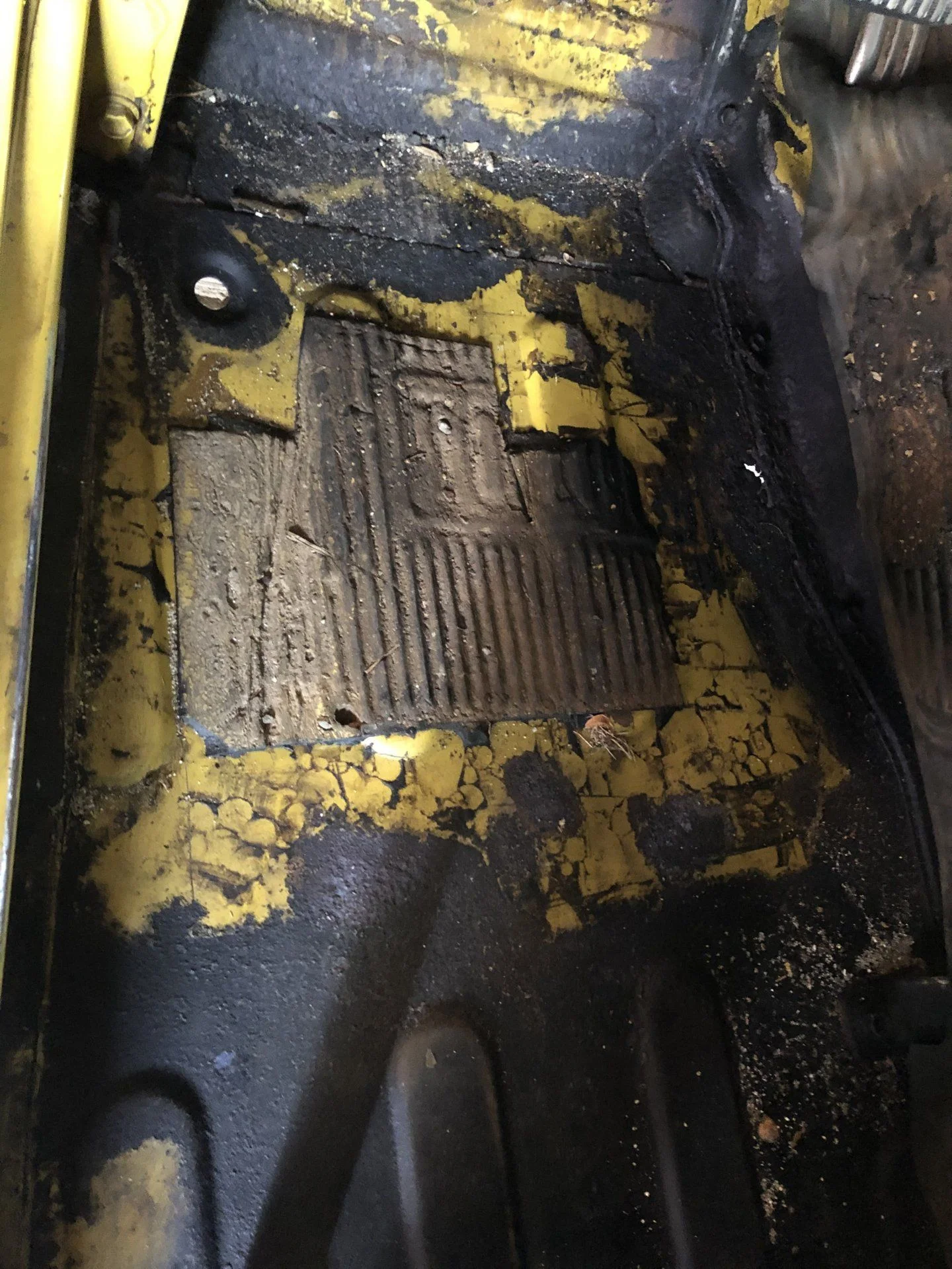

I'm very scared about what the salt air and humidity of Rhode Island will do to it. I'm lucky enough to live a couple blocks from the beach. Years down the road I'd love to do a frame off resto, but that's not in the cards soon. In the meantime, I'm debating rust prevention/mitigation options.
For the frame, POR15 or Rustoleum Rust Restorer or FluidFilm? Not planning to wire wheel the whole thing, much less take the tub off
For the body/painted surfaces, including interior, CLR and some carnauba wax?

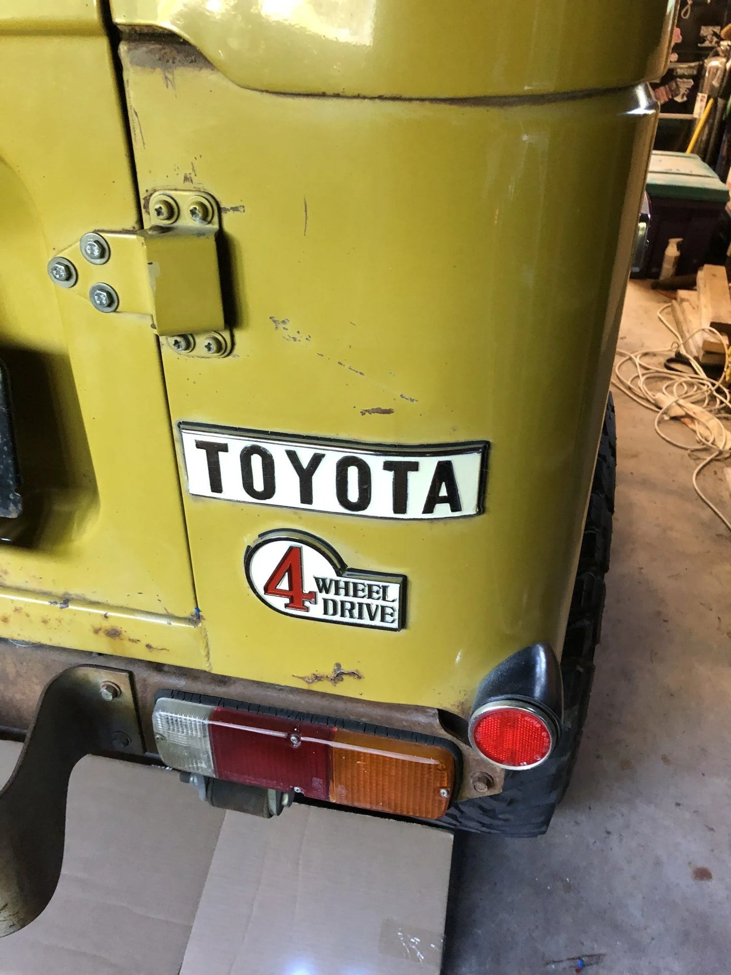

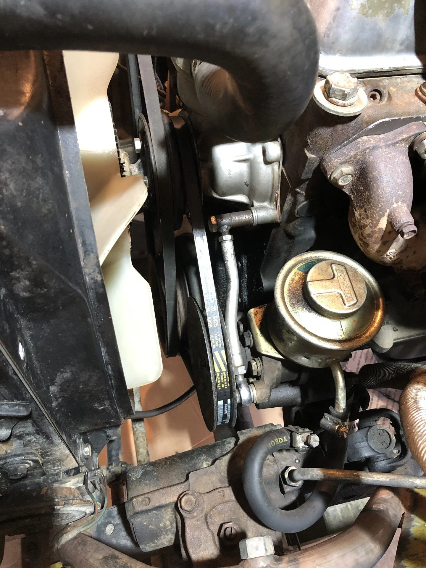

I fixed the horrible PS whine by putting in a new belt that goes around the crankshaft and water pump, not just the water pump pulley and PS pulley. That was a win.

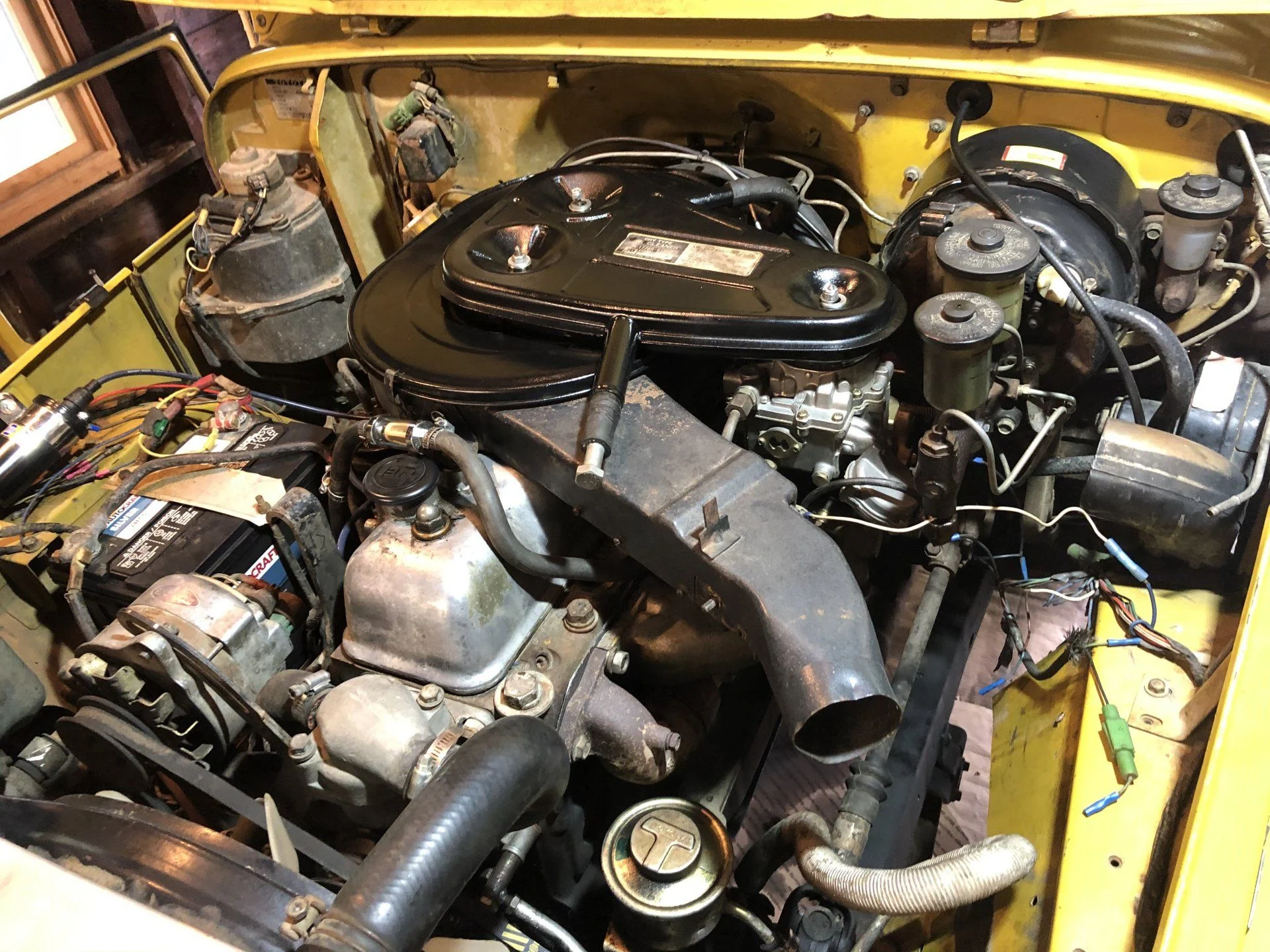

Repainted the original air cleaner cover and reinstalled. Need to find a replacement for the gasket between that and the carb though. Also put in that new belt that eliminated the whine. But you can see a suspicious bolt and washer combo in the top right on the head. It's standard, not metric :oops:

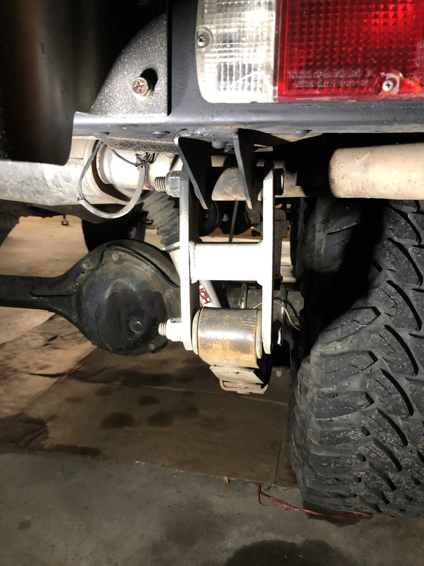

1. It looks like your rear spring shackles have been over-tightened, bent in on the spring bushings, this will keep them from cycling properly, soooo you'll get a stiffer ride.
2. With your floorboards soooo rusted, my guess is the bottom of your gas tank may also be ready to die from cancer. If I am right, then you'd be prudent to consider one of my 22 gallon rear fuel cells, they mount under the floor panel behind the rear differential, and they are nylon, won't rust ever.

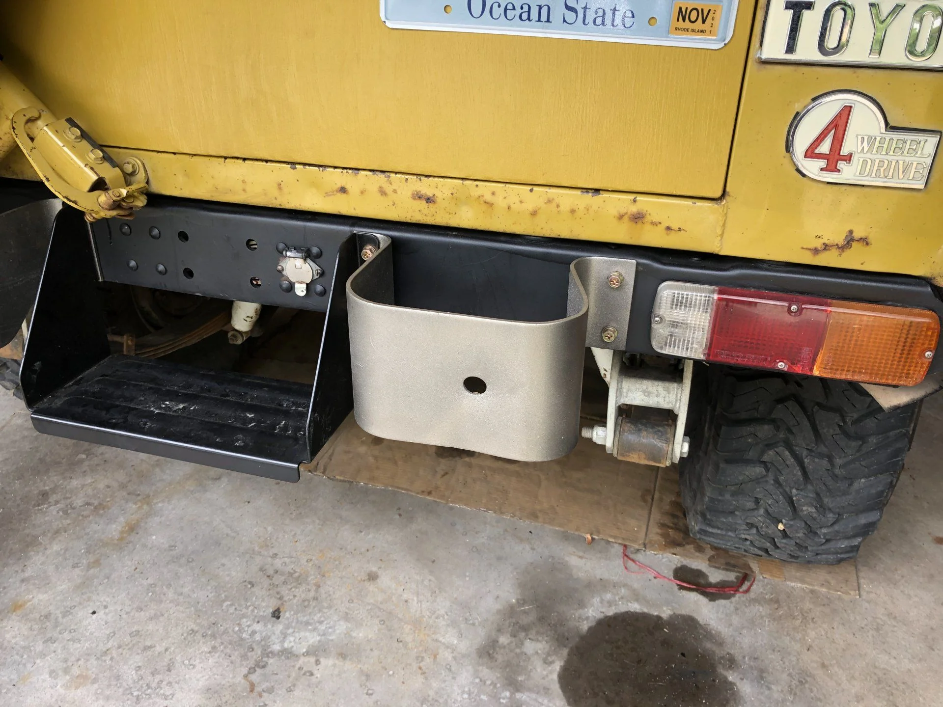

What was the process you had for the rear bumper (cleaning and painting)? I'm in almost the same boat as you (78, Mustard) that I'm doing some cosmetic updating on and would like to clean up my rear bumper as well as the front.

Just seen the Toyota power steering pump in the stock 40 series location. Looking better at the pictures see the steering box is too far forward for either 40 series or mini truck power steering box. Does not look like a 60/62 series. I know the International Scout mounts they but look like could be a Toyota box. Tercel may be correct.

@78Mustard For the bumper, I removed the bumperettes, tail lights, and tow hitch receiver, wire wheeled it as best I could and used Eastwood's Rust Encapsulator, then their Extreme Chassis Black. This was very helpful in deciding which product. Encapsulator vs Convertor I went with Eastwood mostly because I don't have a paint setup and wanted cans. But POR or even rustoleum rust restorer would have probably been fine. I used Duplicolor Pewter Metallic for the bumperettes, though it's not a great match to the OEM pewter. The color is about right, but it's sparkly (I guess that's what they mean by metallic). But overall, it was a one night job and looks much better. Expect the bumperette bolts to sheer off. I ordered replacements from SOR that are similar to OEM, but not exact. They are held on by square nuts on the back that are perhaps tack welded to the frame, or were just heavily rusted on. Definitely hit the bolts and even tail light screws with PB Blaster a day or more ahead of time, maybe even a few days in a row.

Yeah looked up all the engine stuff, it's a '73 from an FJ55. My concern is the installation, marriage of motor to valve cover/manifold etc and quality of rebuild. That big standard nut with a giant washer gives me the creeps. Once I get my nice new carb back from @FJ40Jim and installed, I'll see if I need to do anything with the motor.

I loosened the bolts on the shackles @Downey, had been on my list but thanks for the reminder! I’ll see if it rides better tomorrow.

Sweet, another mustard 78, not too far from me, just a hop across the sound, eh? If it were me, I'd just be squirting in gear oil (I get it, not ideal and smells, but it penetrates) into the underside of the rear sill, rockers, rust prone areas to have it lap it all up. It will help!

Yeah, I’ve been admiring your builds in fact, nice work. By gear oil I assume you mean like fluid film? If so, I think you’re right. Be great to cross paths, just came across a ‘76 yesterday in northwest Maine, so there are a few in the northeast.

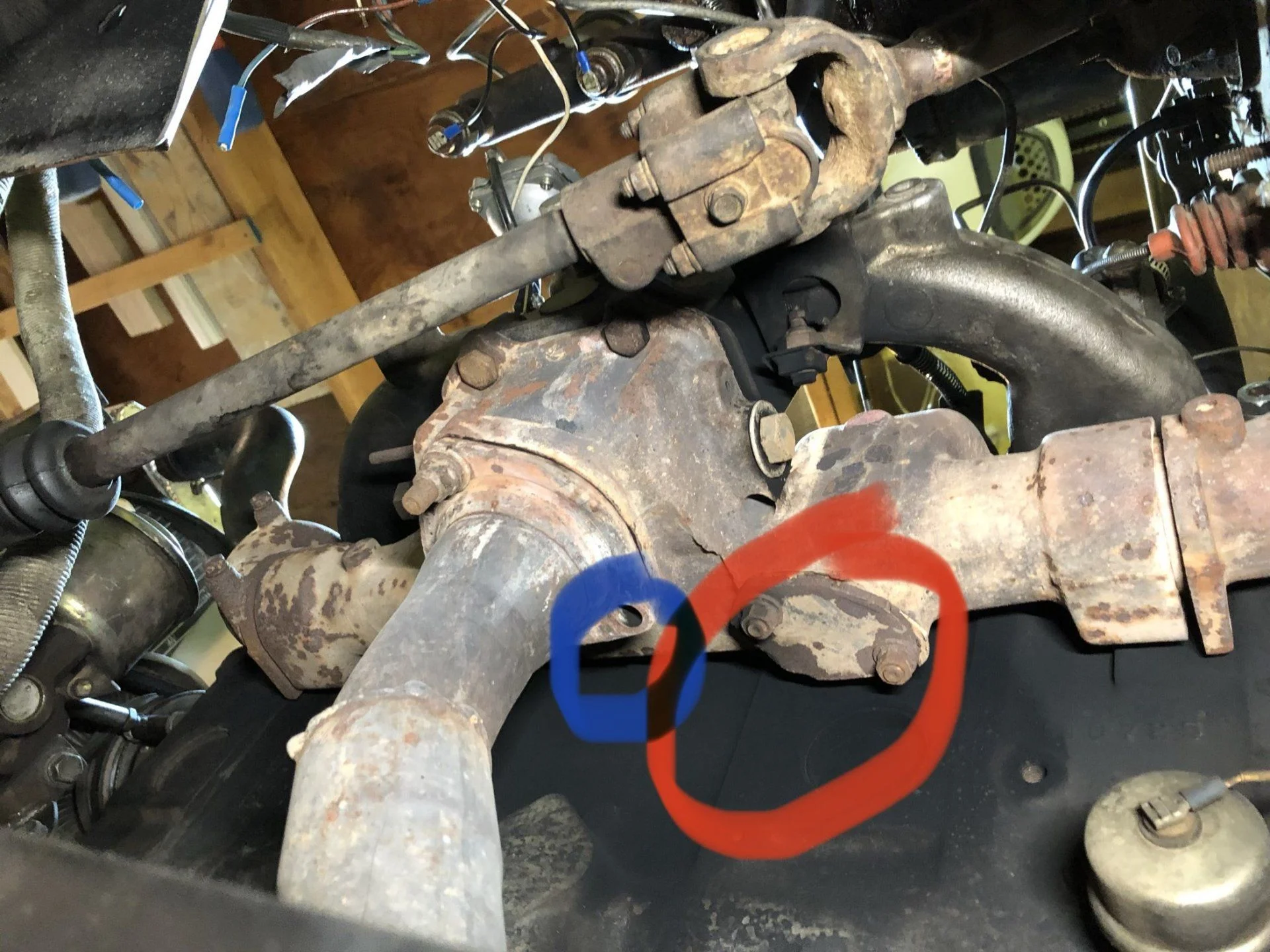

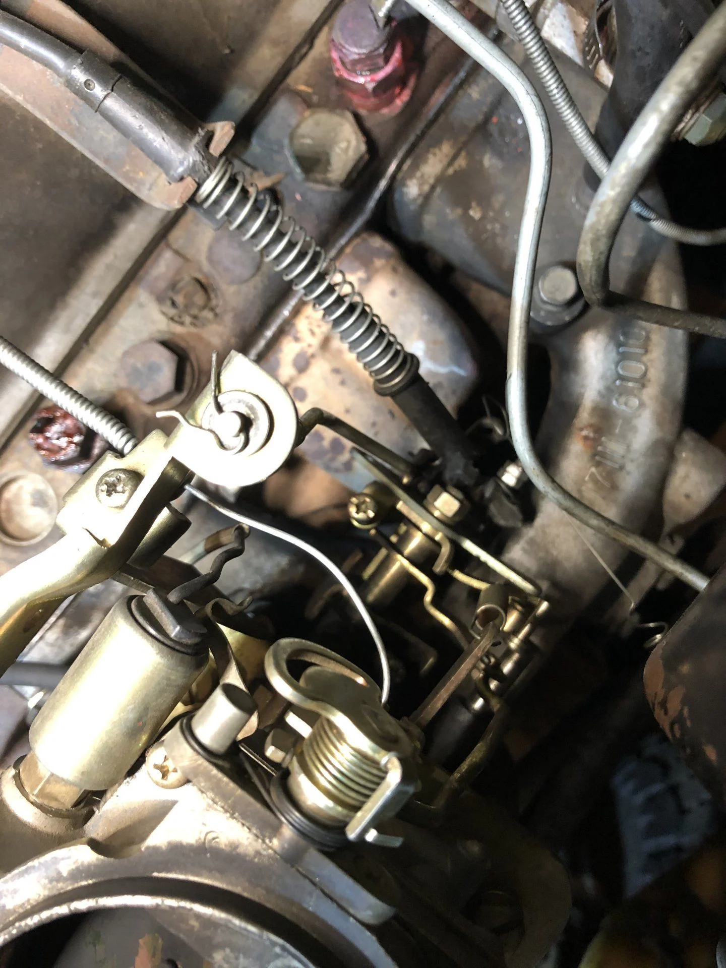

Big day today. Finally got my carbs back from Jim C and I was jumping like a kid on Christmas. Looks like he did a great job. Also got some de-smog parts, now just gotta figure exactly where they go. Looks like the PO did an EGR block off plate, but the one from Jim looks much better. Goes in the red circle I think. When in there, I noticed a bolt missing (blue circle). Does that matter? Also seeing lots of soot, exhaust getting out?
Figure I’ll do this then do carb swap next.
oh and check out the zip tie job on the 3rd photo
