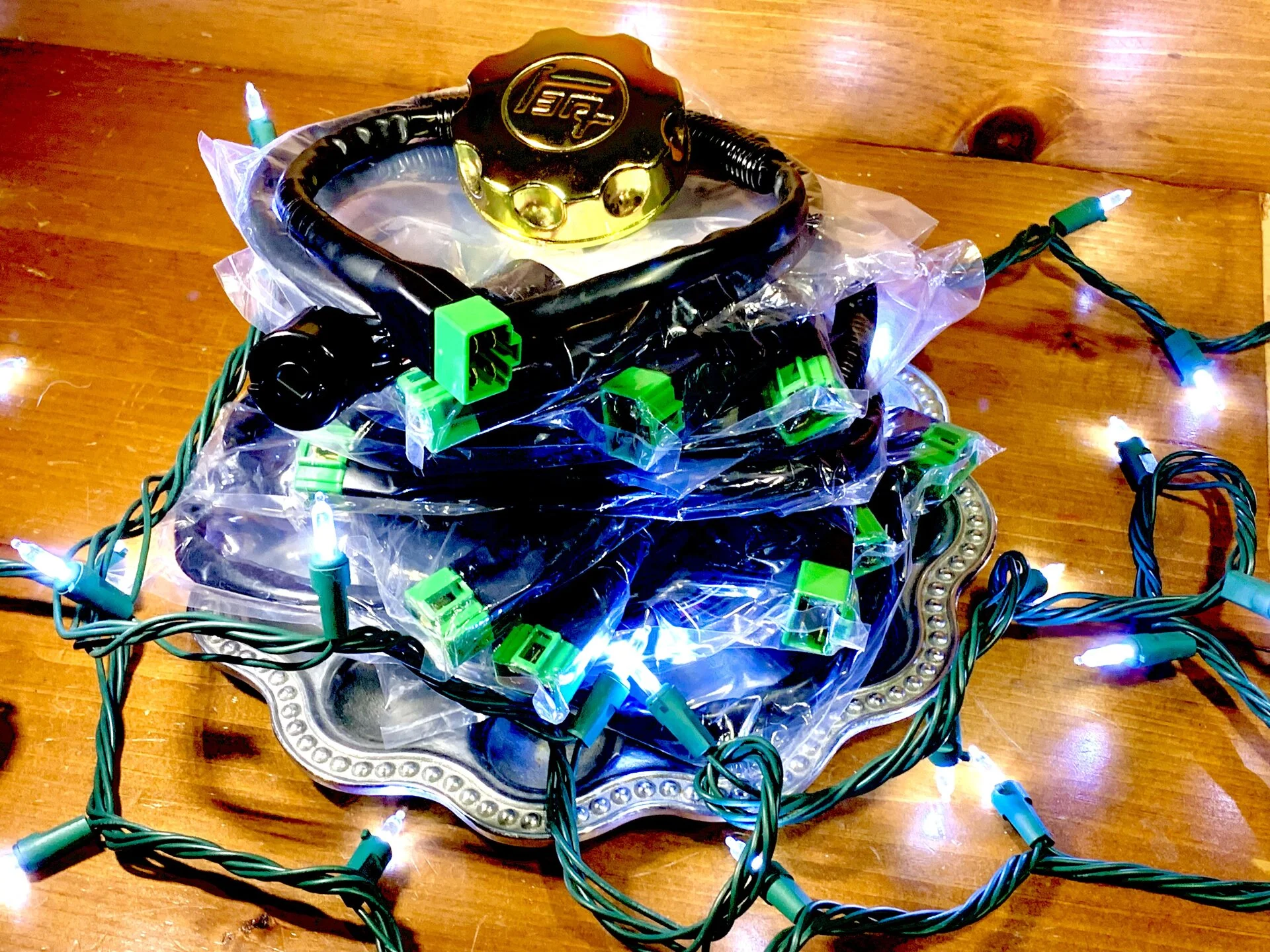

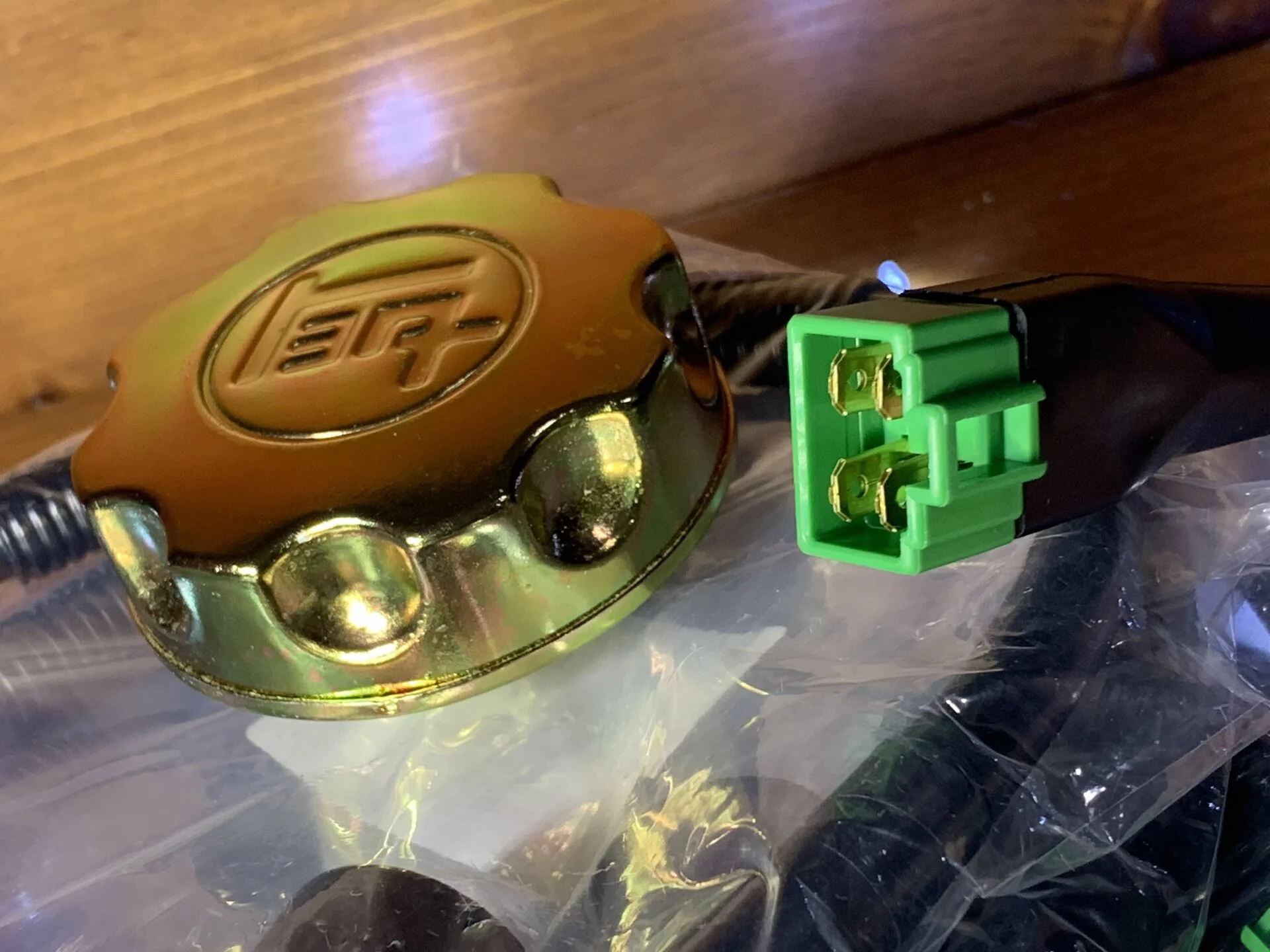

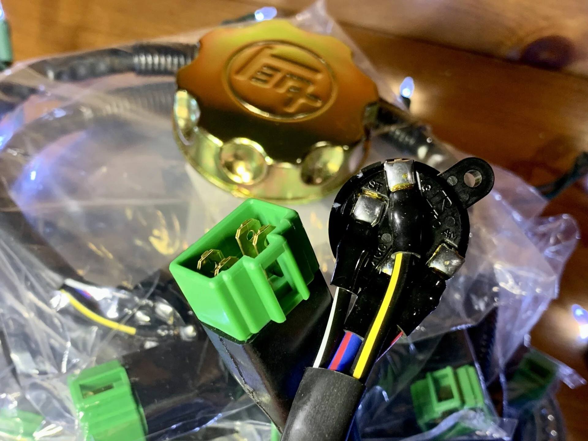

checking-in inventory can be interesting sometimes , especially on a Saturday night on the weekend ...

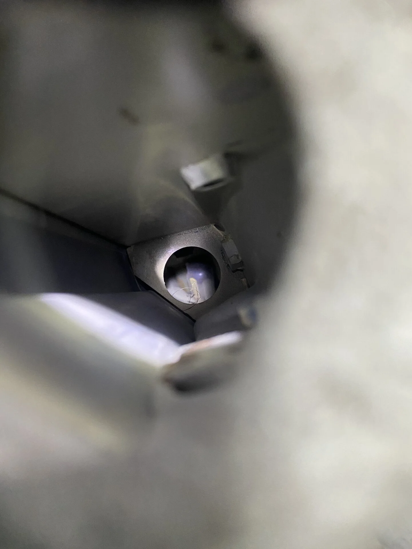

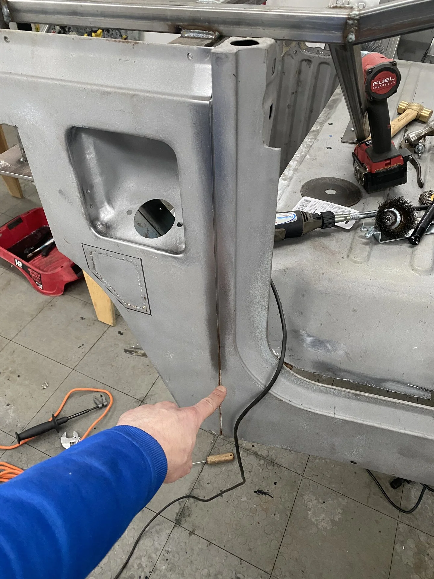

Still in body work purgatory. Opening every cavity to clean it out and remove rust before I start re-assembly. Found some PO had dropped a screwdriver down the post hole for the hard top. I played the most excellent… Wild Stallions! game of operation and retrieved it. No way in hell I’m letting some Philips Head screwdriver violate my restoration. I may have left it if I knew it was a JIS.
View attachment 3226158View attachment 3226159View attachment 3226160

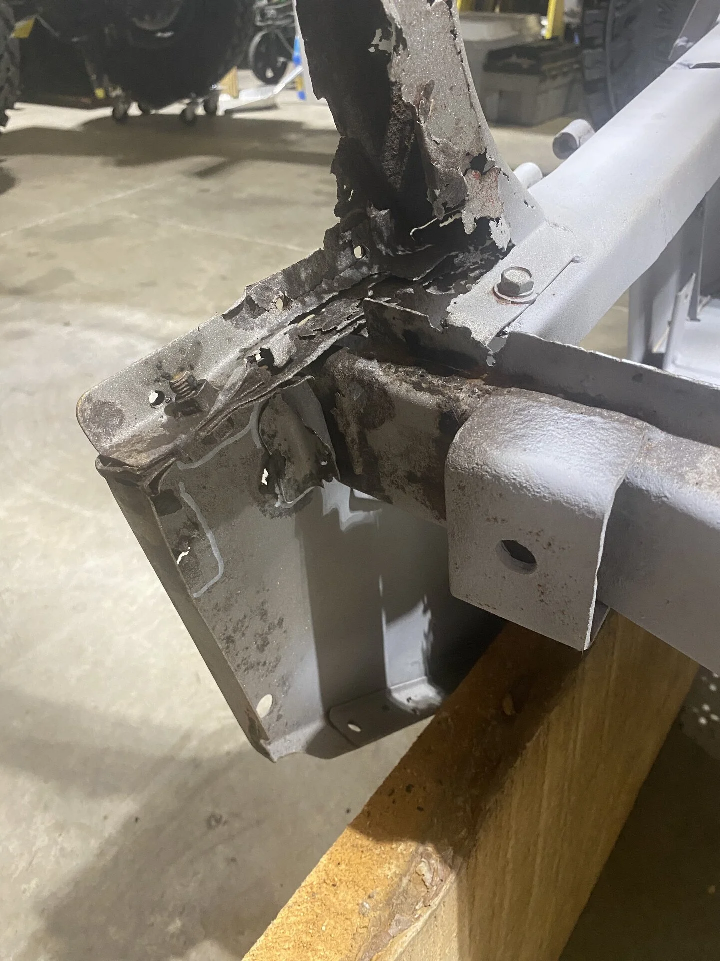

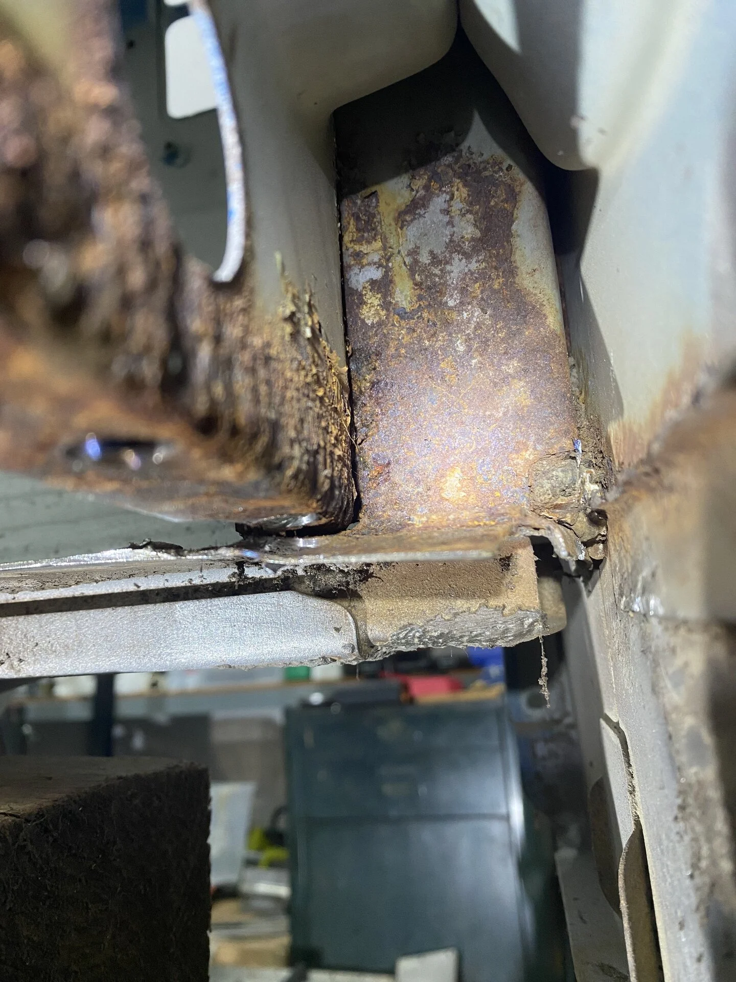

And a couple of rust photos for fun.
View attachment 3226163View attachment 3226164
Two public service announcements: 1) do not put any undercoating or bedliner type product under your 40. It just traps water and causes more rust (my opinion, take it or leave it) and it makes repairs more difficult,. 2) this is a my bad situation. I sandblasted the tub. Don’t do that. It gets into all the seams and cavities and isn’t worth it. If I had to do over again I would have the tub chemical dipped. Oh well, next time.

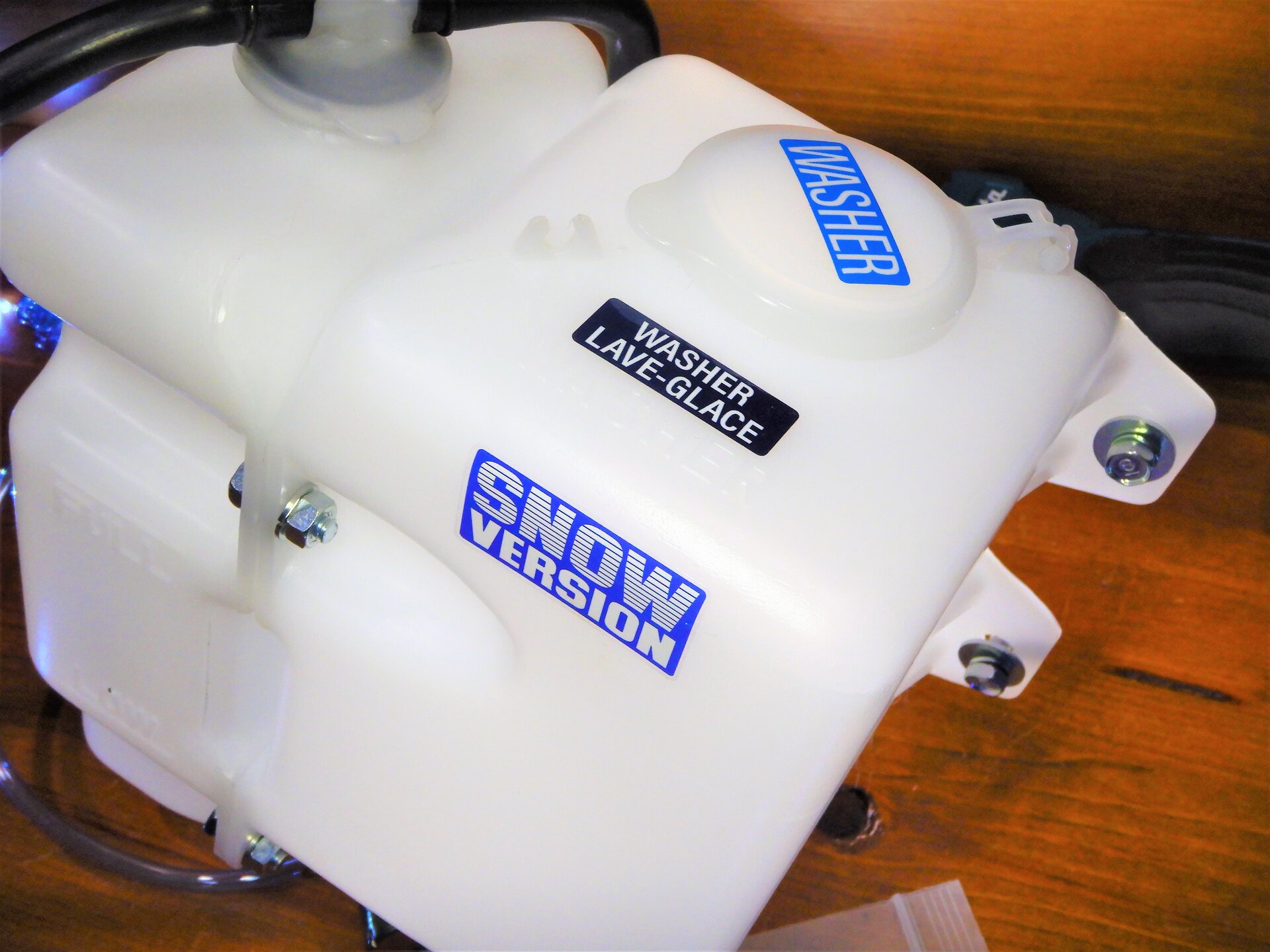

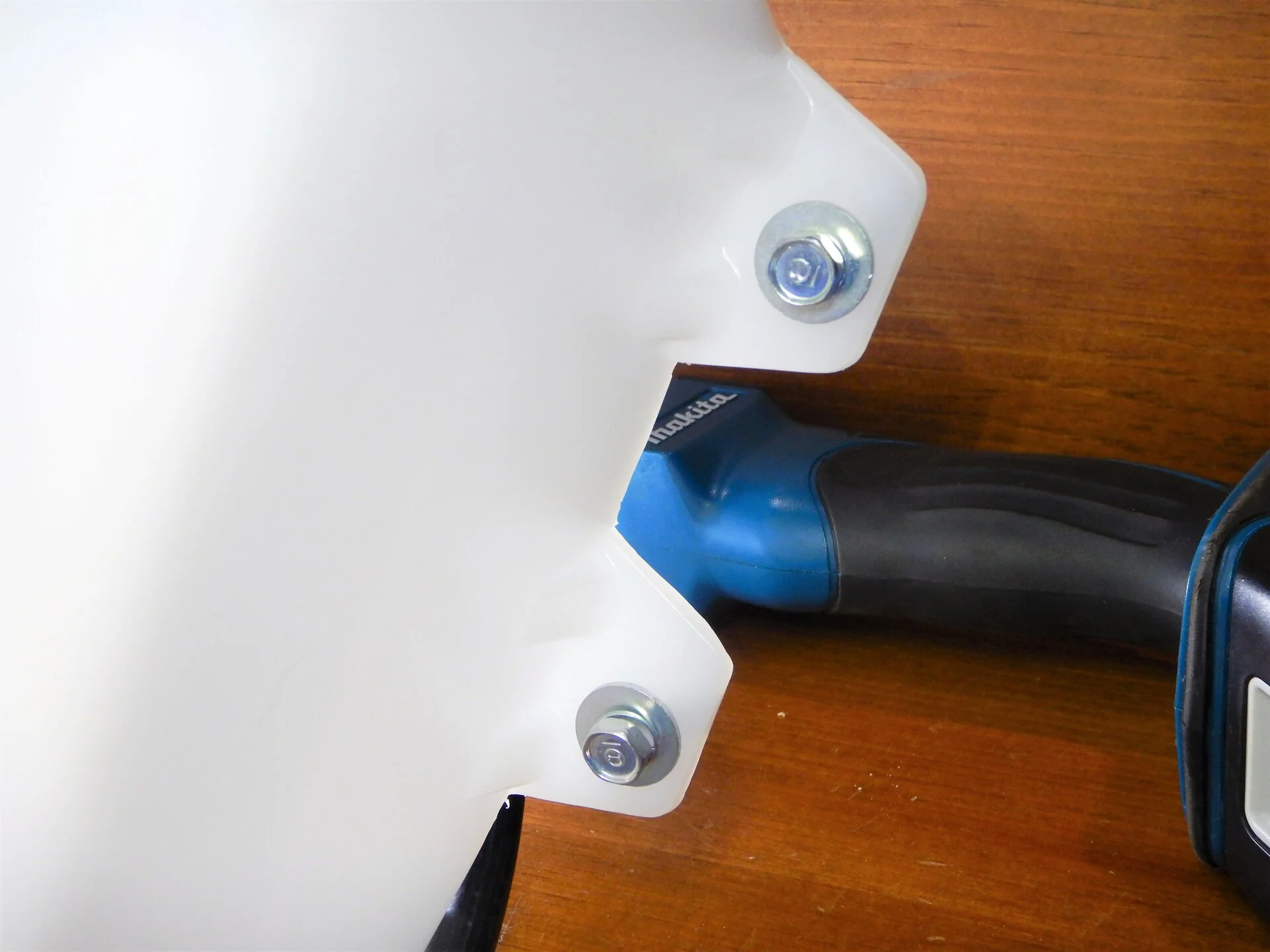

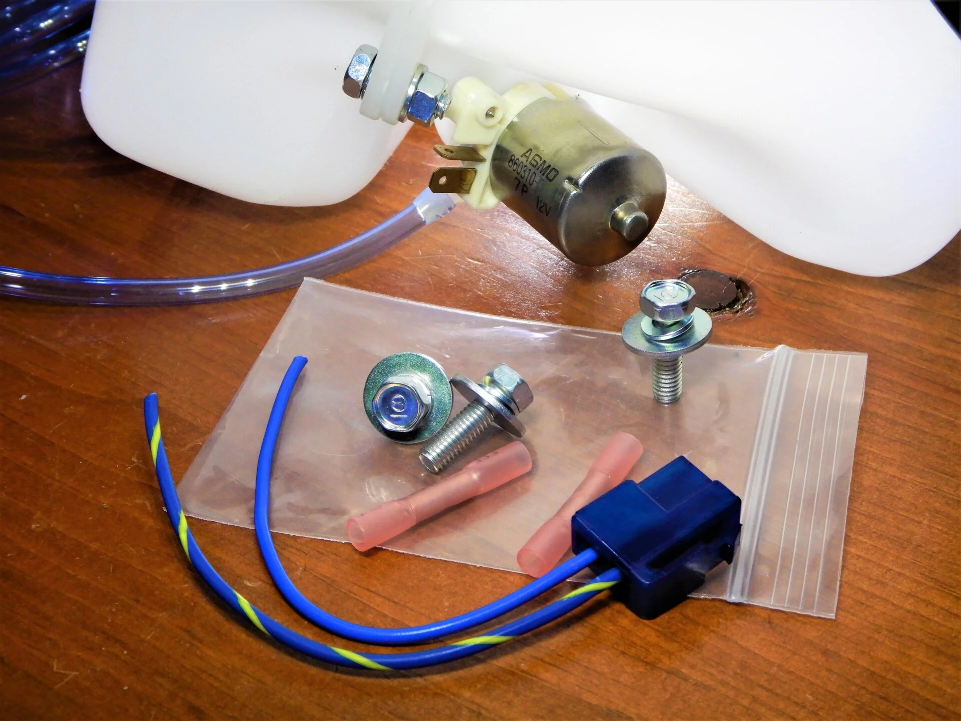

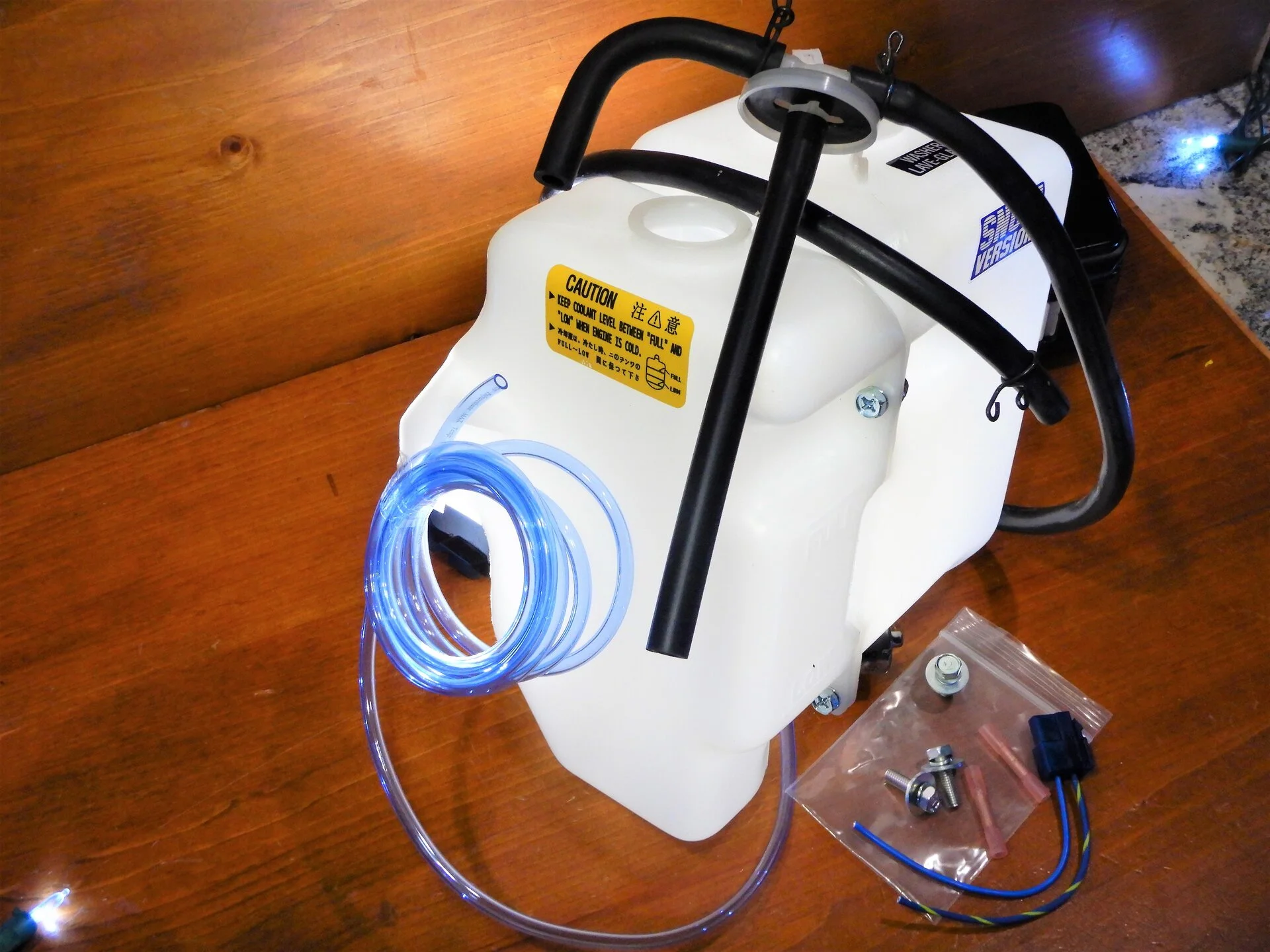

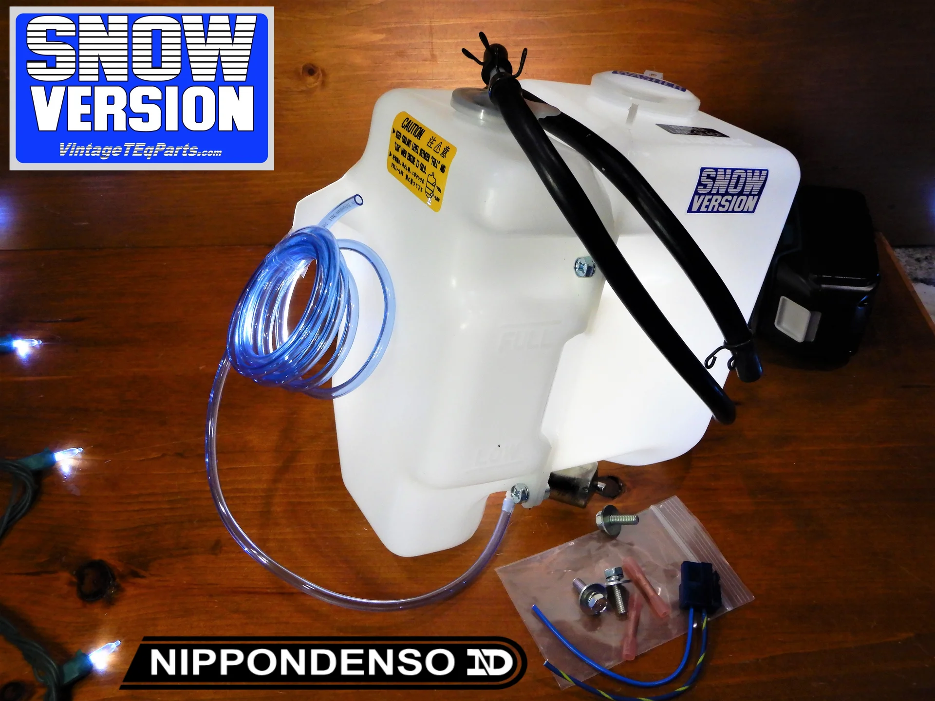

the final rendition of the most Heavy Duty Tough as Nails late modle 40 Series 9/77-10/85 double tanks set coolant over flow and washer bottle reservoir i can pipe dream up and design a few key features to apply our new in-house SNOW VERSION label and TAG to it ...
they include :
- Made in JAPAN heavy duty OEM pump motor assy. ( This IS NOT your Grandmas Auto Zone Trico China Ghetto Trash )
- upgraded stainless steel mounting screws used to mount the pump motor to the bottle it-self
- a much thicker & special hard shell plastic OEM TOYOTA NON-USA Cold Spec. washer cap
- our reproduction OEM UV rated Blue Tint washer pump hose , ( 3' feet included )
- #8 mark head Silver Violet Zinc Plated qty x 3 double SEMS wide fender washer equipped mounting bolts ( the silver violet plating has the highest salt spray test rating ....fyi )
- our over flow suction hose is a thick wall EPDM rubber that WILL NOT snap off in extremely cold or hot weather like the stock white plastic ones do ....
- so that's how i approached offering the best possible and longest lasting service life 40 series washer & coolant double tanks set-up bottles on the planet ..... :cool:

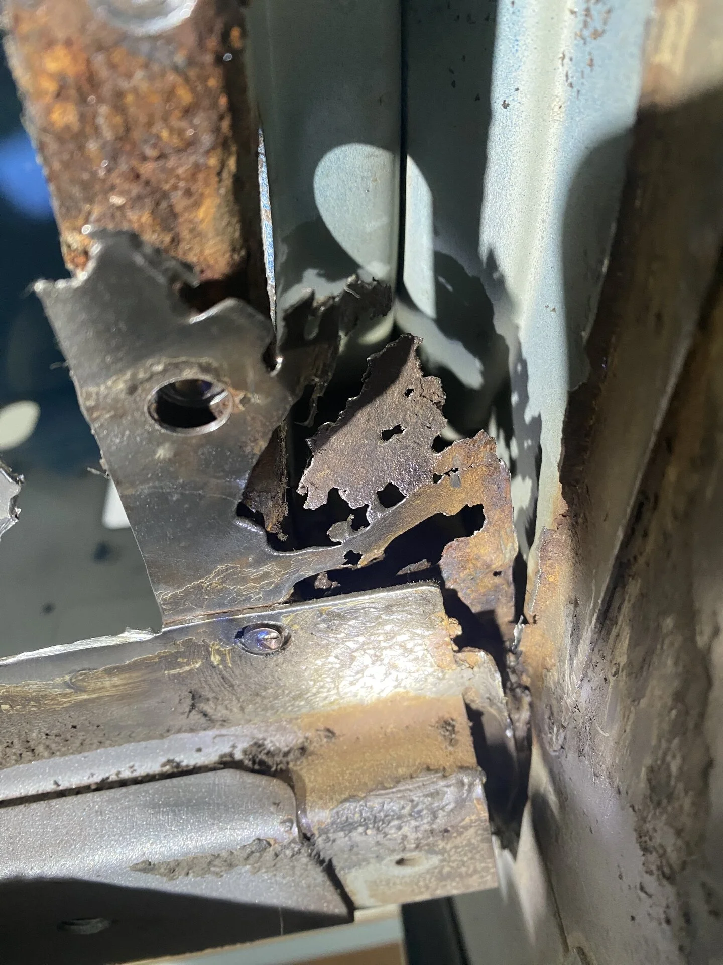

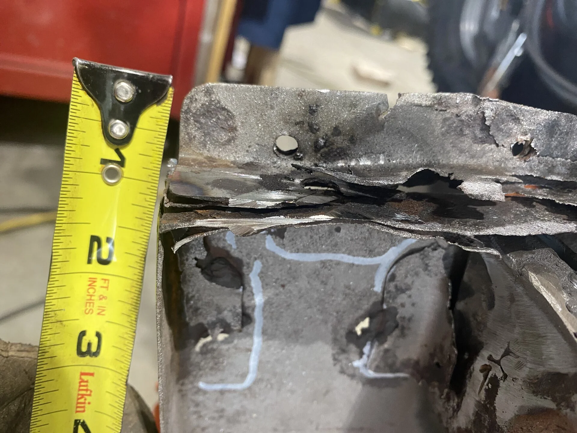

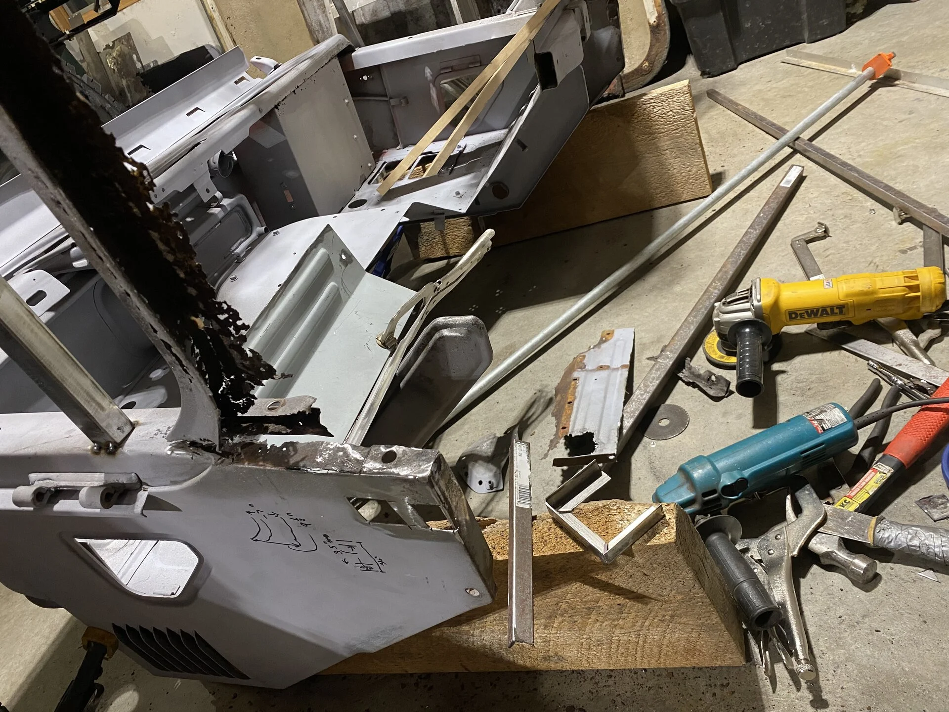

If you don't undercoat, then what do you do with it to stop it rusting??
