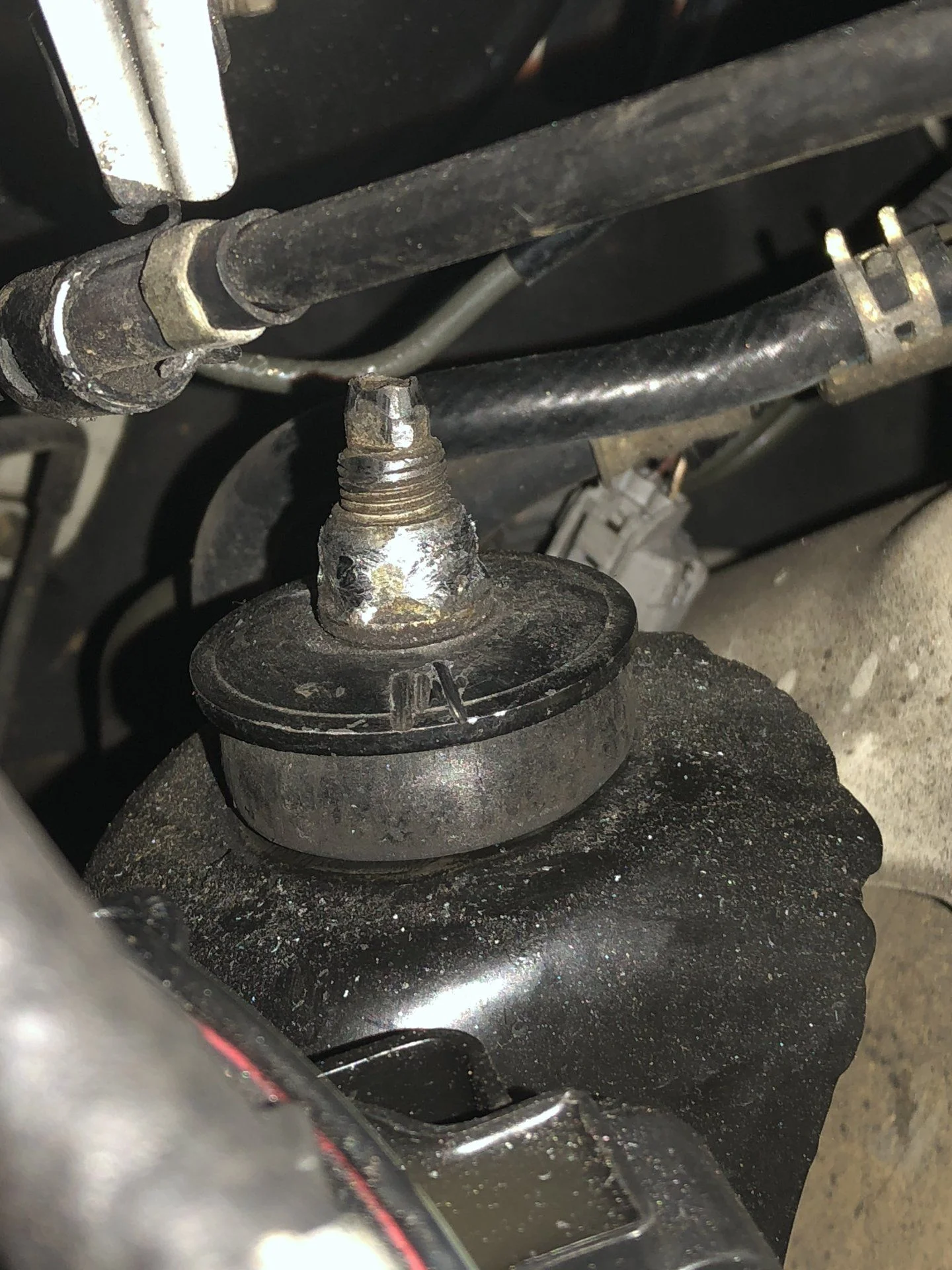

Use a sawsall or cut off disk on a grinder to cut the chrome shank of the shock underneath the shock mount above the tire where you have more room.
I will try that tomorrow morning. Thanks for the suggestion.
I have tried my impact gun, strap wrench, channel lock pliers, Dremel cutting wheel, a nut splitter, etc but still can’t get the nut off the top of the shock. I’ve chewed the nut up far worse than what is in this photo. This was after some early attempts.
Cutoff disk on an angle grinder will take off everything in no time at all, just cover stuff with welding blanket or cardboard box.

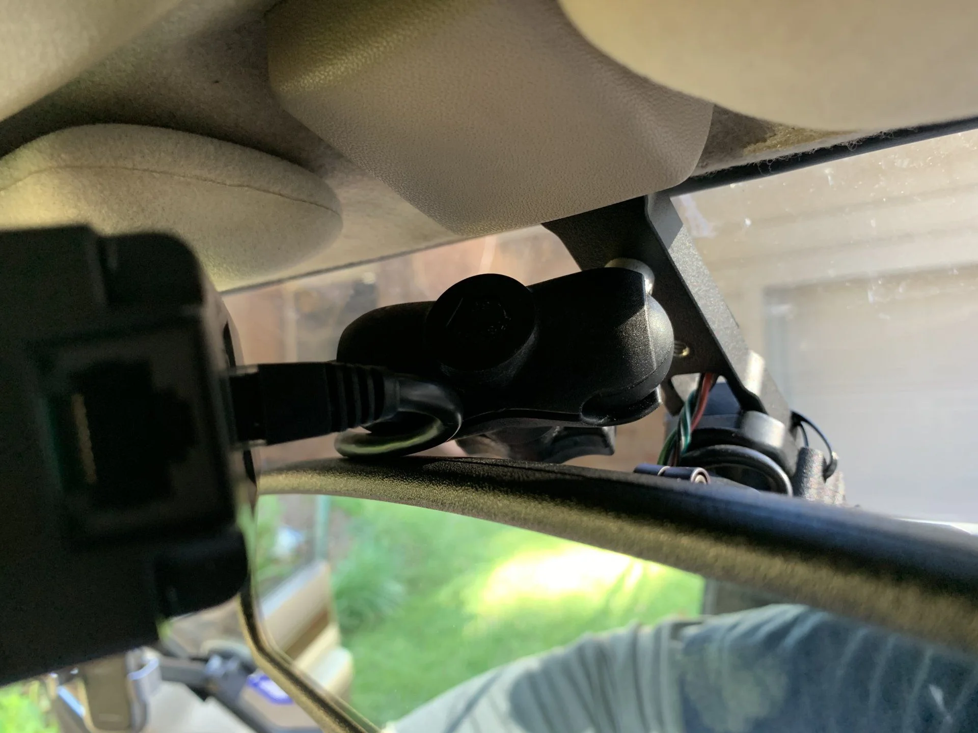

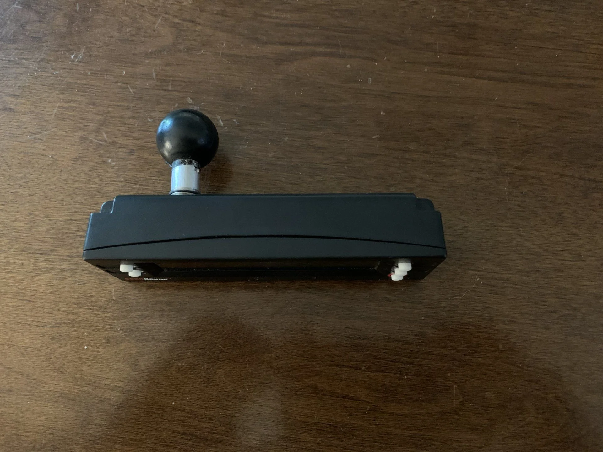

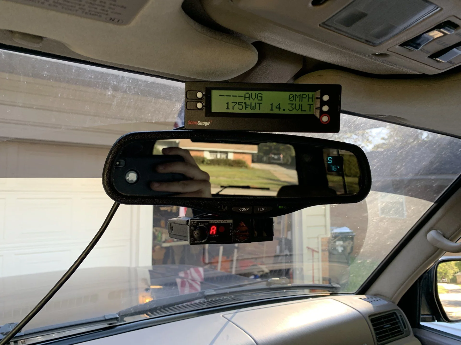

I also moved my ScanGuage from the steering column to the Wits End mirror mount. I took the back cover off of the ScanGauge and drilled a 1/4” hole to accept a 1/4-20 button head cap screw that went into a RAM ball (HD only had 3/4” long screws, so I stacked some washers for the time being). I then used a short RAM arm to another RAM ball coming off the mirror arm. There’s a lot going on around the mirror, but at least it’s all in one spot now. It does make the driver side visor unusable for the time being. I’m going to modify it. Also is not all wired up yet as I need to get an ethernet coupler and make a jumper cable to make it up to the mirror from the driver’s footwell.
How is that V1 mounted? To the mirror mount or mirror with a Blendmount?

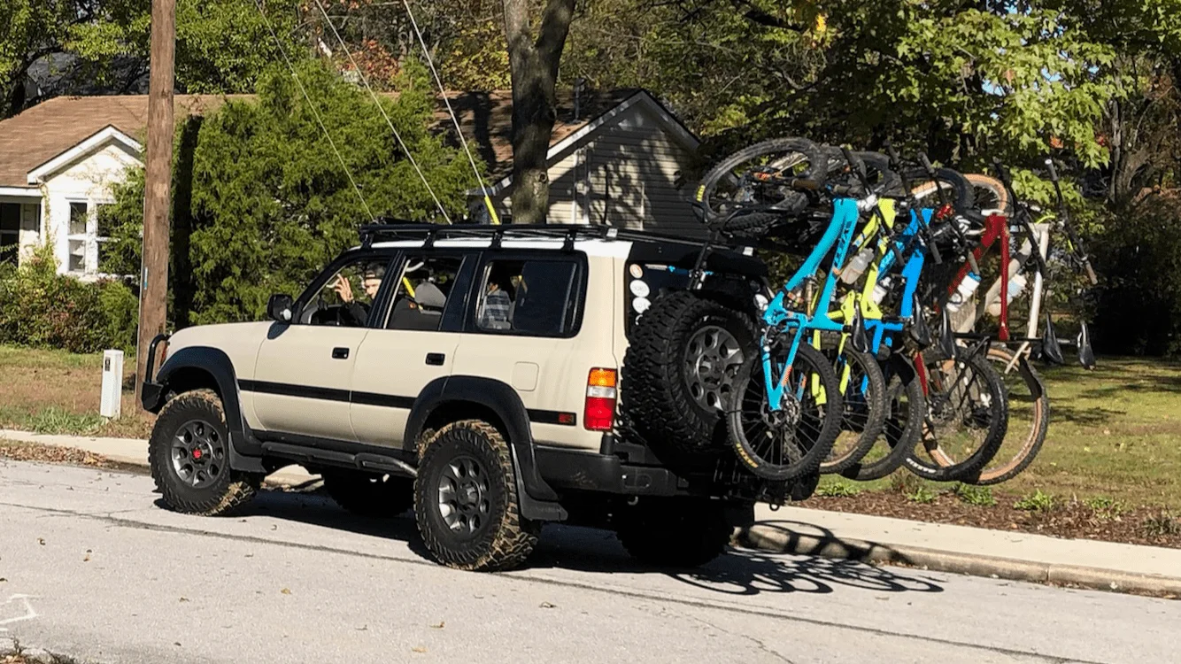

Drove out and biked Bentonville. Hit 423k and only saw gas mileage in the single digits. Come to think of it, I haven’t seen double digit gas mileage in awhile. Even without bikes. Might need to investigate that.
