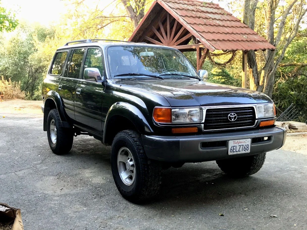

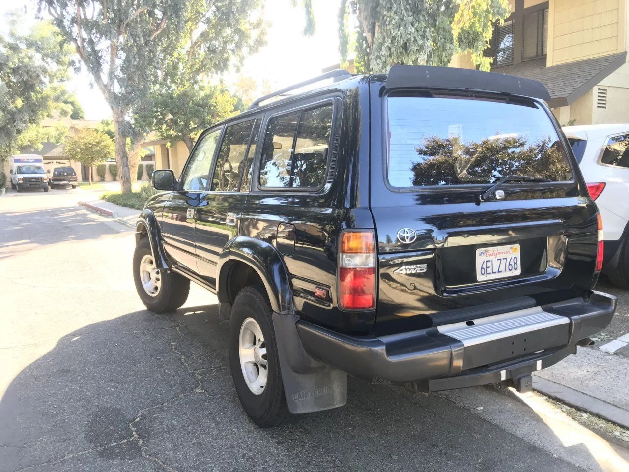

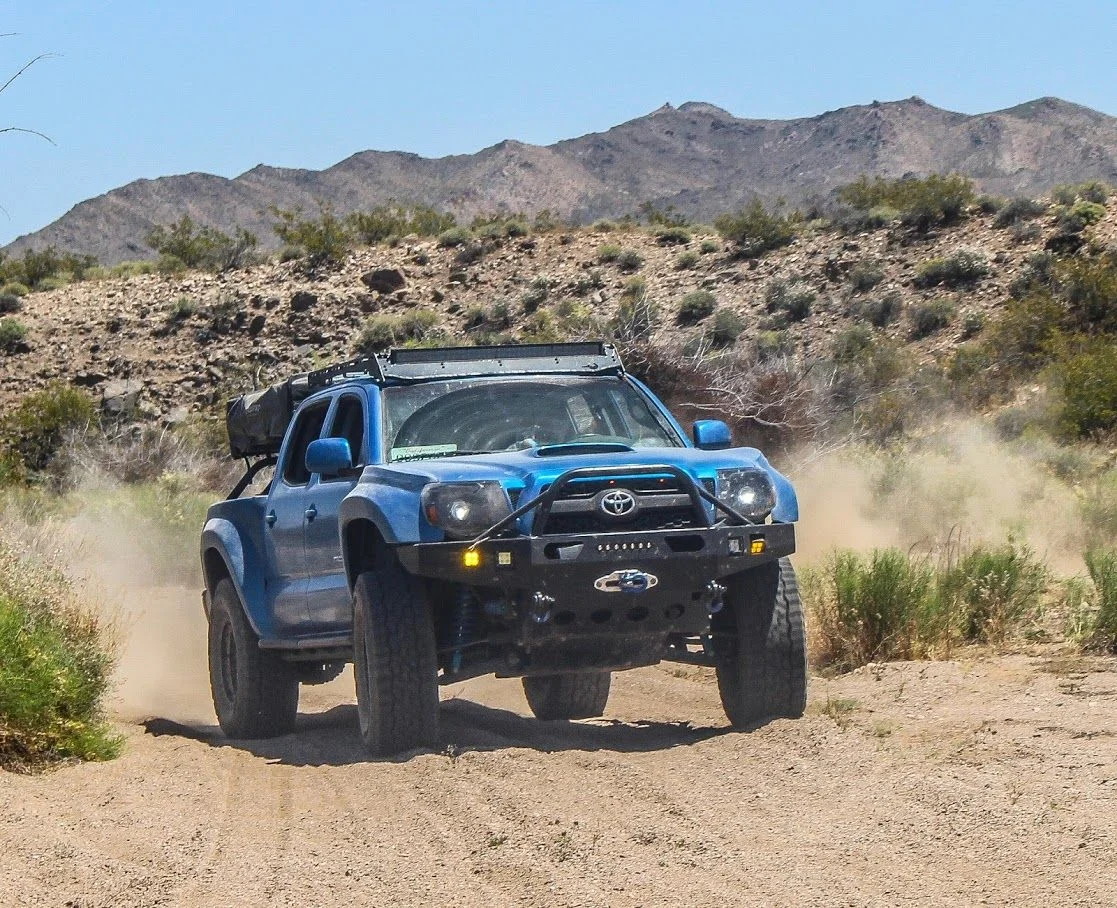

Hey Mud! I'm Danny, and I picked up a FZJ80 Cruiser for my off road fleet. I currently drive a 2006 Tacoma (click for build) that's been built into a zoom-zoom desert bomber. Living in NorCal, I also needed something that was at home on the rocky, mountain trails in the Sierras. I've always loved these FZJ80s and just paid off the Tacoma, so what better time than the present?! Here she is, in all her 80 series glory:
Some quick stats on her stolen fro my 80 Series Registry post:
1. 1996 Land Cruiser FZJ80
2. Name is tbd - just got it 3 days ago lol
4. 270,223 miles
5. OME 2.5" lift w/ KYB extended shocks and CDL switch
Thanks for stopping by! I will try to keep the next couple posts updated with mods and trips. I'm happy to hear any input and advice you 80-series folks may have :cheers:

Day Zero: Purchase day
10/25/19
Early on a brisk NorCal morning, I hopped on BART (local transit train) from my little town of Martinez to Oakland Airport in order to catch my morning flight to sunny San Diego. Being originally from Los Angeles, it's always a pleasure to return to SoCal and enjoy the way better Mexican food lol.
Anyway, my buddy picked me up and we headed out to meet with the seller. In talking to the guy all week, he seemed very trustworthy, upfront and knowledgeable of Land Cruisers. His reasons for selling were 1) didn't have time to take it out into the wild, 2) he bought a 100-series to be more wife- and kid-friendly, and 3) the truck still needed some work after investing a bunch of his labor hours into it.
Things already completed (per P/O):
1) Front main seal
2) Oil pump seal
3) Dizzy seal (distributor o-ring)
Things still needed to be fixed (per P/O)
1) Sunroof was not working properly
2) OEM stereo doesn't push any sound to the speakers, but it still turns on and otherwise functions properly
3) P/O before P/O claims he rebuilt the knuckles in 2017, but didn't have any receipts or other proof (likely need to do this myself)
The P/O before this P/O apparently ran the truck for a long time with these three things leaking, so the entire engine bay and undercarriage is coated in oil (yippee :rolleyes:). Although ugly and annoying, I knew this going into it and used it to bargain. After a test drive and some discussion, we struck a deal, and the title was signed over to me in exchange for a number of crispy, blue Benjamins. Here she is, at the scene of the purchase (me on the right - let me know if you have a cute sister or cousin or something):

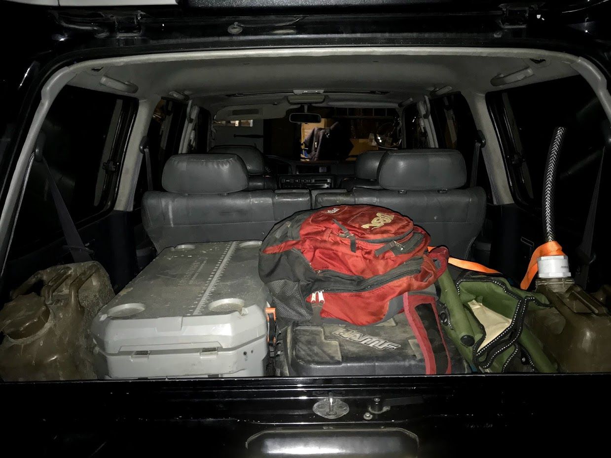

However, the next big step was making the 500-mile journey back home to NorCal...hopefully the P/O was as upfront as I thought he was, but I mean, come on, the 80-series is supposed to be the pinnacle of Toyota engineering right? I checked all the fluids I could without tools, since I flew down, and hit the road first thing in the morning. As mentioned earlier, there were couple more things wrong with the truck, including 1) the radio doesn't push any sound to the speakers, and 2) the sunroof is jammed on something - possibly off the track. Knowing this ahead of time, I packed a bluetooth mini speaker and a dual-usb car charger to keep the tunes going for 8 hours or so lol.
The drive was smooth overall, but I did notice that the cruzer had some vibes/wobble at highway speeds and the steering grew a bit looser over the course of the drive. These were fairly expected, but the next morning was when I found the bummer...

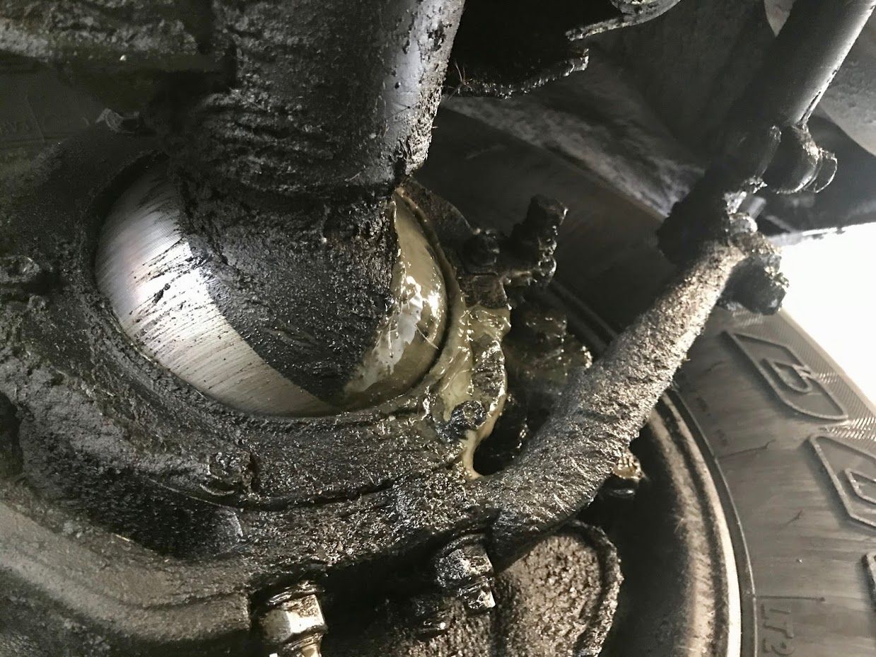

(See all that grime I mentioned before?) I unfortunately had grown optimistic that the P/P/O actually had rebuilt the knuckles...clearly not, though. Overall, she still got me 500 miles back home, and I averaged 14.7 mpgs (not nearly as bad as I've been hearing others getting, but still early on lol).

looks like you have some water inside that knuckle and oil seal is shot but probably you will need new shaft to since the seal is known to cut grove in the shaft and new seal will not seal properly
I took it by my local off road shop, and they are concerned about the same. They're going to handle the job for me...I don't want to have to go through this again, so I'll leave it to the pros lol. My buddy and I are going to try to tackle the rest tho.
