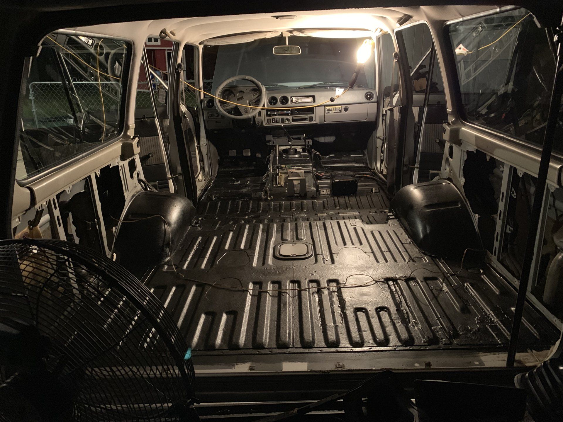

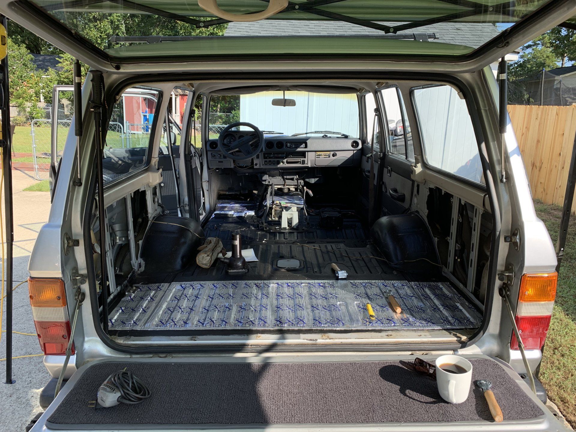

First up...strip interior, look for rust, clean up, coat in bedliner, add sound deadner, install new carpet (new carpet really just because). I was lucky enough that my father-in-law was in town to help so I took a week off from work to dedicate to the initial work.
Interior strip down
Overall great shape, but found one small spot rusted out on the DS wheel well...
From here it escalated quickly. As previously stated, not a car guy and basically zero automotive repair experience. Next thing I know my FIL has talked me into buying small 120v MIG welder, helps me practice for half an hour on an old steel target, finishes dinner and he heads back to his RV with a departing "your car, your job...good luck". It was late and I didn't feel like tackling it in the dark, so I packed in until the morning. 8am I was out there welding up the spot I'd cut out and had it finished by the time my FIL came over after breakfast. I know it was only a little 3-4inch patch, but a pretty big leap from where I was 24 hours prior. No picture because it was in the upper 90's all week and I wanted to move before the sun was completely blazing.
On to the bed liner and sound deadner for the next 2 days...

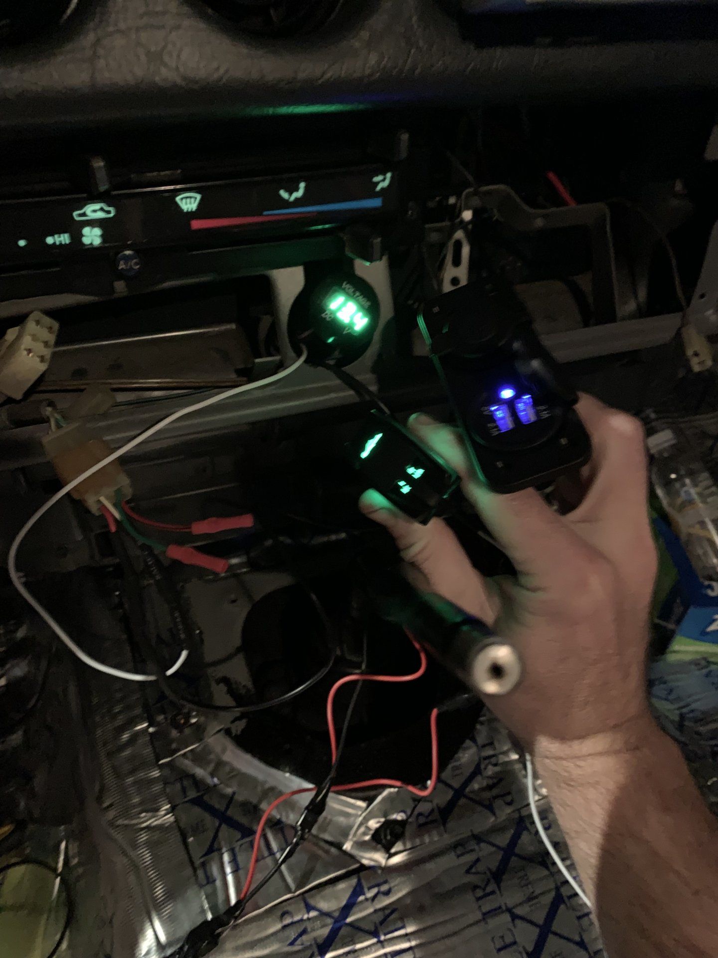

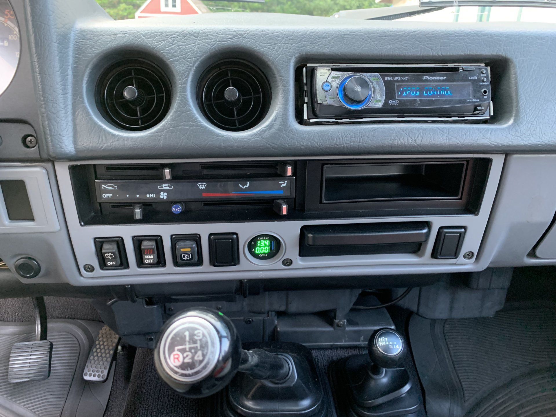

Had a buddy stop by and help me wire in some 2000's tech....volt meter placed in the cig lighter, (on a separate circuit) dual usb for the front of the console for mom & dad, dual usb and 12v socket in rear of console for the kids.

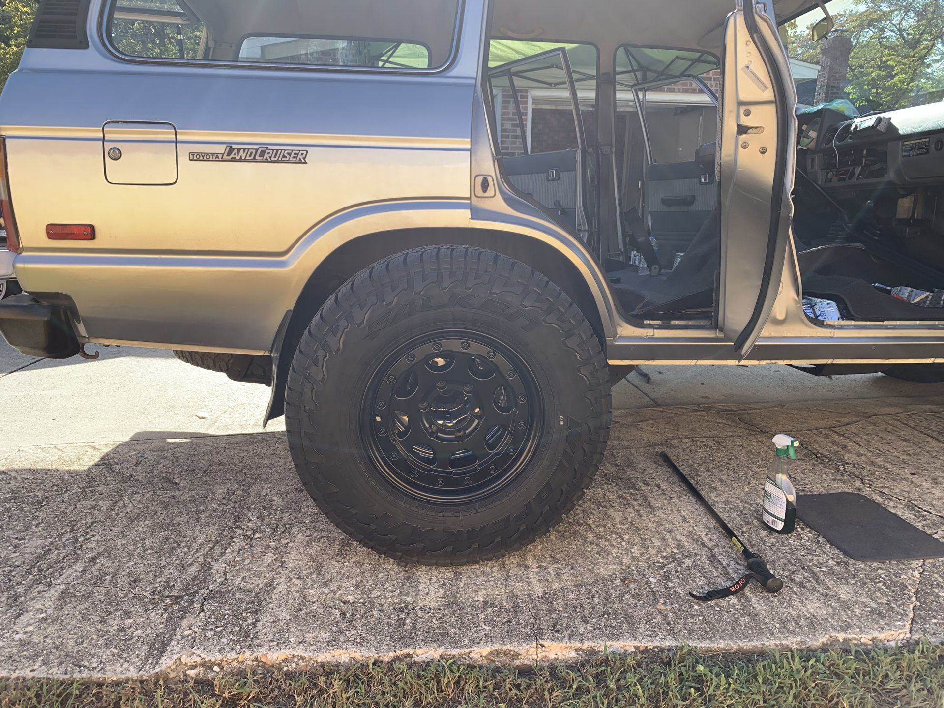

Tires and wheels showed up!!! 265/75R16 Falken Wildpeak A/T3W. Too bad they beat the OME suspension lift kit (parts on back order - "should" be here by 27 SEP though. They'll look even better under the 2" lift and actually mounted!

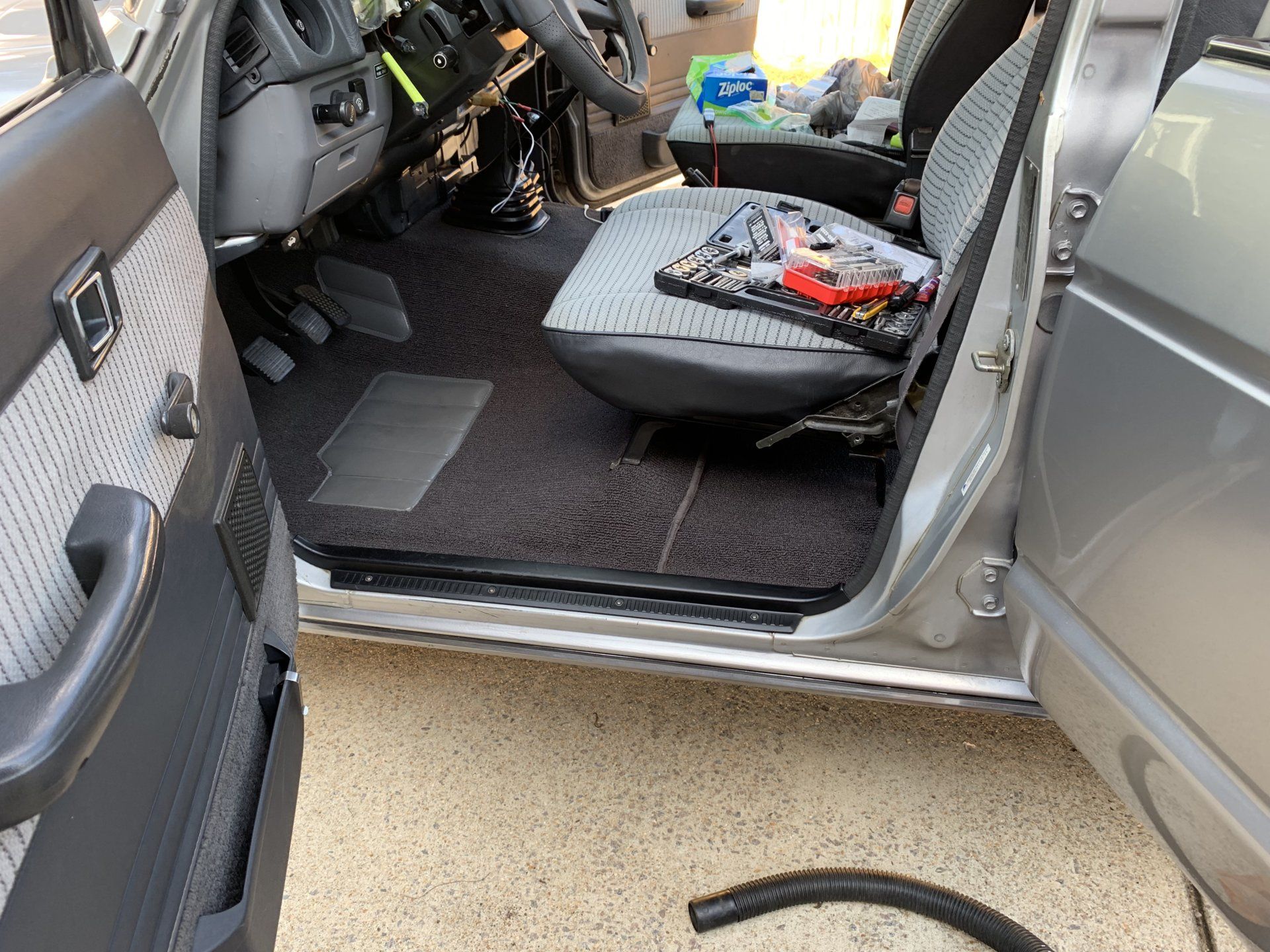

Got the new carpet installed. Only broke one bolt and stripped one threaded hole. On the plus side, I learned how to successfully remove a broken bolt and re-tap a hole for a new bolt...oh yeah, and I added to my tool collection.

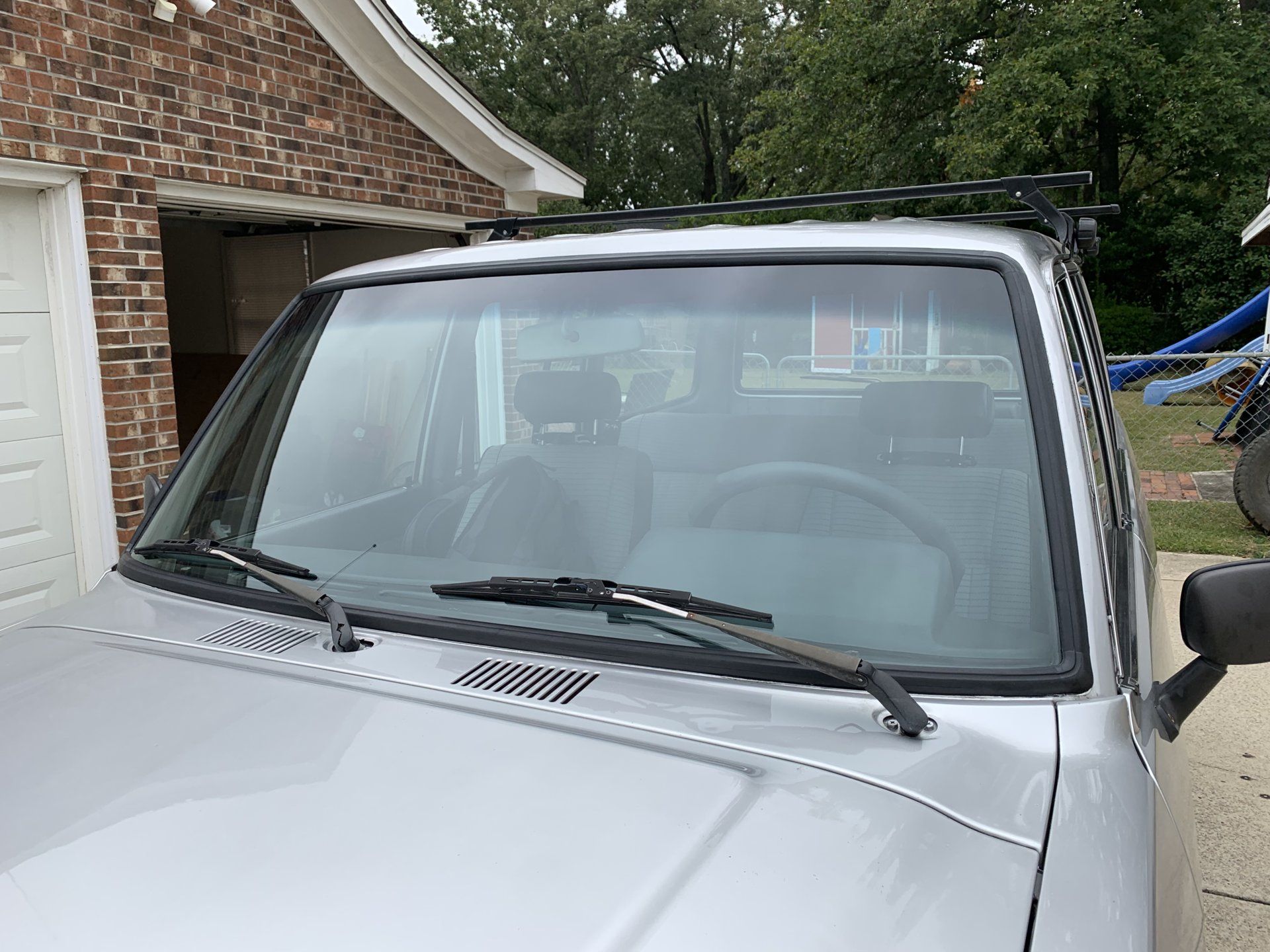

Before I started the interior work, I drove around for about 2 days just having fun with the kids. They learned cool things like "what an ashtray is, how manual door locks and window cranks work, rear passengers only get lap belts because you're not real people yet, and when in Daddy's 80's vehicle we can only listen to all 80's all the time". Taking them to school requires turning onto a main road that drives right into the sun...that's when I realized how bad the windshield pitting was...an actual safety concern. I called around and found a local guy with mobile service that could replace it the first day I was back at work during my lunch break. Bonus...only had black gasket; more chrome vanishing. Well...the windshield had a flaw in it and shattered during the install. No more Crusier fun for a couple days...
That was a Tuesday. He made it back out as his first call on Thursday morning. Not only did the install go flawlessly, but the windshield he brought had that sweet 80's style tint across the top...no extra charge. Back in business!
The interior is pretty close to done. Rear panels are re-colored. Cleaned up and re-painted all the plastic parts around the gauges, heater controls, ashtray, etc. Ran out of sound deadner before I could finish the doors. When I do that, I'll re-color the door panels and be done with the inside.

Here's a few updated shots of the interior...
Drvr/Pass USB ports
Hard to tell, but updated paint on all the plastic bits below the dash pad. I decided the leave the metal alone because it has a very subtle patina I like. Reminds me of all the grey Cold War metal furniture I grew up around visiting my dad at work (I know, weird). Also added the volt meter to the cig lighter hole. I actually dig the original green backlighting on the dash, so I'm sticking to green with any electronic updates up front.

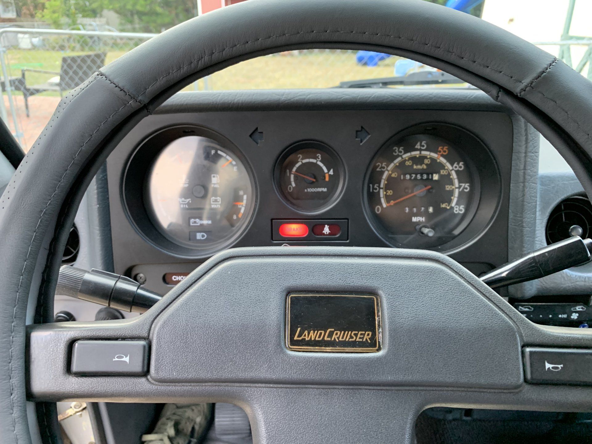

Cleaned up the gauges and painted the gauge panel...
Rear USB and 12v socket installed in the rear of the console for passengers...
