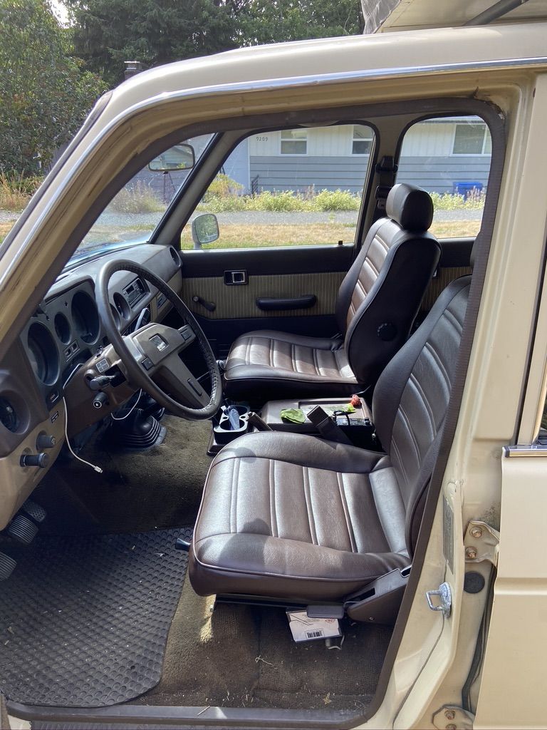

During that cross-state trip my dog went a little crazy in the truck and made the tear in my driver's seat even worse. I ended up grabbing an awesome pair of restored HJ61 seats that were already adapted for an 84 (cheers @ProwlerDriver). They're amazing! My only hesitation is that I do love the look of the stock brown cloth... I'll give the original seats a few months in the shed and see how I feel then. :)
Looks great Nate. If you do the DNP carpet kit I think they will really tie together.
IF you do that vinyl kit it would tie in to the seats but the brown seat stripes and the brown carpet are what give a 60 have such an 80’s appeal.
I'll keep the brown carpet for sure, it just needs freshening up. The stripes are so classic but for now my hope is to keep this truck for a long time so the vinyl seats have a very utilitarian appeal.

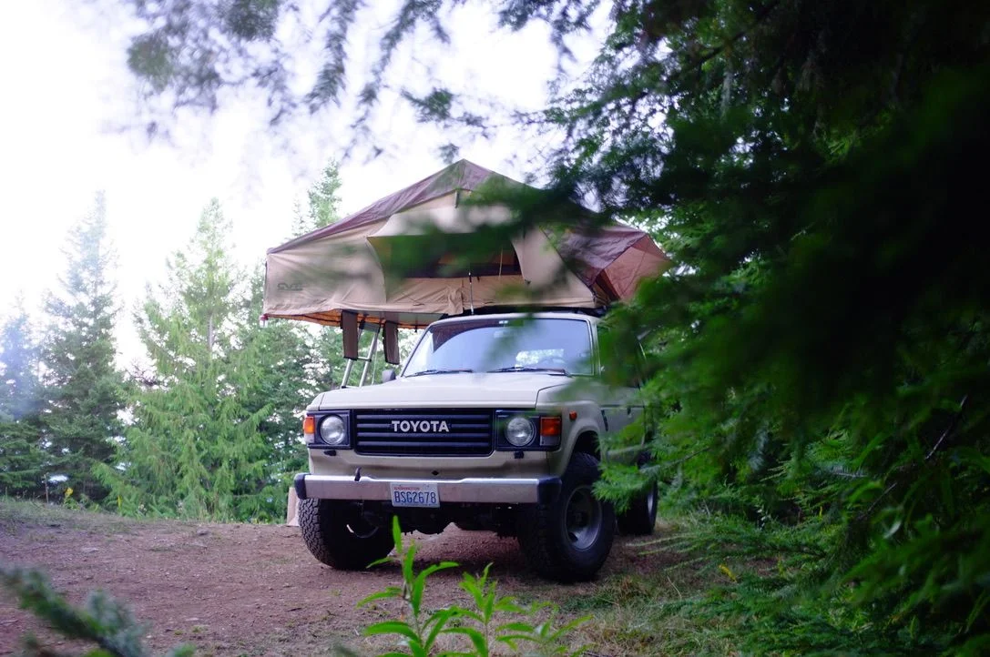

Also also I spent a few days on the road this past week camping and exploring forest roads. I've somewhat resigned myself to regularly loosening the rear brakes and going a bit easier than normal on the parking brake lever. 😅 Other than loosening the brakes on the side of 101 I had no trouble with the truck and it was a joy of a companion for a few days. On the last forest road of the week I drove up a side road that was very overgrown and lost one of my rear side badges to the bush. Worth it!

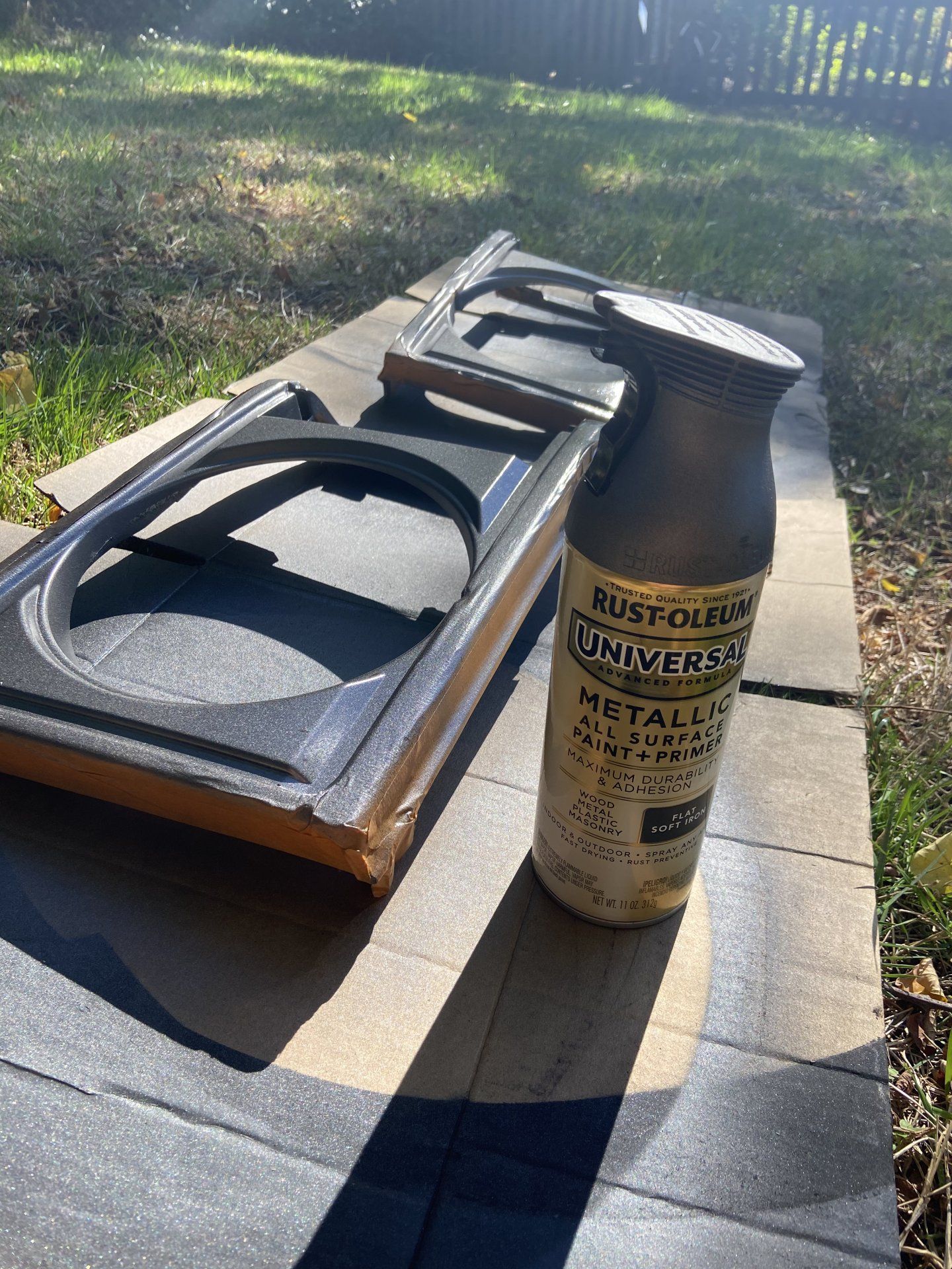

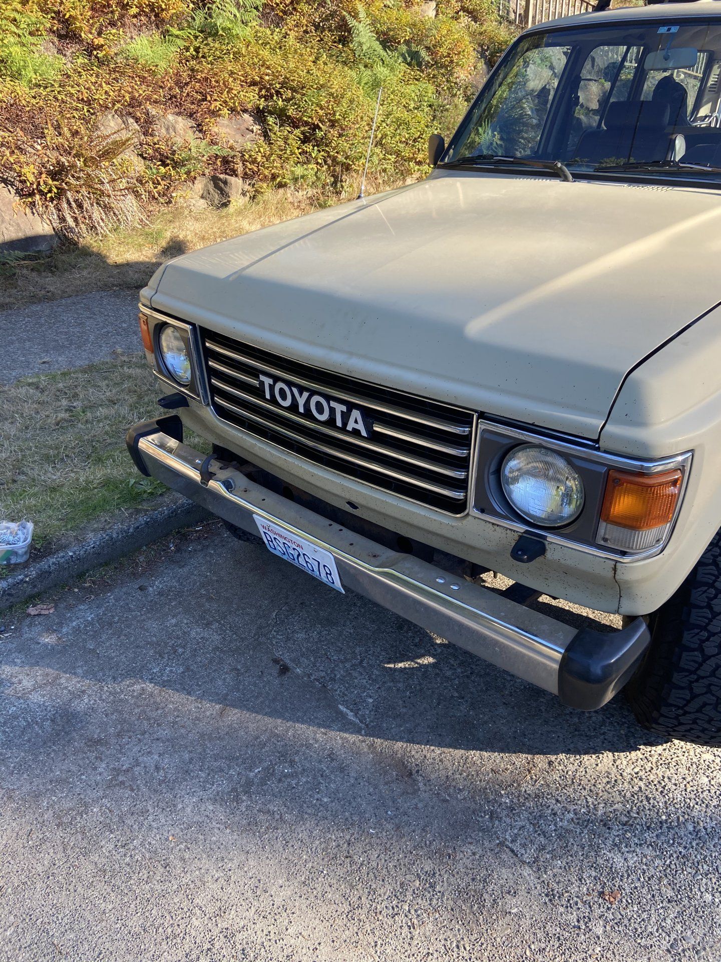

First, the grille! The $30 carparts.com grille is quite nice, other than the minor fitment issue with the TOYOTA badge. I added some Rustoleum to my chrome headlight surrounds, bought some new screws and nuts from the hardware store, and voila, brand new grille.

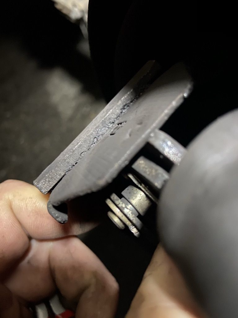

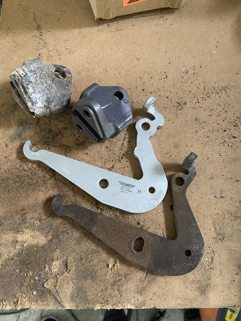

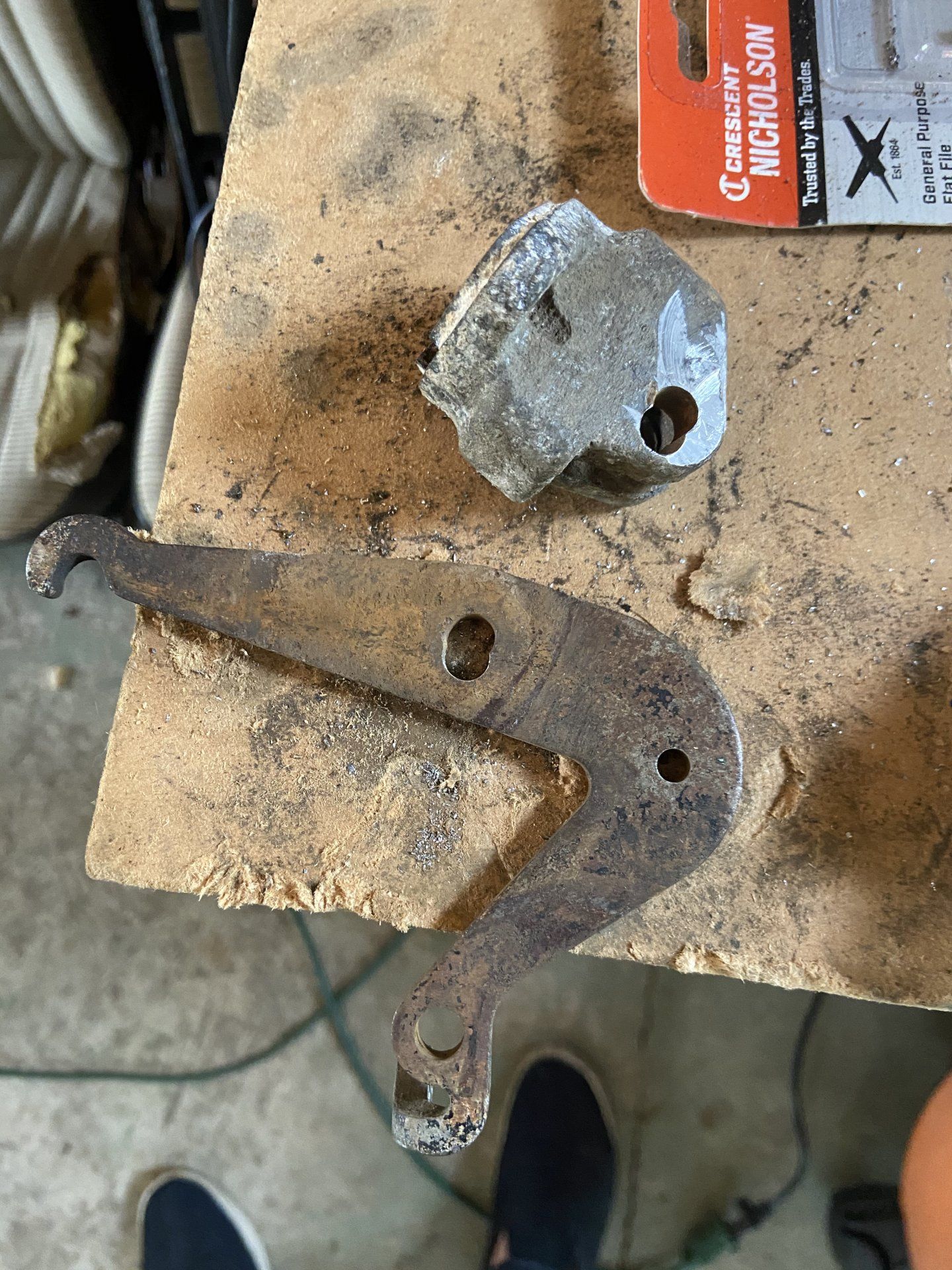

I got 7.7mpg on my last fill-up so I'm trying to fix my over-adjusting rear brake problem again. I thought my bell cranks might be the problem so I pulled them and started a rebuild. They actually turned just fine but I figured I should do the job right while I had them out... but that turned into a complete replacement. I had to drill out the pin that holds the crank to the housing and missed widely enough to not want to re-use them. Fortunately Oreilly carries a Dorman kit that's a very good replacement (924-753) and I now have those installed and working! I also added a washer to the pivot pin for the self-adjuster, hopefully that is the real fix for the over-adjustment problem (the photo shows the gap that I filled with a washer).
It's good to know that there's a readily available replacement for these cranks. What are the components made of? Hopefully Dorman opted for something other than aluminum for the crank mount...
