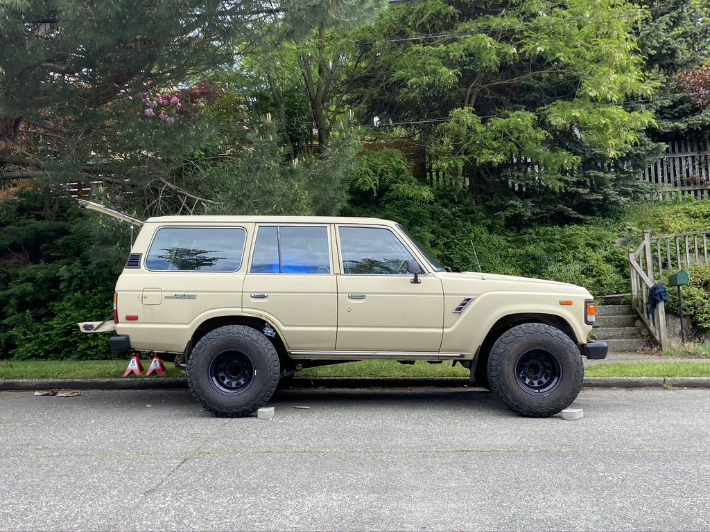

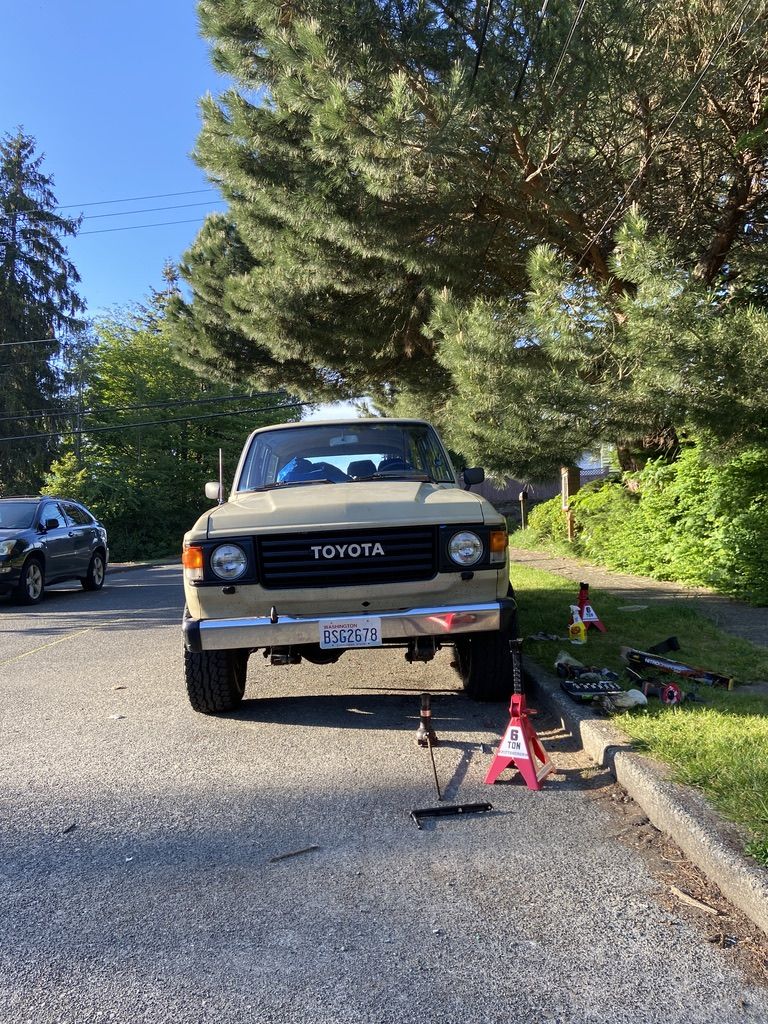

I won't call this job done until everything is torqued to spec but the springs, shocks, pins, and shackles are all swapped out!! Getting those pins out is just awful. I didn't take great before and after photos, in part because the job took a lot longer than expected and also because the rear is very loaded in the "after" photo... but I think the difference is still clear. The last photo shows how the front looked with only the DS changed out. ;)
What was the lift amount again?
Haha I guess that depends who you ask. They're OME CS004 springs all around with an extra leaf in the rear. With my stock bumpers that probably means 2.5" in the front and 3" in the rear. I bought the springs used from @torfab, I think they were on his truck for a year and a half or so. Broken in! I should be able to see the final stance next week after I get my 33" BFGs out of the back of the truck and onto the wheels. If the stinkbug is really bad I'll just prioritize building some drawers.
Yesterday I got the suspension all torqued down. I have a persistent vacuum problem that requires half choke to run but that didn't stop me from taking the truck around the block to test out the suspension. It feels so good!
I also spent a while trying to debug that vacuum leak (I think it's the carb base, need an offset 12mm wrench to really tighten it down) and changing out frame-to-axle brake lines. I got the rear line in just fine but I encountered a rounded nut on one of the hardlines in the front so that may have to wait... or I'll just replace it with a soft line altogether.

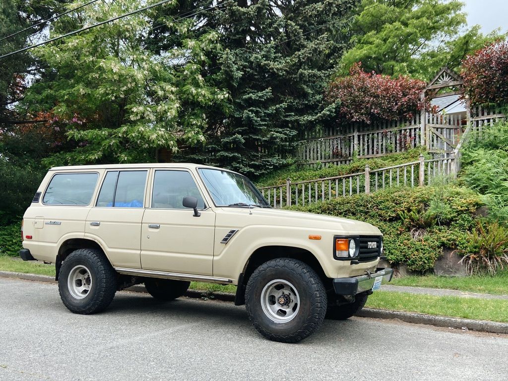

I bought some wheels and tires a couple of weeks ago intending to just swap the tires onto my rims and re-sell the wheels. Unfortunately I really like the way these wheels look leaned up against my truck. Bad news is they're 15x10 with 4" or 3.75" backspacing and the tires are 33x10.5. I could spend the money I would pay to a shop to swap the tires on lugs and spacers instead... but that tire/rim width combo doesn't feel good to me long-term. Still... look at it!
Yeah I'm going to mount the 33x10.5s on my 15x8.5 slot mags. I just can't justify buying spacers and lug nuts for rims that don't match the tires. What's more, I'll be able to make a decent amount back by reselling the AR767s.
