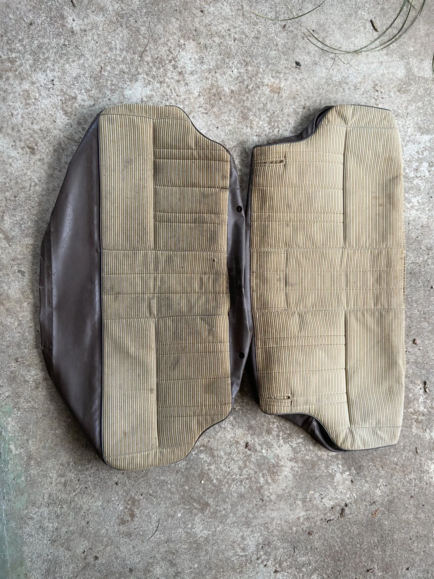

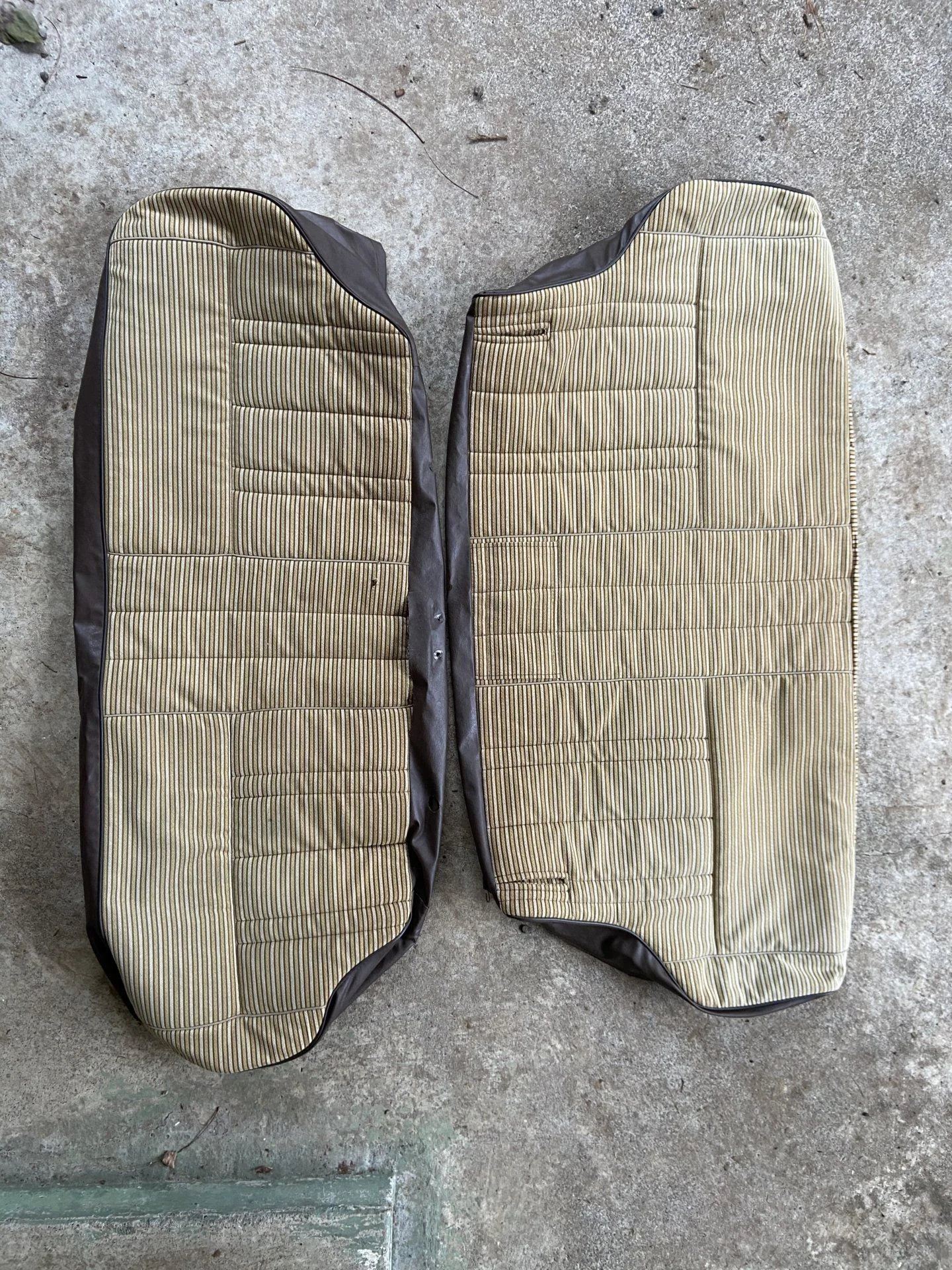

I removed the seat covers from the rear seat back and bottom and started the process of washing them. Added more PB blaster to the head bolts and the air rail bolts in prep for removing. Also, I placed a few orders! Picked up a tailgate light bezel from a mudder; ordered an FSM reprint, a window lever, used front markers, and replacement taillight lenses from SOR; and ordered the cap and plug kit from Jim C (I have aftermarket headers and an intact (devaned?) smog pump so these are the only pieces I need right now).
