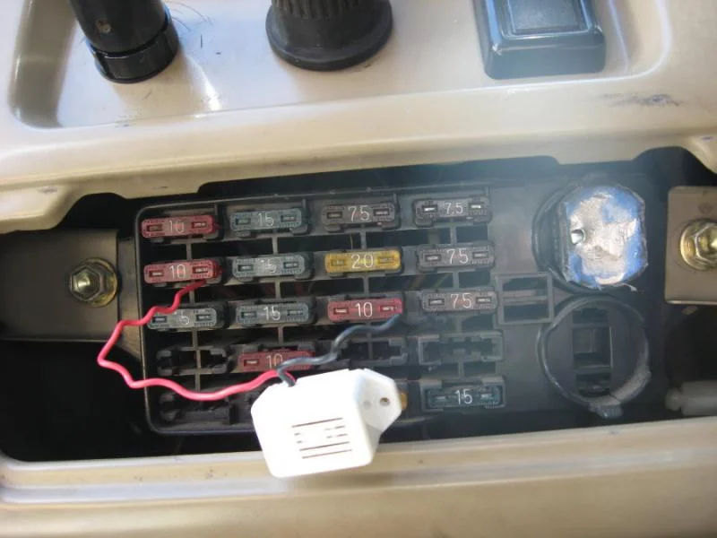

This Mod is care of Dynosoar who has a post about it in the "Best Mods under $50" thread ( LINK ) post # 157 ...
And after killing my battery for the 3rd time in a month, by leaving the lights on during the day, I finally had to PM Dynosoar 'cuz I couldn't find his post
I thought I'd just do a pictorial write up on it since people may not have seen it in a while and I did, after much searching, have to contact Dynosoar.

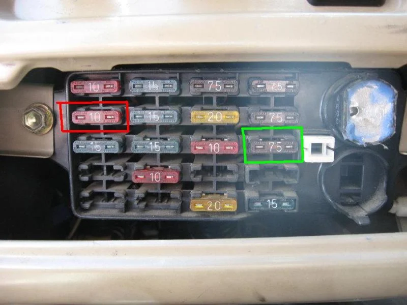

First you need this Radio Shack Buzzer (about $3.50). I could only find it under part # 273-055 LINK EDIT - SEE later posts for updated links.
So, for the blade type fuses, you simply place the RED buzzer lead under one side of the LEFT HEADLIGHT fuse and the BLACK lead under a blade of the GAUGES fuse.
Voila! Now, if you leave your lights on - Ignition off - you get a Buzzer - no more dead batteries.
Wish I had done this long ago ...
Thanks again, Dynosoar for this great and simple solution! :)
:cheers:

I am glad it worked out for you. I know this saved my butt many days. Best $3.25 you could spend!
Dynosoar:zilla:
It kept me from doing something stupid this past weekend. I consider it cheap insurance. And since I already had one of those buzzers lying around my parts bin, it was essentially free. Thanks, Dynosoar.
Well, it took me almost two years and tons of near-misses to finally take the 8 mins just to do it the easy way...
It's not really a problem on my '85. I've got a super-duper odyssey battery in there and I've left the lights on in that for hours and she still started, no prob. But in the '86, I've got a stinky Kirkland batt that if I leave on for an hour, all I get is a click-click.
Guess I could buy another Odyssey, but 4 bux is easier!
Thanks again, Peter!

For the other :banana:s out there, since I had a 60 and 62 outside, I took a quick look and this mod also will also work with the 62 fuse block. (The two blocks are almost identical, just a few extra fuses for the EFI, etc, and higher amperage fuses for hotter headlights.)
Easy Done
hardest part was finding a 1" strip of doublesided sticky tape to attach the buzzer to at the bottom of the tray area.
For those who haven' t yet done this, its really as easy as described. Buzzer doesn't go off if you have the ignition on, so if you need to have the lights on for some reason without having it running, you don't have to have the buzzer going off.
