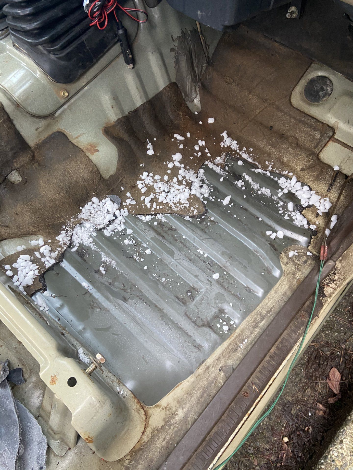

A quart bag of dry ice pellets or broken up into chunks and left in place for a few minutes makes it brittle and easily knocked off with a rubber mallet or scraped up with a paint scraper. Easy work. Fun task.

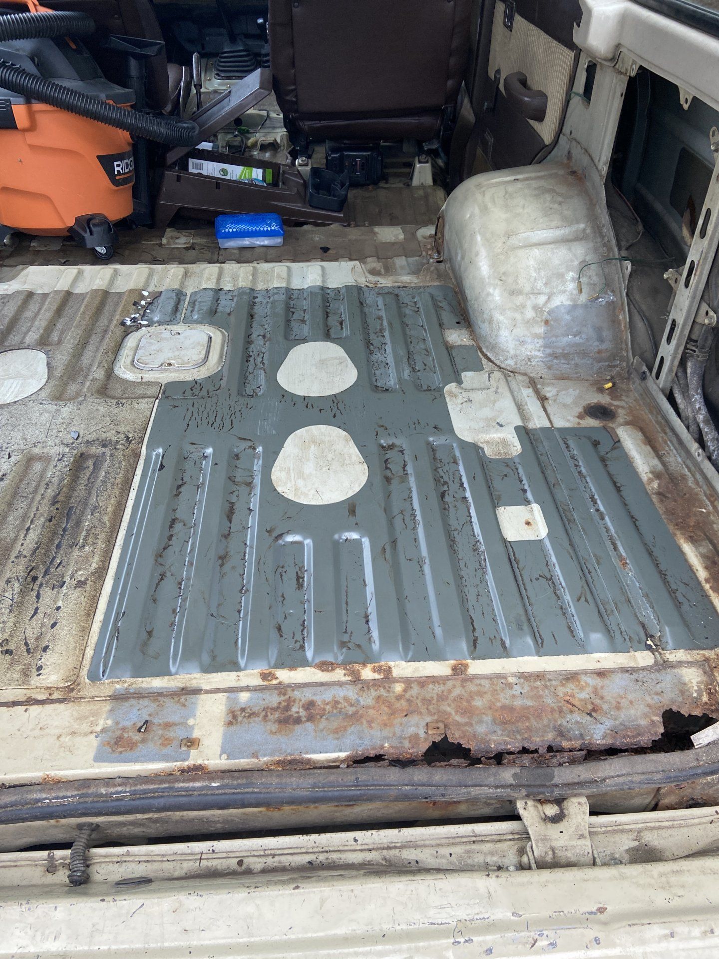

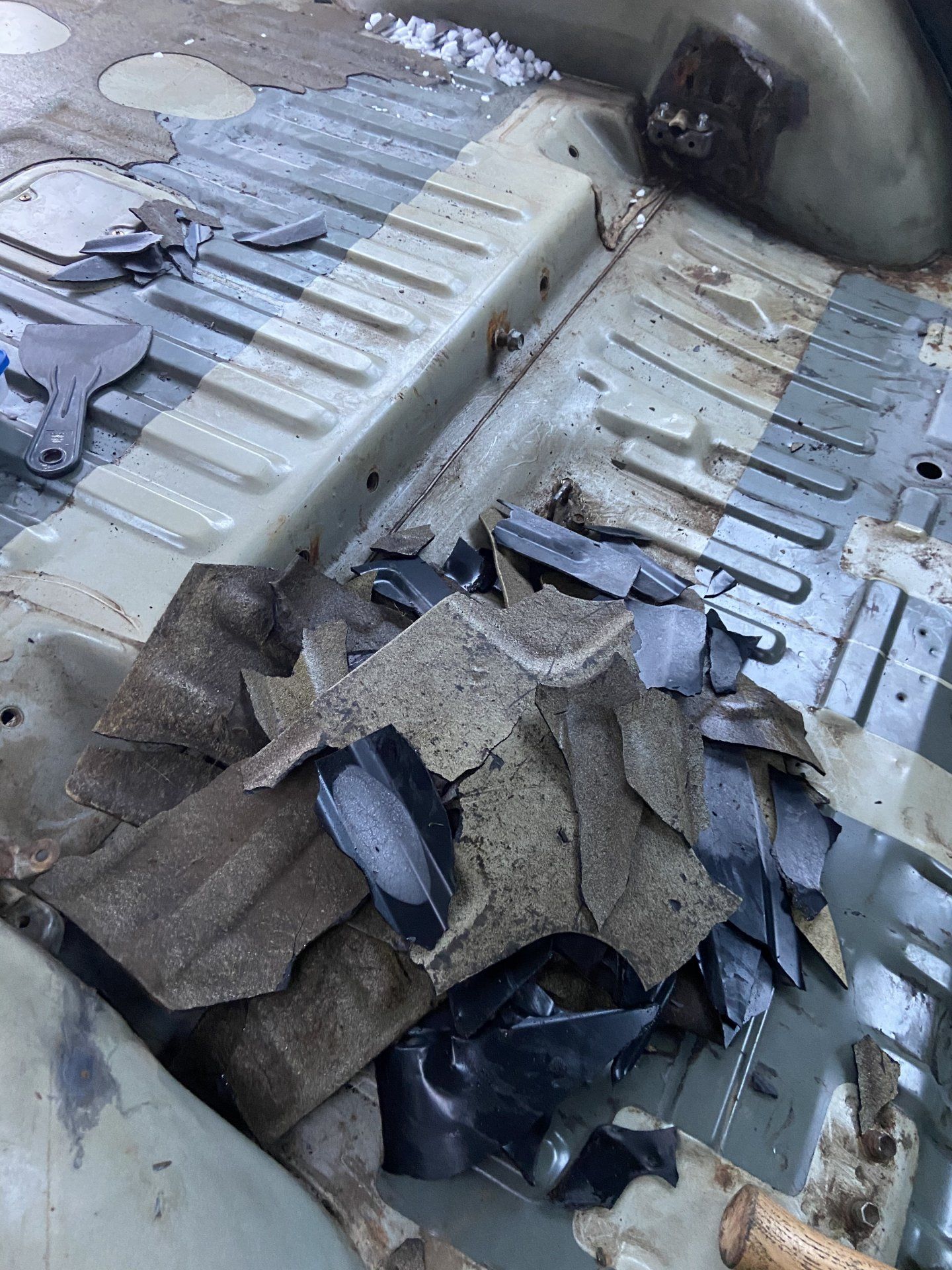

I got most of the factory sound deadener out today. Ten pounds of dry ice was almost enough for the whole truck but not quite, I’ll go back for a couple more pounds and finish the job tomorrow. I found almost no (new) rust! Super pleased. From here I’ll repair as much surface rust as I can find and then get a body shop quote for the tailgate threshold and wheel wells.

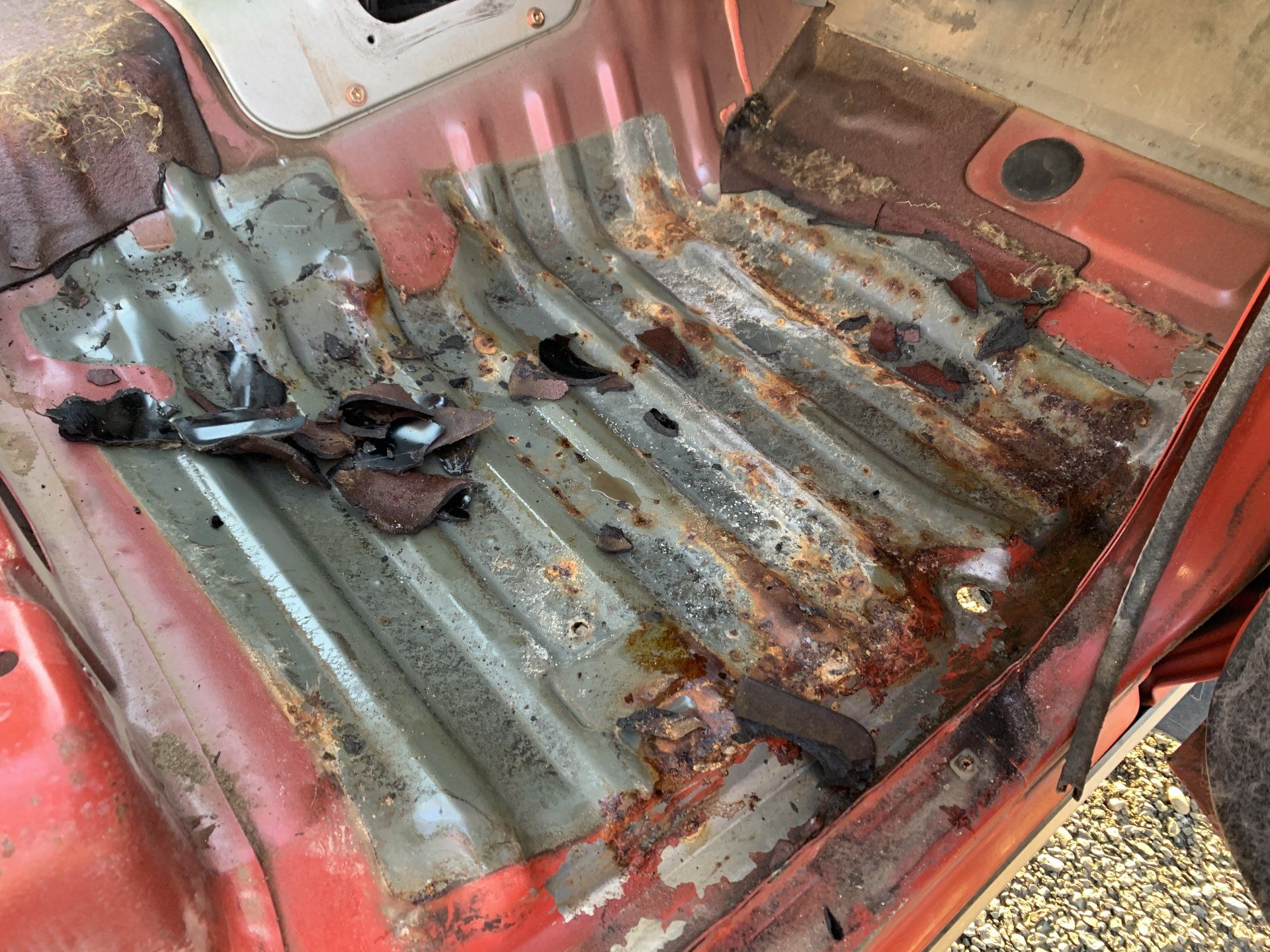

Mine lived almost its entire life in Port Townsend and looks allot worse under some of the sound deadening.View attachment 2565257
Ouch, that hurts to see. Did you have a leaky heater core or something else dumping water on that spot? My carpet was soggy in that foot well for a few months so I was expecting to see something like this under the carpet and soundproofing.
Luckily all the metal is still solid so I am just waiting for some warm weather to sand it, treat it, and coat it with some por15.
My carpets looked pretty ok but were soaking wet and extremely moldy underneath, past the point of cleaning. I think it’s water from the windshield and probably the cowl or drip rail. So far other than the lower tailgate my rust has all be manageable.

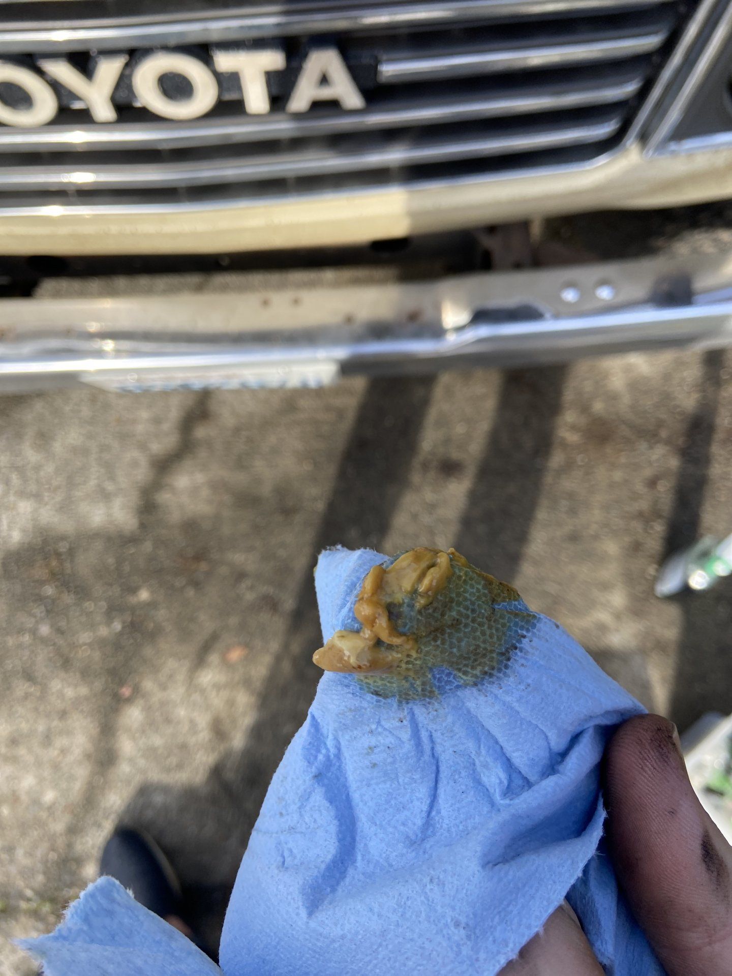

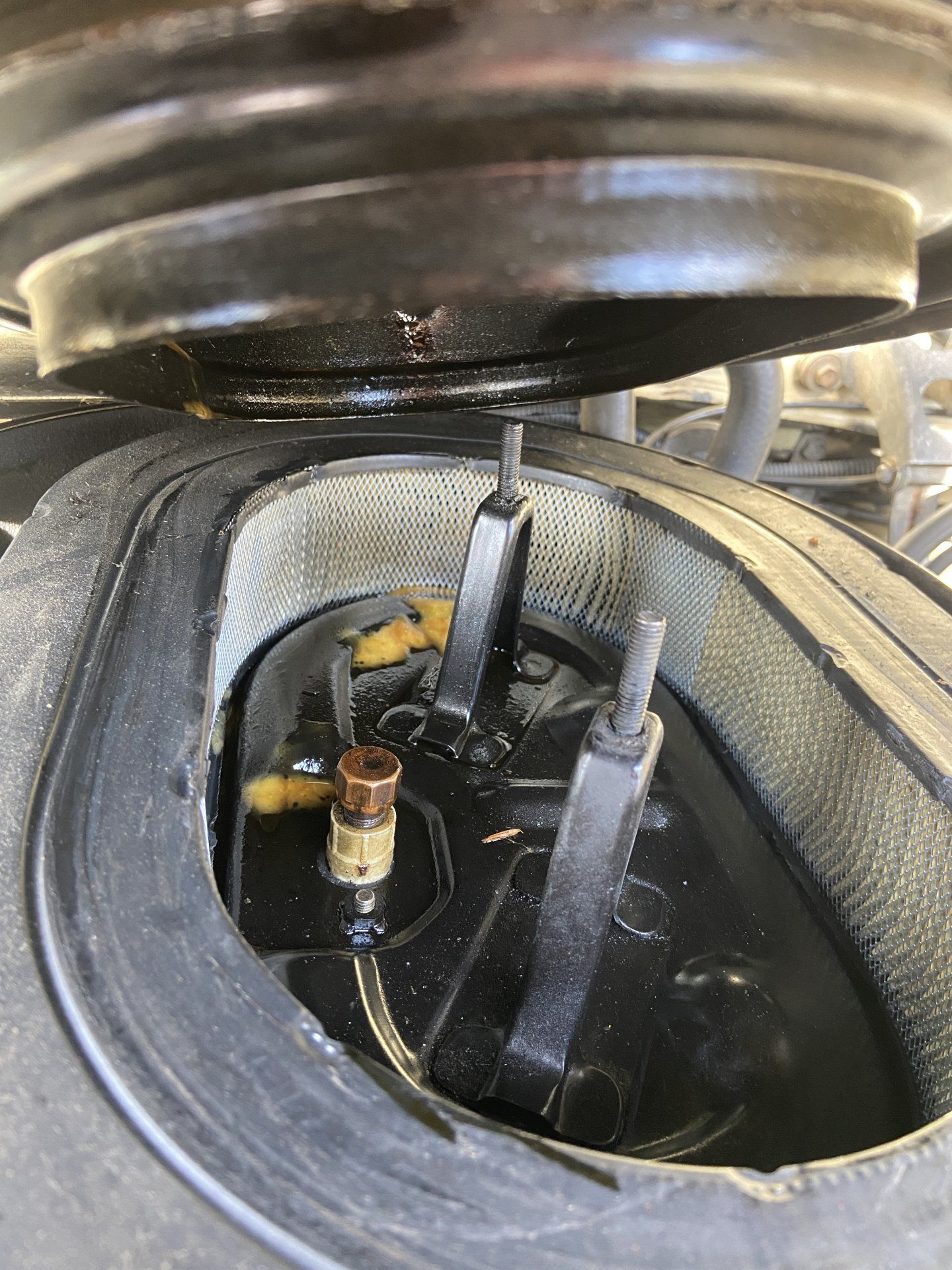

So uh... anyone want to tell me that this is a normal amount of yellow gunk? The last photo is from reaching into the top of the valve cover with a finger. I do a lot of relatively short drives and it is cold and wet here in Seattle. I’ve been getting lots of white smoke on startup for a few months but it typically goes away after warmup. Dip stick seems clean but I thought that was true a year ago too. I’ve been losing coolant somewhere but I was hoping it was a leak near the firewall.
