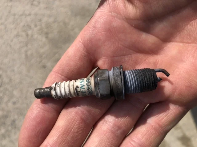

Replaced all the sparkplugs and cleaned everything up.

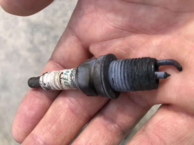

#1, #7, #8 plugs and coils were all super oily. All plugs were crusty, and little damp with oil, and crusty build up around the crush washers. Checked torque with the plugs that were in there and they were all less than or right around 10 lb/ft as that was a low as my wrench went.
Vacuumed out the tubes and cleaned with a rag on a wire as best I could. New Denso TT plugs all torqued to 17 lb/ft and engine, reconnected the battery, & buttoned back up. Car started a little slow, not sure if its my sluggish Optima or if the starter is starting to struggle. Going to get a better battery before I dive into the starter.
Drove around to relearn and the car drives great with new (tight) plugs and new DT headers. The exhaust was smelling a little gassy before replacing the plugs and now I don't notice it anymore. I'll recheck the plugs in a couple thousand miles.

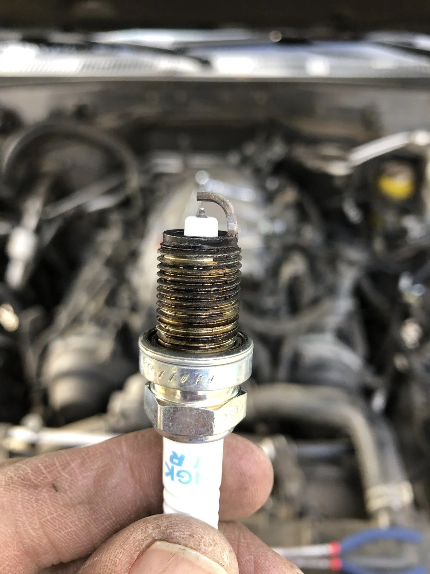

I went through and replaced my plugs in early October as I found all but 2 barely snug and all the electrodes rounded off. I am thinking I may have gotten a set up of fake Denso plugs. I replaced them with a known set and torqued to about 16ft-lbs. Well 4 months later, I replaced the coil packs and check the torque. They were all still within spec.
I just learned about this problem this morning. I was changing my oil anyway so I decided to check the status of my plugs as long as I was already wrenching. Very glad I did! All of mine were loose with the exception of the front most plug on the passenger side. I was very surprised at how loose they were. I decided to order new NGK plugs and will install those when they arrive but for now I just went with "pretty tight" with a standard 3/8" ratchet.

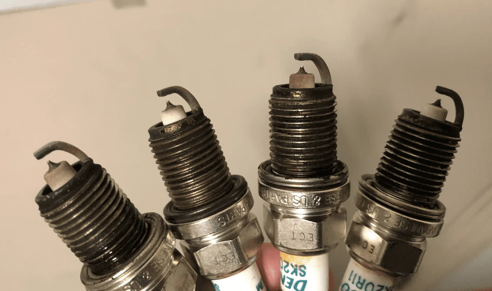

I think all of my spark plugs could be consider as "Normal" or "Normal life"? and the one with a lot of oil was caused by a leaking sparkplug grommet? Am I right?
