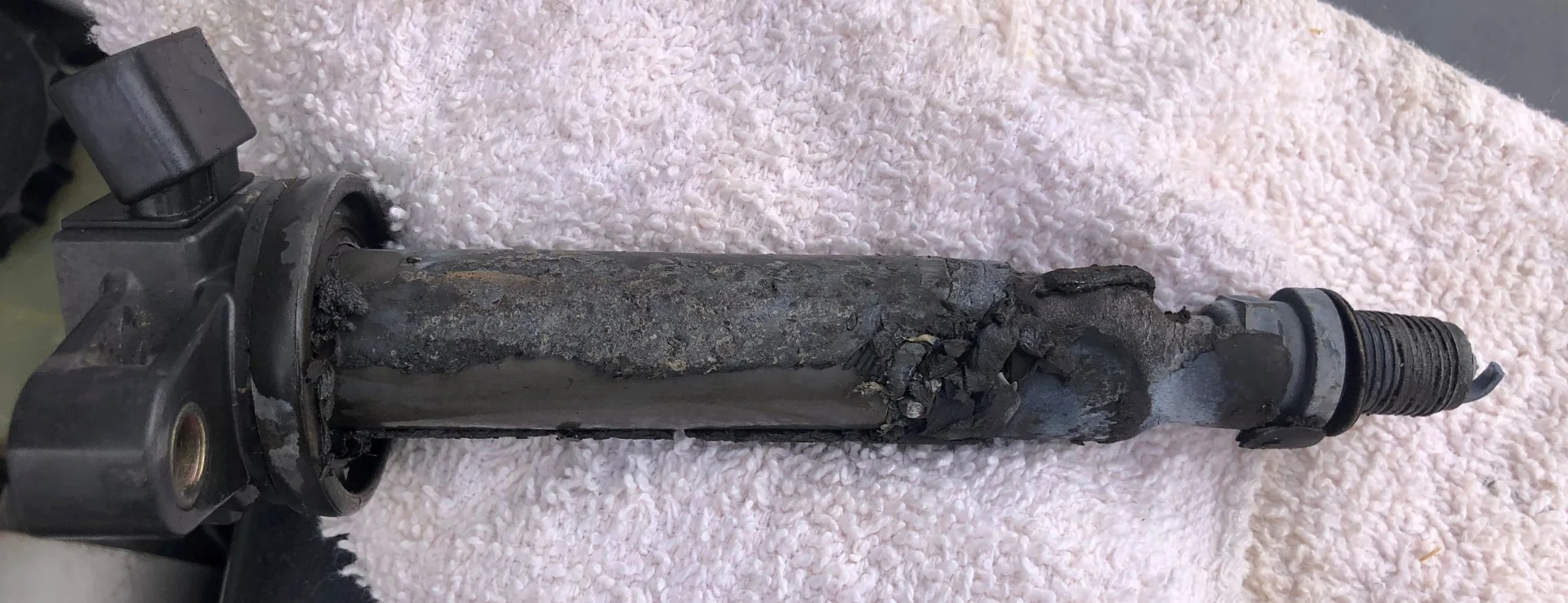

Want to see what worse-case scenario looks like. Plug blew out. This was #4. 2006 LC with 140,000. I have had it 15,000 and not checked plugs. Pay attention if you hear a tick:

My son's 2004 LC blew out #5 Spark Plug at 230K miles in December.
Took it to a respected shop in Charlotte and they said they needed to pull the heads too - for $2,500 est.
They searched around for a used head and could not find one.
Then they installed a TimeSert or Helicoil - not sure which - for $600.
The LC is running great today so one should be OK with a repair like this.

A tick noise is hard to describe but think light tapping that changes with RPMs. In my case the noise only started to be audible this day it failed. But about 1 month and not too many miles ago I had a CYL4 misfire, pulled the coil - which had a big crack - put in a spare and the misfire went away. Too bad I did no think to check the plug at that time.
