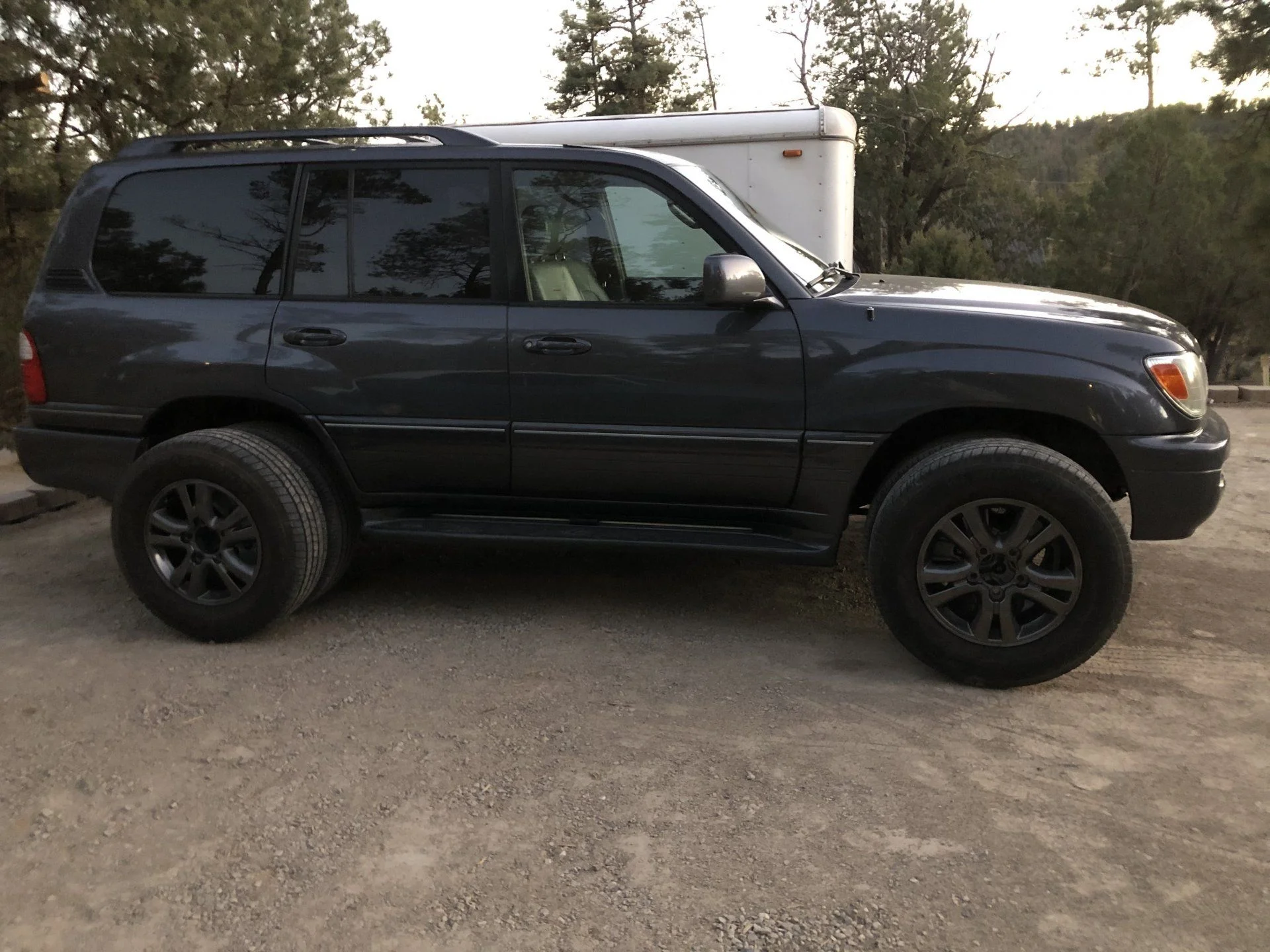

Bought this 2005 LX470 with 196k miles in Albuquerque back in December in hopes of replacing our 2011 LX570 with it. My wife signed on and we were off to make a deal.

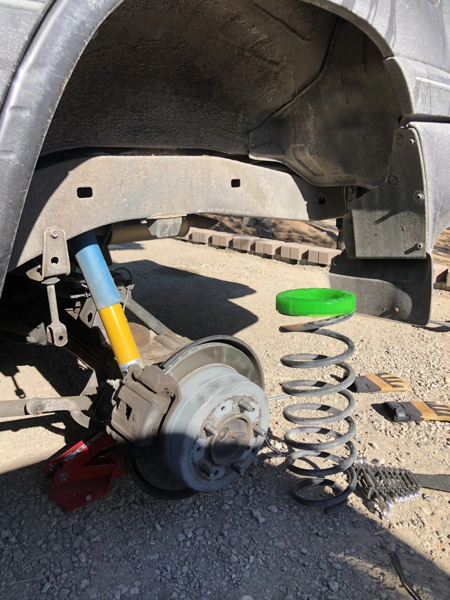

So I got a decent deal because the AHC went up and down but rode like trash. I talked with @suprarx7nut about possible issues but ultimately decided to replace with stock LC springs and torsion bars (free from my brother in law). I replaced the shocks with Bilstein 4600s and added 30mm @Ironman4x4Bubba spring spacers to give it a 1” lift.
Rides great now.

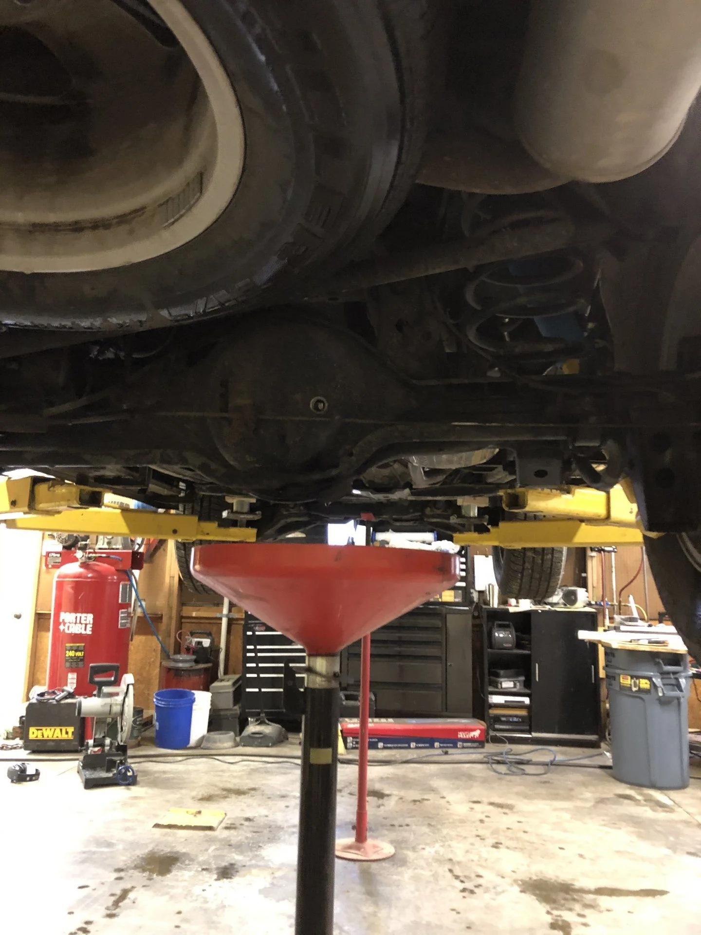

Decided I needed to baseline the driveline fluids, so at 198k miles I drained front and rear diffs and filled with 80w-90 diff fluid. Worst smelling stuff. Also had a local shop replace and repack the front inner and outer bearings at the same mileage.

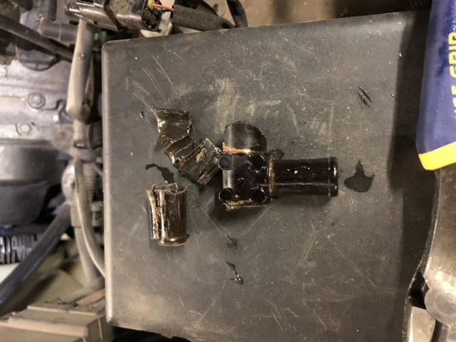

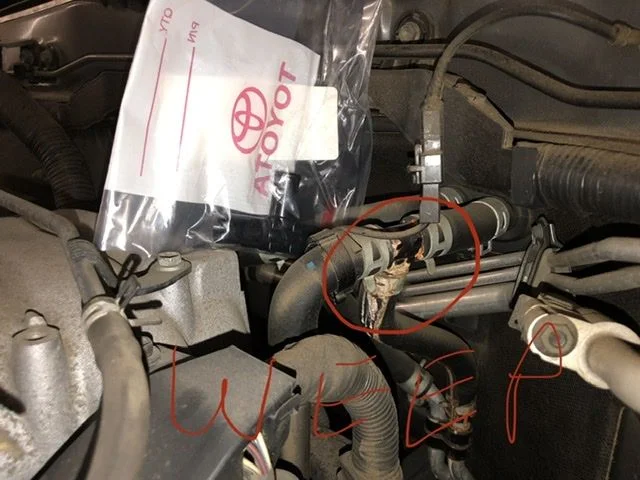

while I was in Tulsa, I stopped by Fowler Toyota and bought a heater tee to replace the ticking time bomb I had sitting back there at the back of the engine bay.

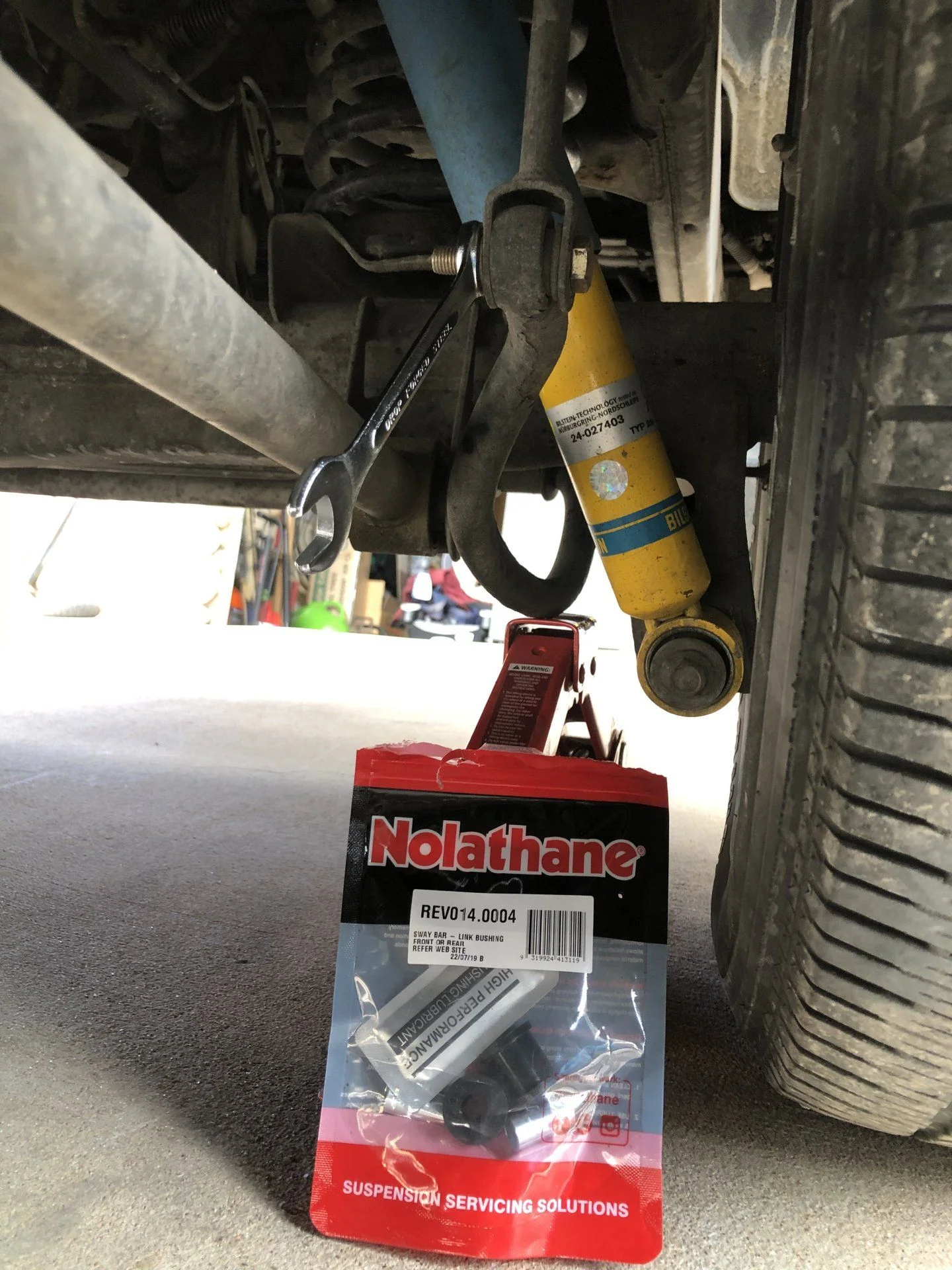

Then I replaced the rear sway bar eyelet bushings:

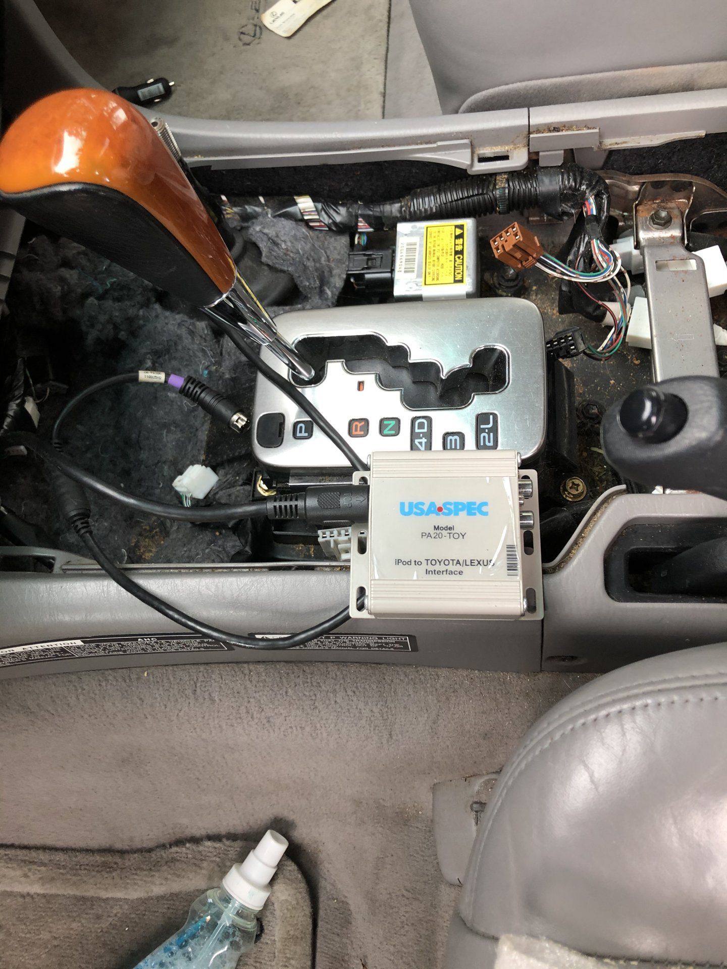

As I was leaving for my trip to Tulsa, I noticed if I push the disc button 2 times it would bring up a MD emulator screen. And on the screen it said “iPod off”. I knew there was something special so I decided to investigate and clean as I went.
Found a USA Spec PA20-Toy iPod interface with a broken iPod cable. So I just hooked up the aux in with RCA-1/8” cable. Works great.

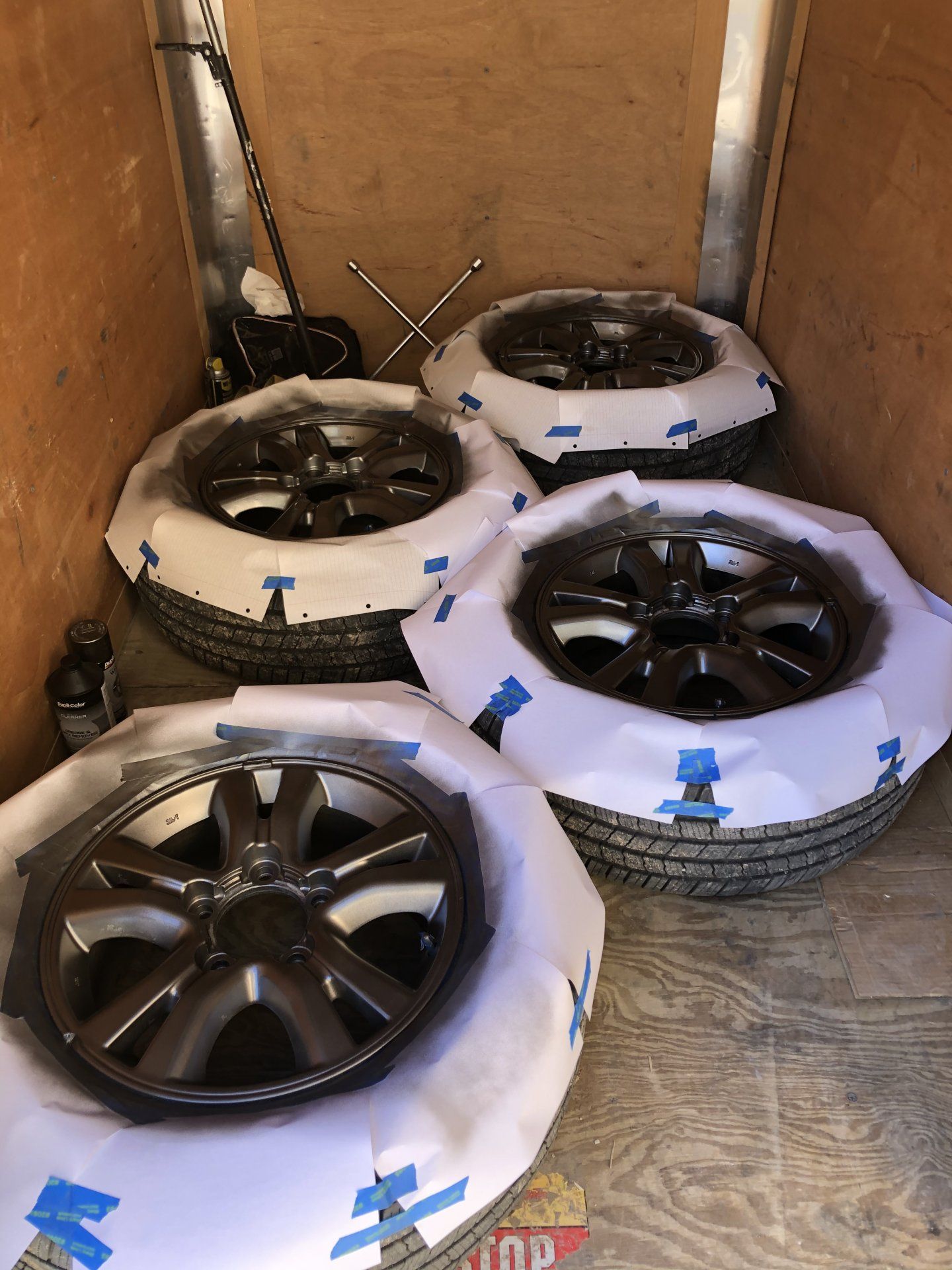

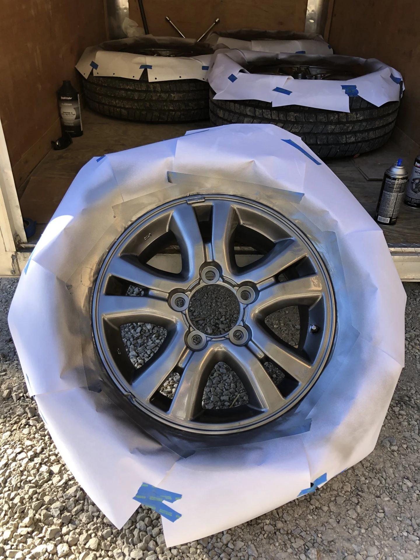

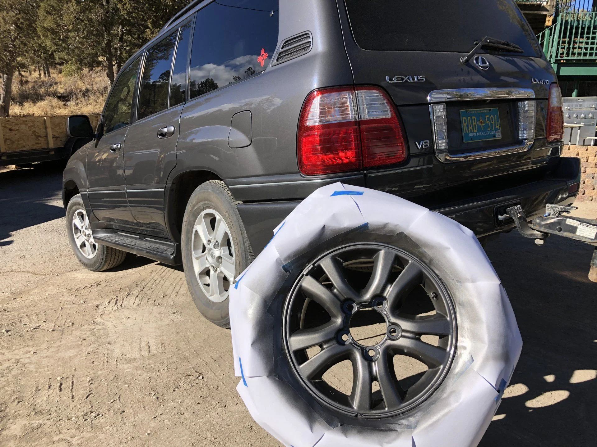

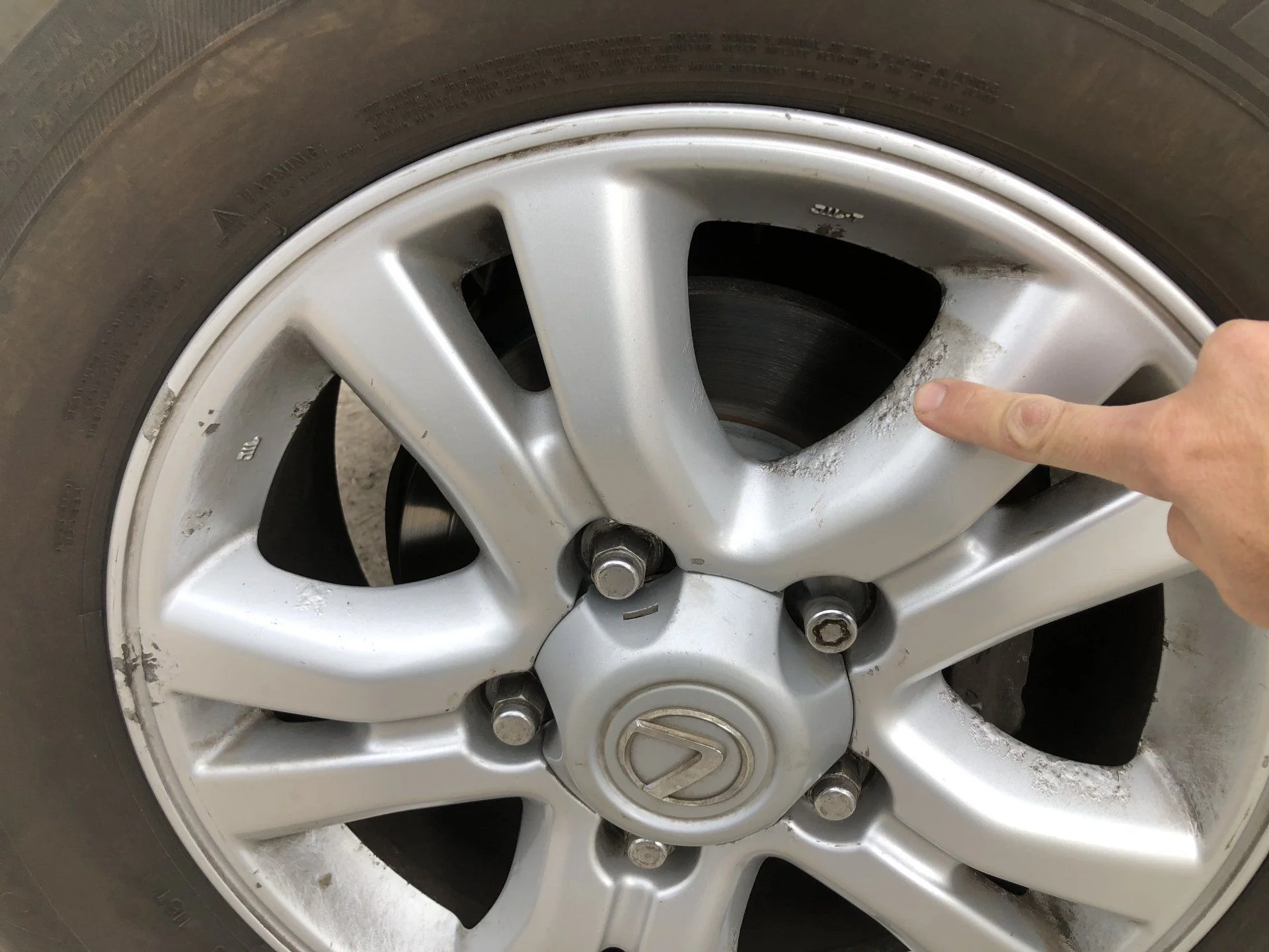

Today I finished prepping the OE 18” LX wheels for paint. I put the ugly bald tired Tundra 18” wheels on it while I painted the OEM ones with Duplicolor Graphite Gray and finished off with VHT clear coat.

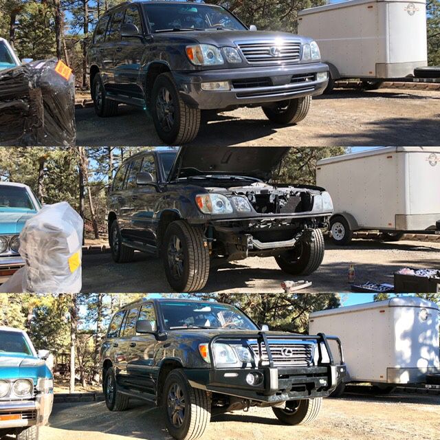

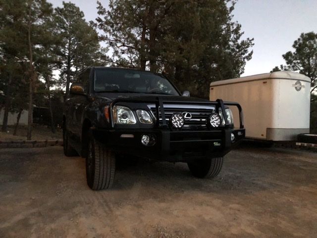

5. Wait forever for my TJM bumper to ship and install it. We have elk and deer around here by the thousands. And I frequently hunt hogs in west Texas (where I have hit a hog while going 75mph) and those suckers will jump out and get you.
**edit: cancelled the TJM order when I saw a fluke Ironman4x4 bumper show in stock.

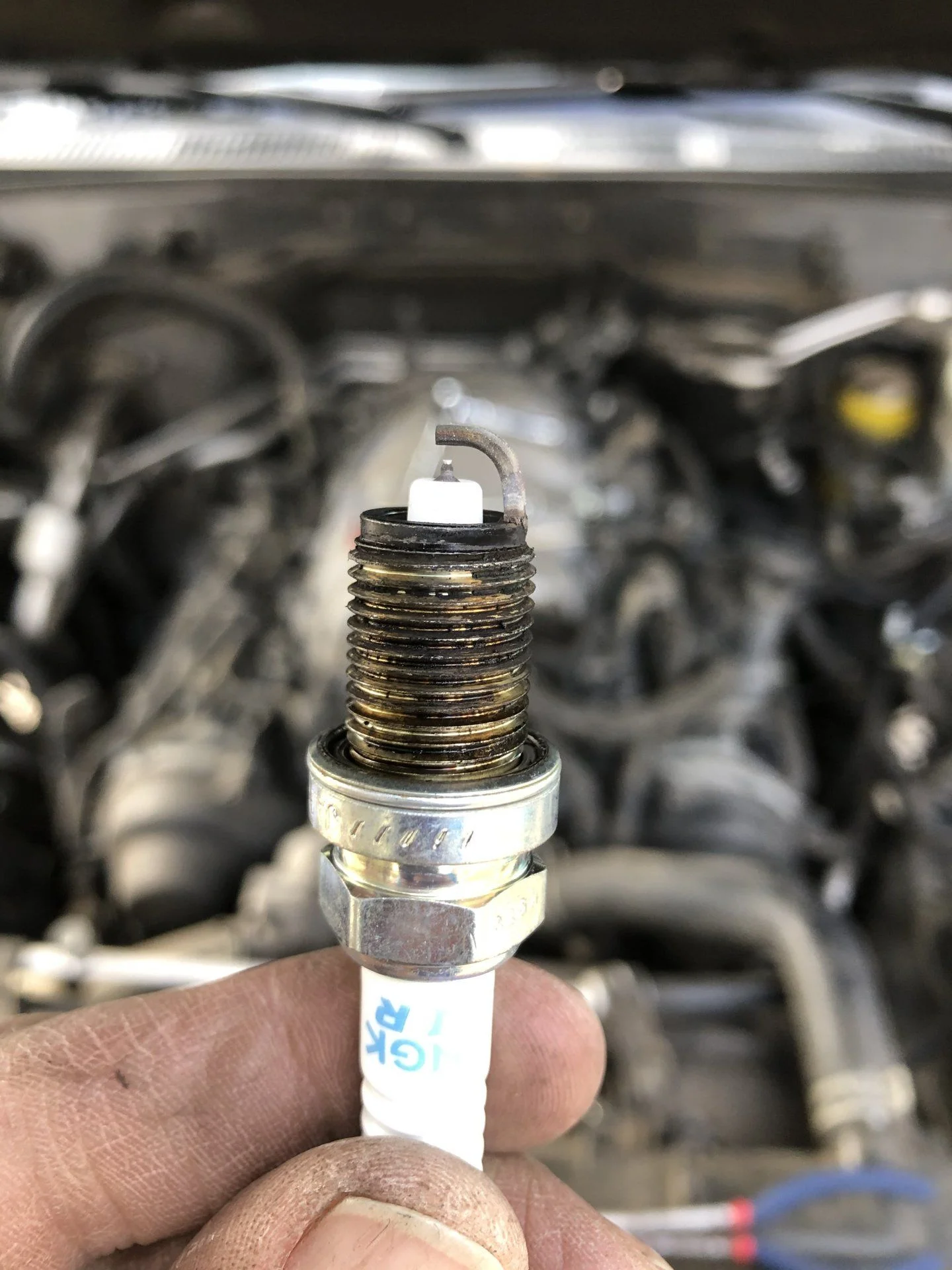

I decided to investigate the new to me 2005 LX470 spark plugs and coil boots. Turned out all 8 weren’t close to torque spec.
All plugs looked new, coils/boots were all in good shape (no cracks), plug sockets all bone dry 👍, valve cover gaskets dry as well.
So I torqued to spec and put it all back together with peace of mind that it’s done and won’t leave me stranded. Thanks for the heads up, this forum is the 🎁 that keeps on giving.

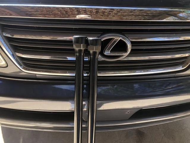

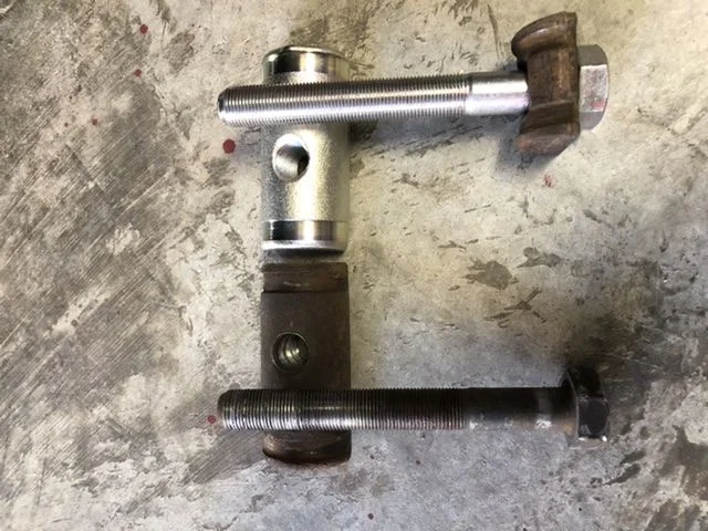

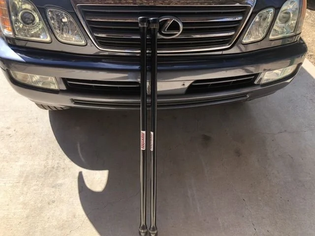

Sway-a-way (sway away) torsion bars received. Ordered on 1/27/2021, delivered 10 minutes ago. Still waiting on the Ironman4x4 bumper to ship. Ordered last Monday and still “awaiting fulfillment”.
Well packaged and marked for offset.

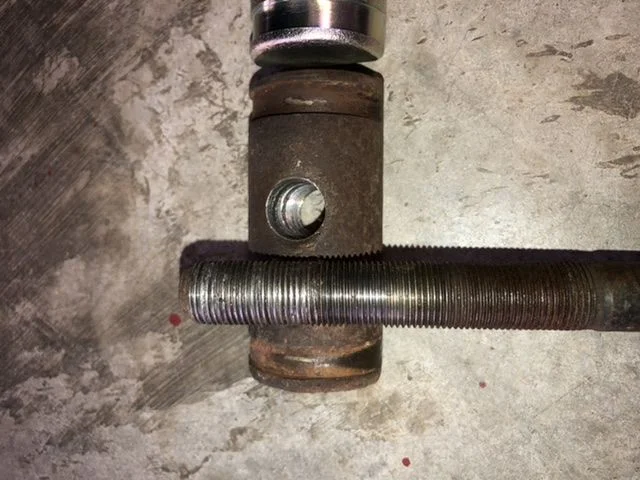

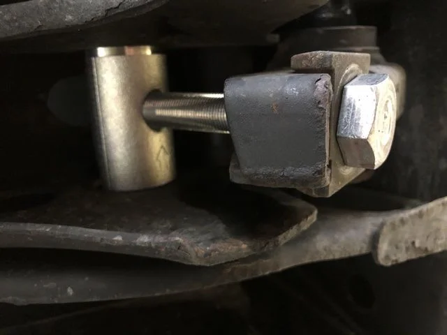

One minor hiccup installing the torsion bars. I must have got some dirt or crud in the threads when I installed the LC bars before, but the driver’s side adjustment bolt and swivel nut were FUBAR.
