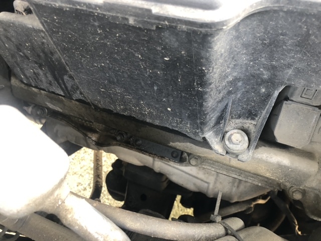

I may be a fool I’ll see how it turns out: I drove home (knocking the whole way) so I could leave my kids. Coolant temp stayed fine throughout the drive at 186-190. Just as I pulled up to my garage at the top of a 1/2 mile pretty steep hill I smelled burning and saw smoke so I just shut it down. Temp was 195 rising to 197 when I shut it off. I don’t think it got too hot but there was definitely wet oil leakage on passenger side of block. Maybe from the coil? It’s under the air box which I haven’t taken off. My guess is #4; that’s where it sounded like the knocking was from and also the first misfire code it threw.

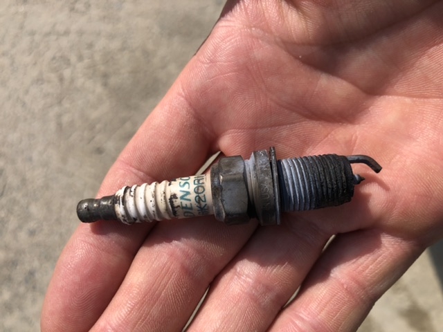

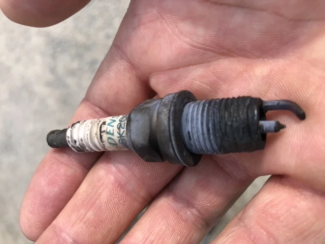

#4 spark plug blew out. Probably had worked loose and that caused the knocking? Then the drive home was too much for it; I think it blew out in my driveway (almost made it). The shop’s going to try a helicoil in the head. Fingers crossed….
