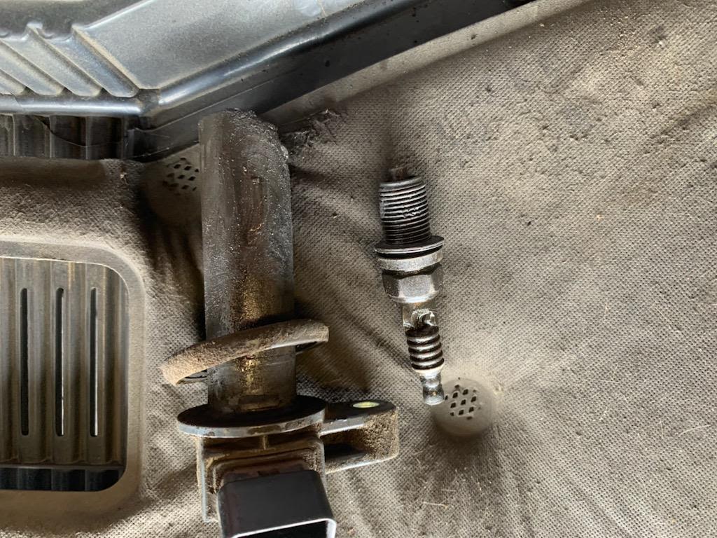

Be alert, so you don't see a spark plug blow out the head:

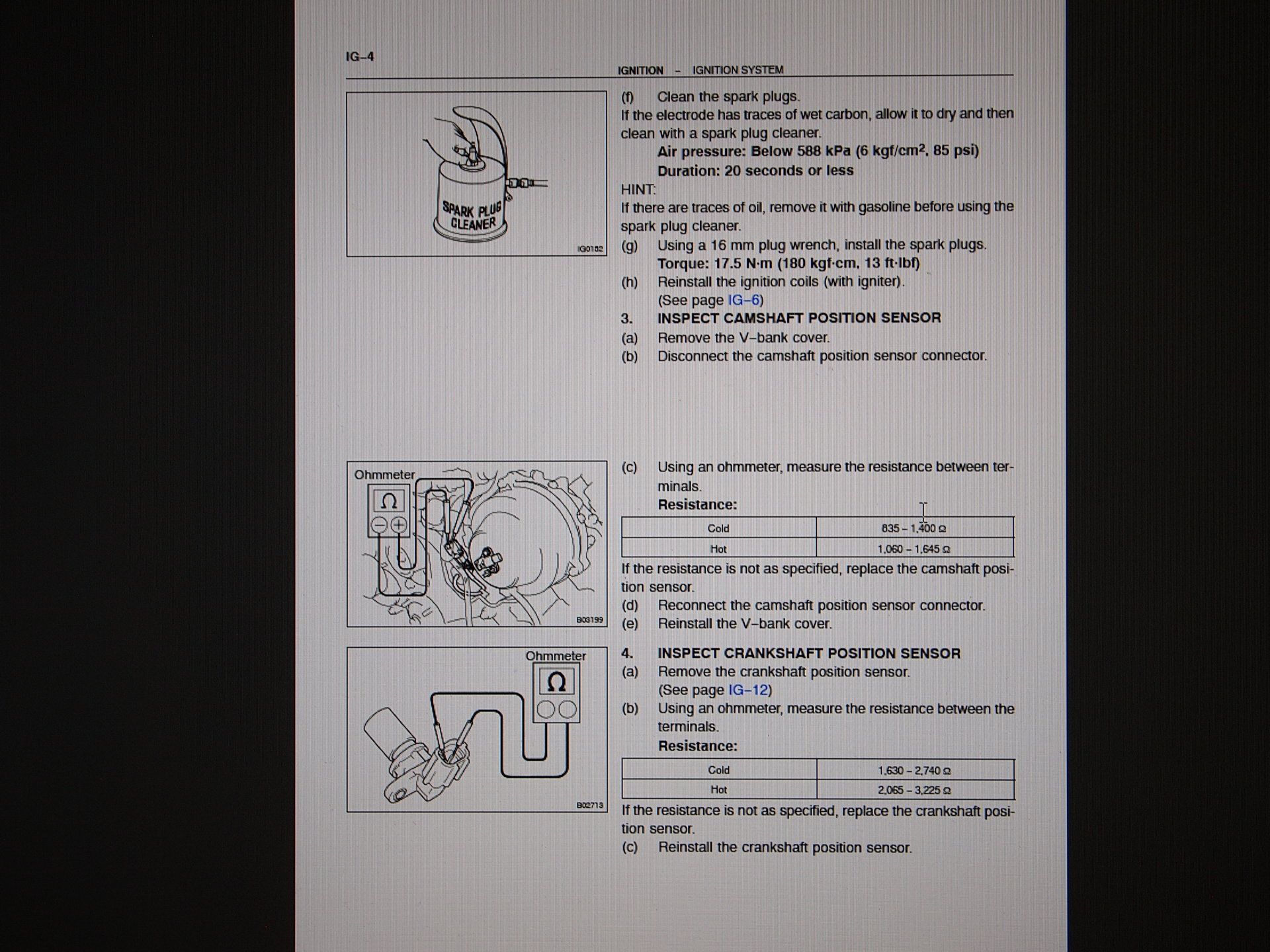

BTW, what is the recommended tightening torque?
Factory spec is 13ft-lbf.
But I'm using 18ft-lbf from a range Denso torque chart gives. Use this higher torque, at your own risk.

Final torque to 13ft-lbf is the FSM recommended. I use 18ft-lbf.
Typical on new Denso I see a gap of 1.09mm

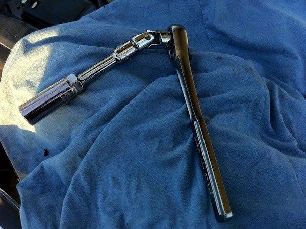

Here are tools I'll use.
You can do without the pliers & screwdriver. Also you'll find tools in your Land Cruiser tool kit with exception of torque wrench to do the job.
Oh and my 3/8" Universal. Use with the short (3") extension above for #7 spark plug. Works great.
This old tool is great for hooking on wire housing blocks to pull them off.
Here set-up for #7 & #8 plugs. Use breaker or ratchet to remove.
1944394
This has become my favorite style, which few different manufactures make. Has swivel build in, so can't separate while in the spark plug tube.
