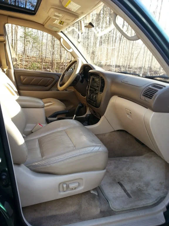

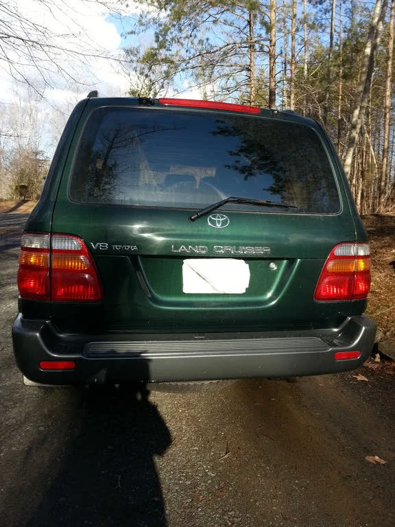

These are actually the photos from the listing online from about December 2018. Not bad looking for 480,000 miles at the time and only the second owner. And for the whooping price of $2,250 I decided to go crawl under it and check it out. I swore to my wife I was just going to go look at it and wouldn't make it any rash decisions without her...lol I drove it home. The guy selling was not a car guy but he basically took to Toyota whenever he had an issue and let them do whatever they told him it needed. Not the world greatest maintenance records but good enough and very little rust aside a bubble spot on the rear hatch and some surface rust on a cross member.
As my wife began raging into the phone about why I bought this the check engine light came on...luckily it was just an O2 sensor. But thus began a solid 9 months of wrenching just about every other weekend on it.

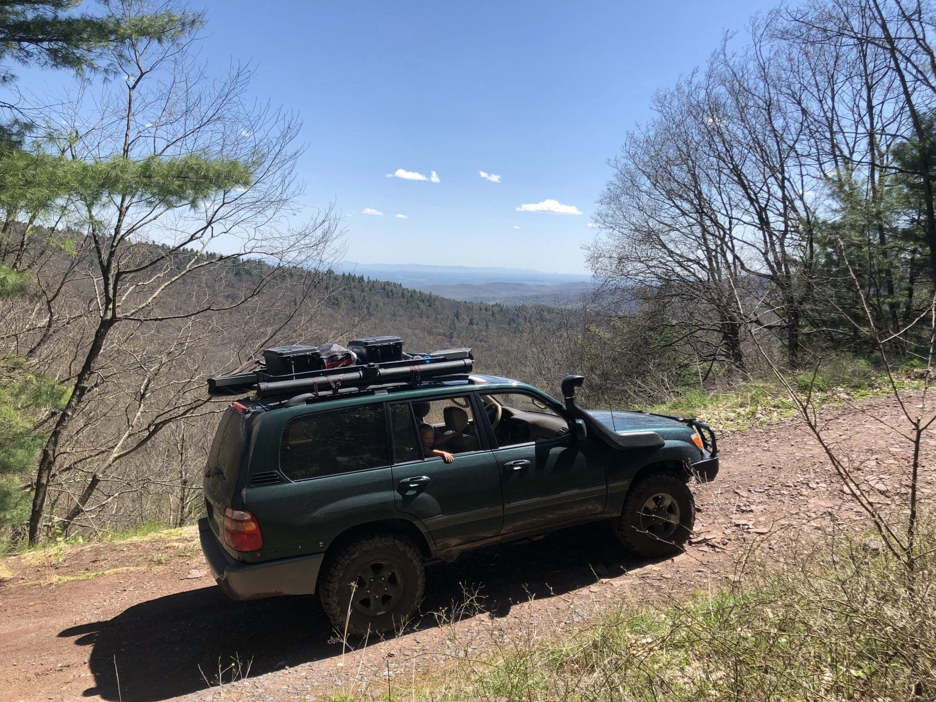

Been all over the Virginia/West-Virginia mountains, Asheville, done about 3 trips to Florida and back, camping on the beach in SC and the OBX, all with our three kids 4 and under.

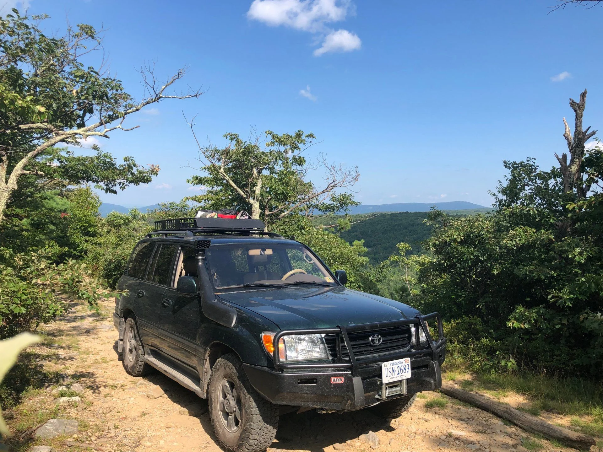

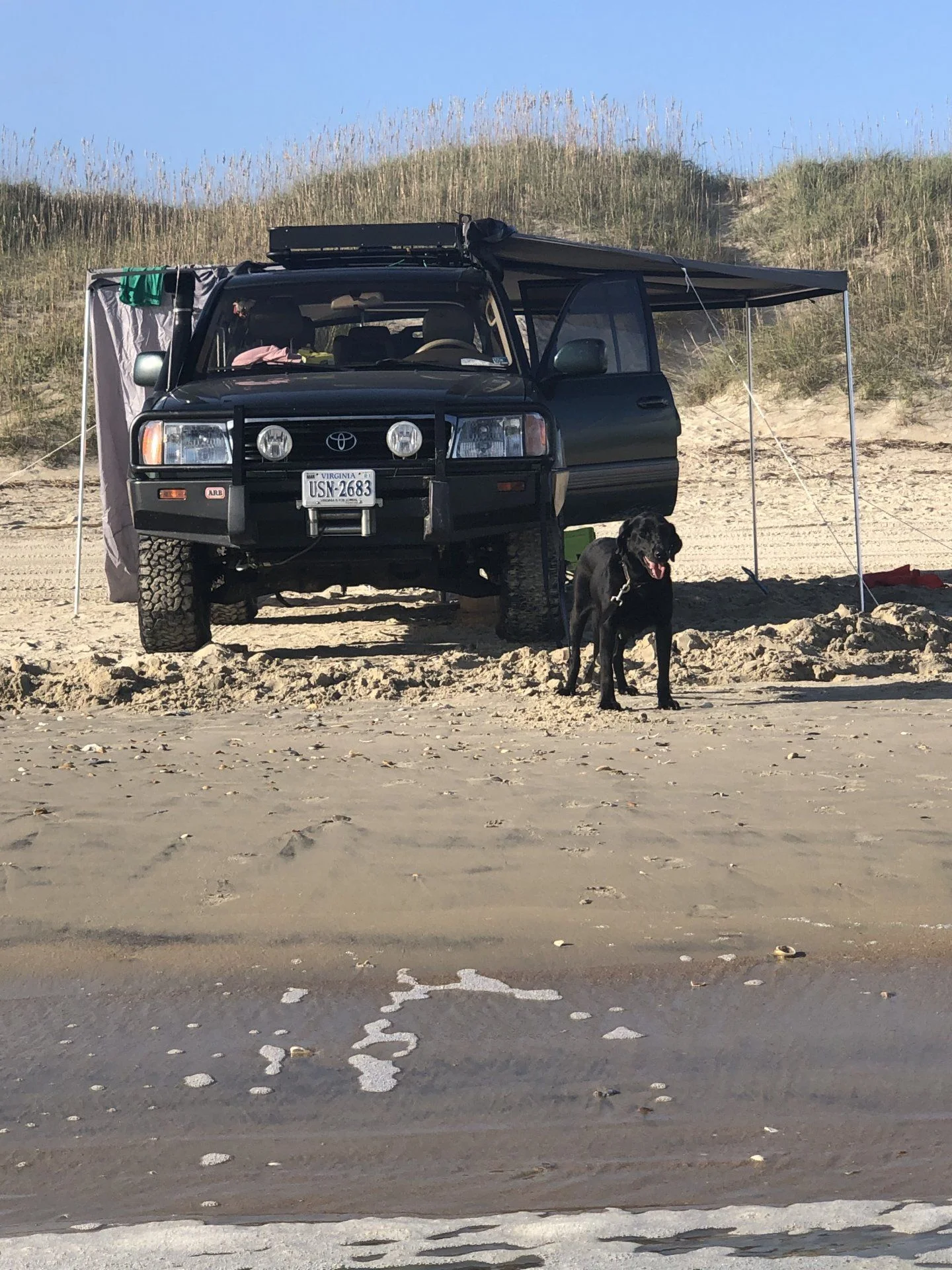

Here is some photos from trips over the past year and a half, the evolving truck, and the growing pinstripes.

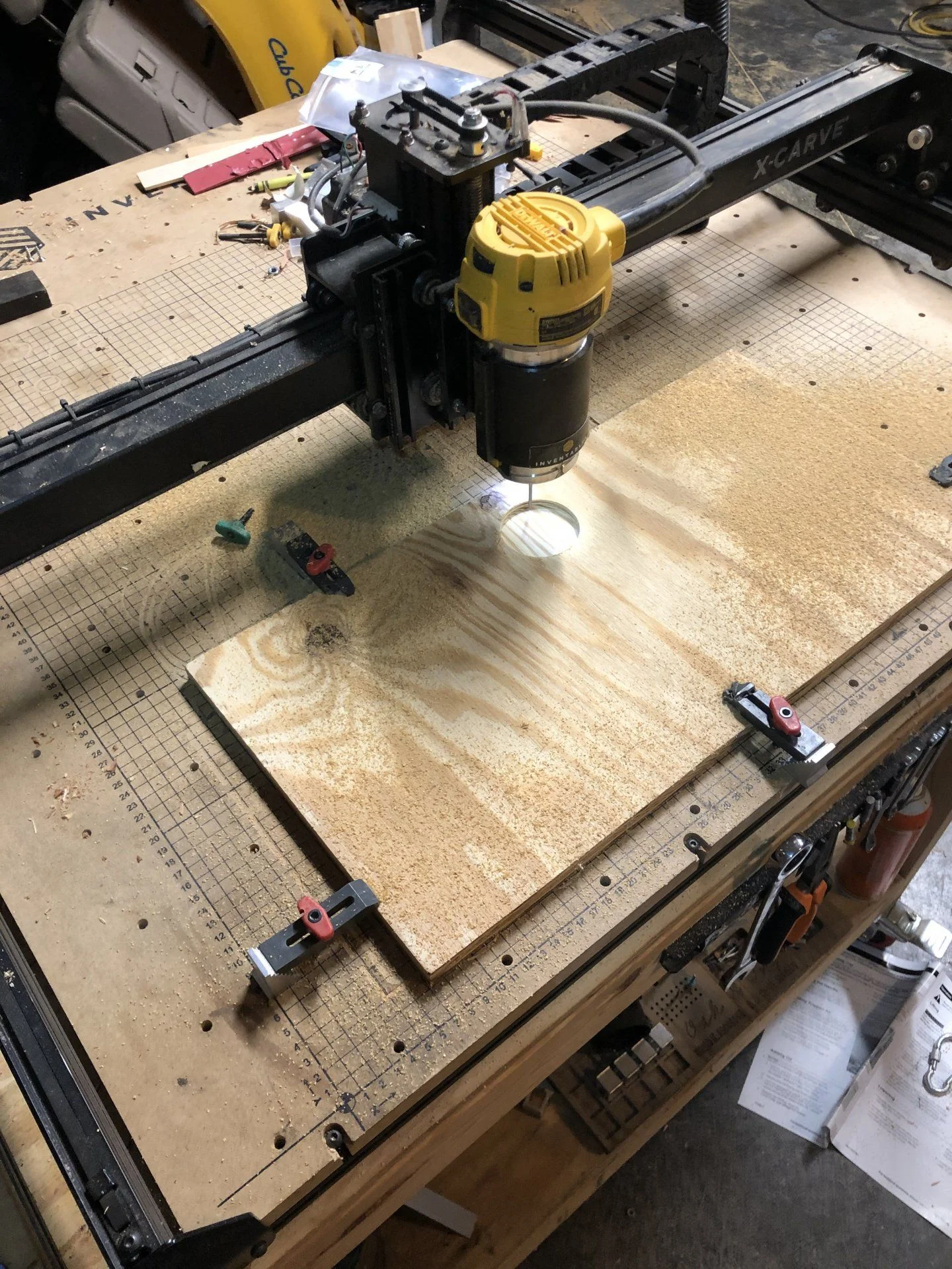

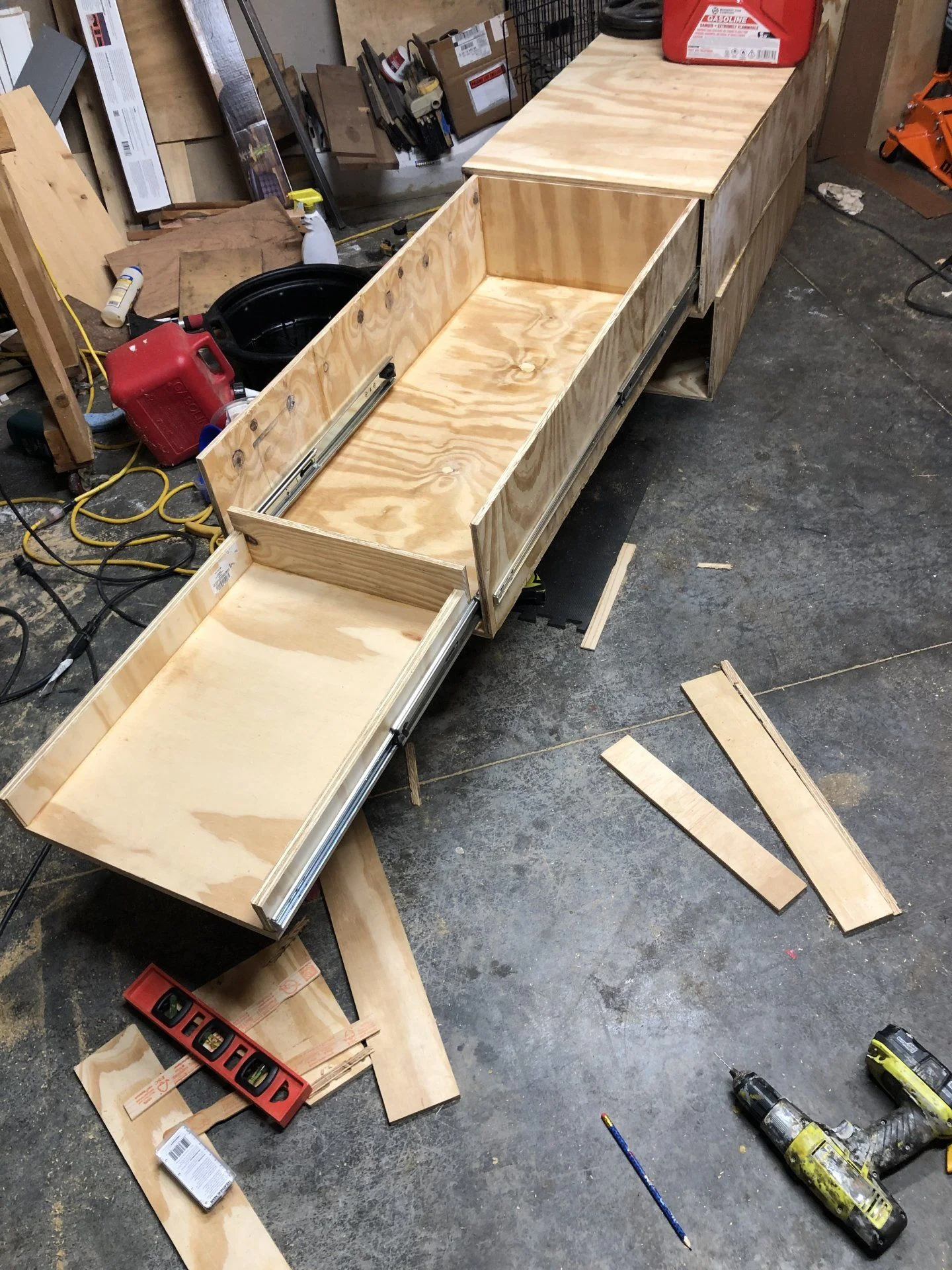

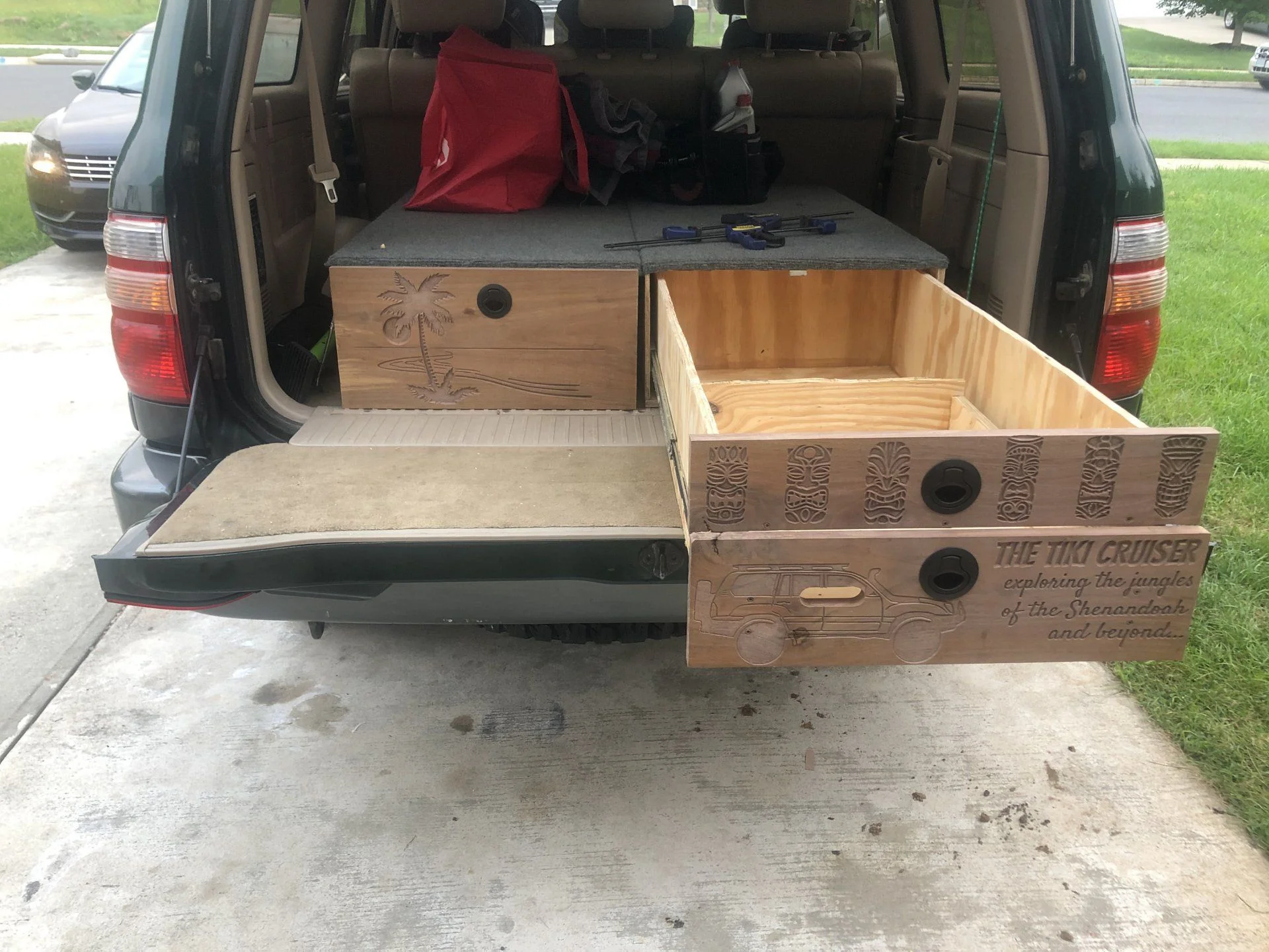

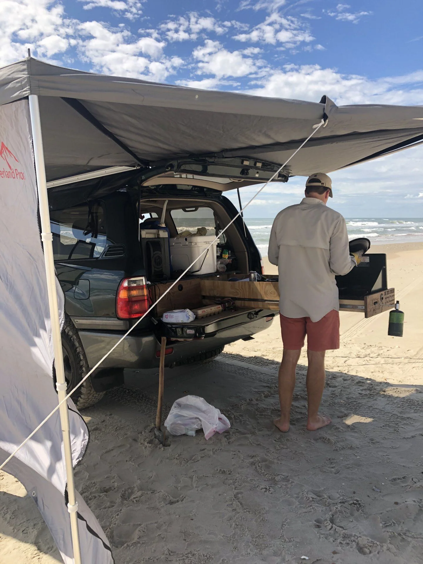

Over the end of summer I built a drawer system and since then it has evolved into The Tiki Cruiser. This is perhaps where my build is a little different than others. A lot of people doing building up their overland rig go for for real hard, intimidating, military style gear and equipment and the color coordination consists on getting all black. Of course this makes sense and usually practical, but I'm going a for a different angle now.
First thing was the drawers which provide a good quick kitchen and bar work station set up. I used my CNC router to produce a good chunk of it including the drawer latches and the carved drawer faces. System consists of two independent drawers of an eclectic combination of 3/8", 1/2" and 5/8" plywood to save weight and so that one drawer can be removed a third row seat added. The passenger side drawer has a 22" slide within it for the coleman stove.
Later on I added folding wings with fold out supports to the top is a true flat platform to pack everything else, and make the area around the wheel arches a little more usable as storage. The drawer faces themselves are walnut and I've added a couple coats of satin polyurethane.

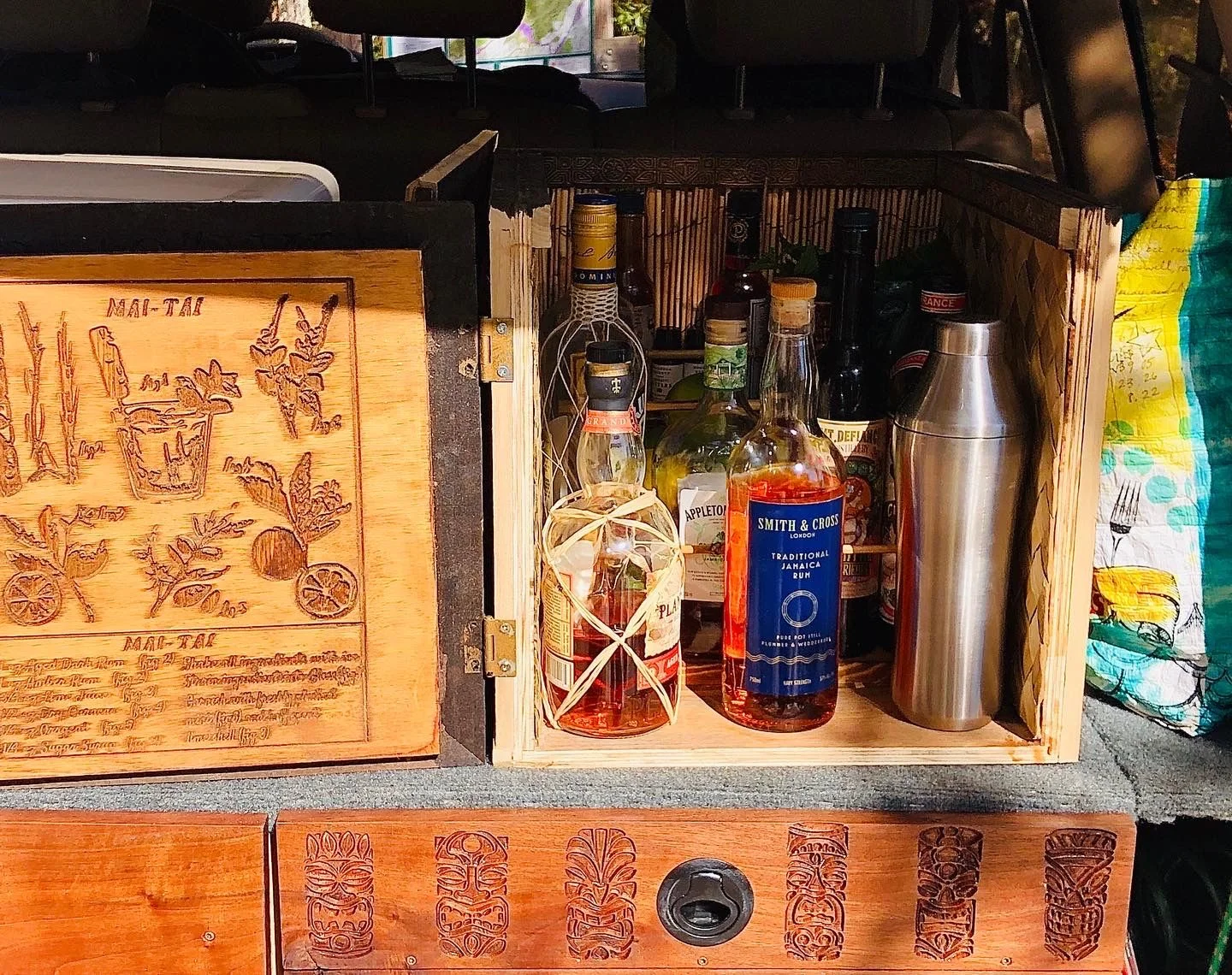

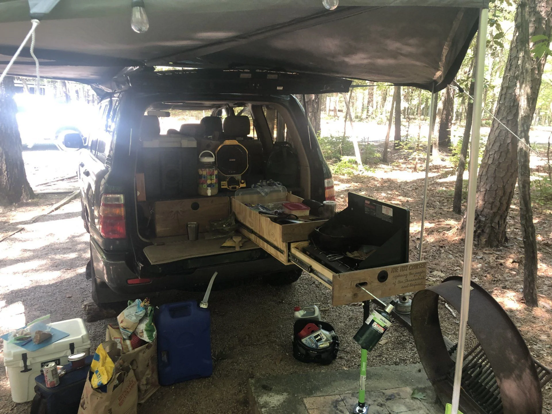

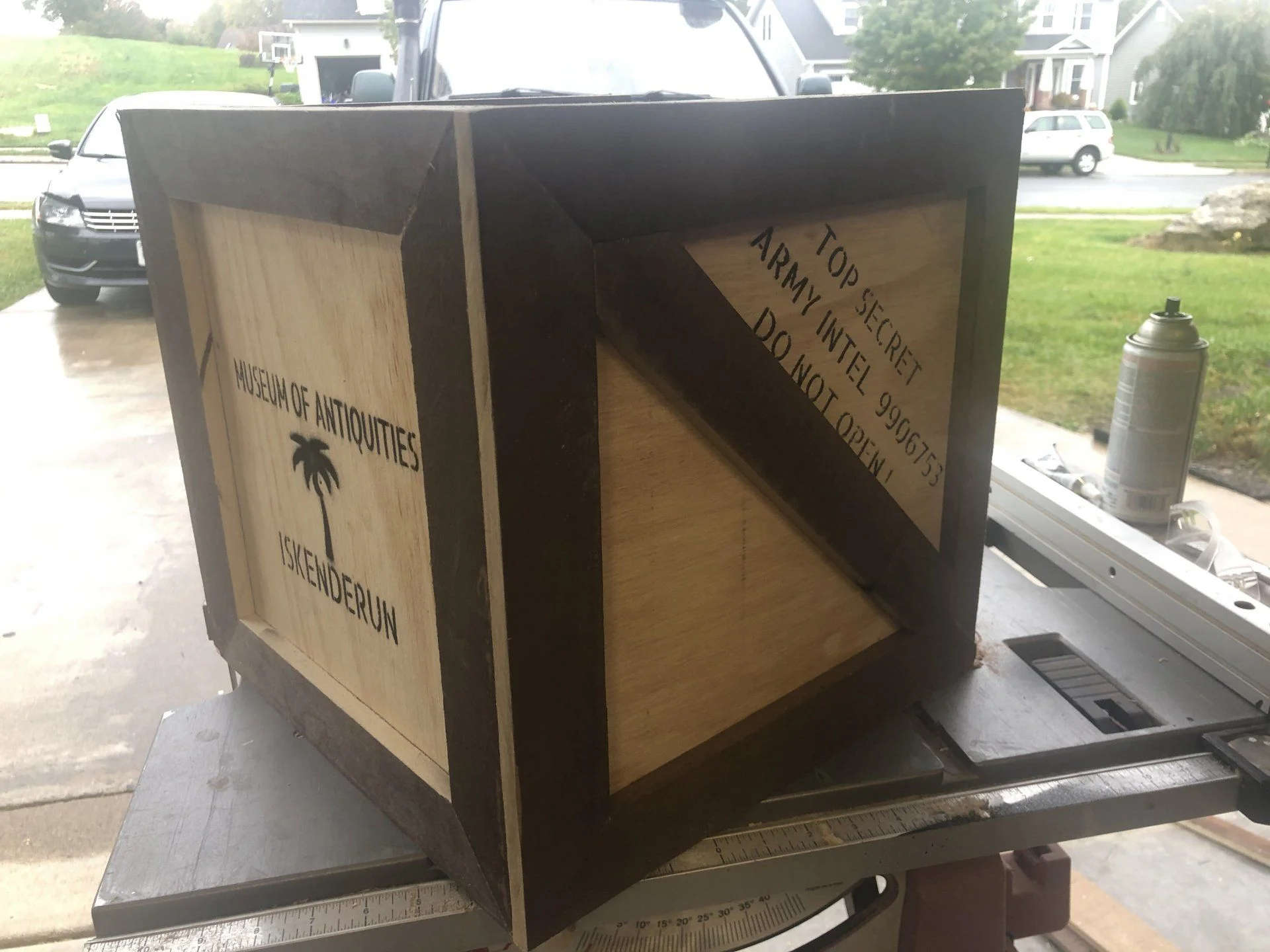

I've always been the designated bartender for our group whenever we go camping and pretty much the reason I like overlanding/off-roading is basically to have a cocktail and a cigar in interesting places. Also I like to do some good eating while camping out. Part of this has been to prove to the wife that dispersed camping can become glamping if you're prepared enough. I usually bring about 4-5 homemade bar syrups (orgeat, falernum, grenadine, simple syrup, etc) and multiple rums, bourbons, curcao, triple sec, etc... With the drawers I now have a very functional and good looking platform to work off for juicing fresh lemons and limes, making some food. With the pvc shower tank I hang the nozzle on the lift hatch strut and its like I have a sink and running water. But till now Ive never had a good solution for bring booze into the wilderness. I usually stuff it all into a reusable trader joes bag and listen to all clink all around down the trail and its a total mess grabbing the right bottles and getting stuff out of it and it doesn't pack. So I finally decided make a solution. Introducing The Tiki Crate v1.0 for beta testing:

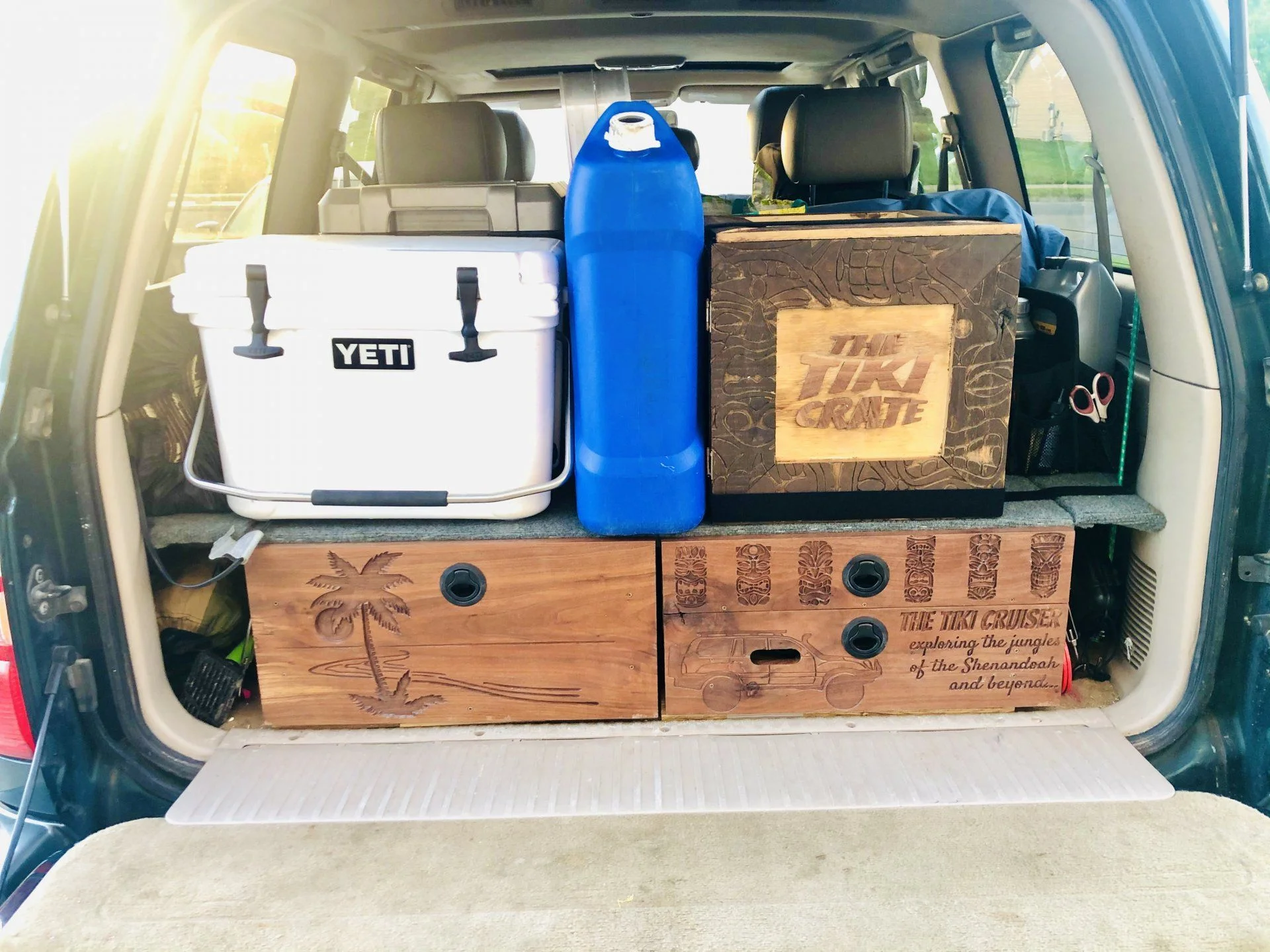

Now, its not finished as I broke one of my bits on saturday and couldnt finish the inlay popout lettering for the front and I still have to stain it all and lacquer/urethane it. And I'm waiting on some cherry for the cutting board which will be integrated into the top so after pop open front door (which utilizes a secret hidden push button in the forehead of one of the carvings) you can slide the top off, flip it over, and it becomes a cutting board with a juice trough and monstera leaf inlay.
Inside it's a 4 tier shelf with bamboo railings and 3D carved tiki heads to separate the bottles. I took the crate out for a Sunday Safari yesterday on a trail and it did pretty good, a need a Velcro strap hold down on the carpet I think, and it had very minimal glass clanging but I'm going to tie braided jute rope between the bamboo railings and make them slideable bumpers between the bottles. Inside of the front features a decorative carving of a mai tai recipe artwork, sides are lauhala weaving, back is a reed wall fence, and a carve trim crown piece all around the top.
Also used my cnc to make some stencils to give the outside some mystique and pizzaz, plus 2 points if you know the references.

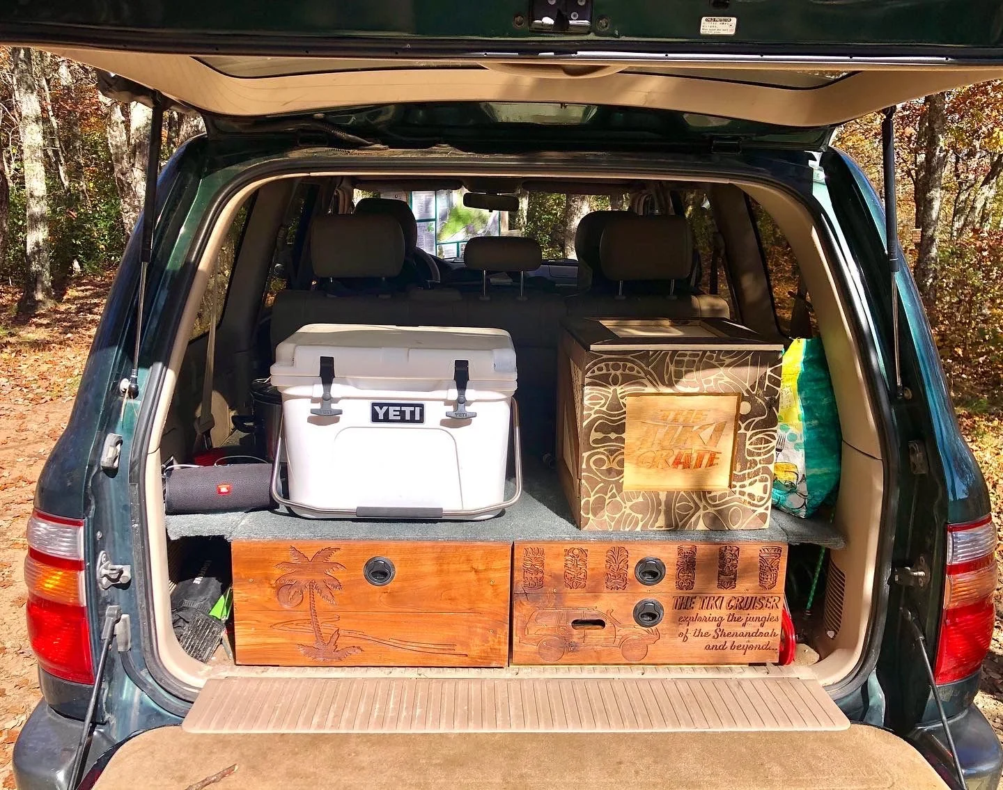

Over the end of summer and since then it has evolved into The Tiki Cruiser. This is perhaps where my build is a little different than others. A lot of people doing building up their overland rig go for for real hard, intimidating, military style gear and equipment and the color coordination consists on getting all black. Of course this makes sense and usually practical, but I'm going a for a different angle now.

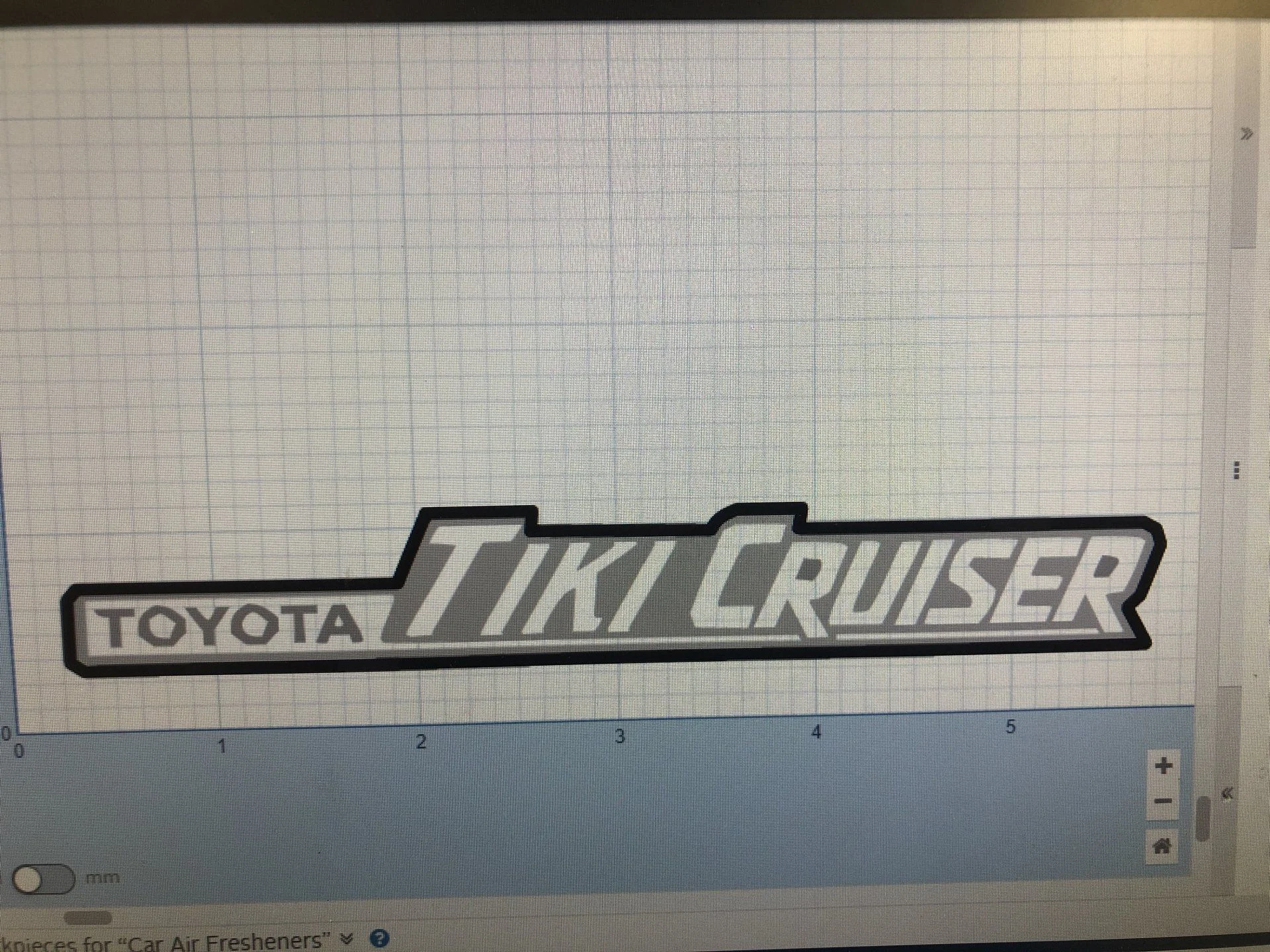

New badging inside and out.
This is what I've drawn out so far. I'm gonna try machining it out of MDF material and some chrome spray and some shiny coating material for the drivers side rear quarter area or the rear hatch. And then carve this out of walnut, cherry or cedar with a rustic wood look for the inside.

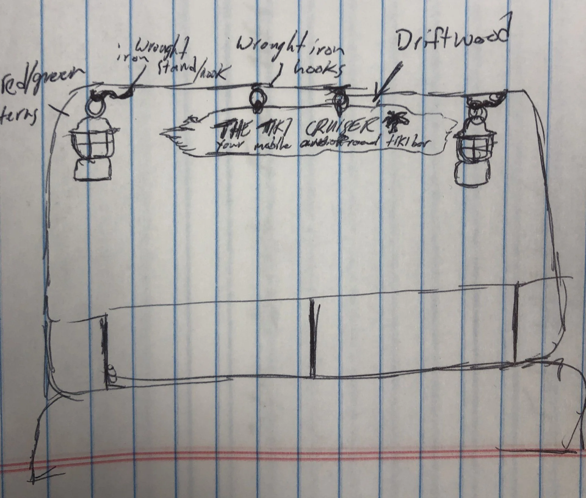

Next, and excuse my doodle but this how I work:
Using a piece of distressed driftwood I'll carve a sign with design or similar and hang from the inside top of the cargo area using some antique wrought iron loops I've yet to source. On the left and right side antique red/green lanterns. What I'll have to do is come up with a way to flip the sign and the hooks back when the vehicles moving. This I haven't figured out yet.

All packed and ready to go for Fall Crawl, now to just get through work. First time just packing for me and not 3 kids and a wife. Loads of room especially with 3 car seats out, barely anything on the roof except the tent. I don't know how some of you fill your car on a solo trip. I packed all kinds of outrageous extra stuff and still have room. Replaced the last o2 sensor so now theyre all <1.5yrs old...replacing the post-catalytic sensors actually seemed to make a difference, it seemed to be running rich and the exhaust had a smell to it that seems to be gone.... Put on Trail Tailor recovery points, had been using the stock ones but they don't fit a d-ring so I could only use them with the hook off the winch. And while I did that my machine finished the walnut inlay lettering for the crate.

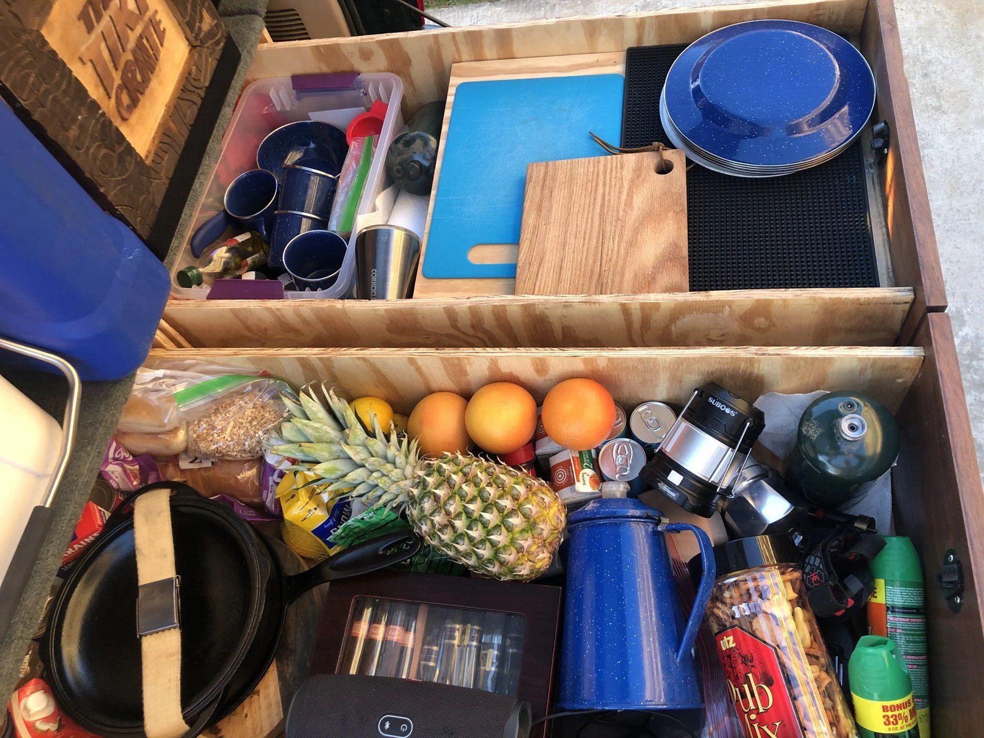

Here's a peak inside the drawers, they're still not really finished. I haven't decided If I'm gonna make insert dividers for the "pantry" drawer. As you can see on top drawer, for now I just have plywood above the stove with I put the bar tender mat and a cutting board on usually, and then I just stick our "kitchen" tub down next to it. Eventually I will have silverware/utensils caddy to replace the plywood above the stove. I already started making some cutting board countertops that will go over the caddy, span the width of the drawers, and rest on the sides of the drawer so that when you want to grab some tongs, a knife, or whatever you just slide the cutting board over, grab what you need and slide it back. Probably will make some kind of divider set to get rid of the kitchen catchall bin.
As you can see only the essentials to survive the harsh wilderness...
