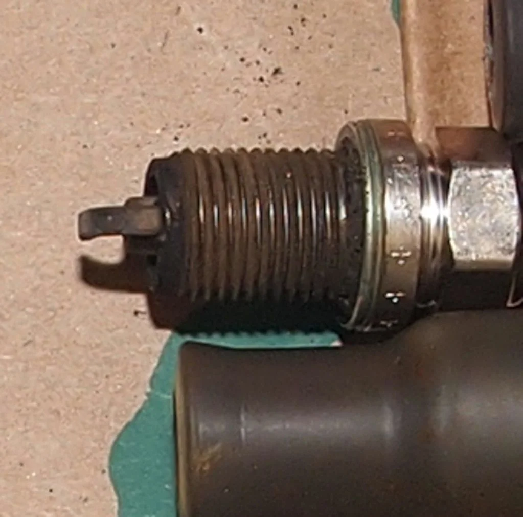

Here a picture of a spark plug that I did put anti-seize, 50K miles earlier. I torque to 13ft-lbf, which mean I actually had equivalent (due to lubed threads) of 18ft-lbf of torque.
Notice threads full of crud,. That crud is the anti-seize I used.
Coloration varies with how much combustion gases, passed the thread. This one above, had some combustion leakage. It walked out about 1/4 turn then froze. Some other in same engine, were more golden. Those plugs hadn't loosened, or not much. Others more blackened, they had walk out the most. All 8 plugs' thread where filled with crud. This was first time I'd added anti-seize, which I'll never do again.
BTW: It looks like I added a lot of anti-seize. That is not the case. I wipe lightly after applying the Anti-seize, out of fear I'd get copper in the engine cylinders/rings.

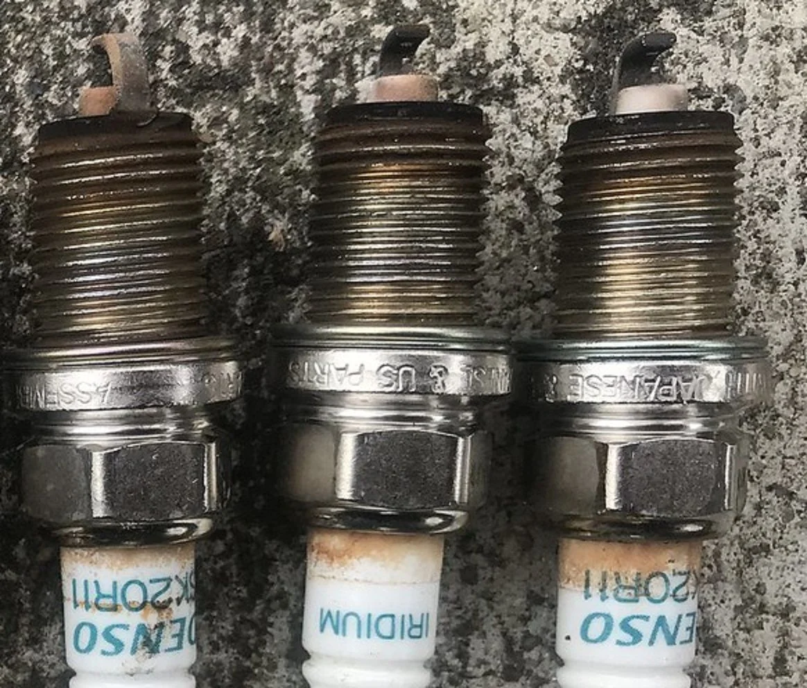

Here pictures of plugs, I believe, without anti-seize at a reported 75K miles.

But it's not the iridum electroid that's the issue. Most all spark plugs threads used in aluminum heads, are a nickel IIRC. It's thread design and low torque "we think." is the Denso issue.
Note: I don't see this freeze-up, unless anti seize used. Walking out and blowing out head yes, without anti S. But to get so bad as to blow out. Takes about 120K to 200K or more miles. It has to due with heating and cooling cycles IMHO. More so than miles. We can hear them leaking exhaust gases, way before that. Just turn down the radio once in awhile.
