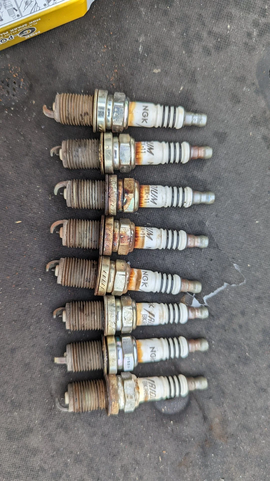

Wanna guess which ones were loose/leaking?
In my case, the bad ones were cylinders 3 and 7. The coil boots also looked nasty and had soot on them but no major damage. Glad you guys accidently got me off my butt and got these replaced on my lunch break today! Thanks again.
