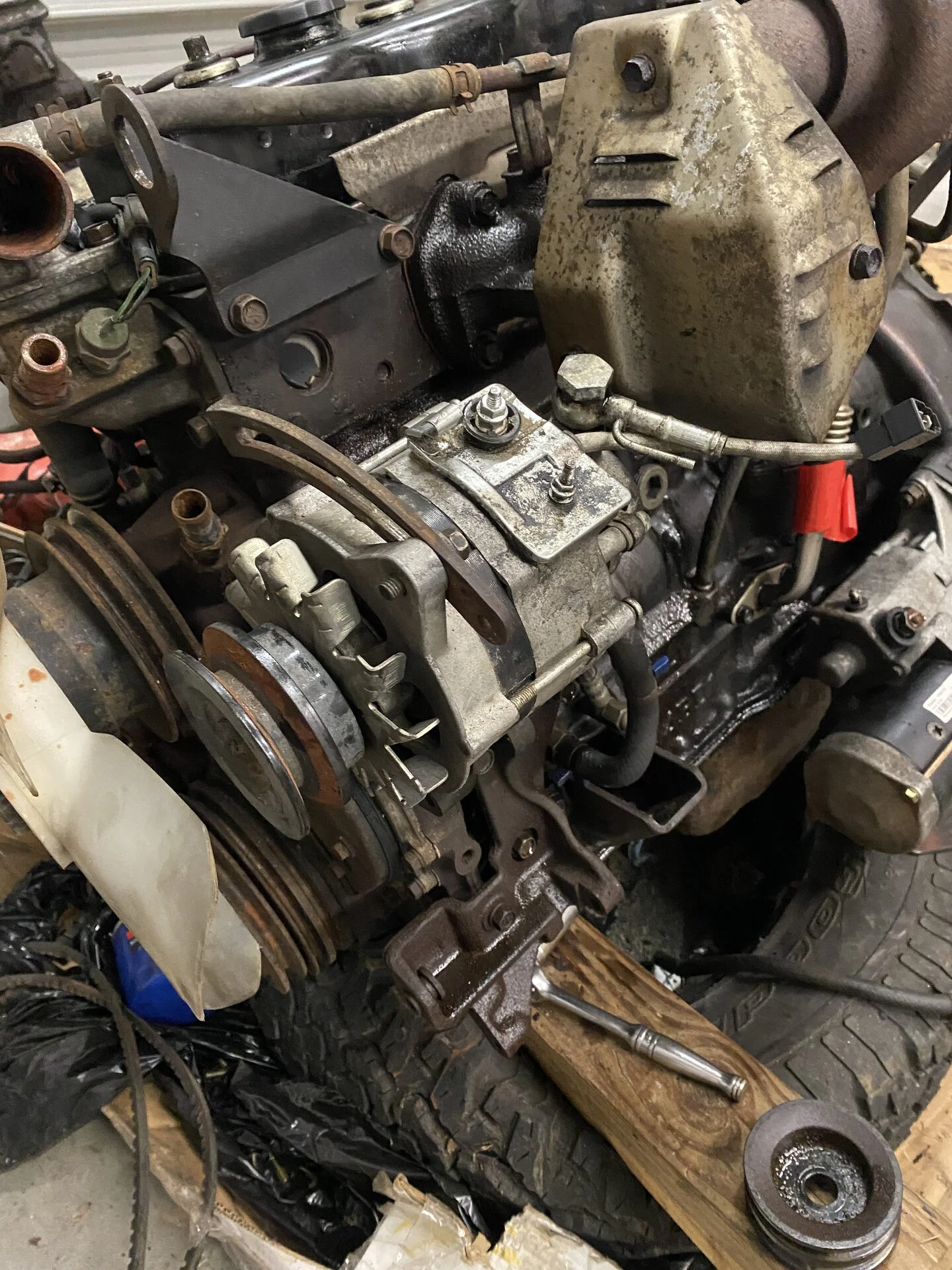

I would recommend going through and making a list of all the different systems that will need to be hooked up, then work on figuring out how to mate each engine system to the vehicle system. Things like power steering fittings, alternator wiring, engine electrical, etc. Figure out any electrical re-pinning or other changes and diagram them so when it comes time to wire everything up you have a wiring schematic to work off of.
Motor mounts and things like coolant lines and intake tubes will probably have to wait until the motor is in place. I don't think engine swaps ever go as quickly as originally intended!
The troopy doesn't have P/S so I will just be taking it off of the 4BD1T. I believe alternator rewiring is one of the only electronic bits in the engine I'll really have to mess with. There is nothing else on this engine/part of the swap that should be electronic minus the starter, and pyrometer, plus all of the other gauges that arent mechanical. But as for my vehicle to be able to run... Really just the alternator. I want everything to be as mechanical as possible. I hate electronics and dealing with them, just not my strong point in the slightest. I want it so if my alternator fails or my batteries die, that I can still clutch start the troopy and drive it (albeit without any lights or anything)

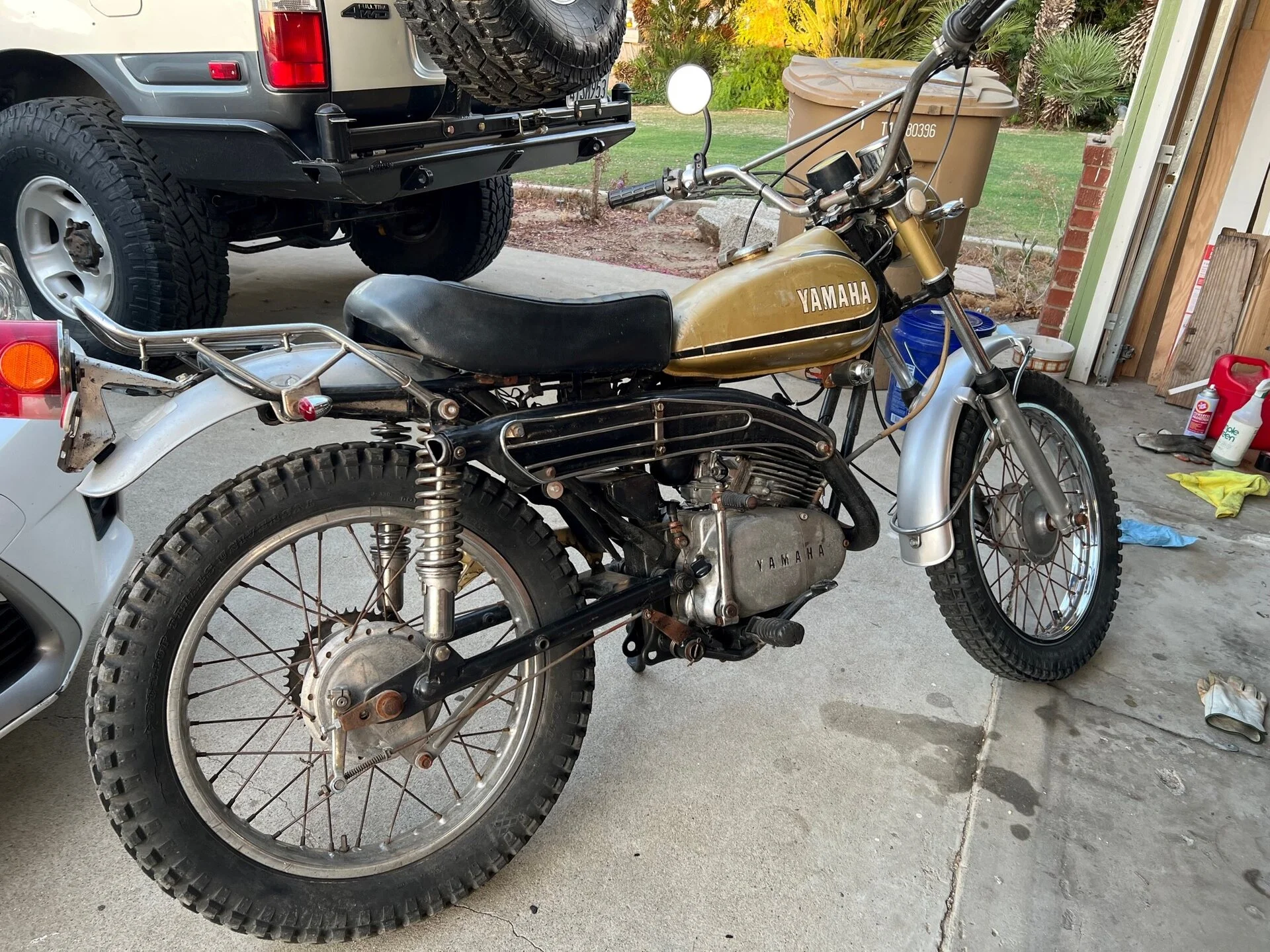

Cool bike i've got similar but it's the 175
SWEEEEEET, I have been buying and flipping antique chainsaws for the past couple months as a little side gig, decided to step up to a bigger 2stroke. Waiting for a title to come in using the VT Loophole. Hoping to make some decent profit off of it but every time I ride it I get sadder and sadder that I'm selling it! Such a fun little bike. Motorcycles do scare me to death, not that I don't trust myself but everyone else on the road. Everyone I know who actively rides has a crash story or knows someone who died cause some 16-year-old was on their phone, just scary.
We had that same motorcycle growing up. 1 red and 1 blue. Abused the heck out of that poor Yamaha and it kept going.
Well the Kentucky coal miner that owned it before me must have REALLY neglected it, both of the crank bearings were very crusty from water getting into it at some point. Ontop of the gas tank being dented everywhere and spray painted blue? Compounded it off.

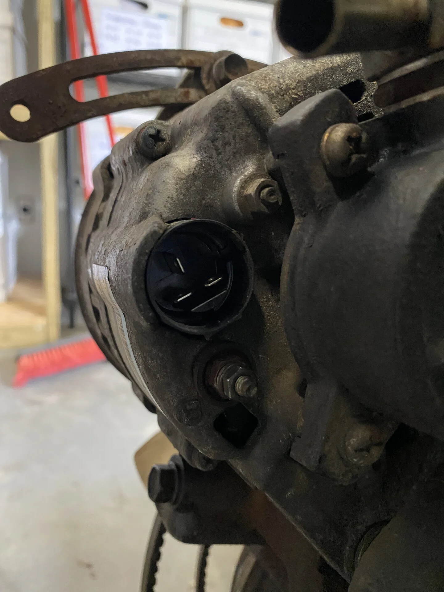

How do you even start to repin or combine the pins together? Are there websites that sell adapters or just jerry rig your own?

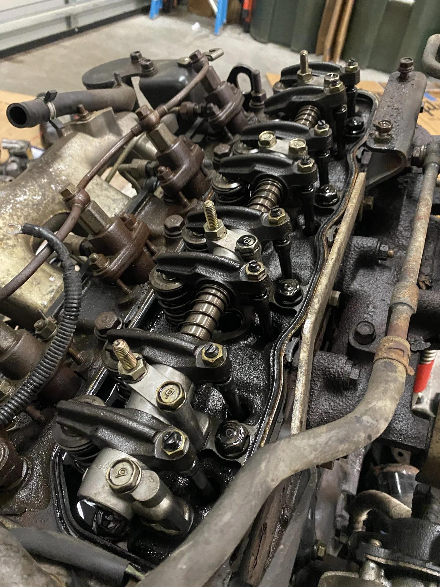

Good news is that underneath the valve cover is SUPER CLEAN!!! I guess I should have expected this as the engine only has 86,000 miles on it but its still nice to see

For electrical connectors, pins, etc, I start with photos on the Eastern Beaver catalog. Very often I find a match among SUMITOMO unsealed connectors. I have made some simple adapters with parts from E.B. so I would not have to cut factory wiring.

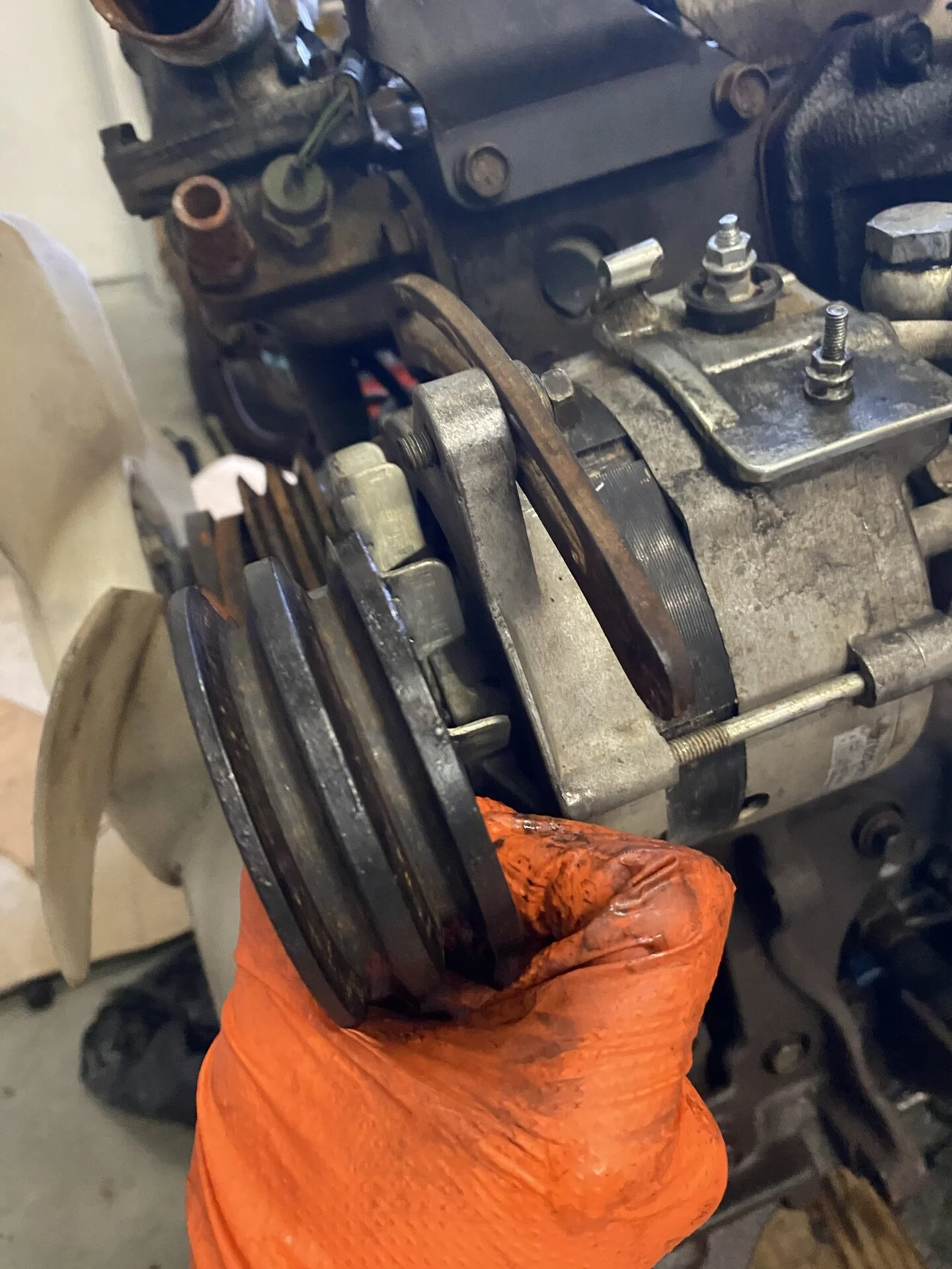

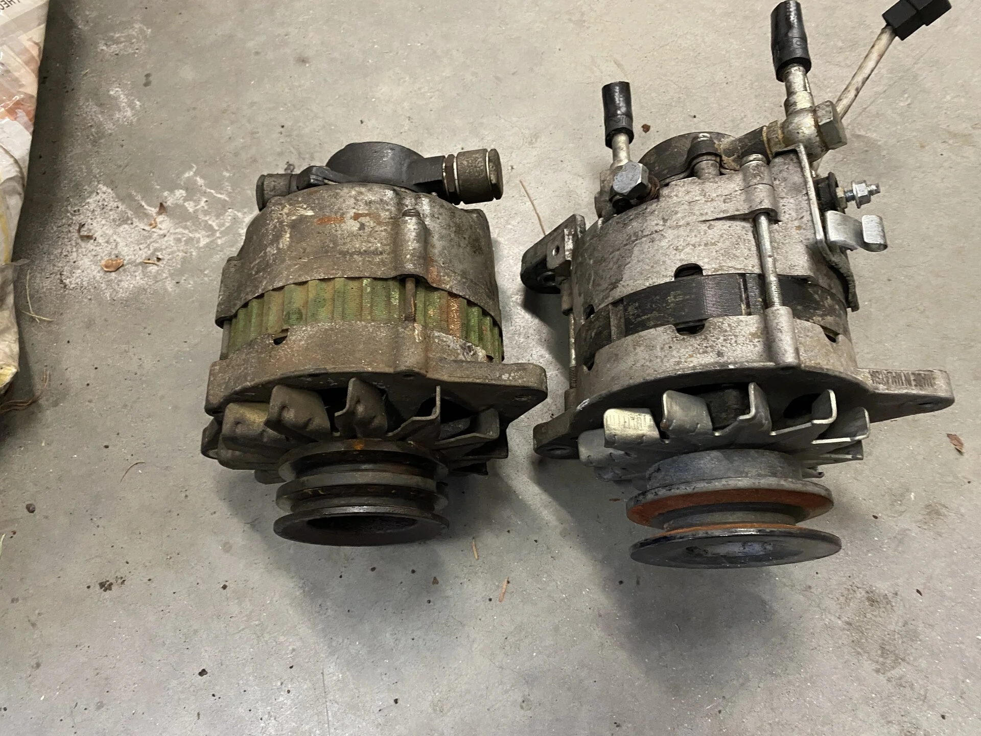

Alright sooooo, no more needing to worry about rewiring. I have the alternator sorted I believe. Took one of the alternators for the 3B I had just laying around and tried to fit it on, fits pretty well, almost like it's supposed to. Need to add some spacers on the bottom, get a longer bolt for the bottom. Other than that the oil supply banjo bolt is the same thread, along with the top mounting bolt. Just need to swap over the pulley from the Isuzu alternator to the 3B one, everything looks like it should line up fine! Big win in my opinion as I won't have to mess with the wiring really much at all.

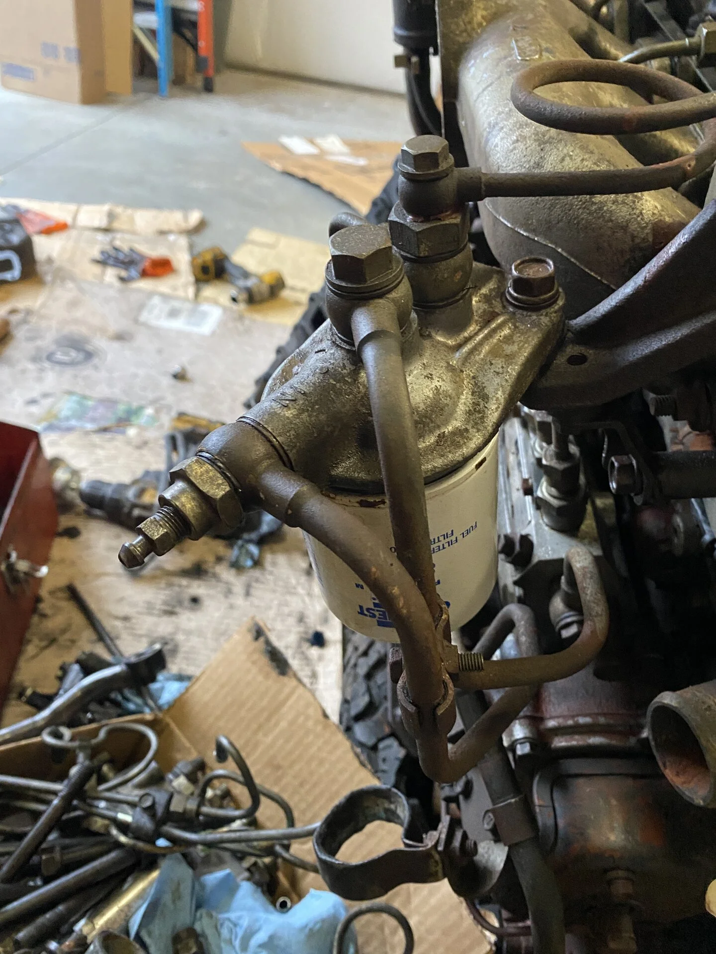

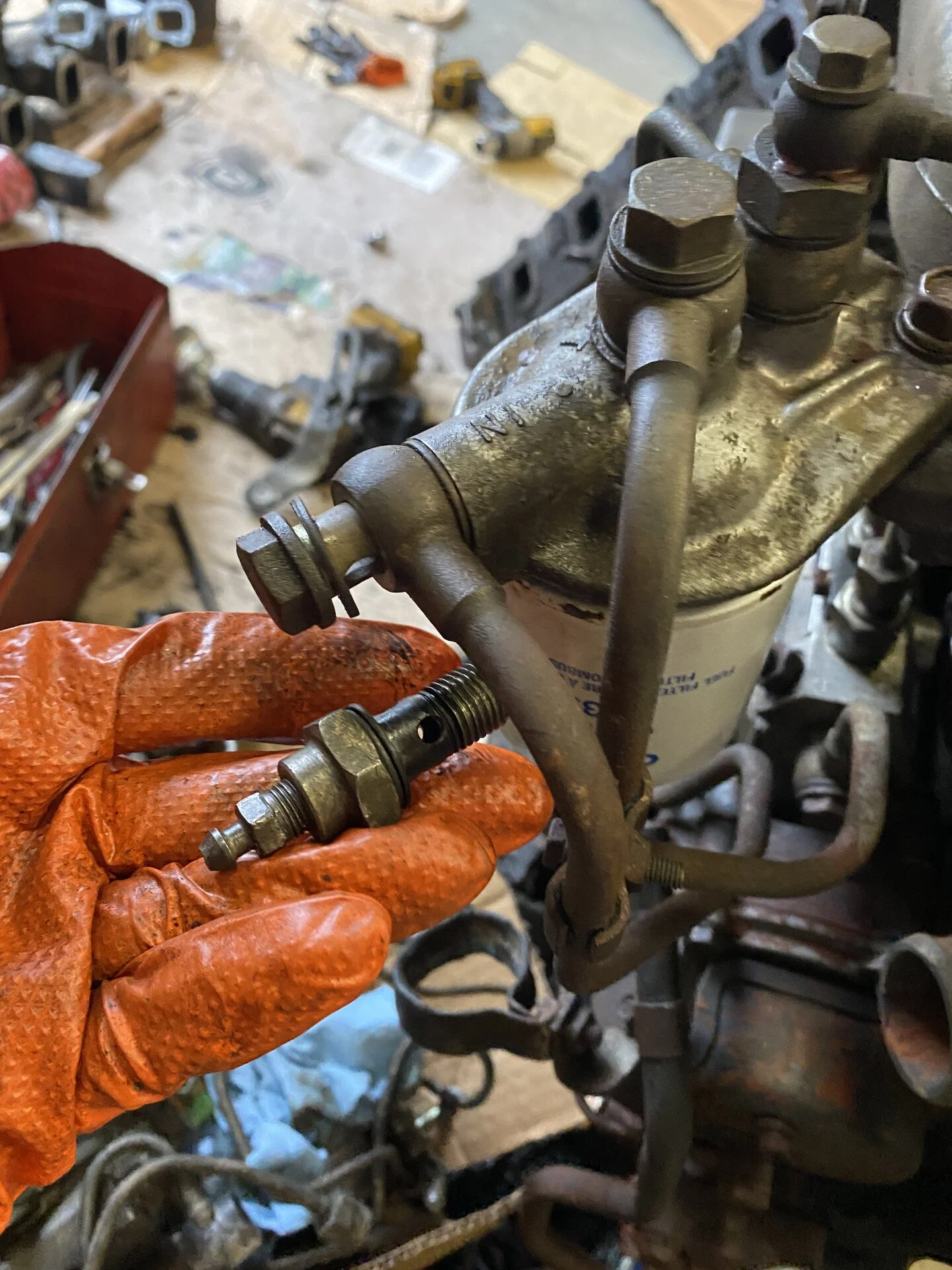

I'm a big fan of the "brake bleeder" screw on the fuel filter that the 3B has, helped me plenty of times when having to get air out of the system. Saw that the 4BD1T didn't have one so I just swapped it over, same thread pitch and everything.
