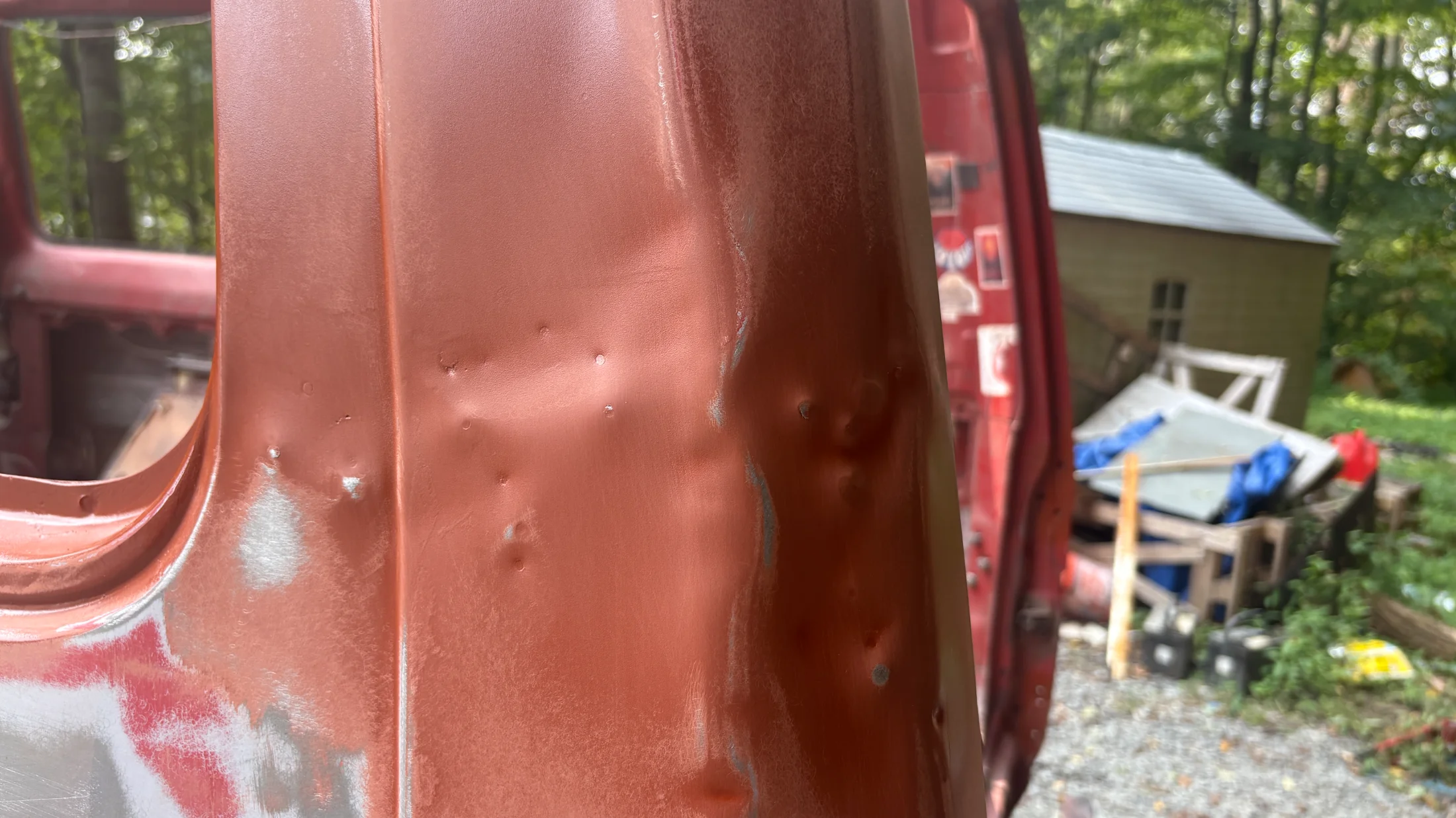

If my primer has this kinda paint defect, should I sand it down and repaint it?
If the primer is thick enough, you should be able to block sand it smooth without burning through it.

Those ripples in the primer indicate bad adherence to the surface. I'd sand it and apply another coat.

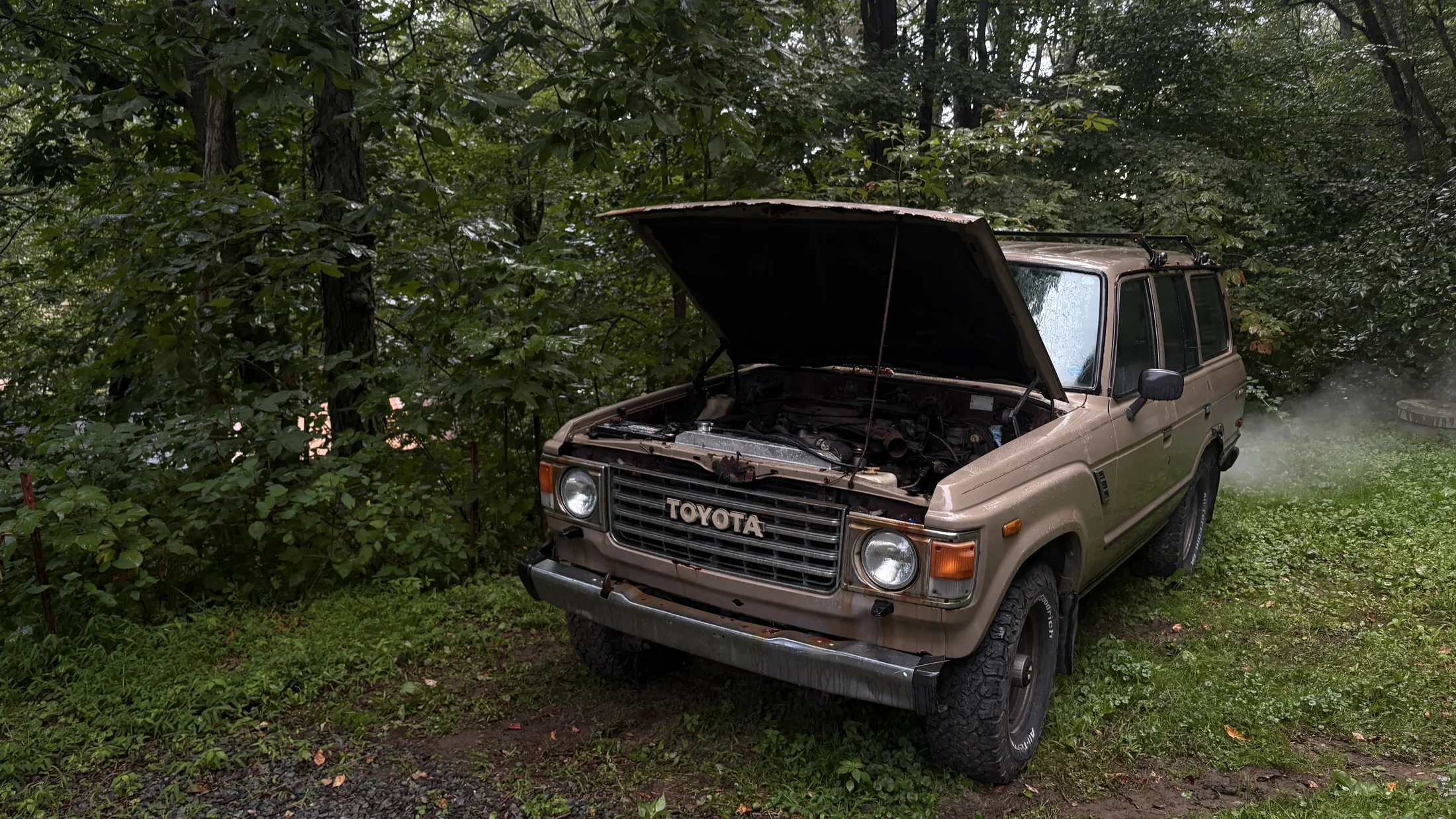

Alright, I made like 0 progress today 😂 Spent a couple of hours masking/taping-off weather stripping here and there. Then I laid down some more paint on one of the doors, and it just came out like absolute sh!t. Horrible.
I was not pleased and figured that I needed to get to the bottom of this before I do anymore work. Spent another couple hours playing with settings, cleaning out the gun, double checking everything that can be checked or adjusted. No difference. Drove 45 min to the Harbor Freight, got a new gun, 45 min back, test sprayed, and PERFECT! The new one works totally fine. I guess I was just unlucky enough to get an absolute lemon of a sprayer and since I have 0 experience with paint, I just didn't know any better. Got to painting the hood and it started raining out of nowhere, nothing on the forecast, not a single bit. So that's cool 🙃. I'll sand down the hood again tomorrow to get the ruined primer off of it and do a respray. Hopefully that'll be the end of my issues with paint.
Since I wasn't able to do any more paint work in the rain, I tried to make the best of it. It finally gave me a chance to throw in my rebuilt alternator into the crusty 60, I dont mind working in the rain.

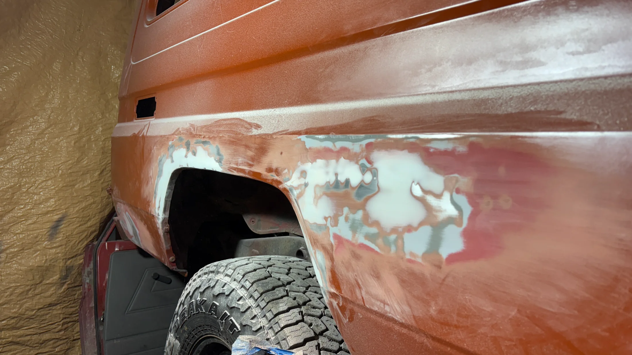

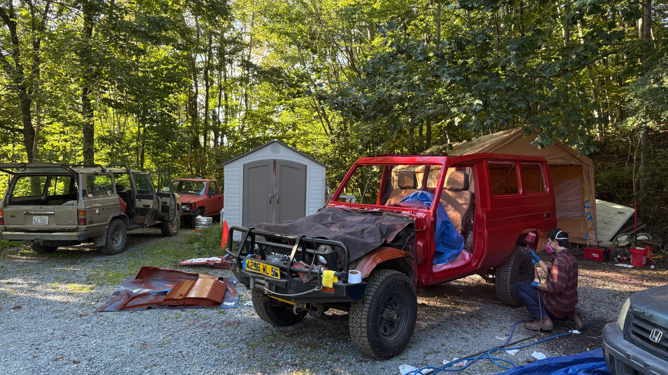

Been doing some bondo here and there where I used a stud welder to pull out some dents the troopy had, the circles in the metal thats left behind would look noticably bad. Also bondo'd some of the wheel well that I rewelded as it was quite wobbly due to me being impatient and not dispersing my welds, causing it to warp.

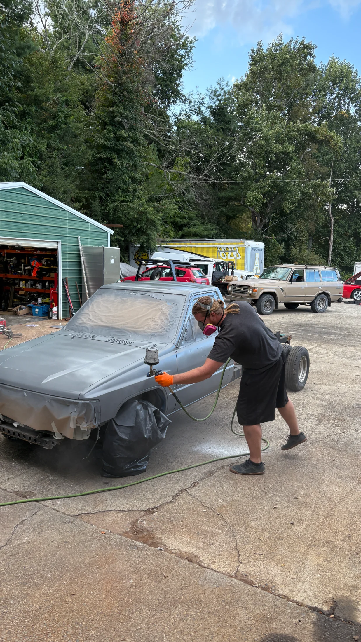

Also good news. I've been helping my buddy on the side paint his Toyota Dolphin turned flatbed pickup, he ended up getting a pretty nice spray gun and said I'm welcome to use it this coming weekend when I paint my car. Definitely taking him up on that.

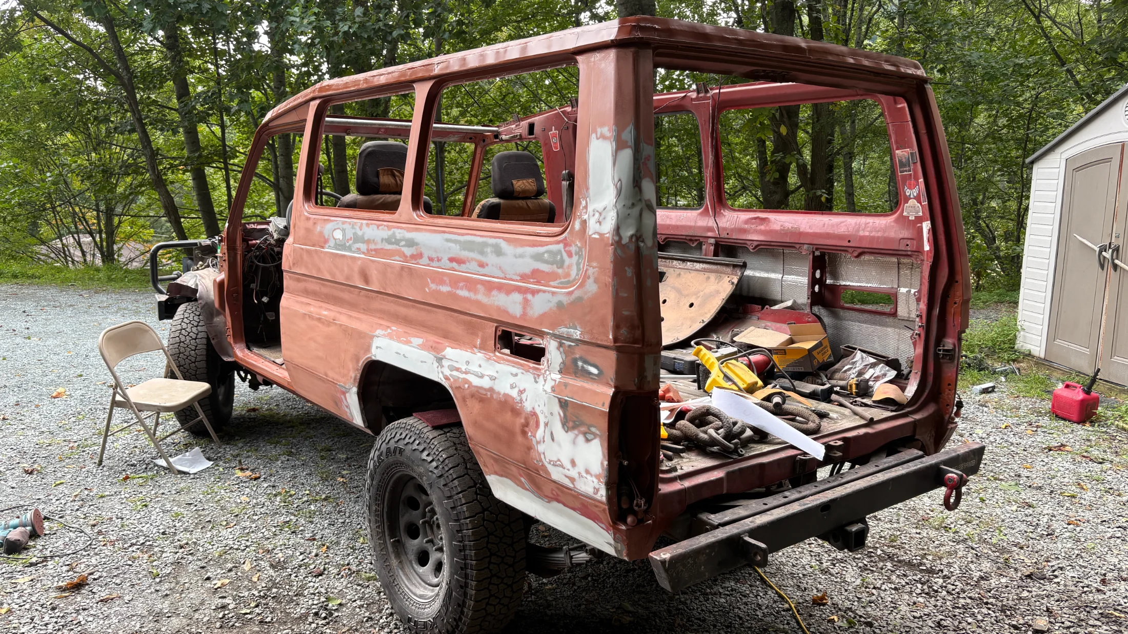

and a photo of the crusty 60 I snagged the other day

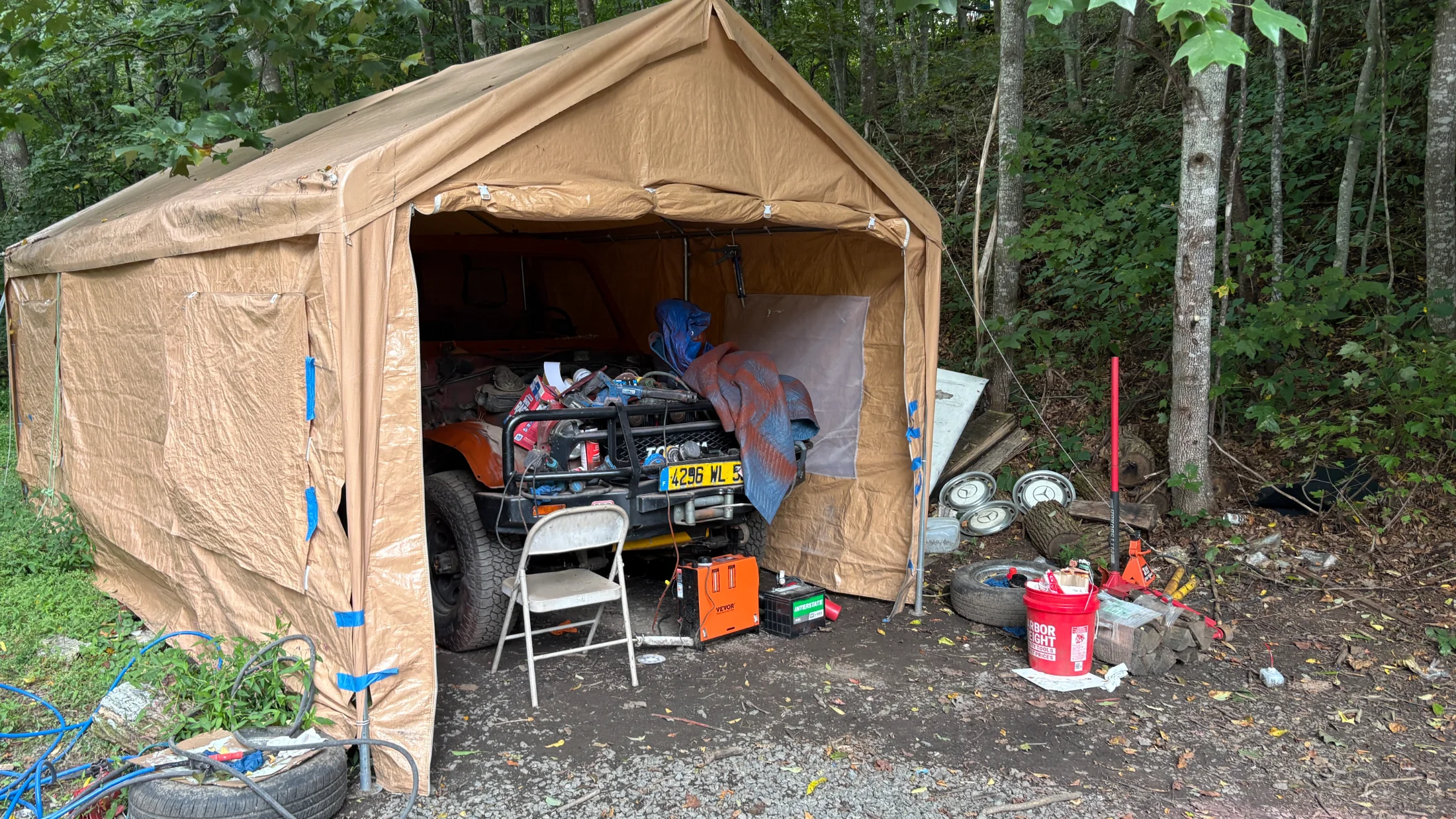

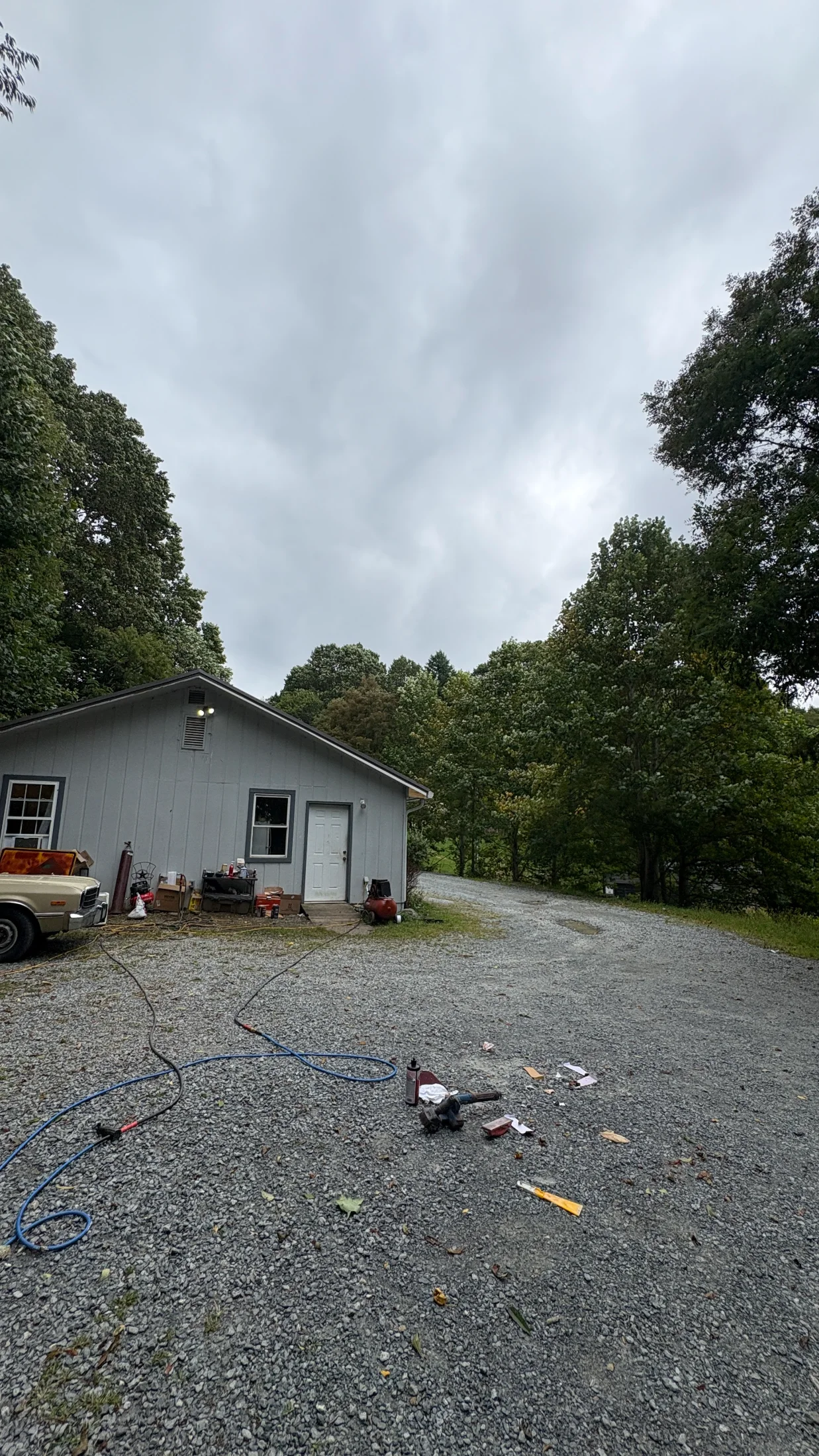

Well, its hard to get much progress done when it rains 3 times on and off every day out of nowhere haha. I am so sick of this. Mad respect to any and all of the bodyshop guys out there cause the mindless sanding, painting, and just everything about this is possibly less enjoyable than sheet metal welding... which is really saying something.
It's a bondo queen just like it was before, except I actually have metal and epoxy primer underneath the bondo instead of the "structural bondo" that was just slapped over already rusting away body panels and joints. It's still not perfect on the driverside where all of the body damage to it is, but it's a whole lot better.
Put some more primer on all of it again, getting as many layers as possible
an example of why I wanted to bondo in these areas... those dots would stick out like a sore thumb,

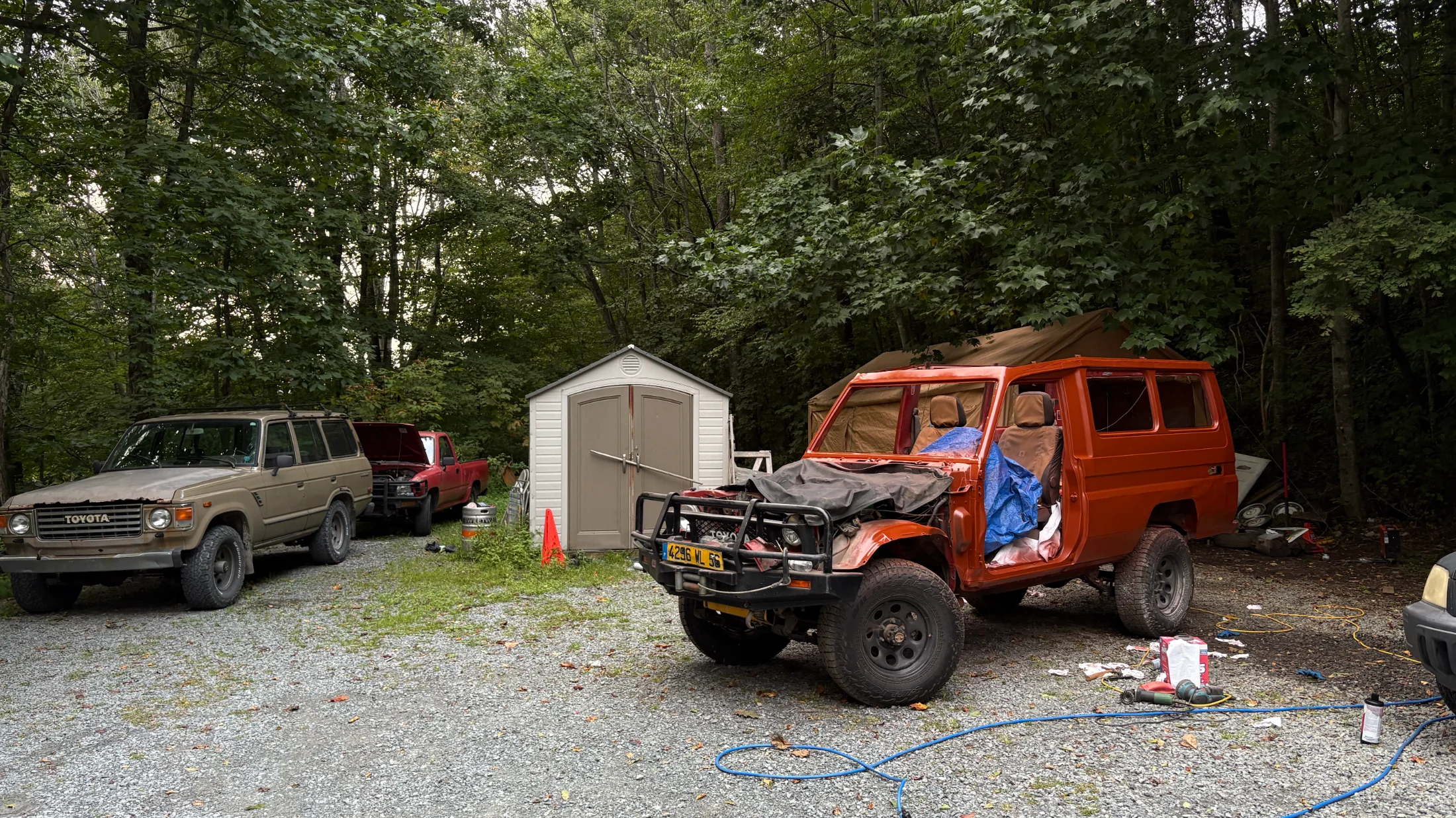

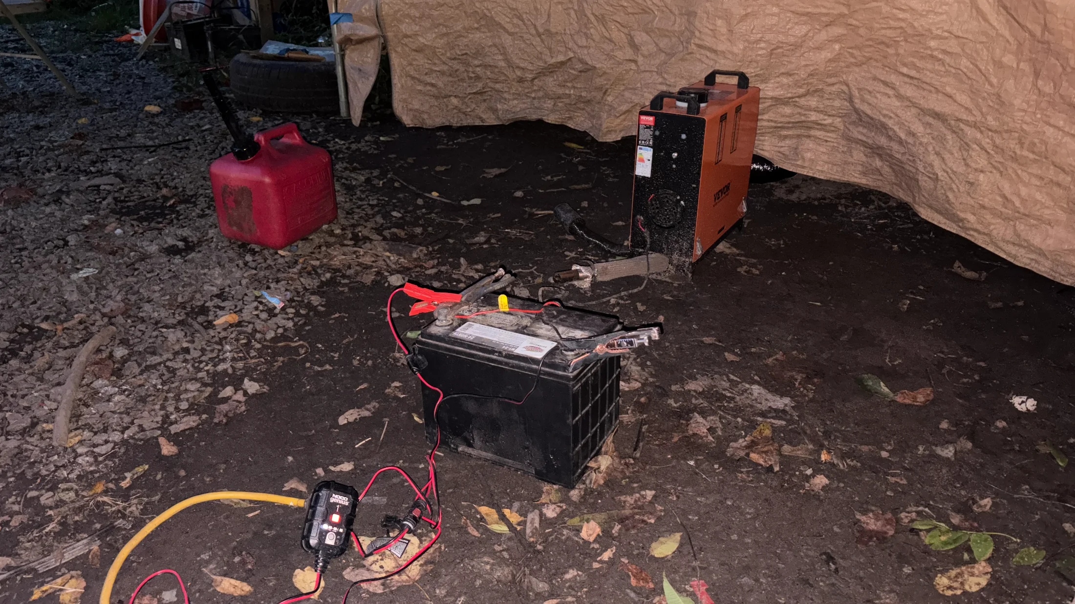

Here is my extremely professional heating setup to keep the primer on the troopy above 65f every night. Amazon diesel heater, vice-gripped wires to the battery from my Toyota pickup, and a battery charger hooked to the vicegrips to keep everything charged properly.

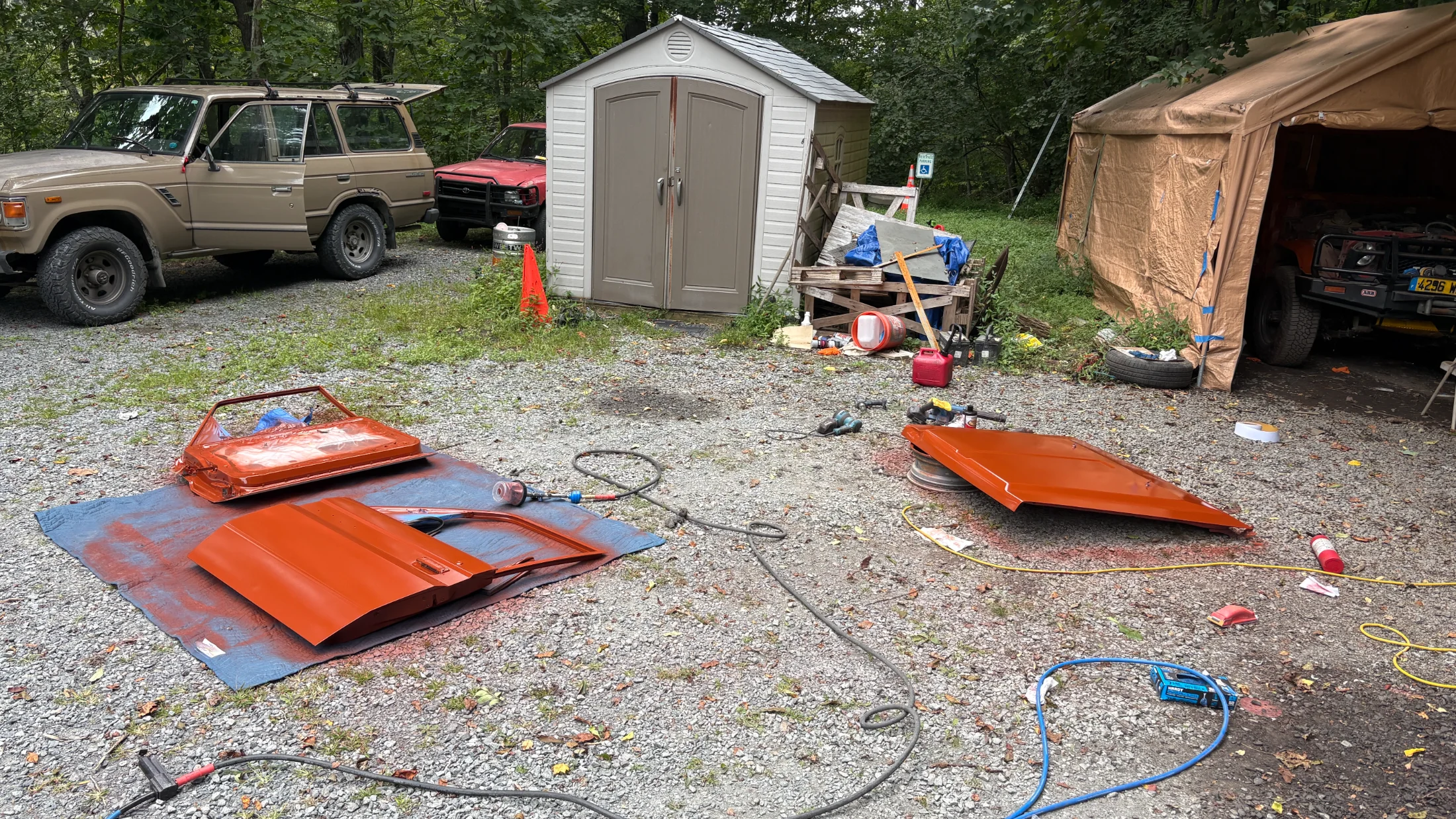

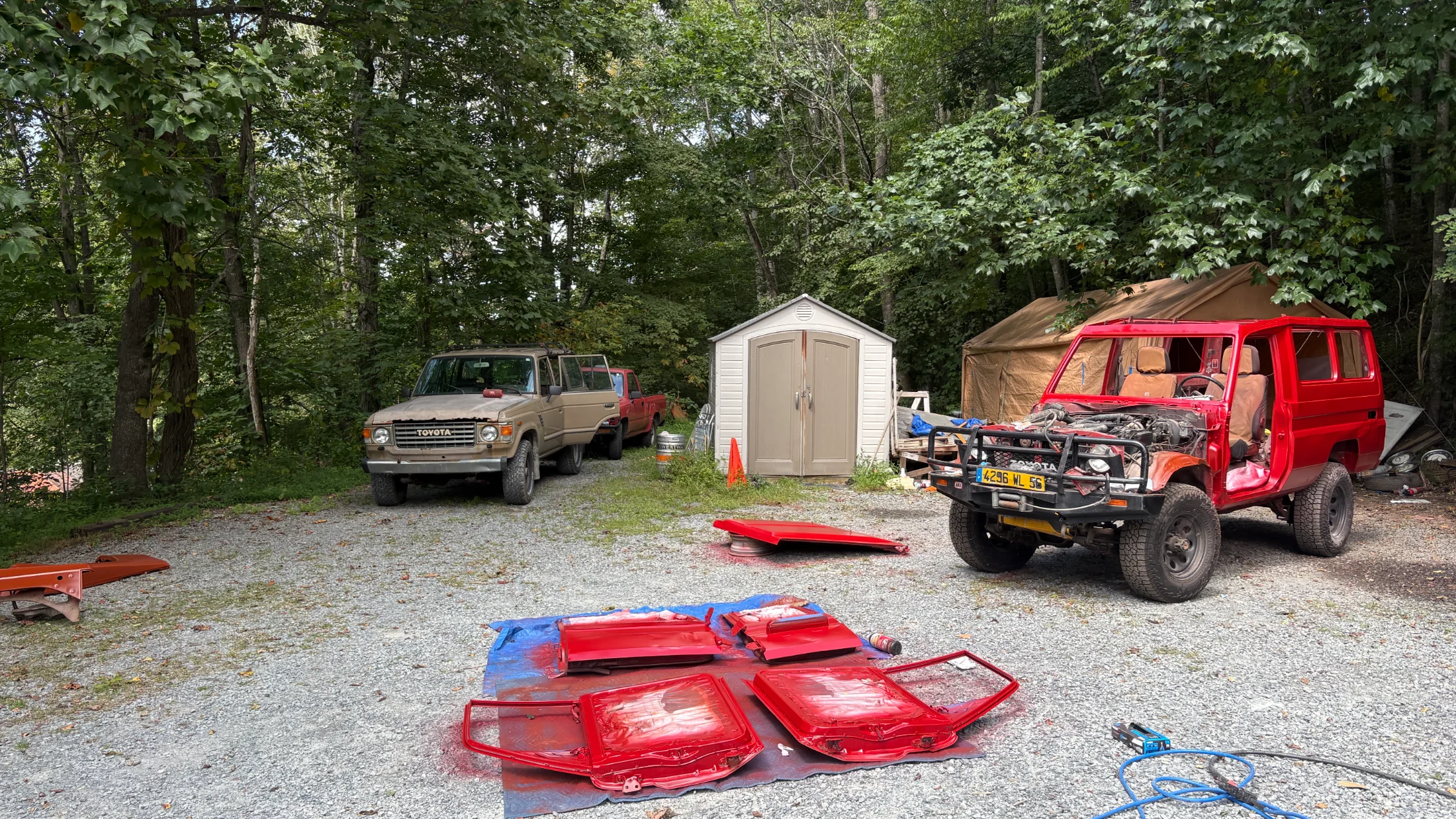

So that all happened yesterday. Today I got to paint some of the body parts and doors while the primer on the troopy continues to dry for at least 24 hours. Got some primer down, forecast was clear, anddddd rain started coming down. 🙃
Called it quits for the day and threw everything inside the temu carport.

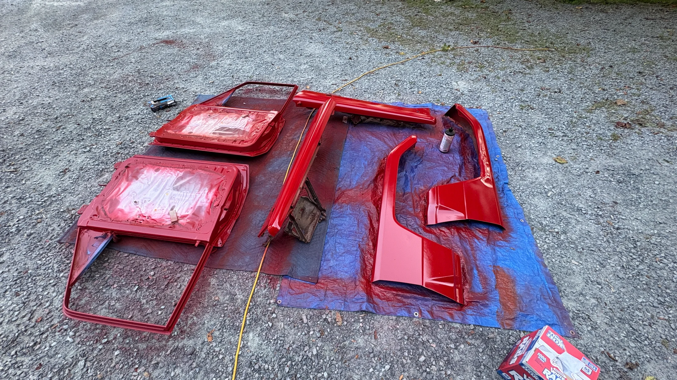

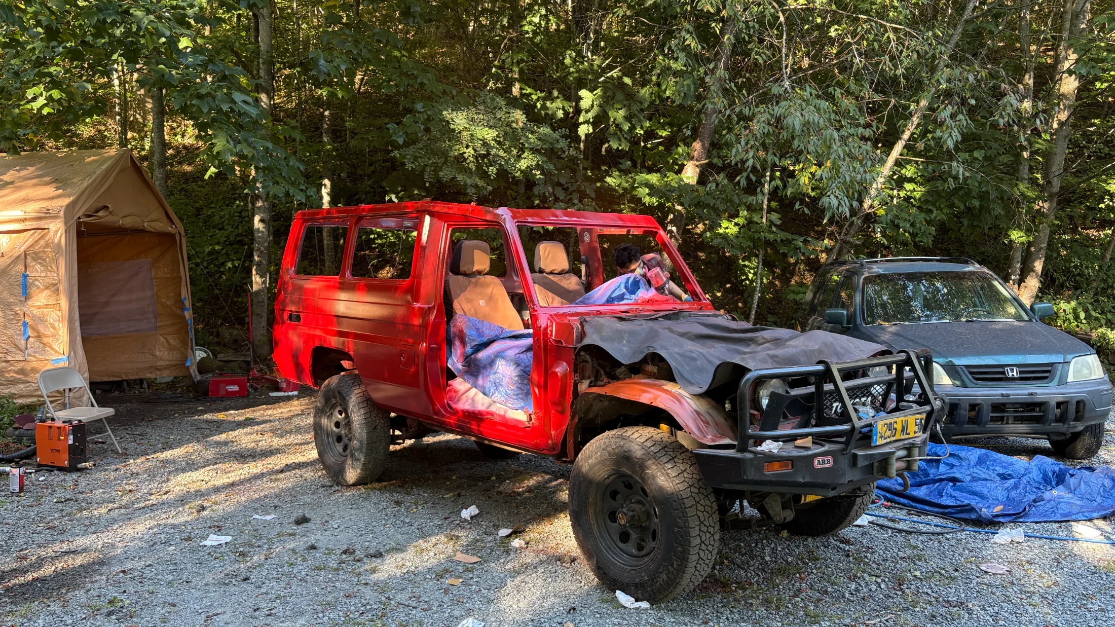

Got the body painted on Sunday. It's definitely red but I don't think it's too red.
Got all of the other panels, fenders, doors, etc painted today! Feels good to have this done with.
Gonna wait a while to let the paint dry before I start bolting stuff back together.
