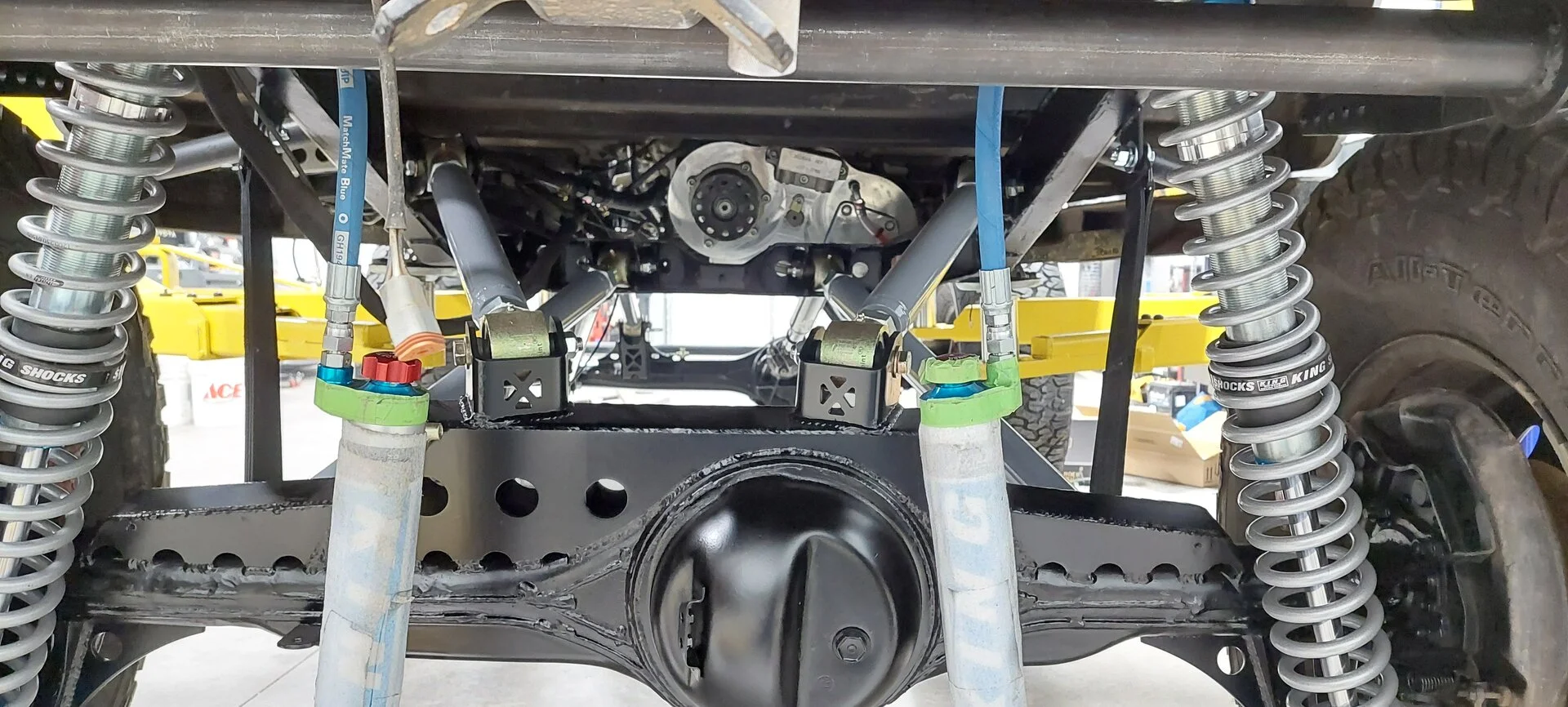

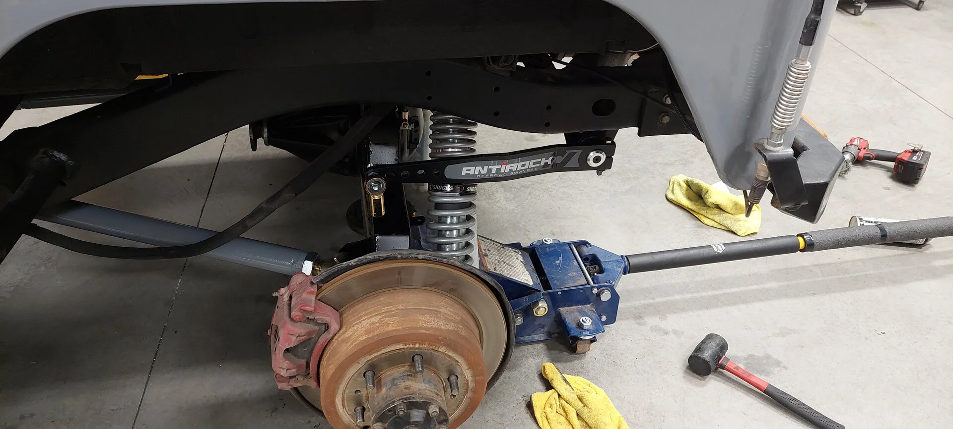

Did you replace the oem rear crossmember that the upper CO tie to ? The factory piece will tear with the CO's offset that way. IMO.
Yep, frame has been boxed and crossmember pushed back about 4". The tube 2" 1/4 wall.

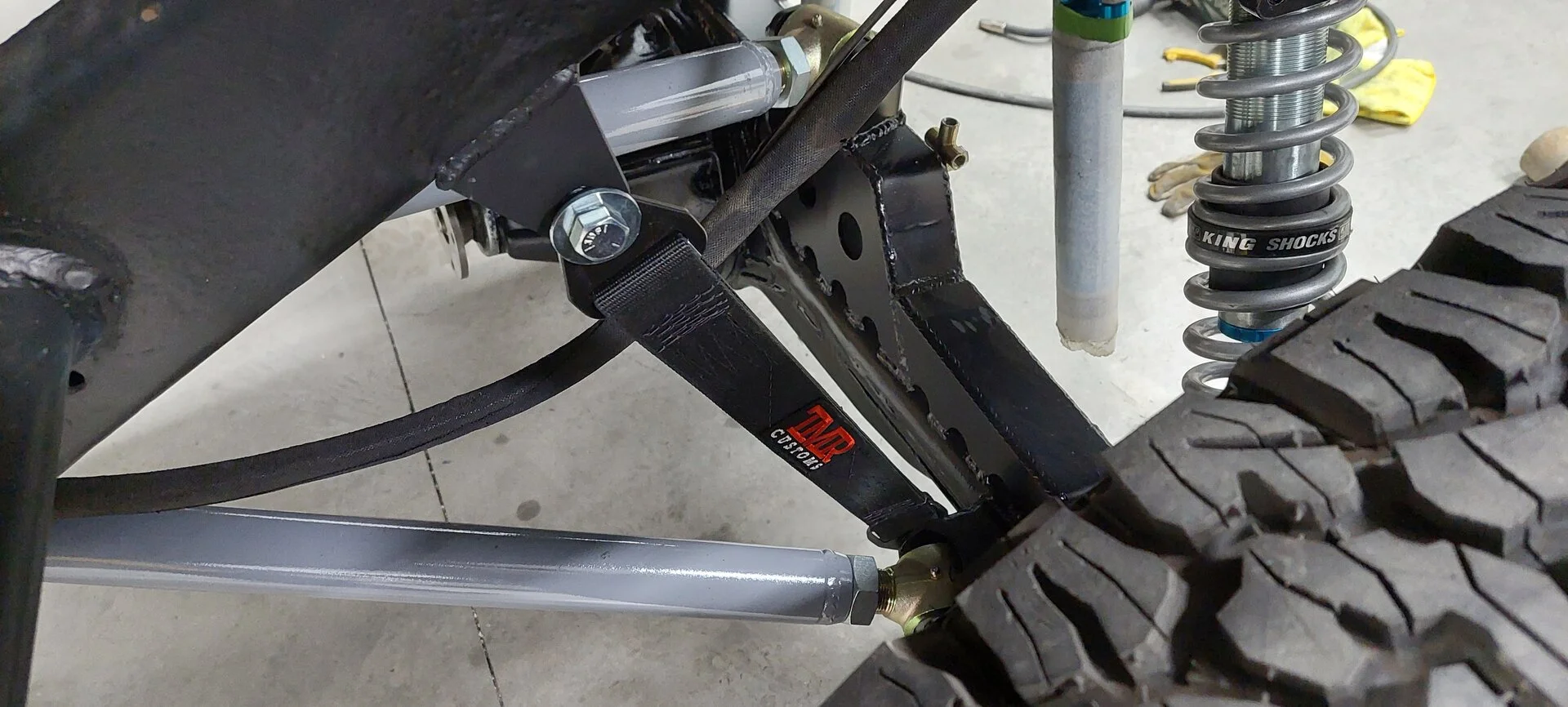

Got limit straps in.

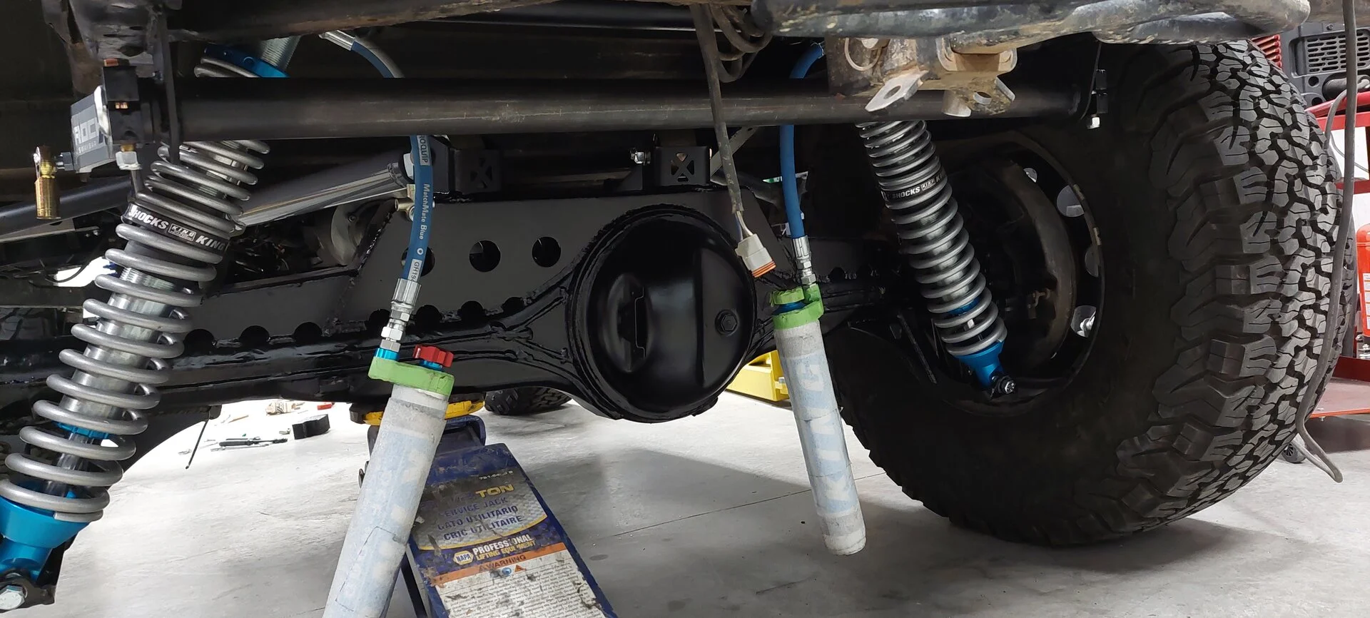

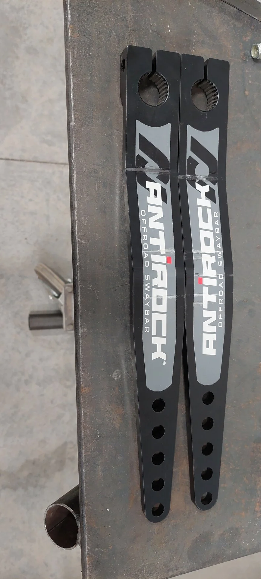

Bent the sway bar arms for a little more clearance.

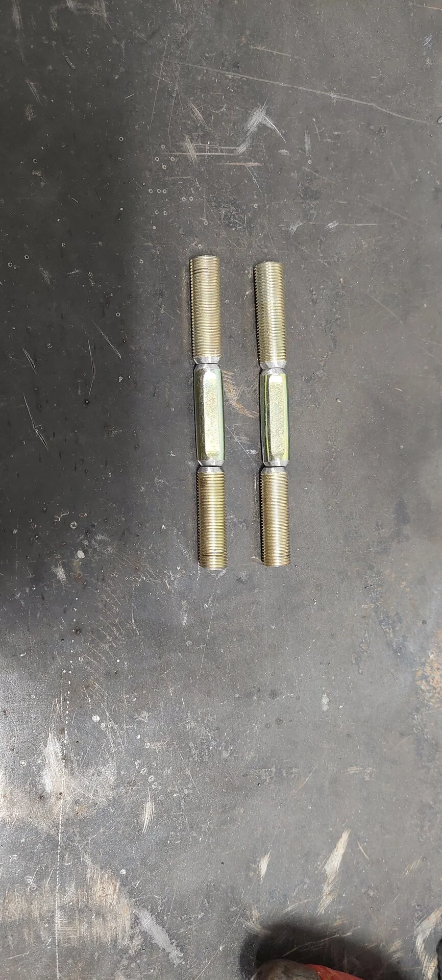

Custom short swaybar links.

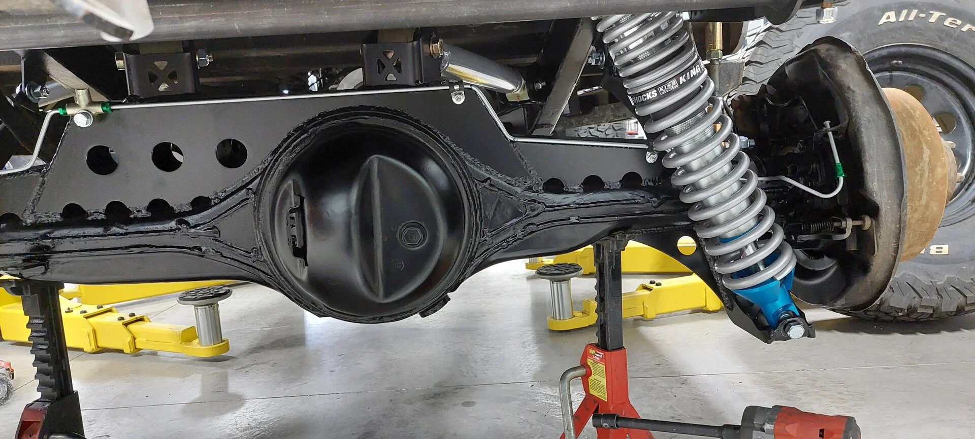

Bar in
Links in.

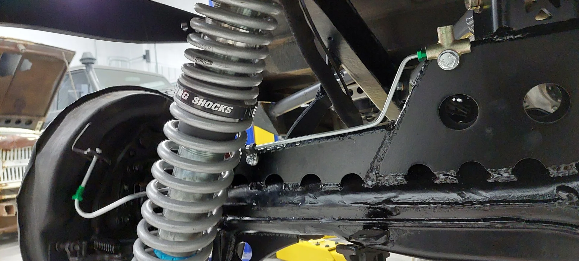

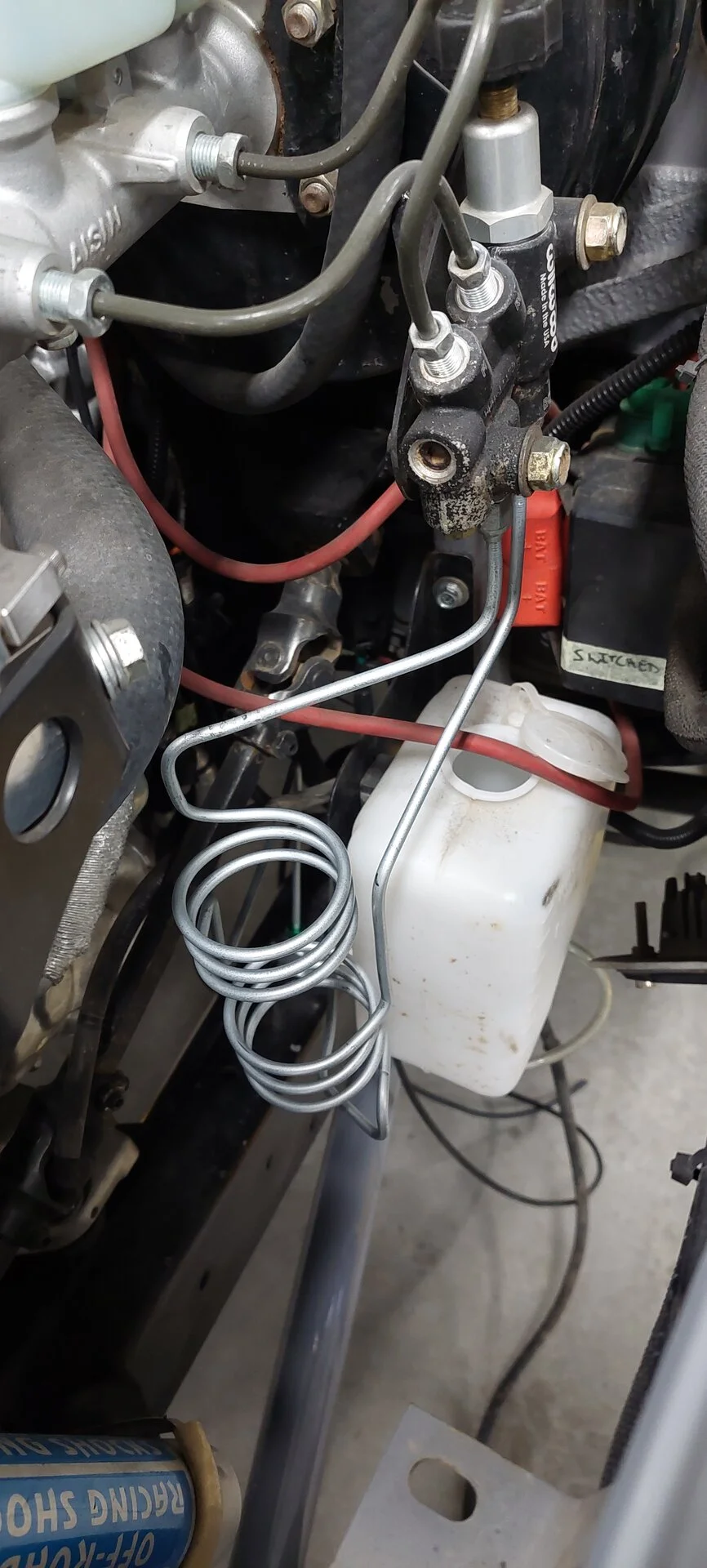

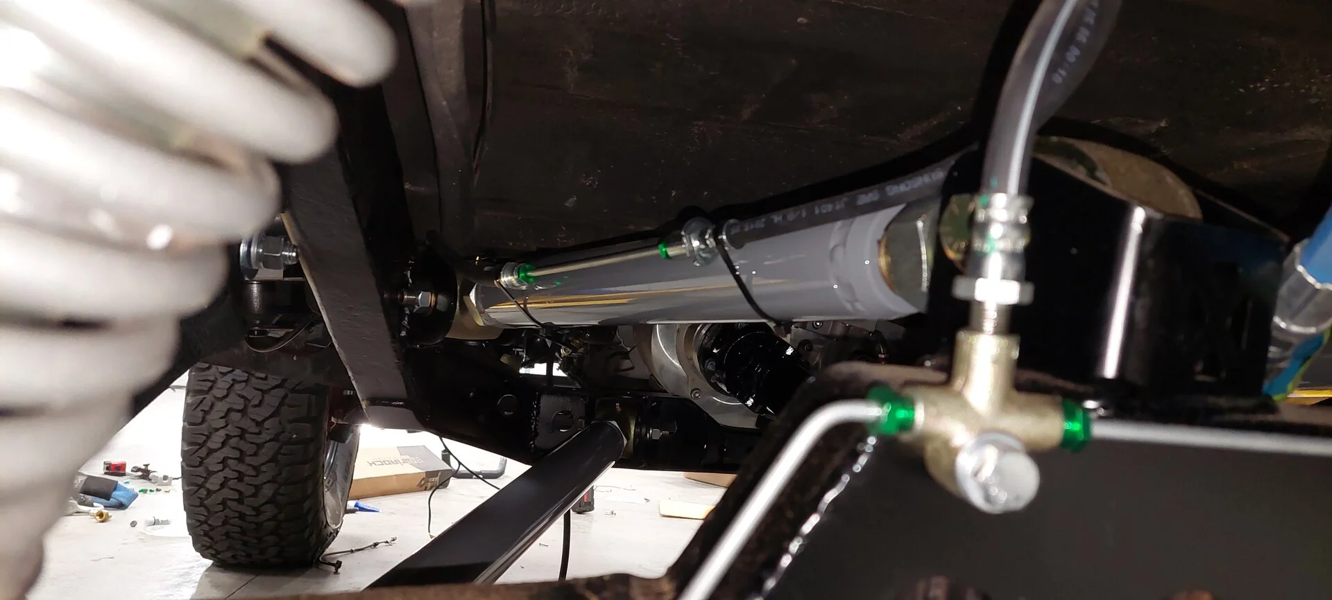

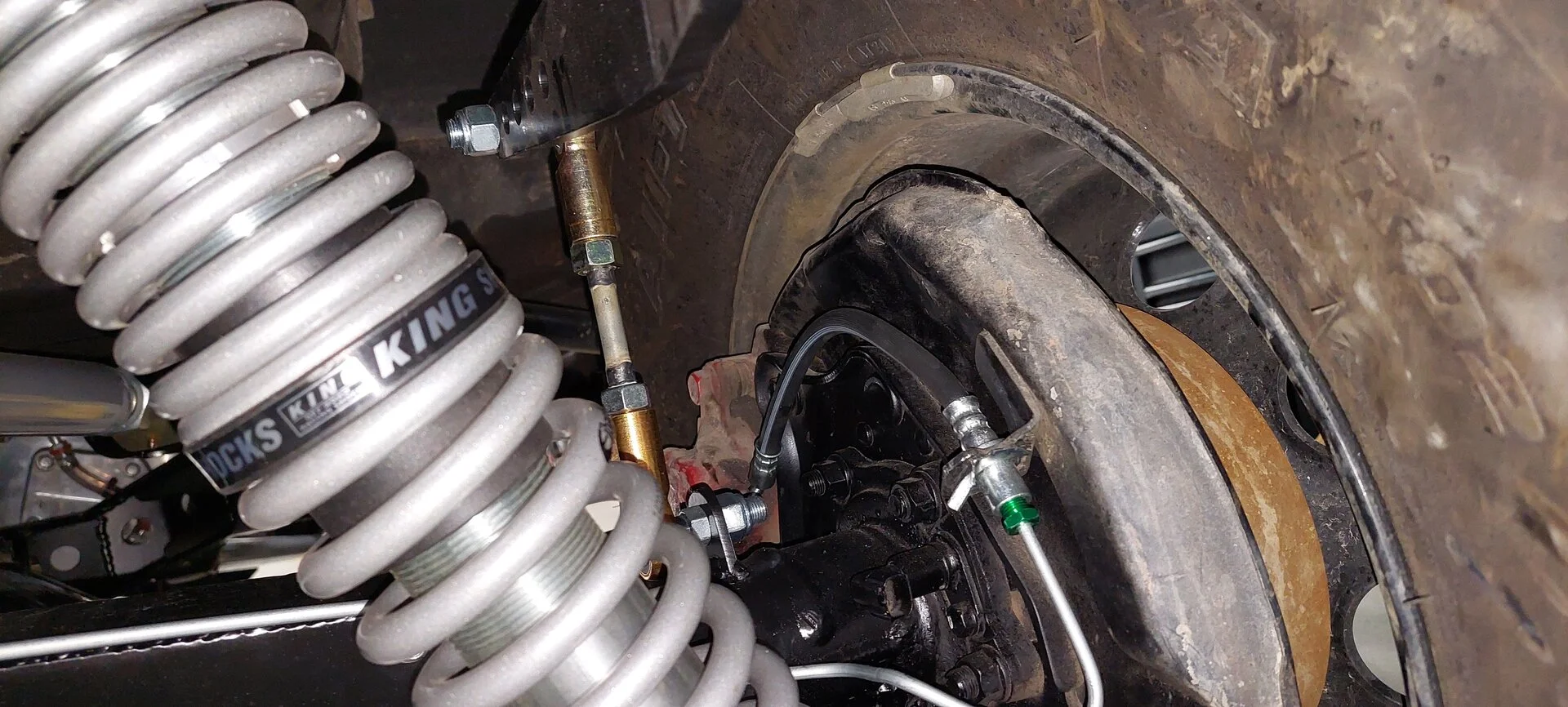

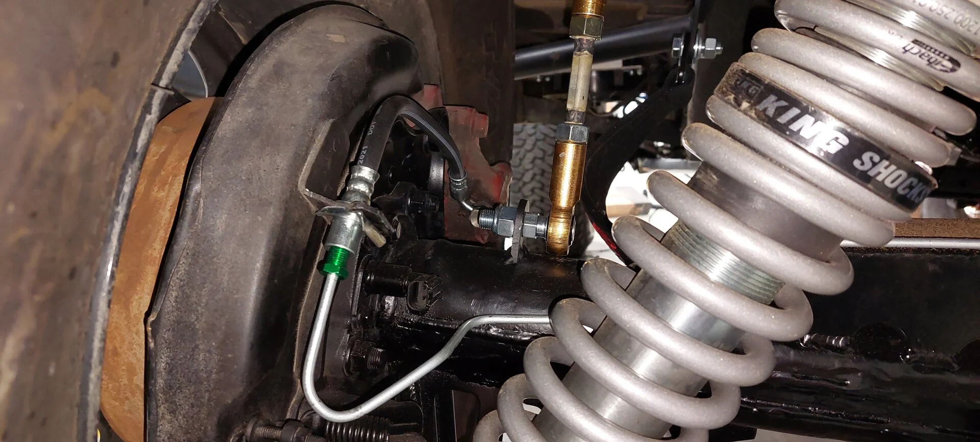

Brake lines. I love bending brake lines. So much fun.
Master to frame lines.

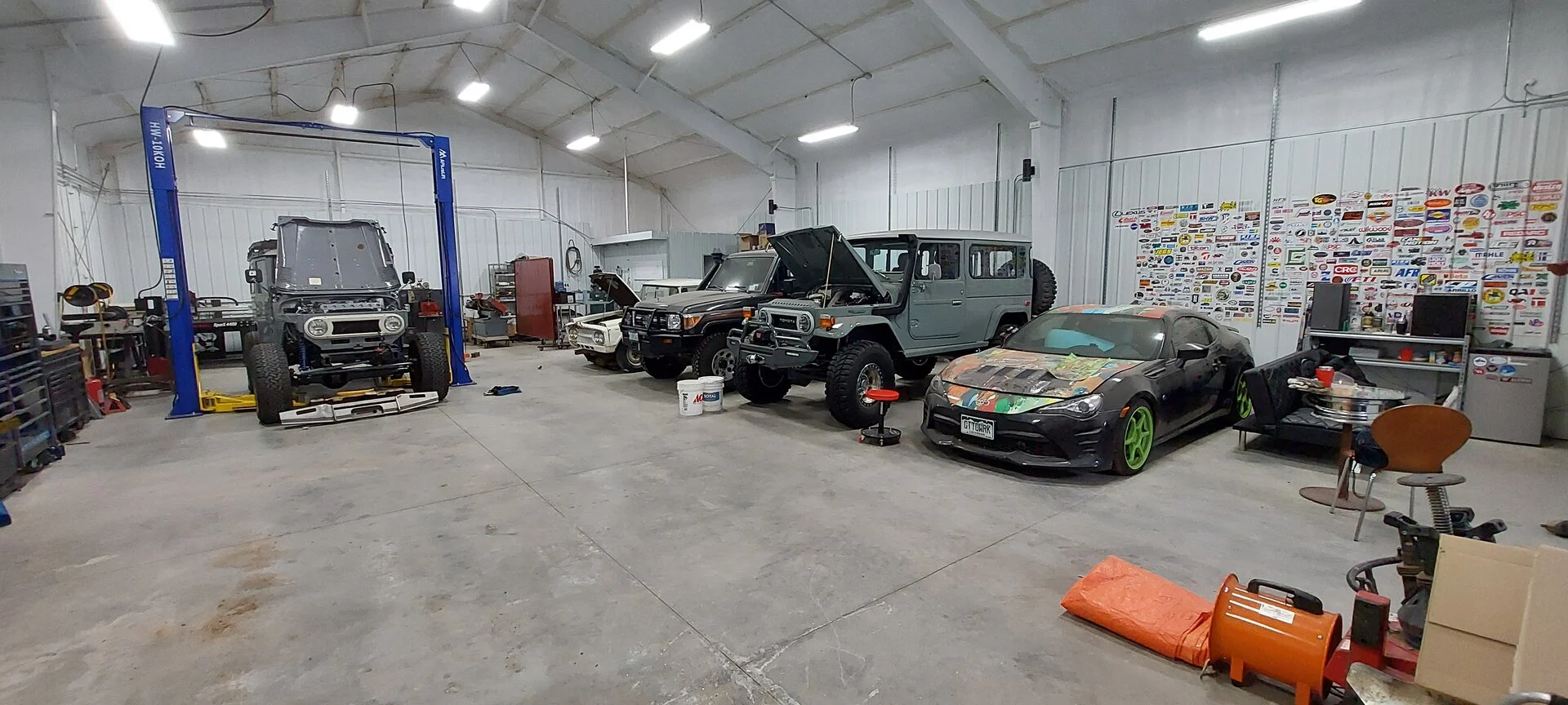

Current herd in the shop.

Nice job on the brake lines. What type are you using?
Got a few 25' rolls of 3/16 on Summit. Don't remember the brand.
A good tube roller/straightner and a nice set of bending pliers makes the job a lot easier. I also grabbed the spare hydraulic flaring tool from the shop.

Moar brake lines. Rock auto soft lines showed up.

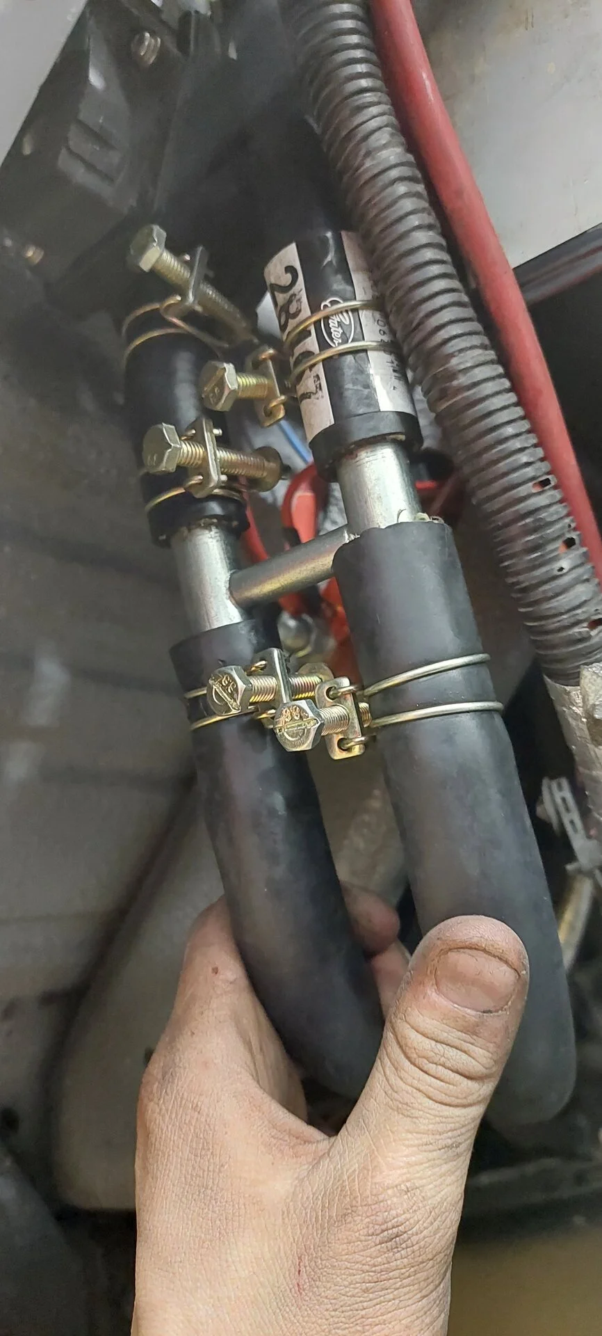

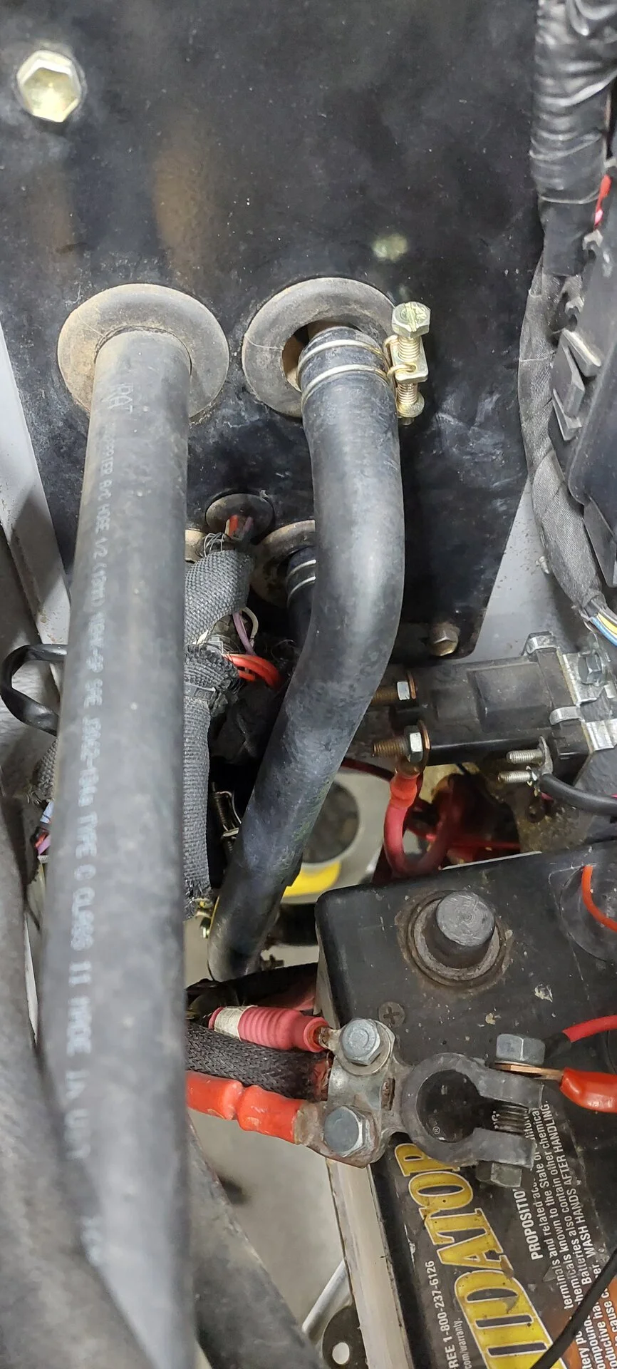

Heater hoses finally done as well.

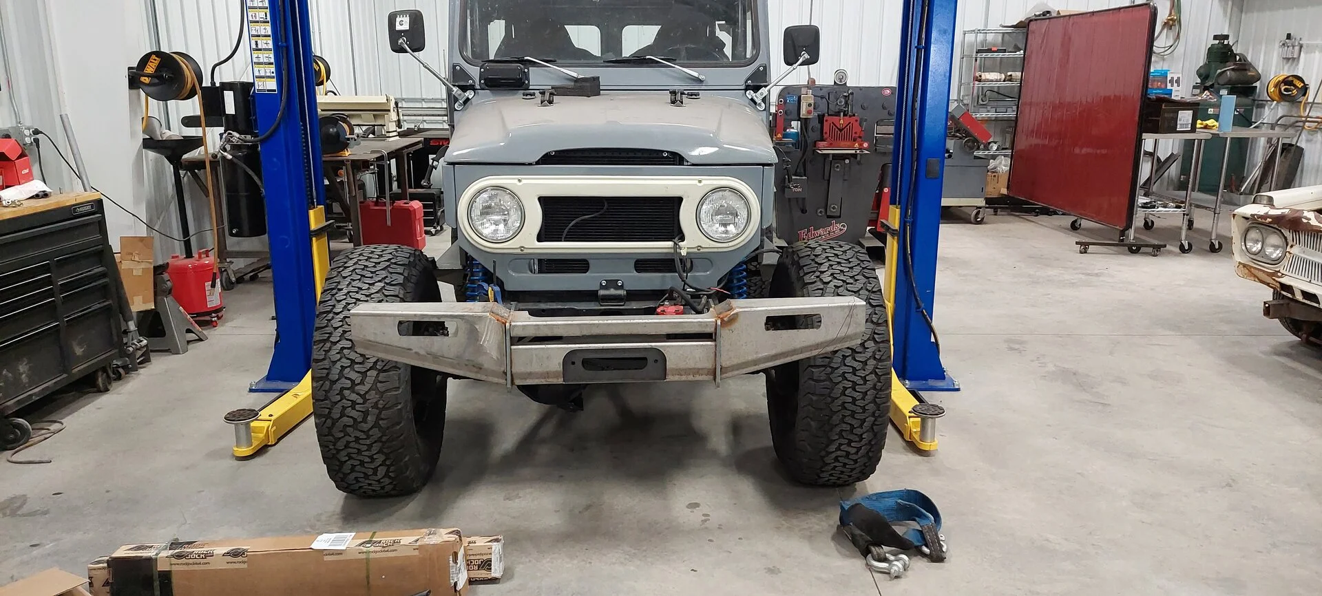

I love this front bumper. I’m bookmarking this for later reference. I have something similar on the drawing board.

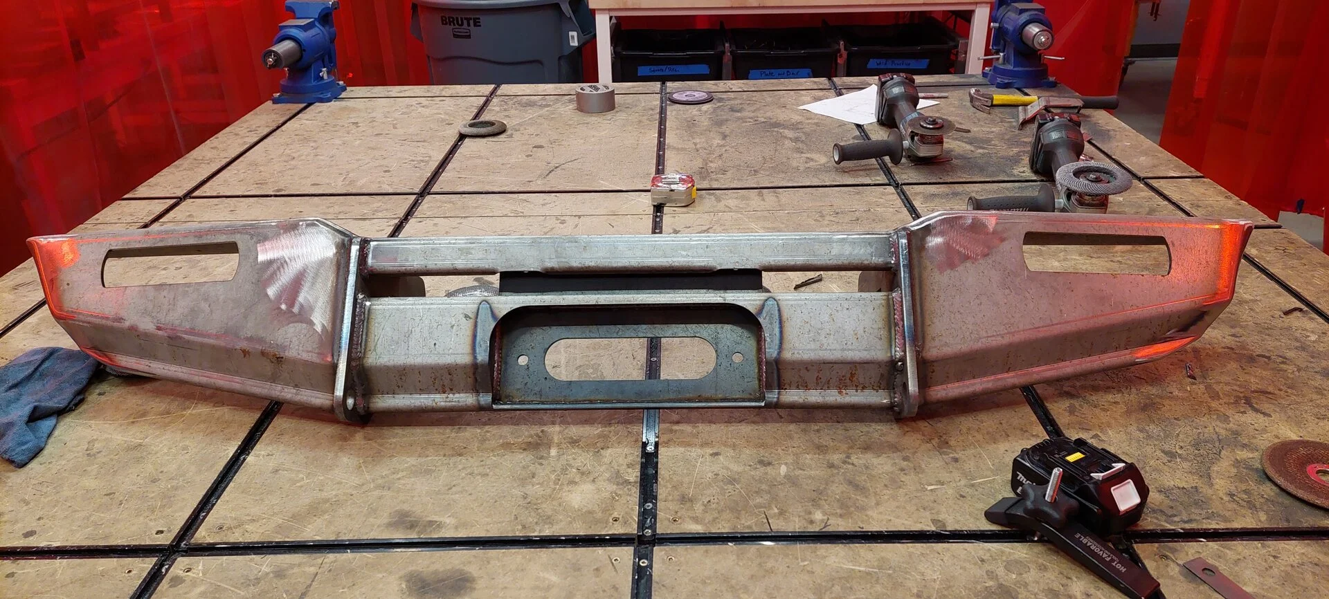

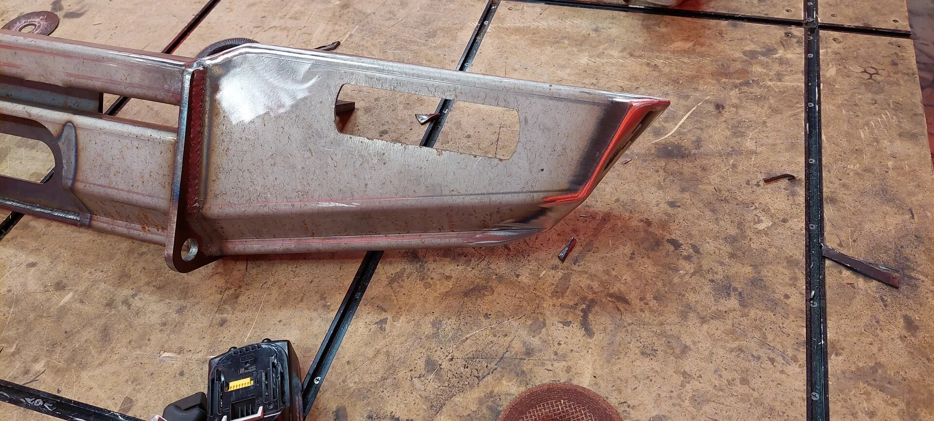

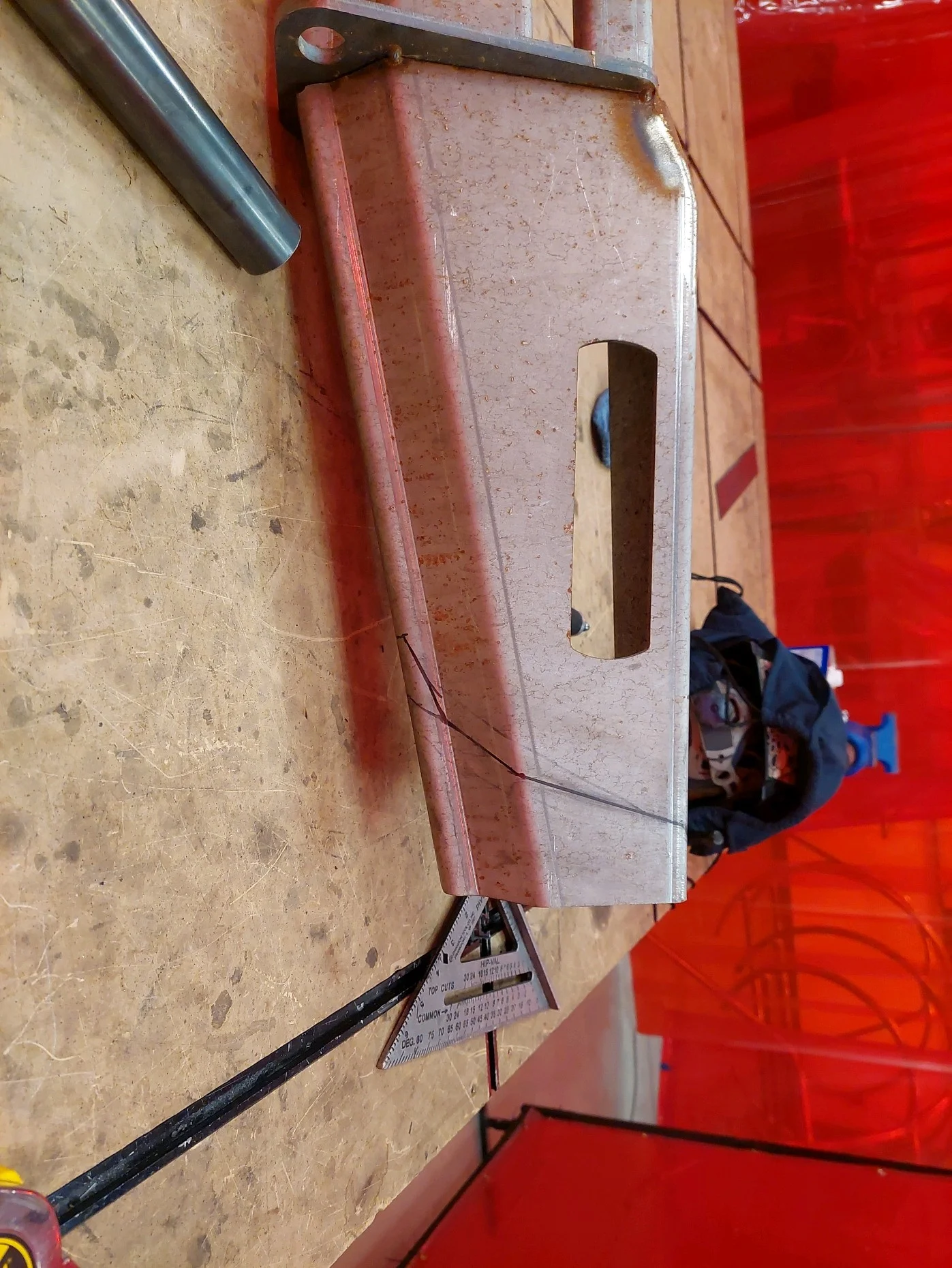

Got the annoying parts of the bumper out of the way this week as well.
Wrapping the corners is a pain in the balls, and I wanted to do something different than the usual work style.
Much more agressive corner mutliation lol.
Done
Pretty happy with the way the corners ended up.
