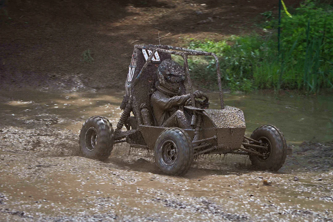

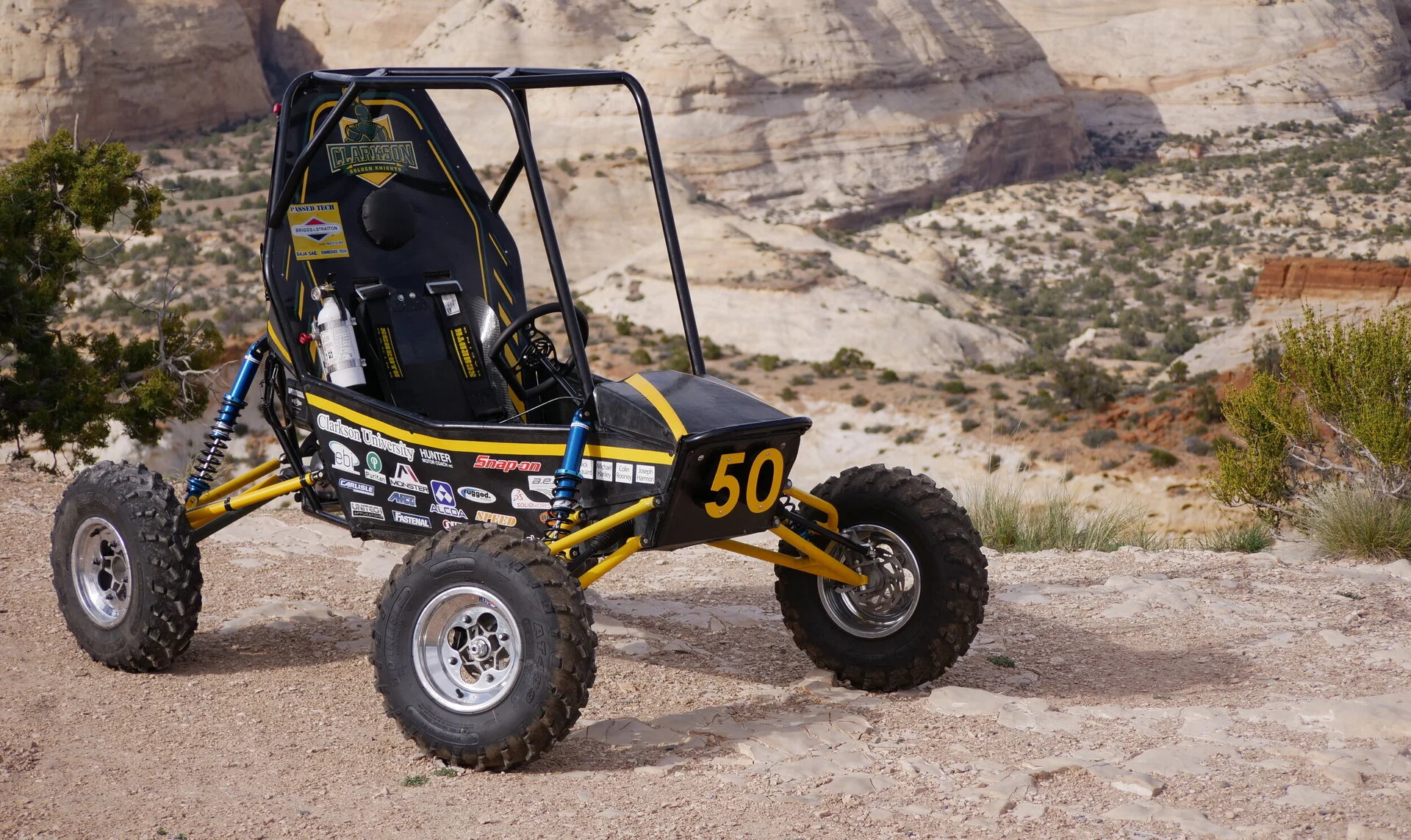

I have not a single clue what the Baja sae is But why is the cage so tall looks like you will have Feet of head room ?
They come out like this. They are aquatic and buoyant and need to protect you if it rolls over
95th percentile males and 5th percentile females must fit in the cage, and have 6" min of headroom to bars with a helmet on. Makes them super tall.
They supply a cardboard cutout we use to determine fitmet.

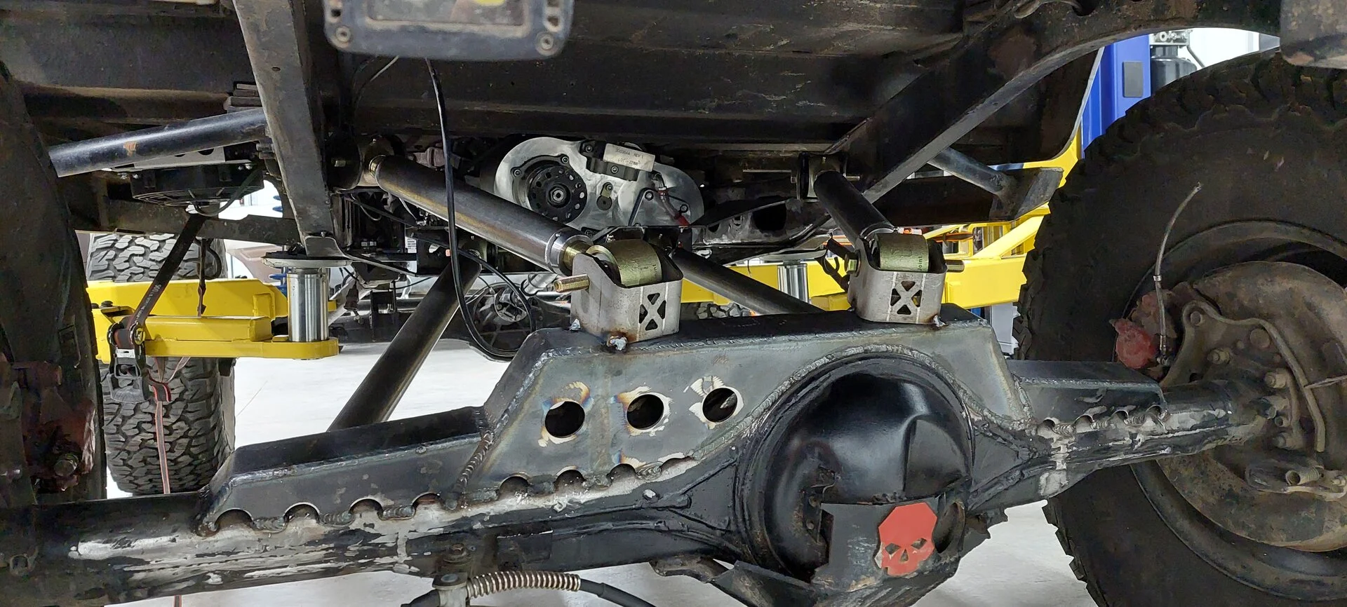

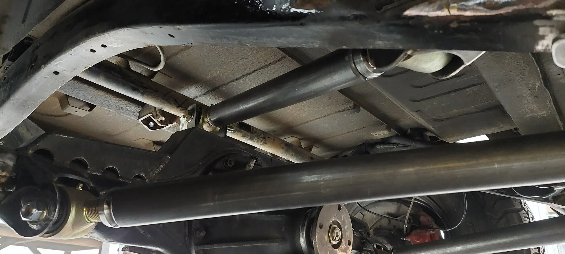

The mini truss was bugging me looks wise, so I had to fix it.
Made some extra little wings. I think it looks better.
Welded up.

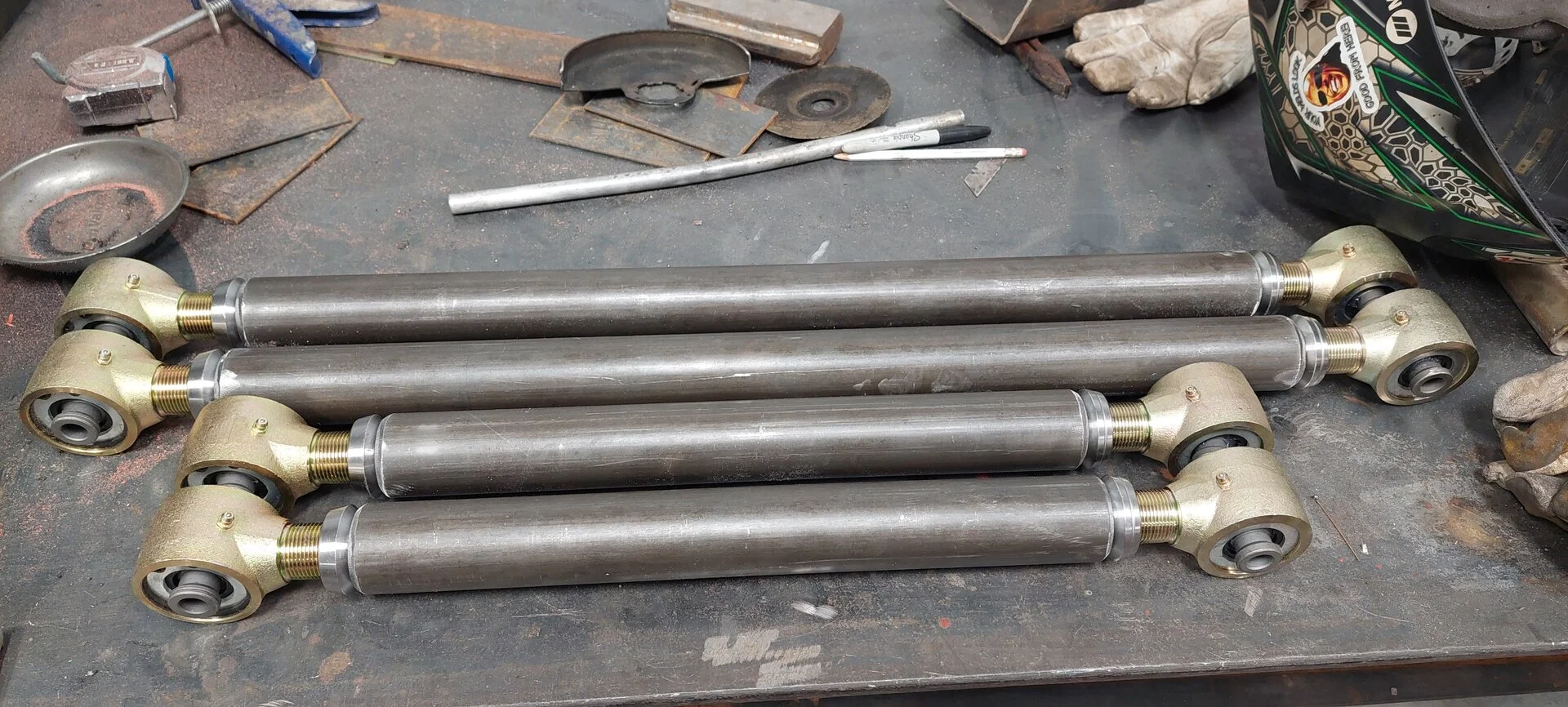

Link time.

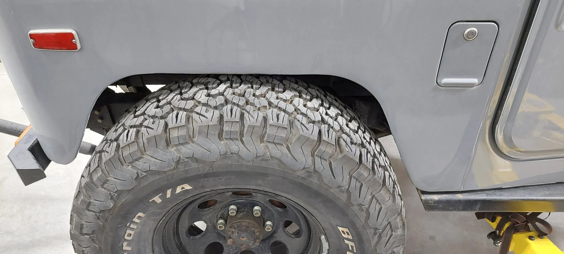

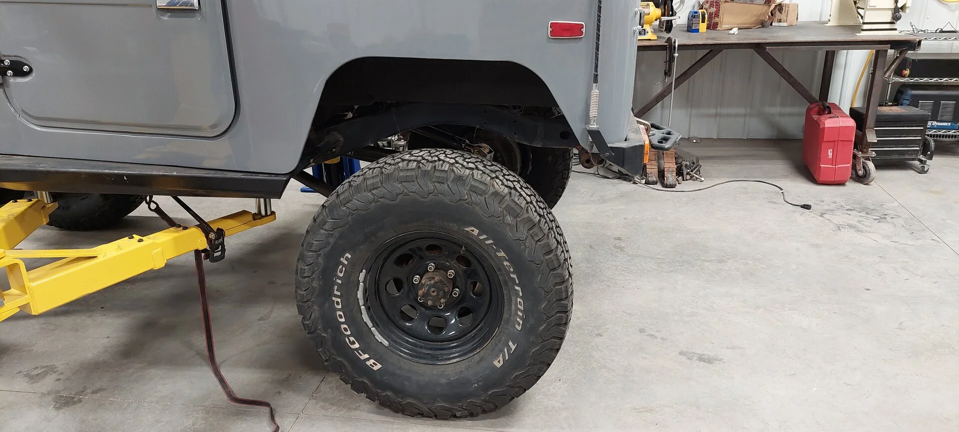

I'm building at full stuff-ish. Max bump will probably be around here, max articulation will probably be close to touching.

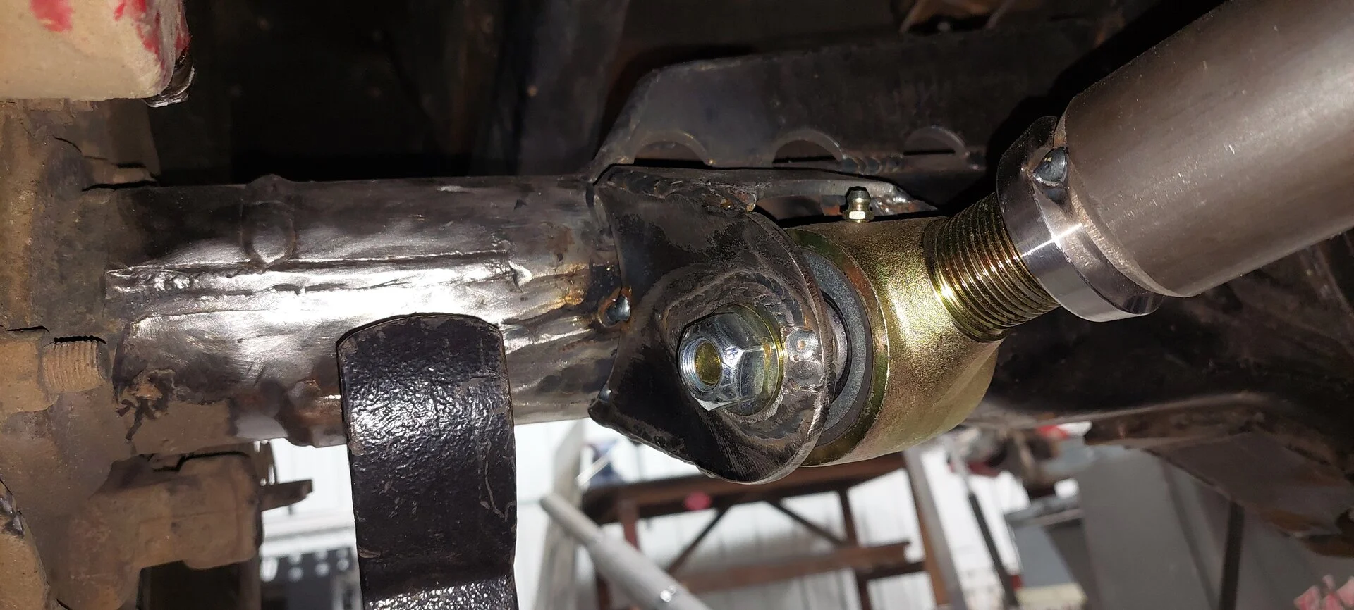

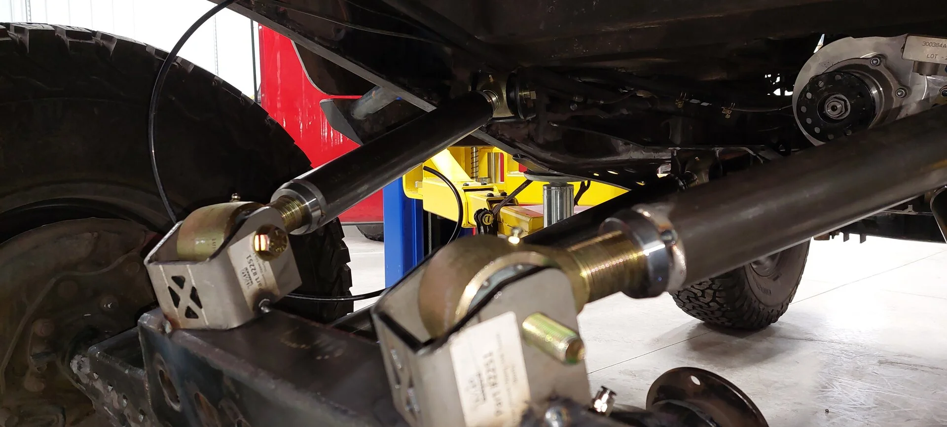

Got the lowers in today, had to make some new more angled axle side brackets. Oh well.
Had some weld washers lying around so I used them, why not, I guess.
Need to trim the uppers, they ended up about an inch long.
New truss looks way better in my opinion.
Anyways, i'll get the uppers finished tomorrow.

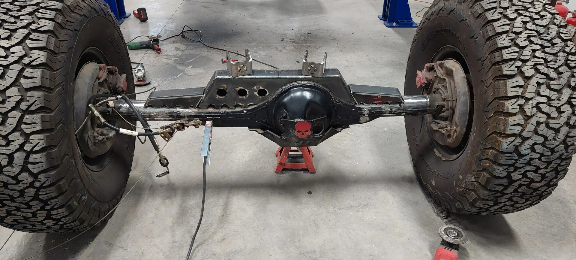

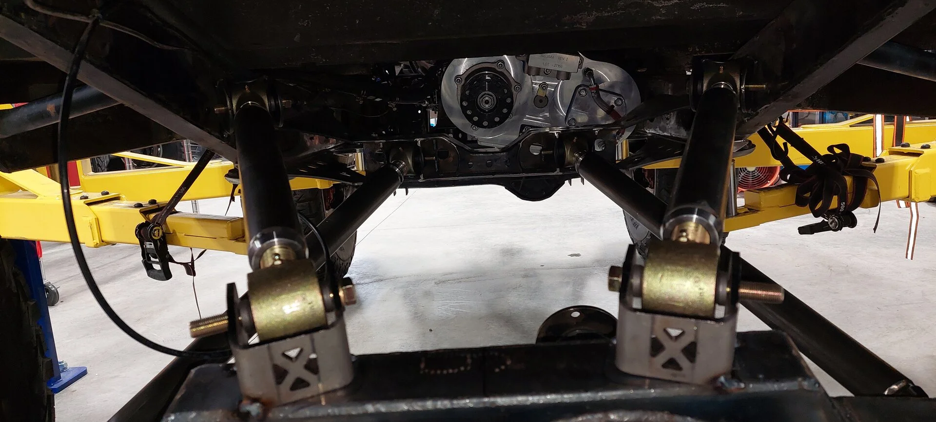

Spent about 2 hours at the ahop today and got the uppers in.
Drooped out.

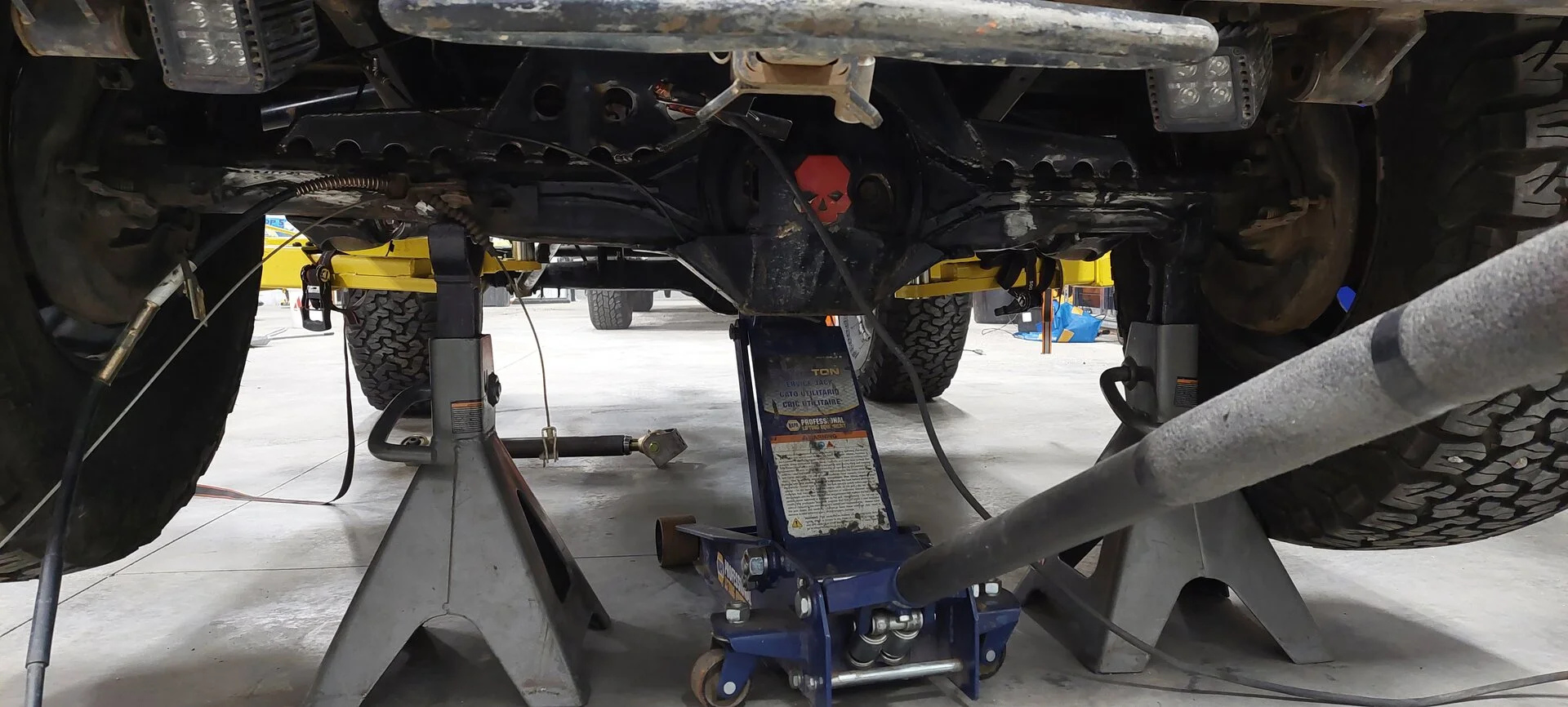

Wait a second you have a center t case and a off set rear :hmm: lol. i have the flipped version
Yep, lol. Cant get an atlas offset, I believe.
Mine is fine. i was worried but its working fine. my samurai was the same way when i put in toy axles from what i understand the early 40 where the same also
I'm barely using any of my joint angle, so i'll be good.
