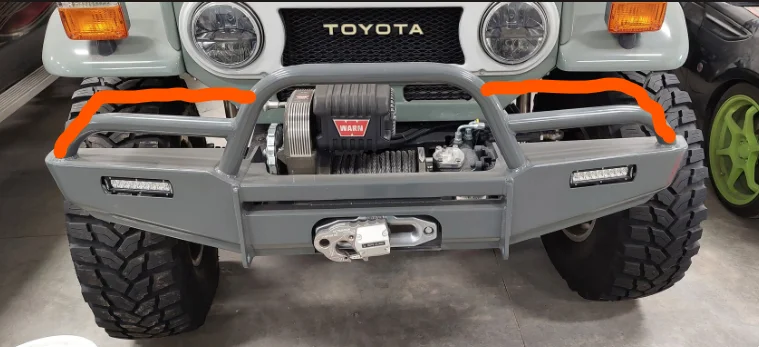

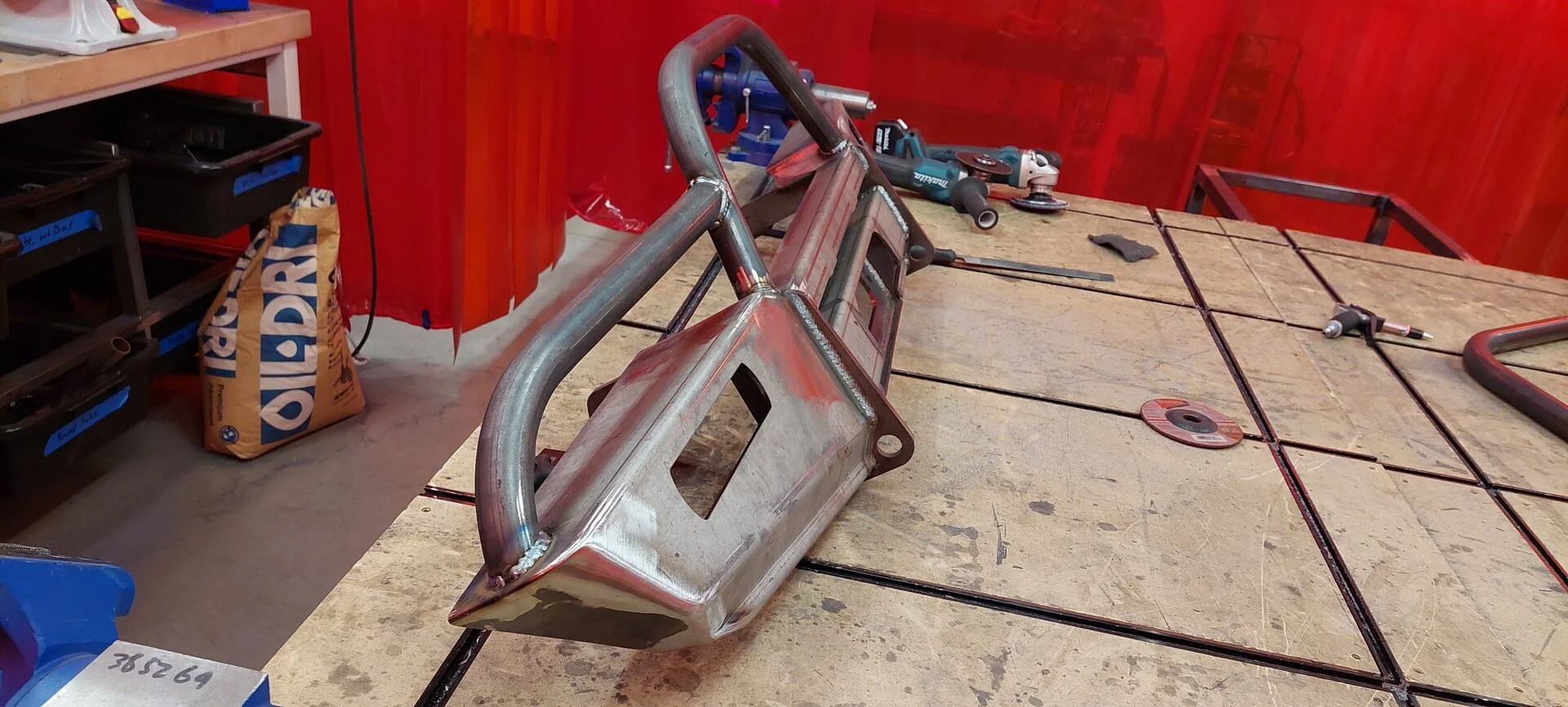

Do i put the side tube wings on or no?
Cant decide.

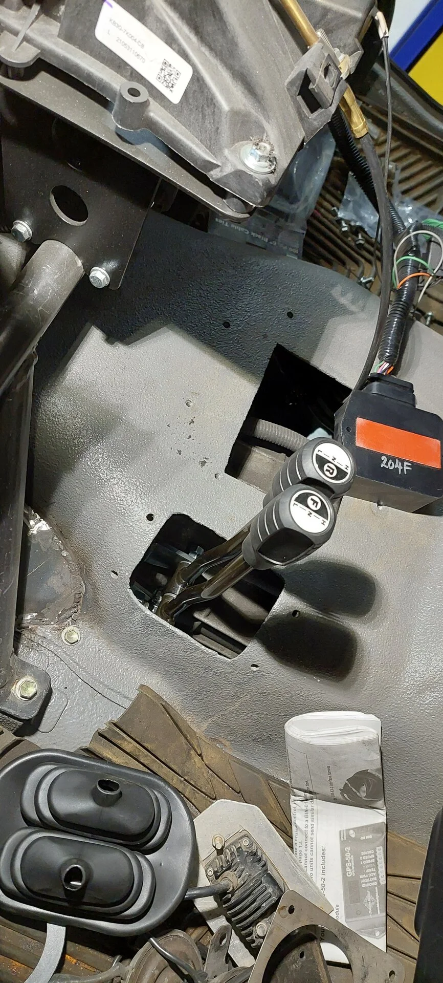

Got the atlas shifting.
Lots more little cleanup stuff getting everything ready for exhaust.
I swear the little stuff no one talks about takes more time and thought process than the big stuff .
Feels like it always adds up to more $$ sometimes too. 😫
Last 5% of the build is 90% of the time lmao

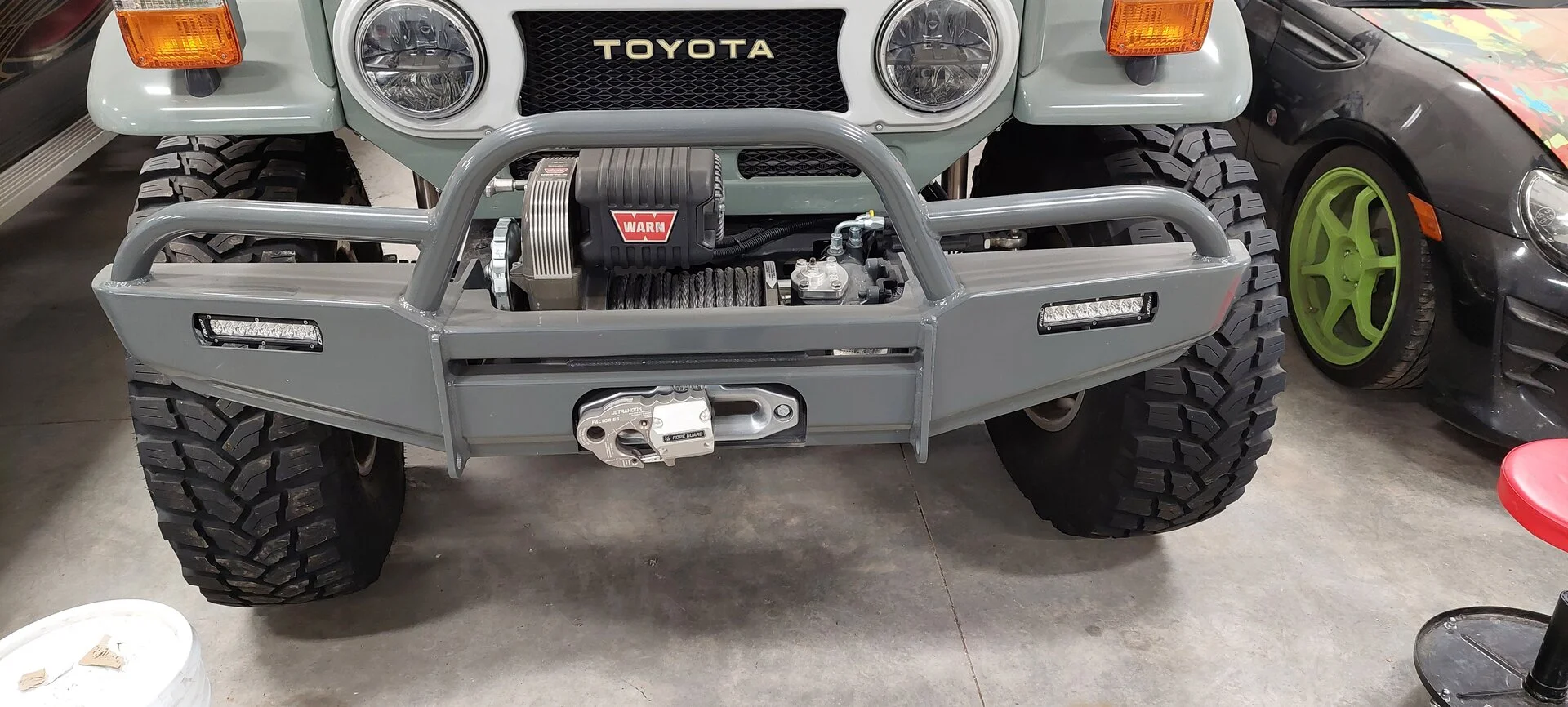

I say yes to side tubes. That bumper has quite a lot of visual mass so the gap between the top of the bumper and the fenders may look a bit off when viewed from the front. The side tubes will fill that space.
Ok, you guys convinced me lol.
Side bois on.

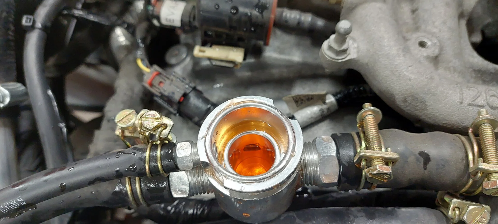

Got the intercooler loop filled and burped.
Started filling the rad and found this:
I'll find a hose that works tomorrow. Hopefully I can find a u similar to that.

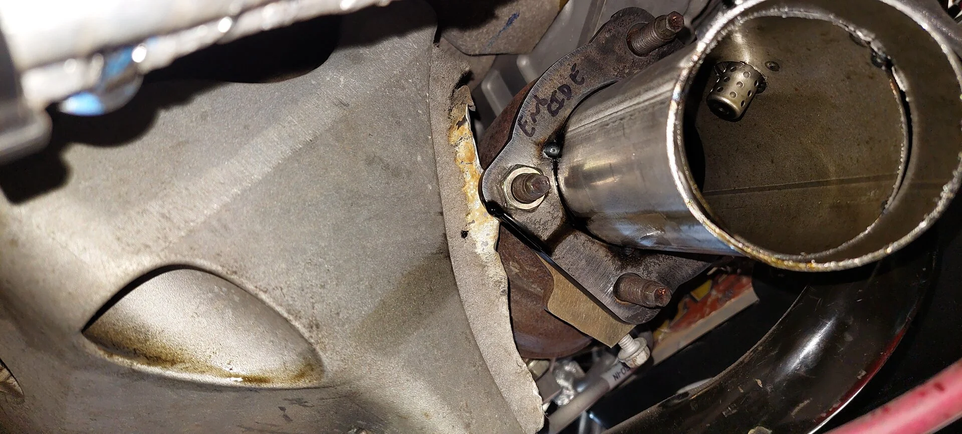

Trying to get exhaust done asap, everything should be here soon. Maybe cruise moab ready. Need to diagnose the no throttle situation, hoping its just a bad calibration on the pedal.
