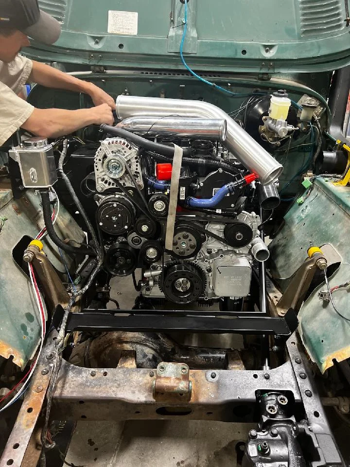

Slowly crawling along on the weekends.

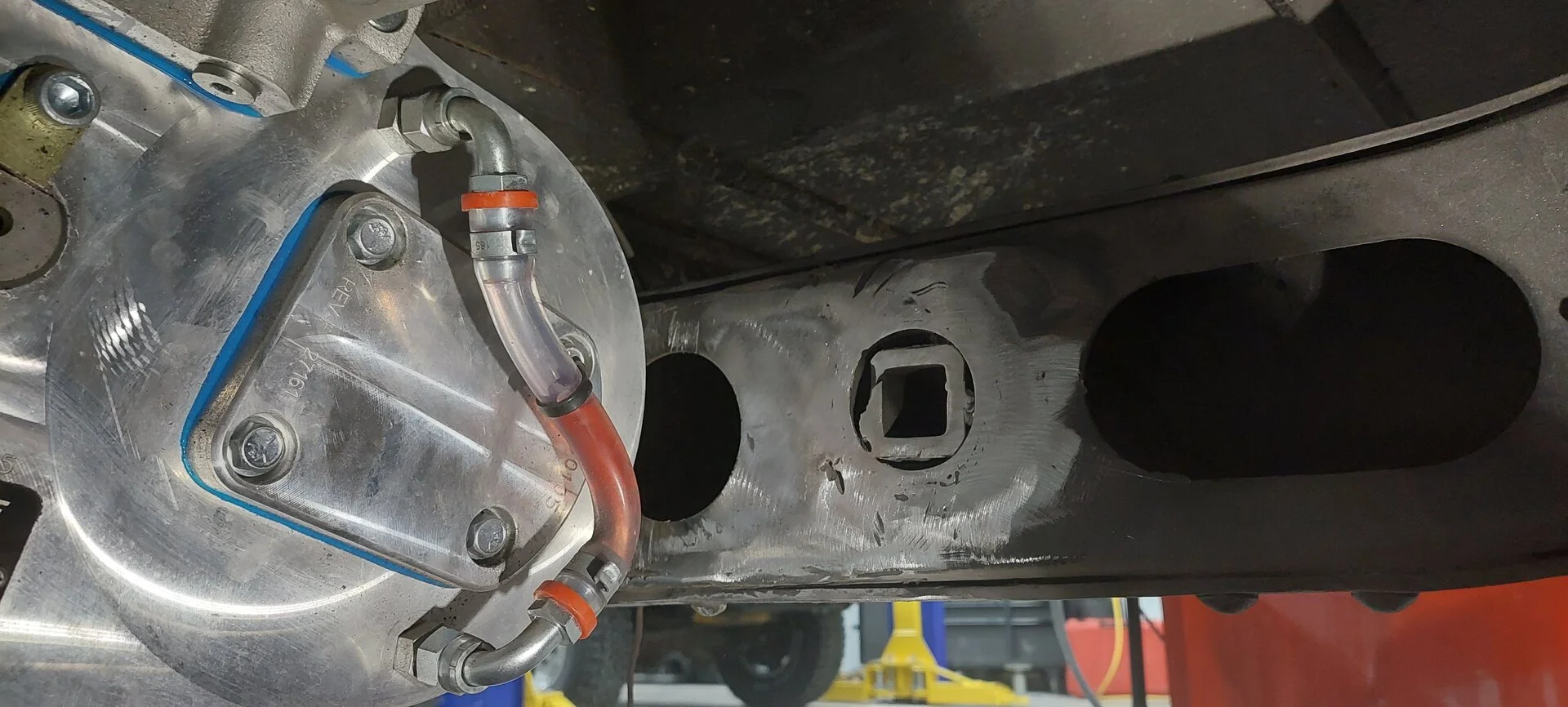

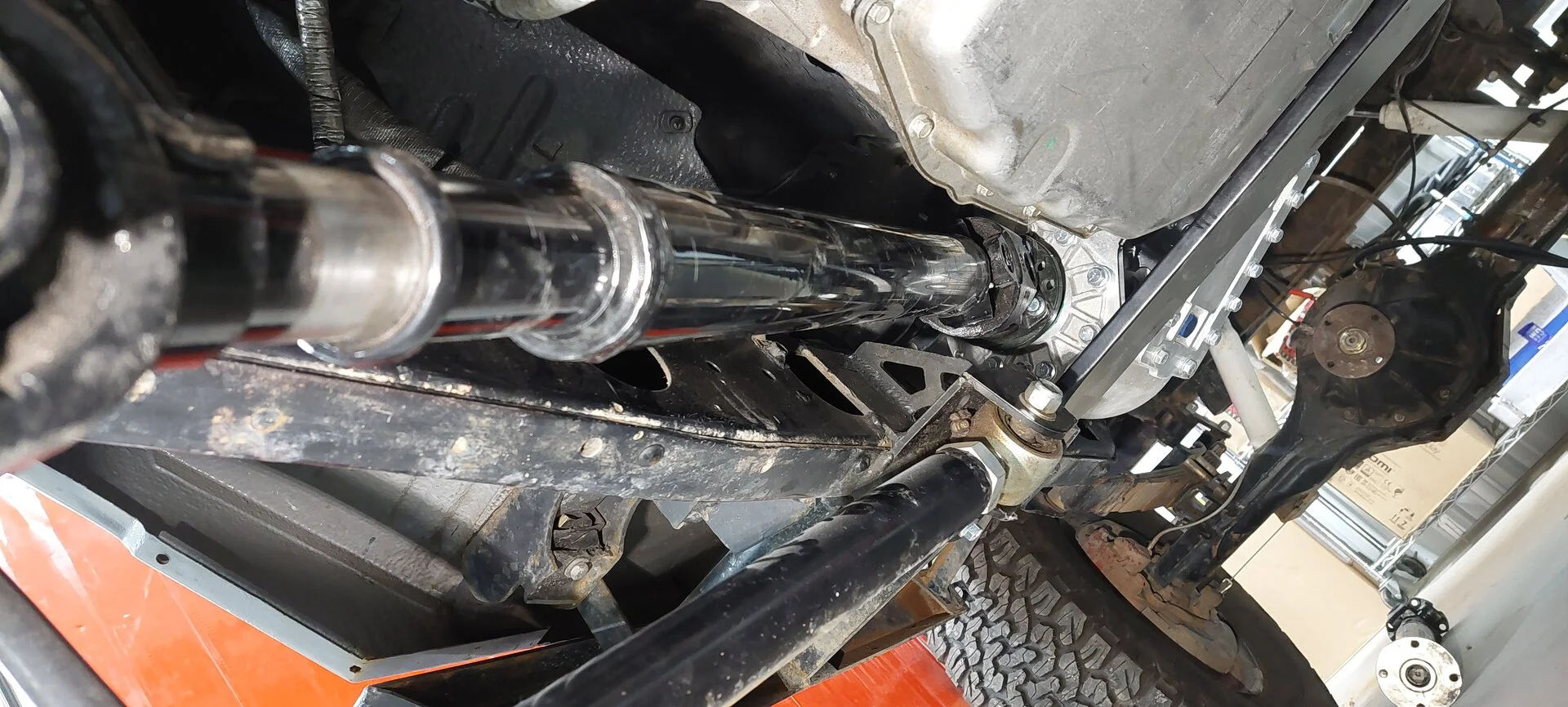

Front driveline clears much better than anticipated, i was expecting to have to move link brackets. Very glad I don't.

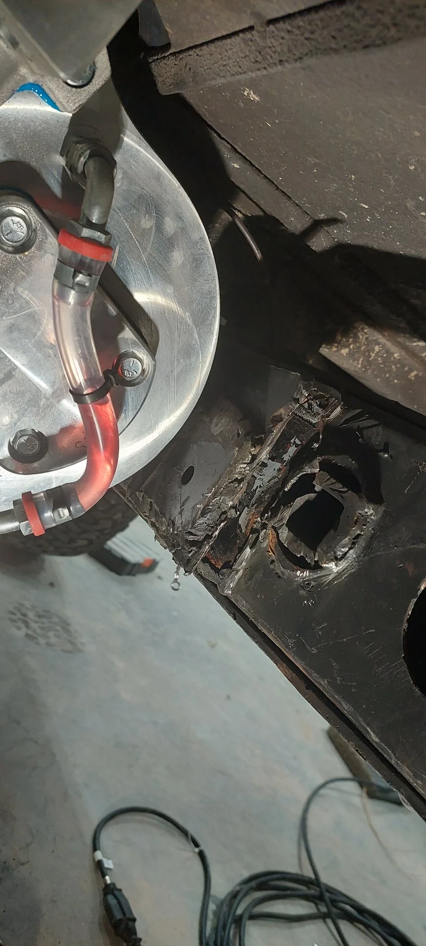

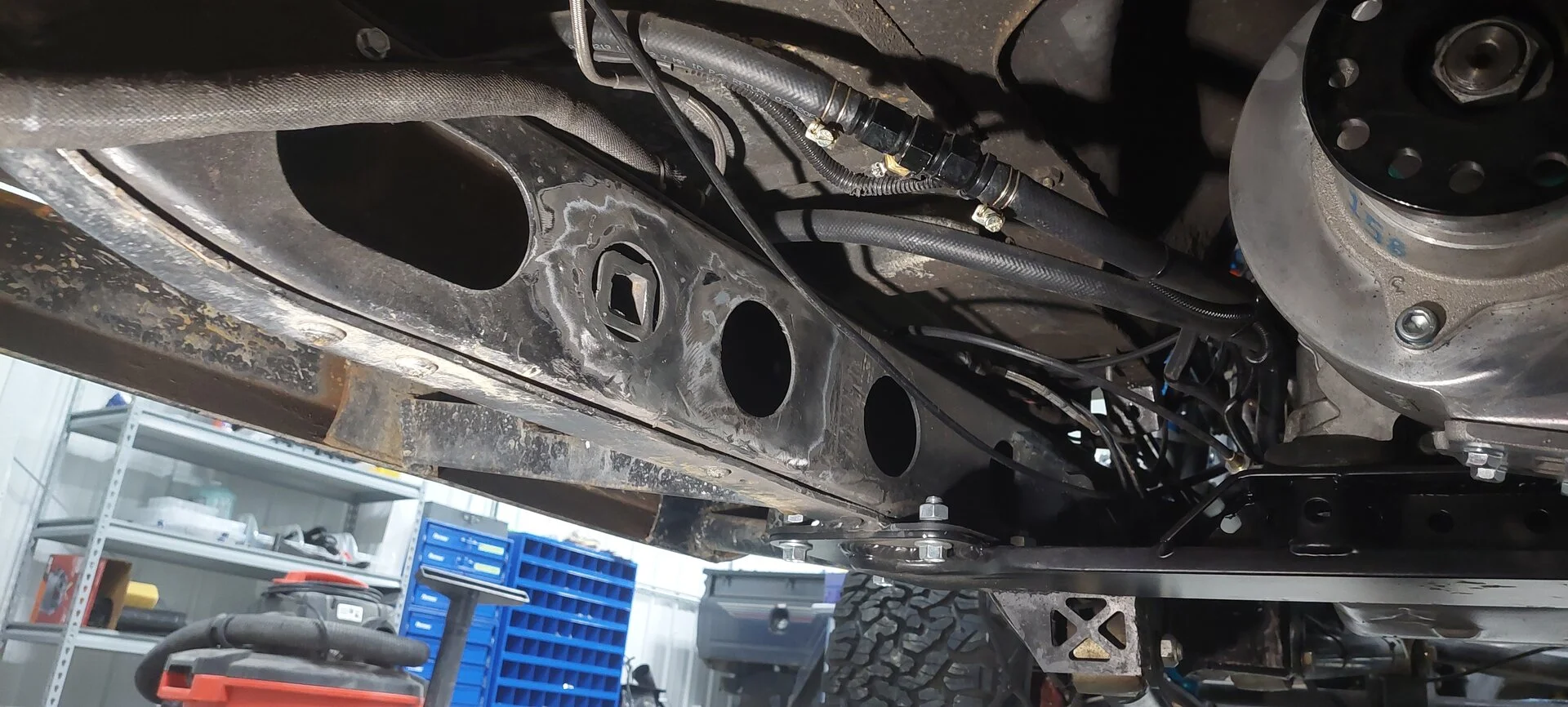

Started cleaning up leftover fishplate from the frame. It sucks.

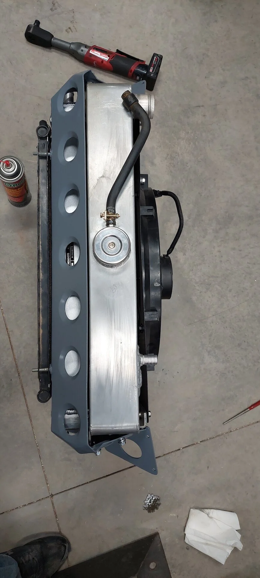

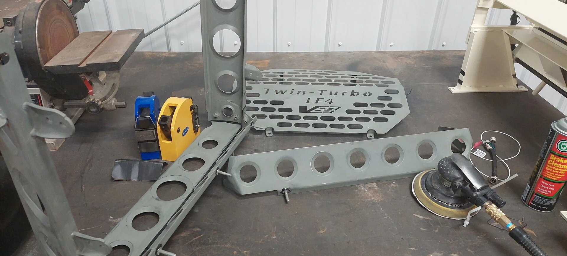

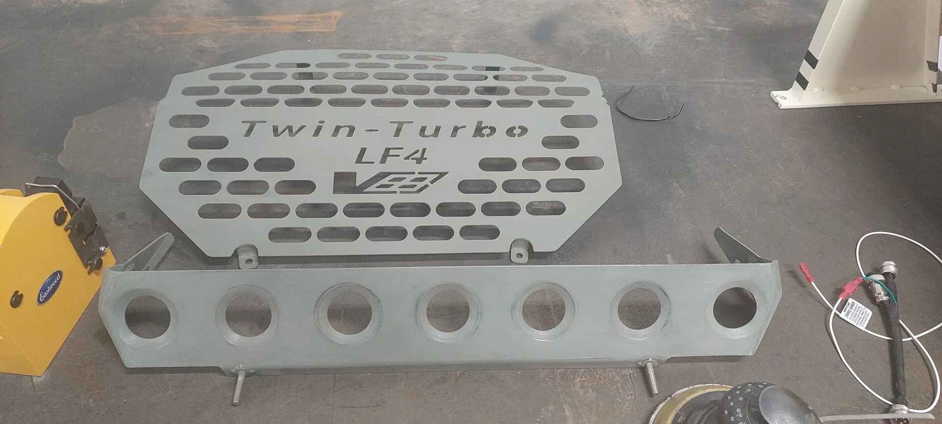

Got the radiator support and vanity cover fully prepped and primed, and sent it off to the shop to get a squirt of paint. They should come back in matte nardo gray.

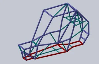

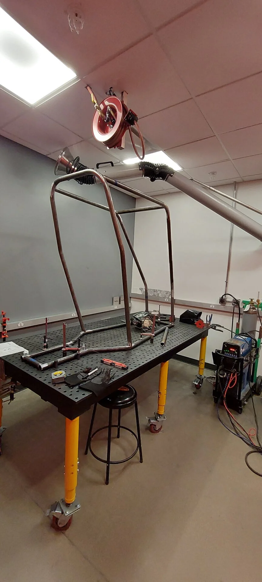

Been super busy cooking up the baja sae chassis. Been teaching the senior design team how to bend tube. Notching has not come so easily to them, lol.
Should end up about like this in the end.
Anyways, should be starting on the rear links soon.
Wish we still had a Baja team
Lol we have 15 members. First year team. 4 seniors for design, rest are people that are interested.
That’s good. We have about 30 split beteeen a formula student Internal combustion and EV team. Most people just aren’t interested in putting in the work for the team, because it is a lot of work. People do stuff like this as a full time job

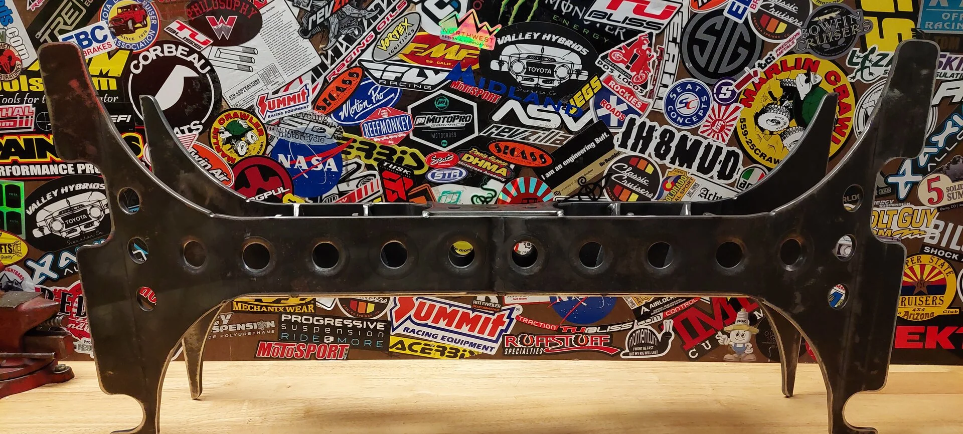

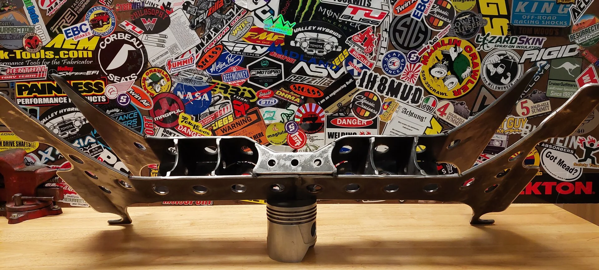

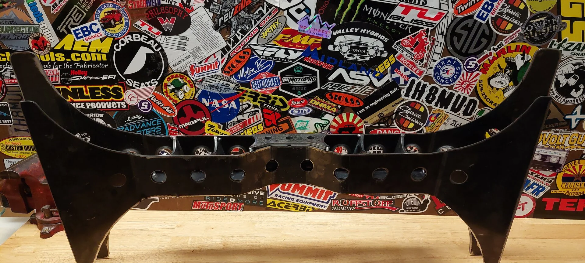

Rear lower link mount brackets modeled. Hopefully will get them cut out this weekend.

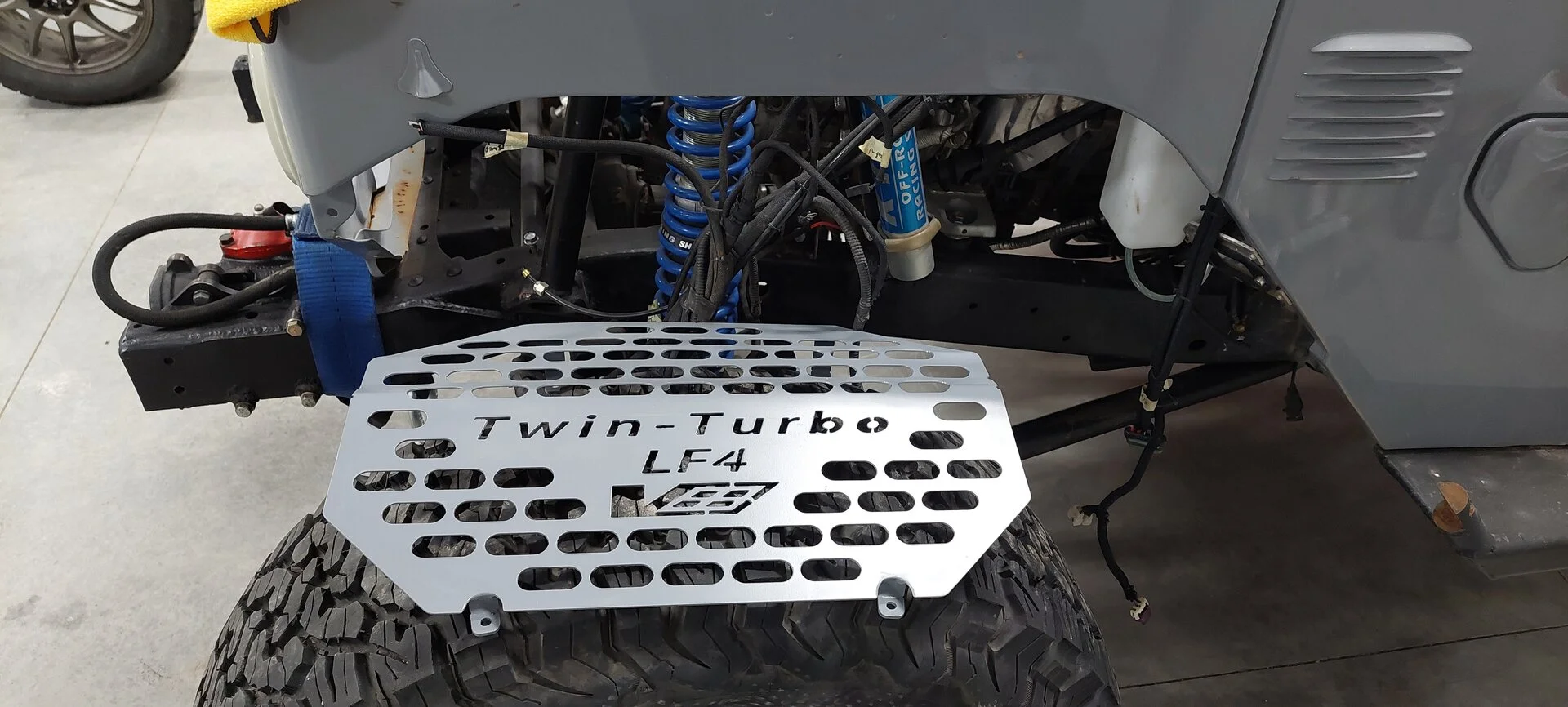

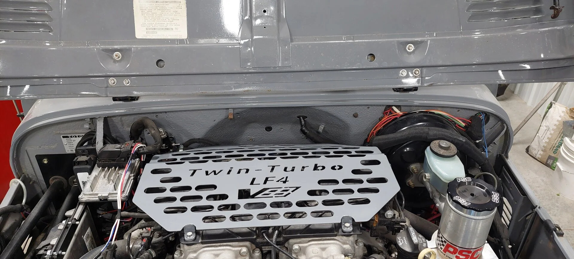

Stuff got painted this week, so it was ready to install. It looks like primer lol. Maybe I'll buff it. What do you all think?
Vanity cover
Installed.
Found a belt, 86 5/8" for my refrence later lol.

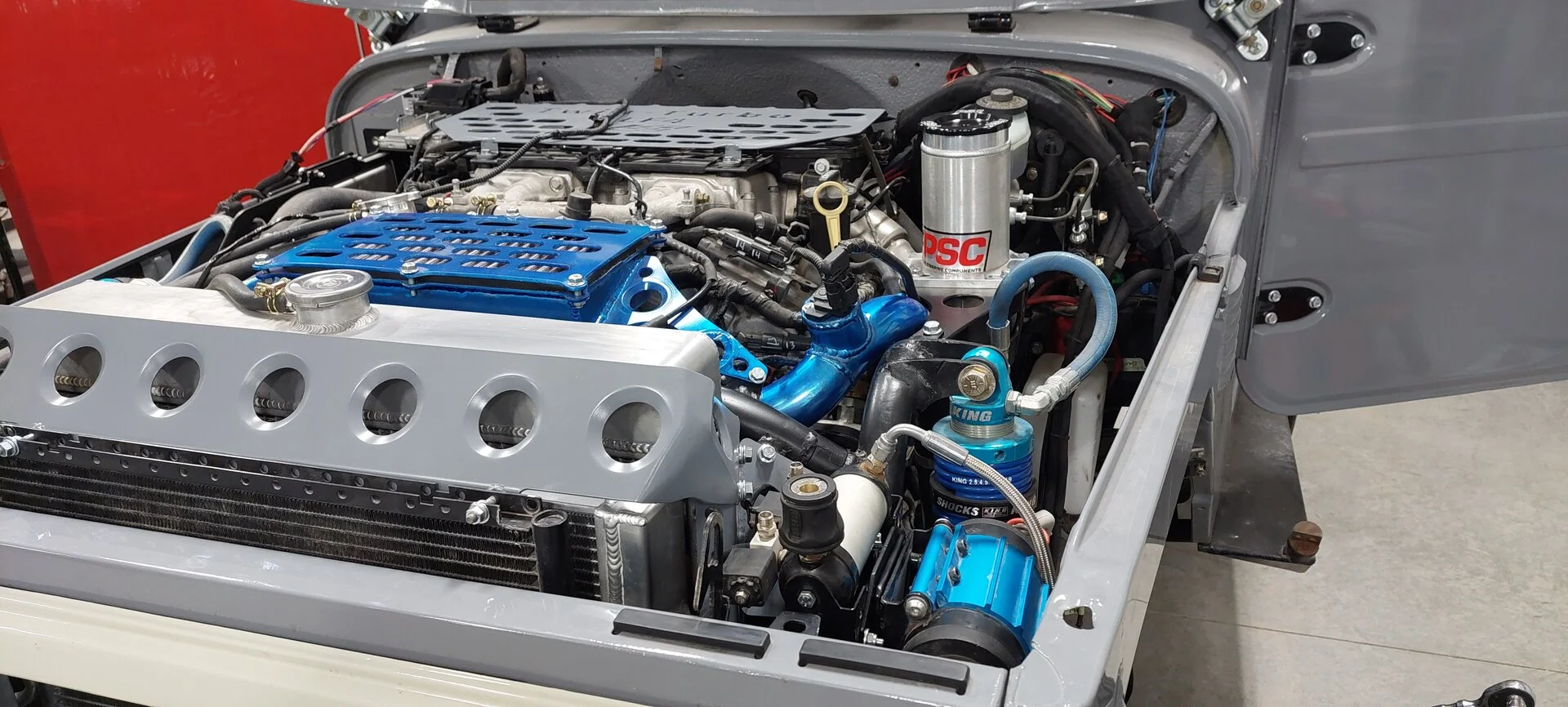

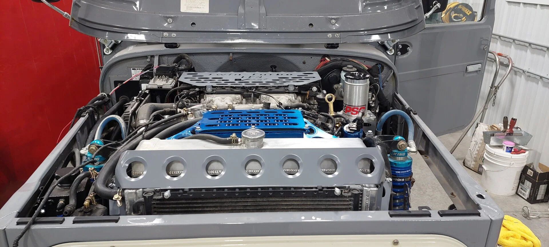

Rad stack back together, hopefully for the last time.
Shoved back in.
Compressor bracket.
Compressor and manifold installed.

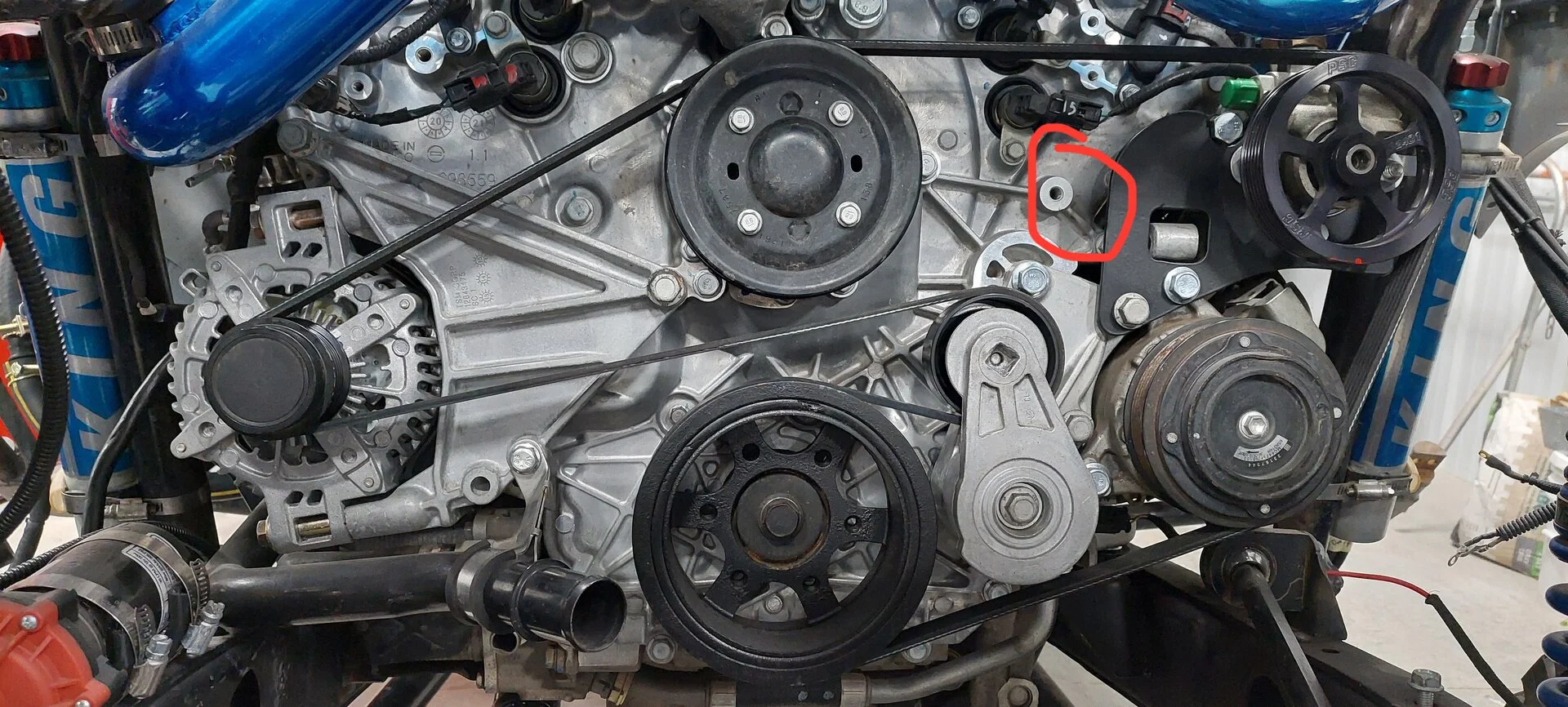

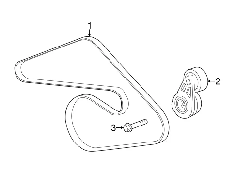

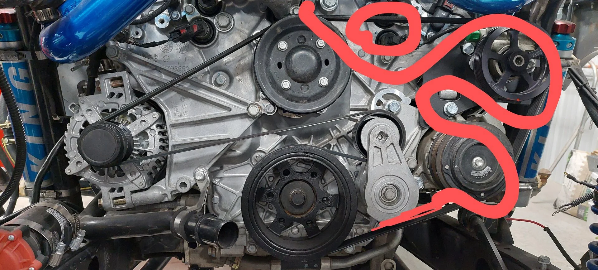

That’s the factory belt routing? There’s hardly any belt wrap on that stuff. Kinda weird.
Similar to one, but I added the power steering. Lf has no power steering pump. Looks like this factory. I might see what I can do to get more contact, but I'll run it and see if it slips first.
That ac compressor will slip, guaranteed, without more belt wrap. Water pump might get by, but that's not much there either.
With a pulley in that highlighted boss, looks like you could go from the waterpump down around that pulley to the ps, or from the ps in around that pulley then to the ac compressor.
BTW, whole thing looks sick. Nice work.

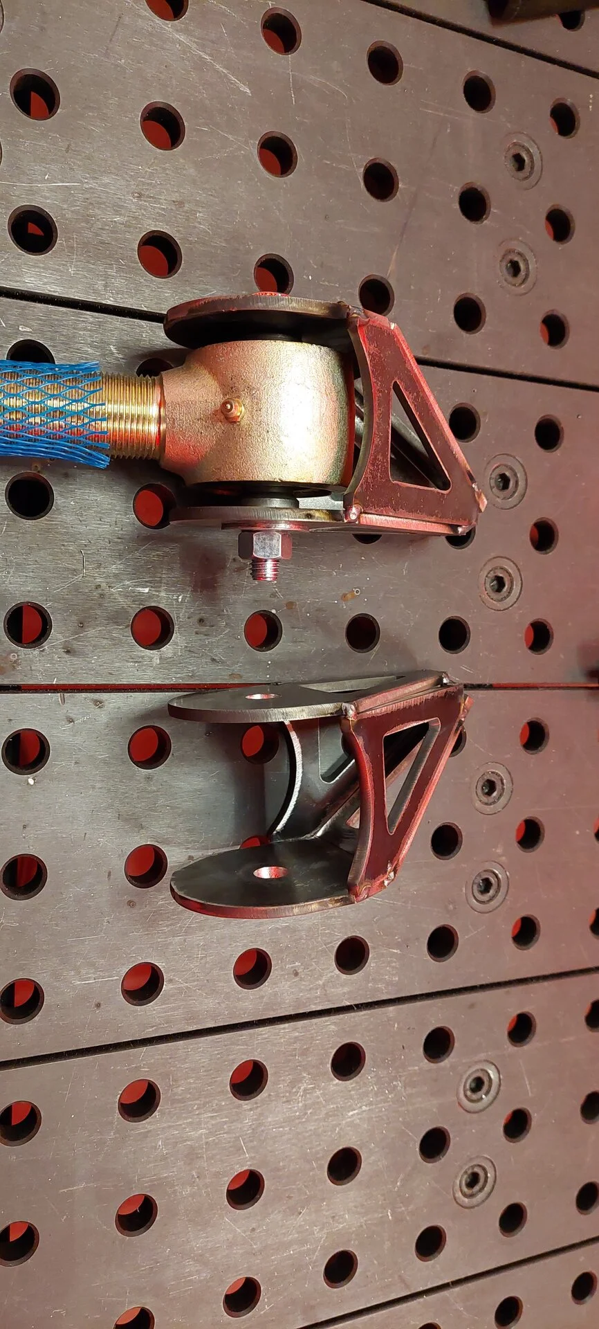

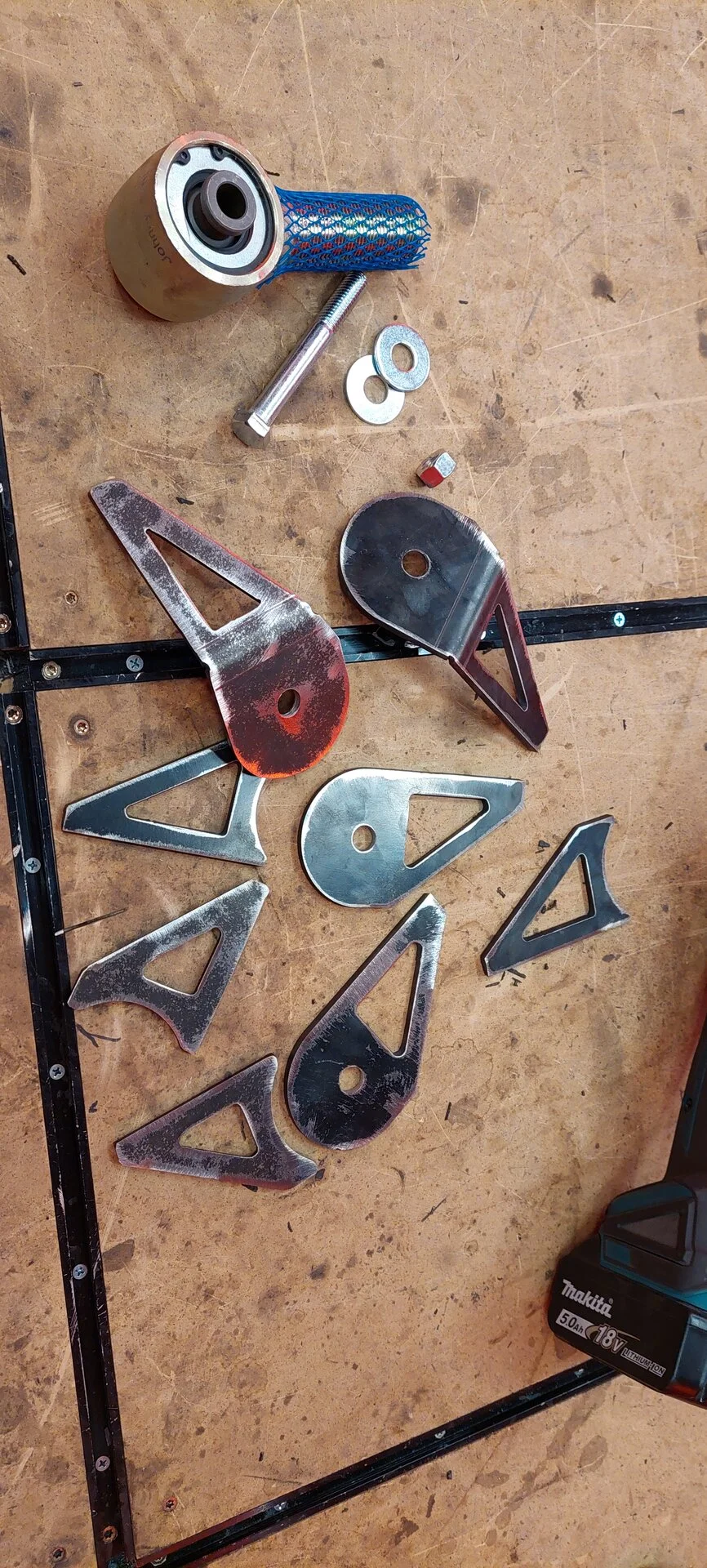

Got my lower link mount cut and ready to install, as long as it fits in my frame lol.
I'm happy to provide models / DXFs if anyone wants them.

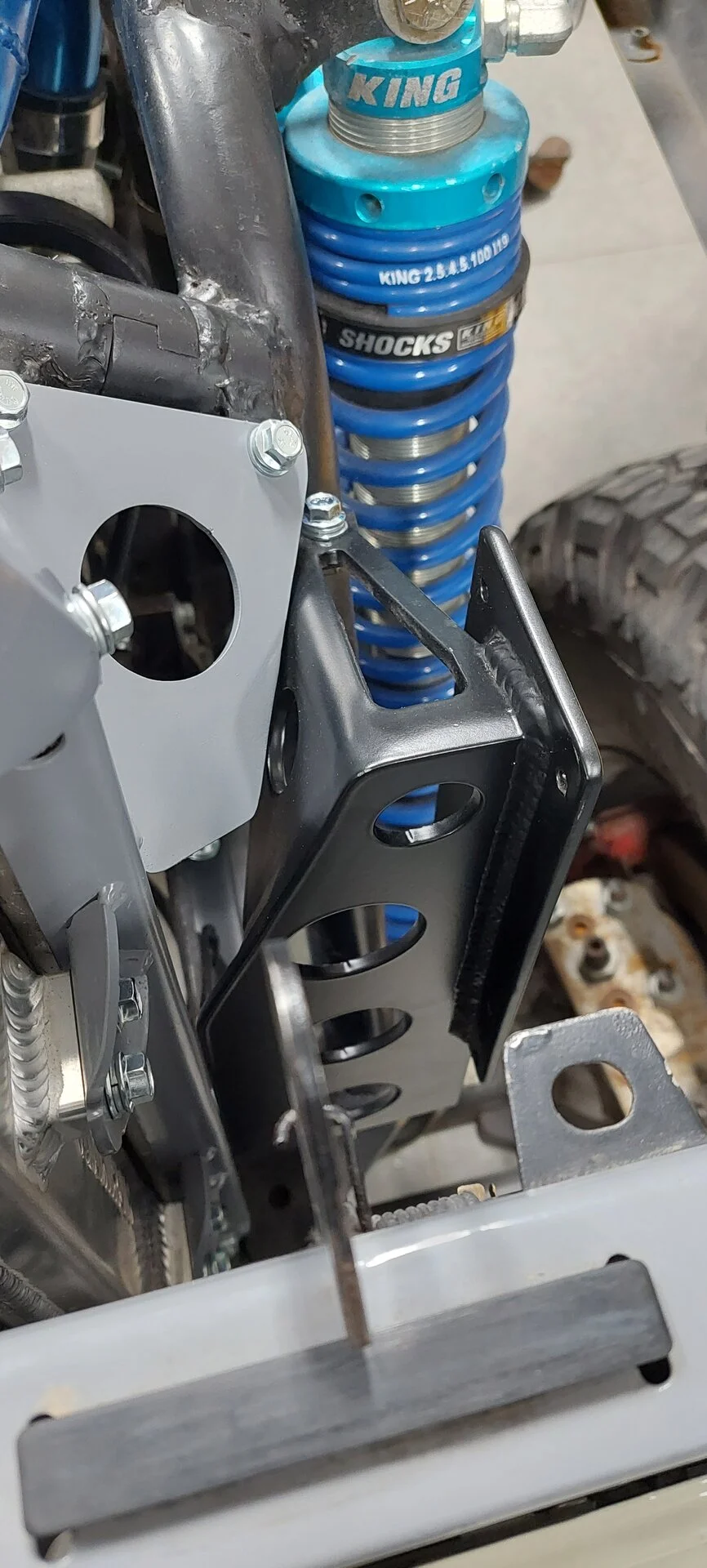

Upper link mounts.
I have the cad for thoses as well, if anyone is interested.
