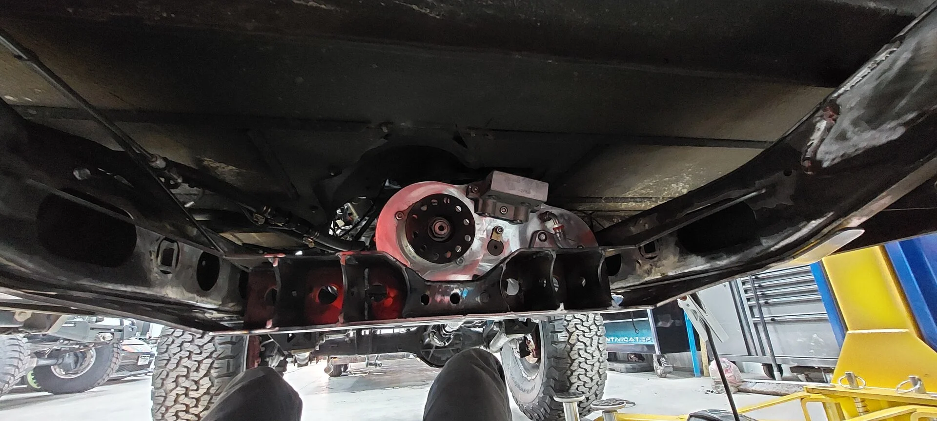

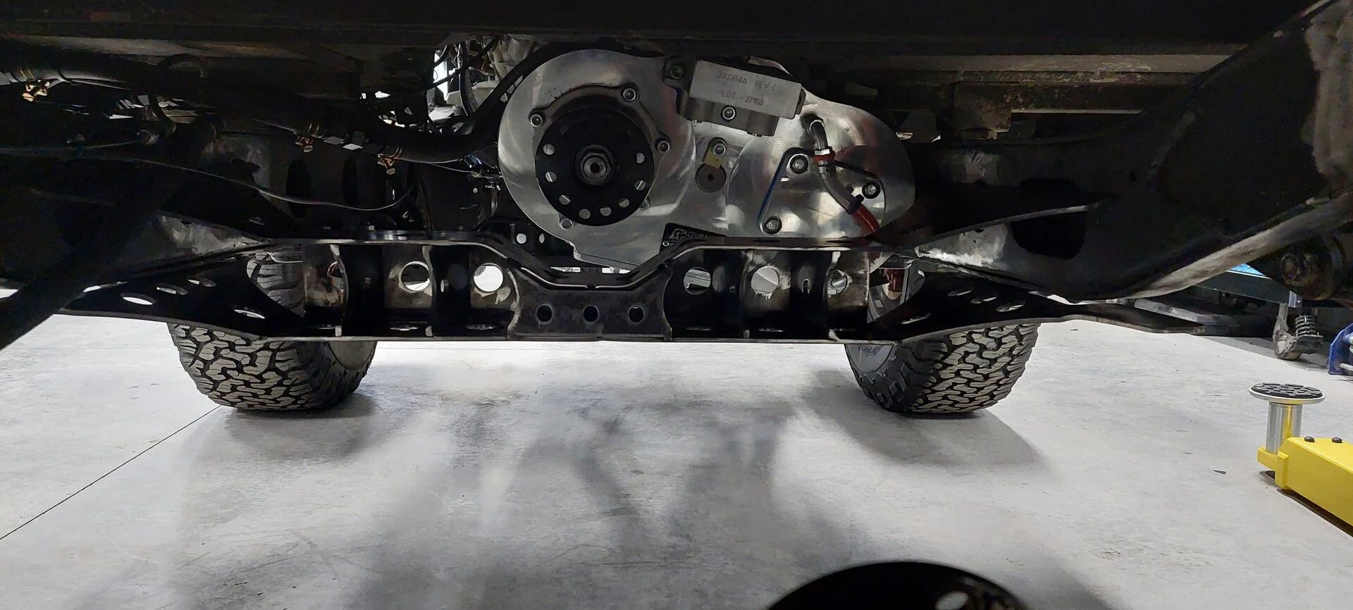

Well, the CAD and the Cad that I did worked like a charm.
The crossmember holds itself inplace dead on the money.
Pretty stoked with how it looks and fits.
Uppers fit very nicely as well, so they got burned in and ground.
Got the crossmember burned in as well, waiting for full link fitment to weld to the frame, though.
Fun welds for sure. Running a new Lincoln as well, so that was interesting.

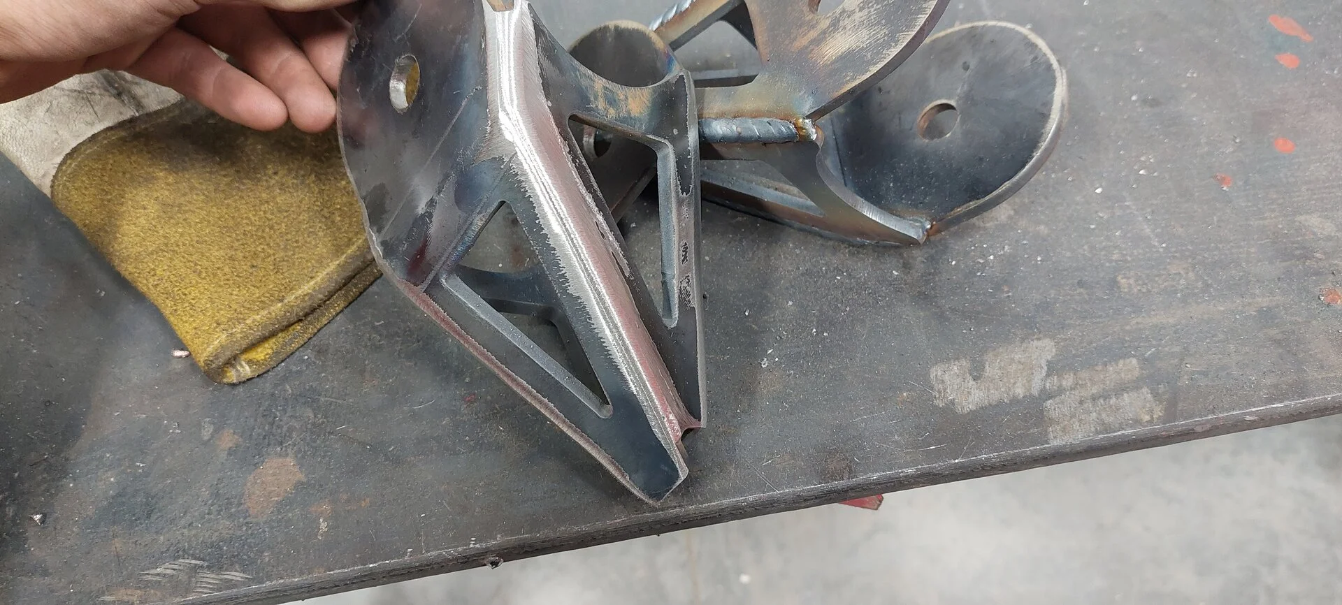

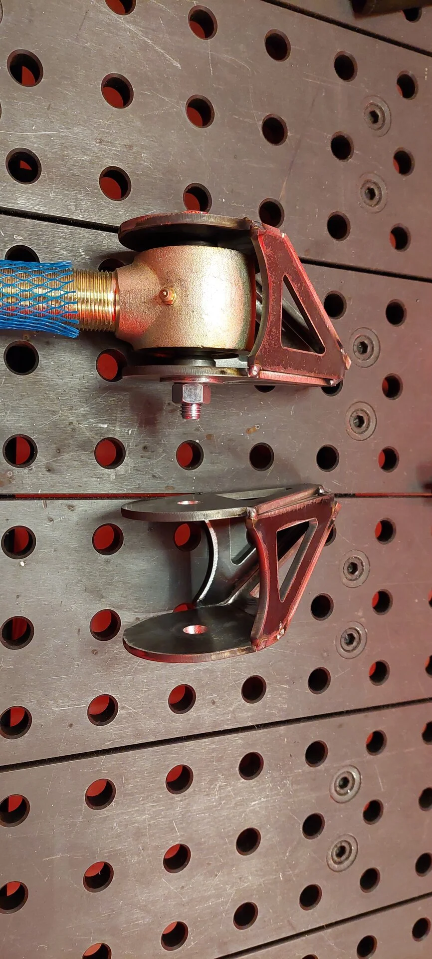

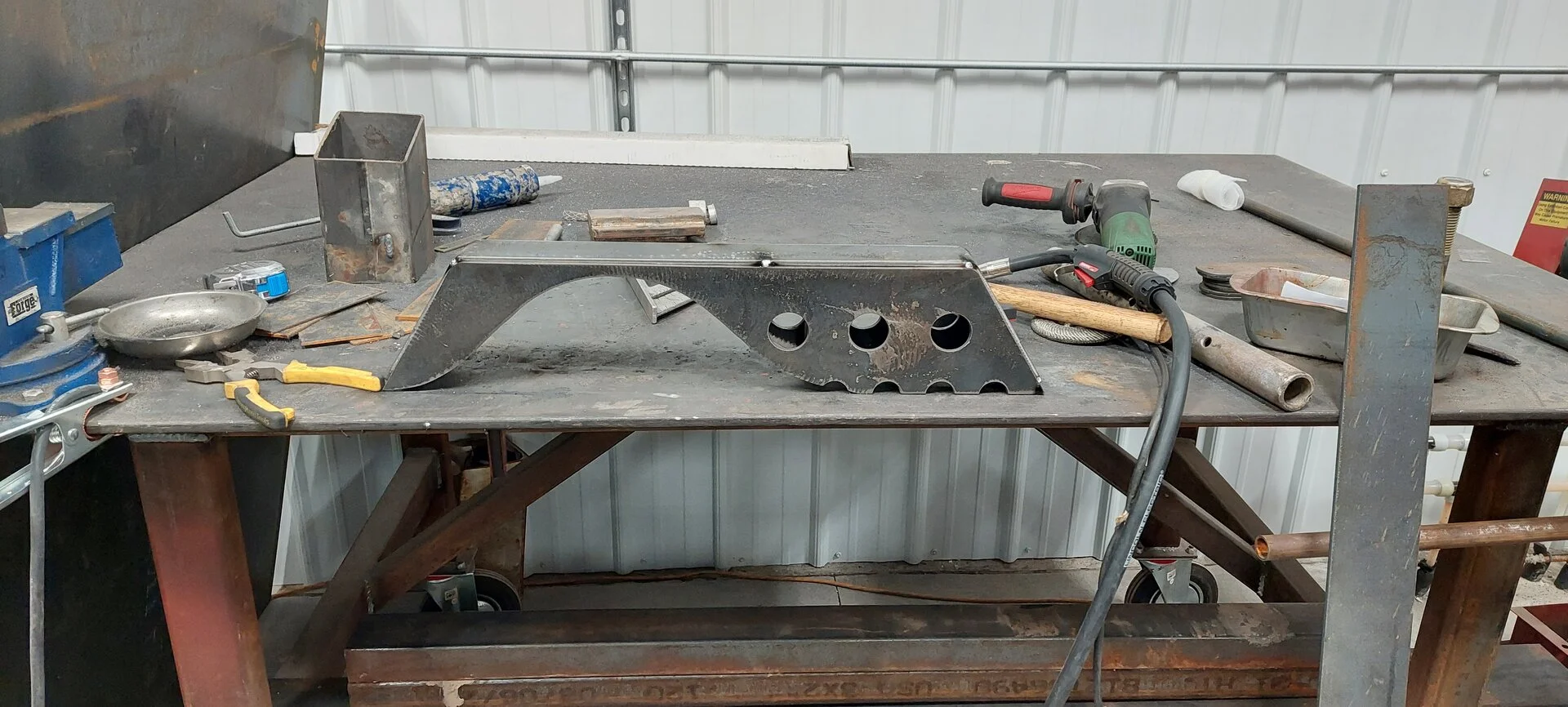

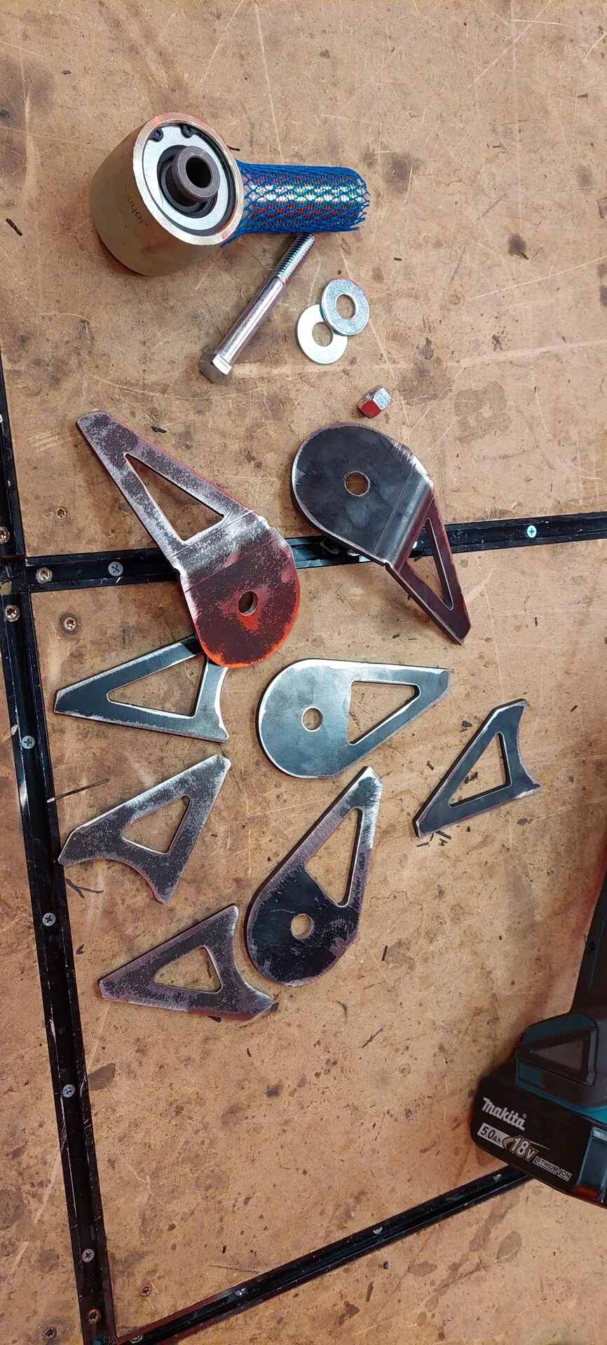

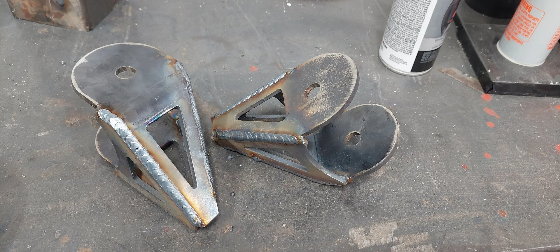

Here is how those upper mounts started. Nice little pile of parts.
Not super great fitment, but I only had about an hour to get them done, lol.

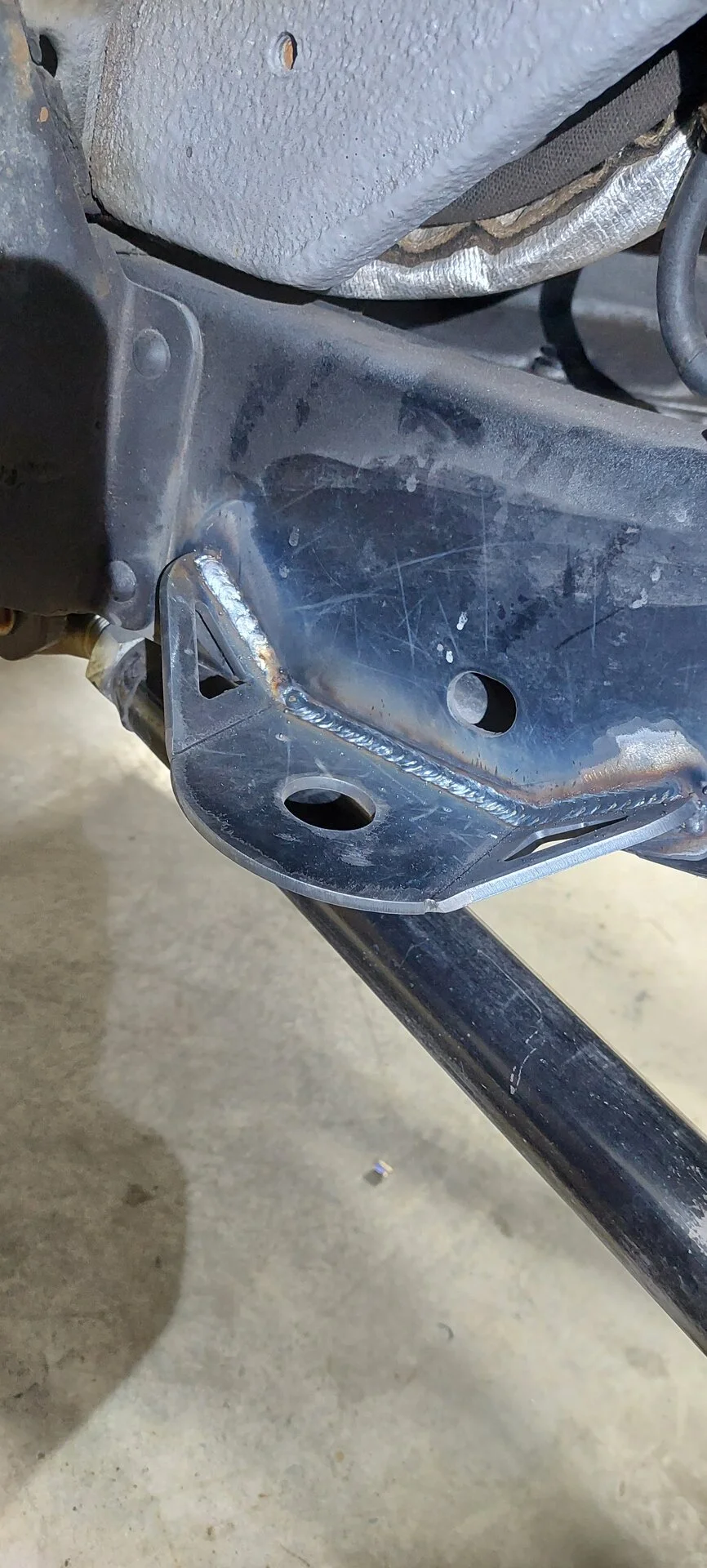

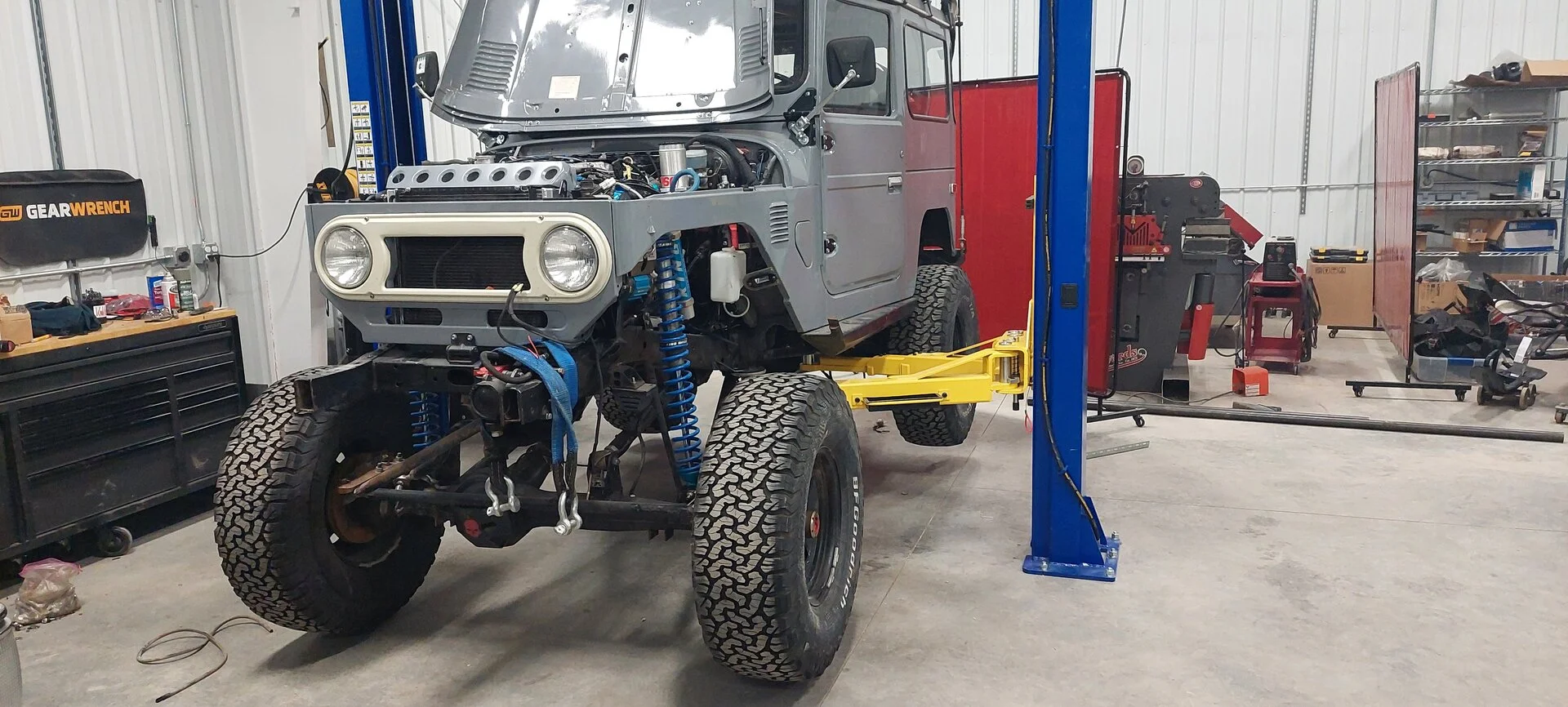

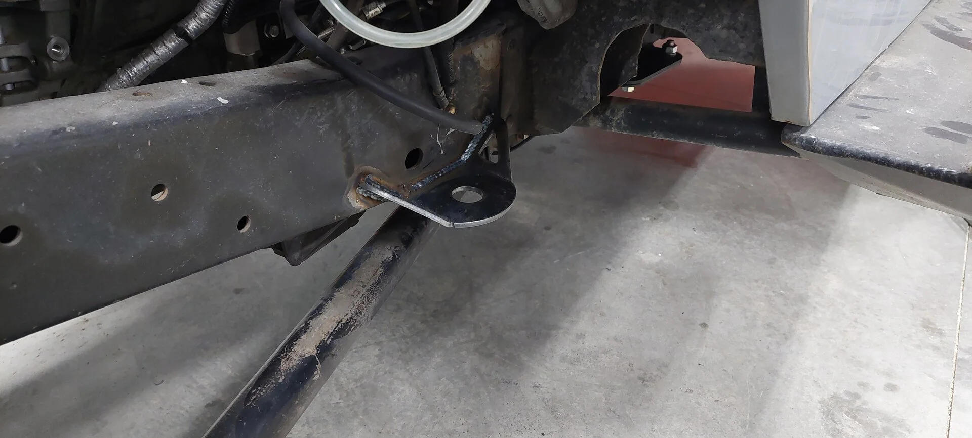

The next little peeve of mine got fixed today. My front link geometry pushed my lowers into the frame, it's a pain in the balls to get this thing on a hoist. Well, no longer.
Made 2 little dudes to stick lift arms on and got them burned onto the frame today.

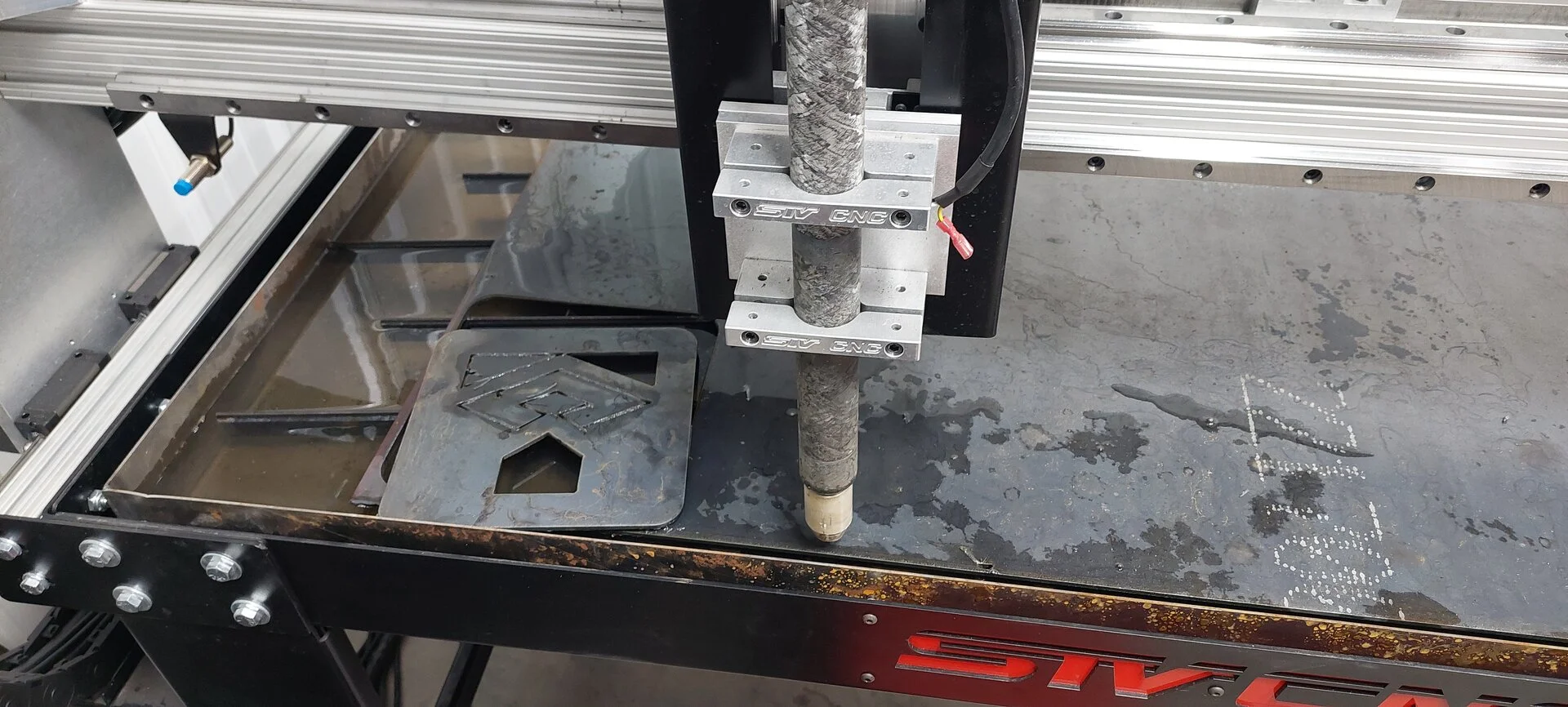

I also got the new plasma table up and running today, so I will finally get to build stuff with actual reference geometry instead of guessing lmao. Need to learn new setting for this table, as it's all manual.

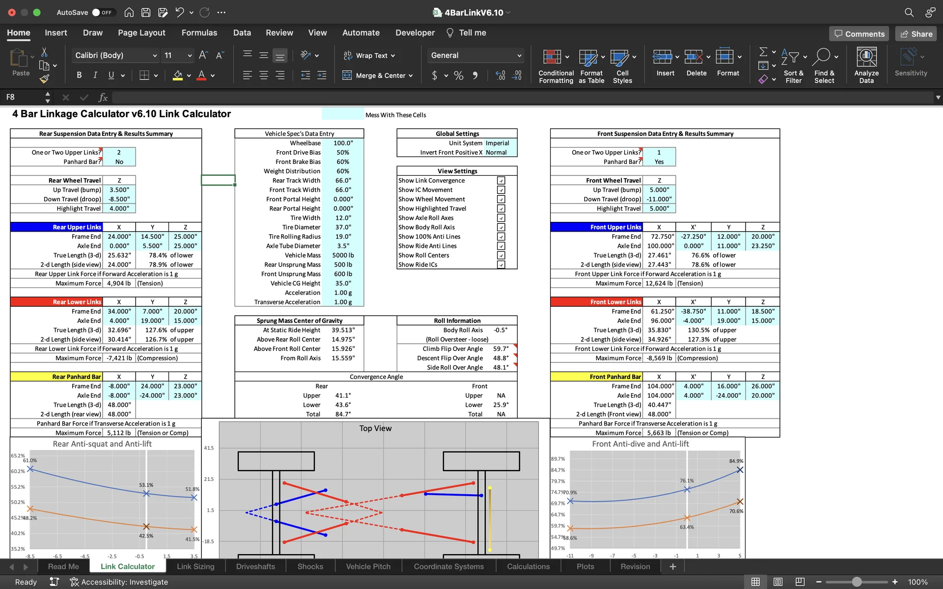

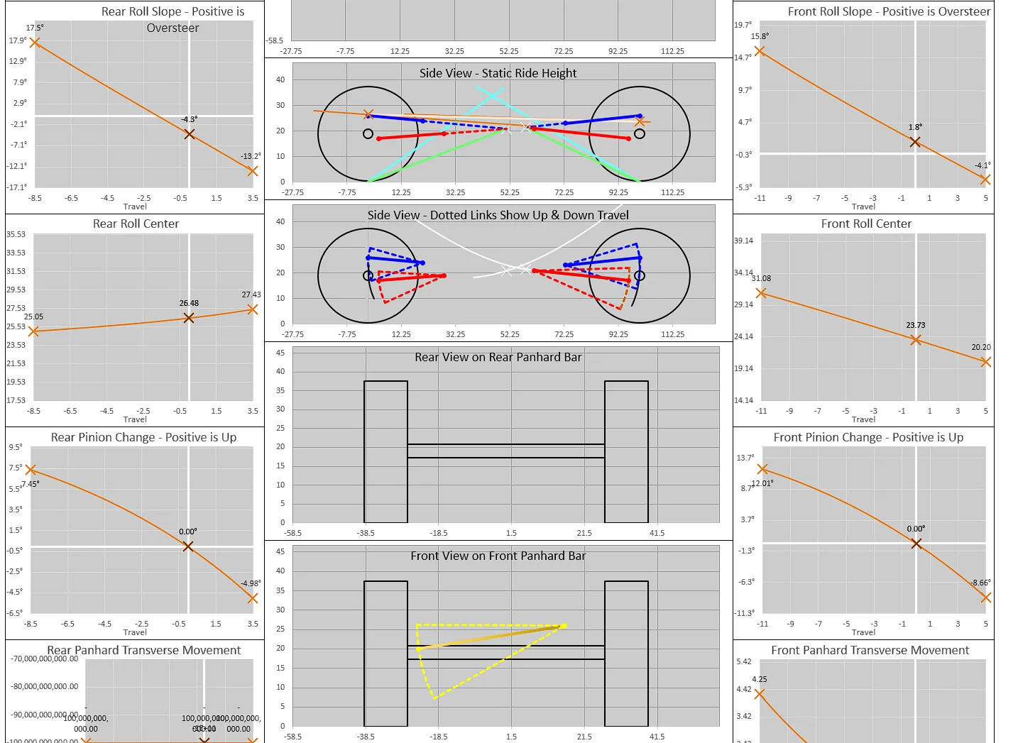

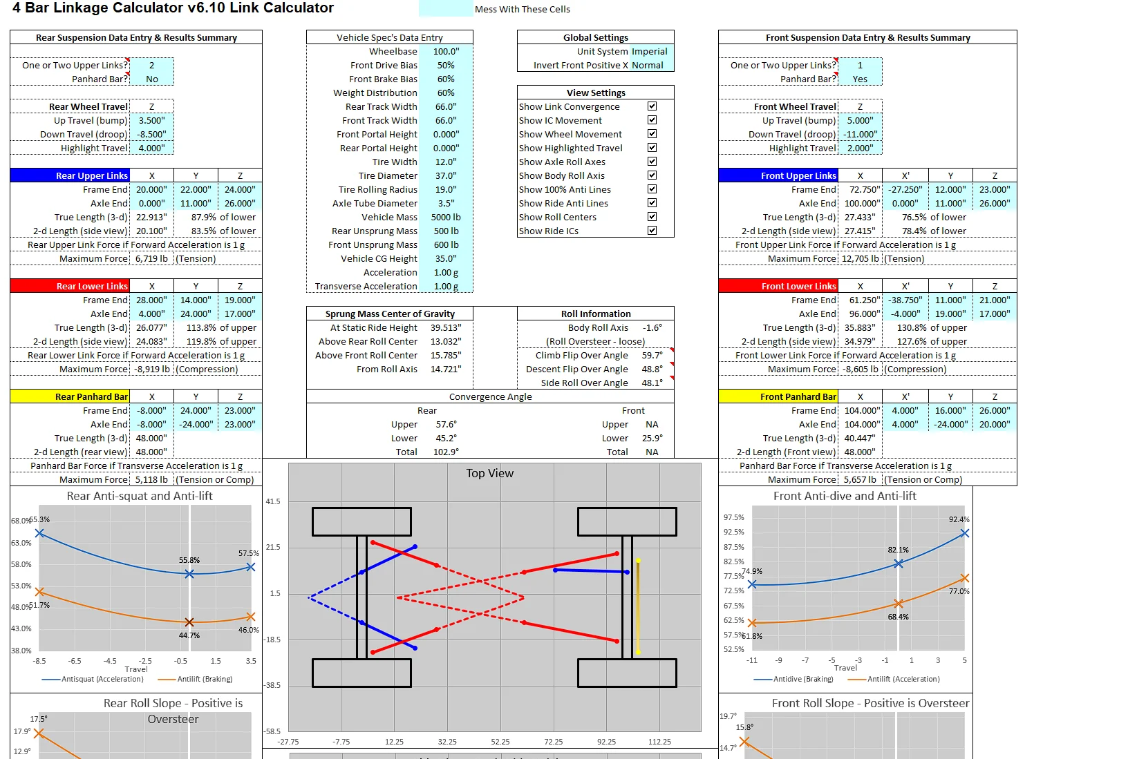

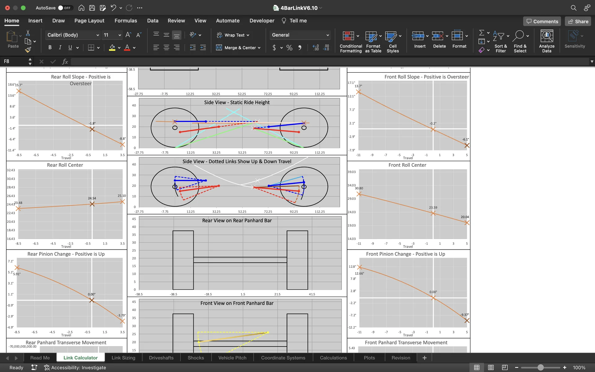

On the more technical side of things, here is how my geometry is stacking up, currently. Subject to change, but it's roughly there.
I'm hoping to fix my front unloading issues with some upper link changes that are necessary for clearance, but we'll see.

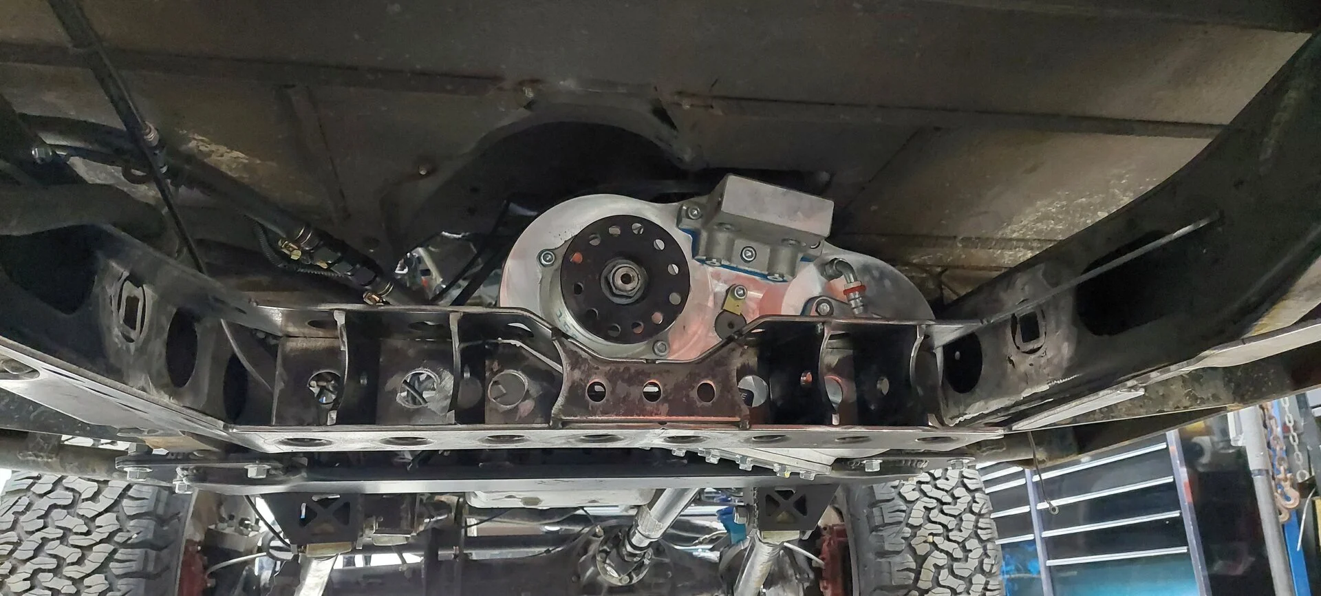

Starting to tack everything in for frame side links.
I still need to get the backing plates made to finish the rest of the crossmember, but those will be last in line after final welding for torch access.

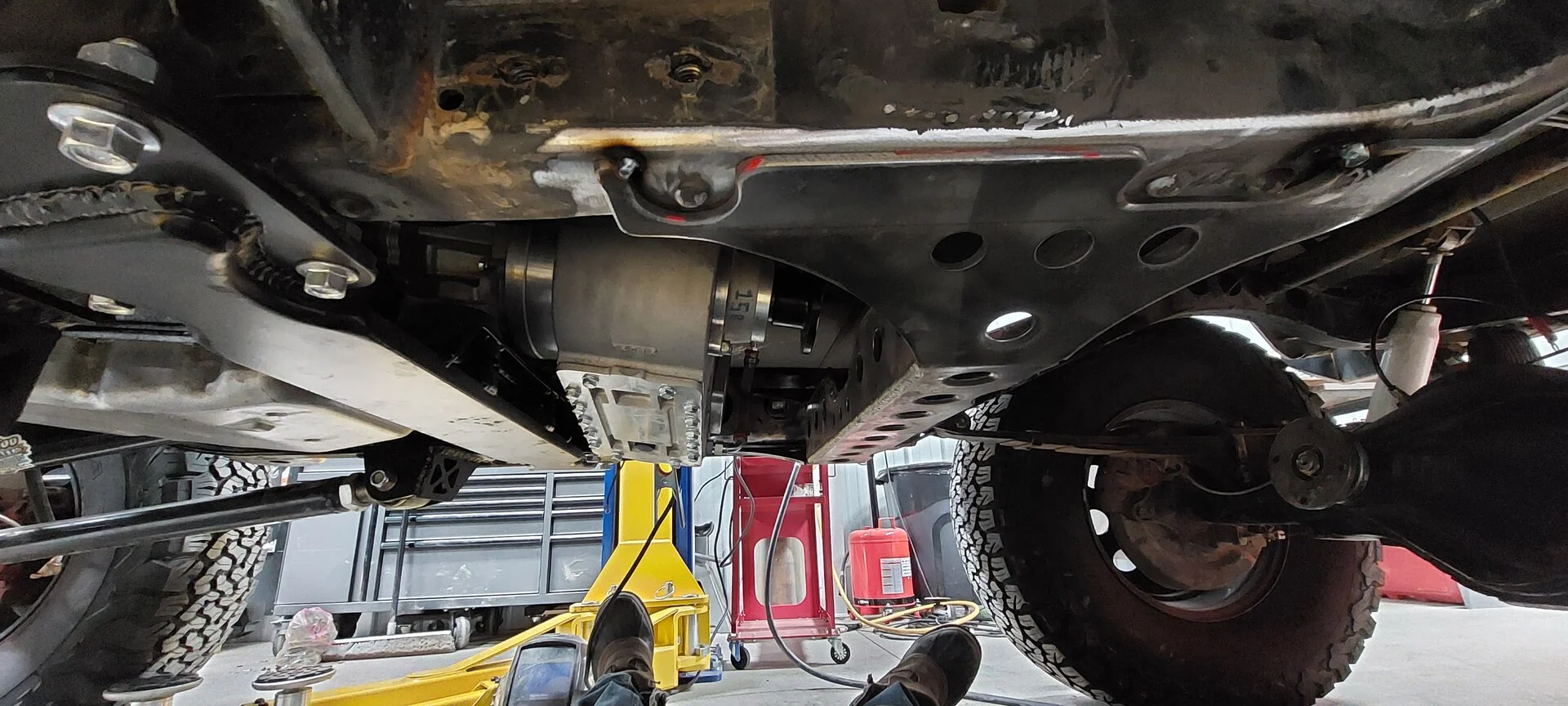

Plenty of room to drop out the tcase if necessary, hopefully i won't have to for a while, though.

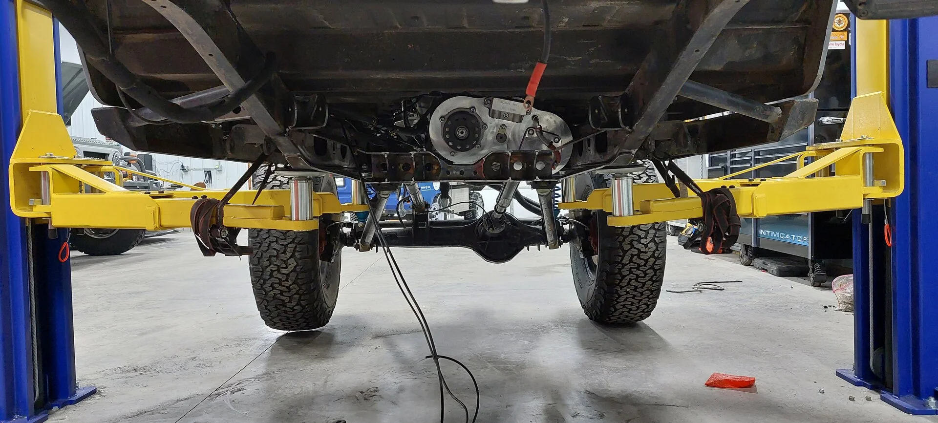

Lots of room for links, I'm excited to get started.

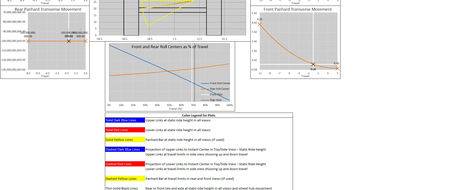

Alright, here is the final expected link geometry. Would love some feedback if you guys see anything you think is funky. Nothing is fully burned in yet, besides the frame side lower mounts. Those aren't going anywhere. :)

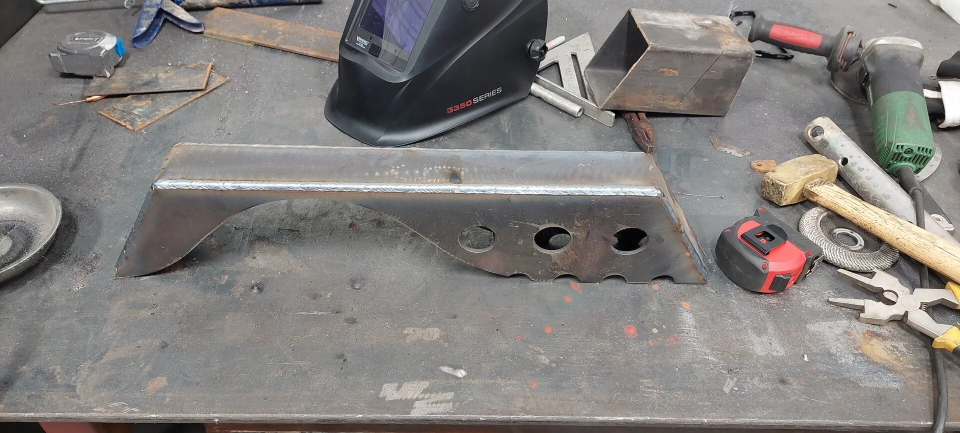

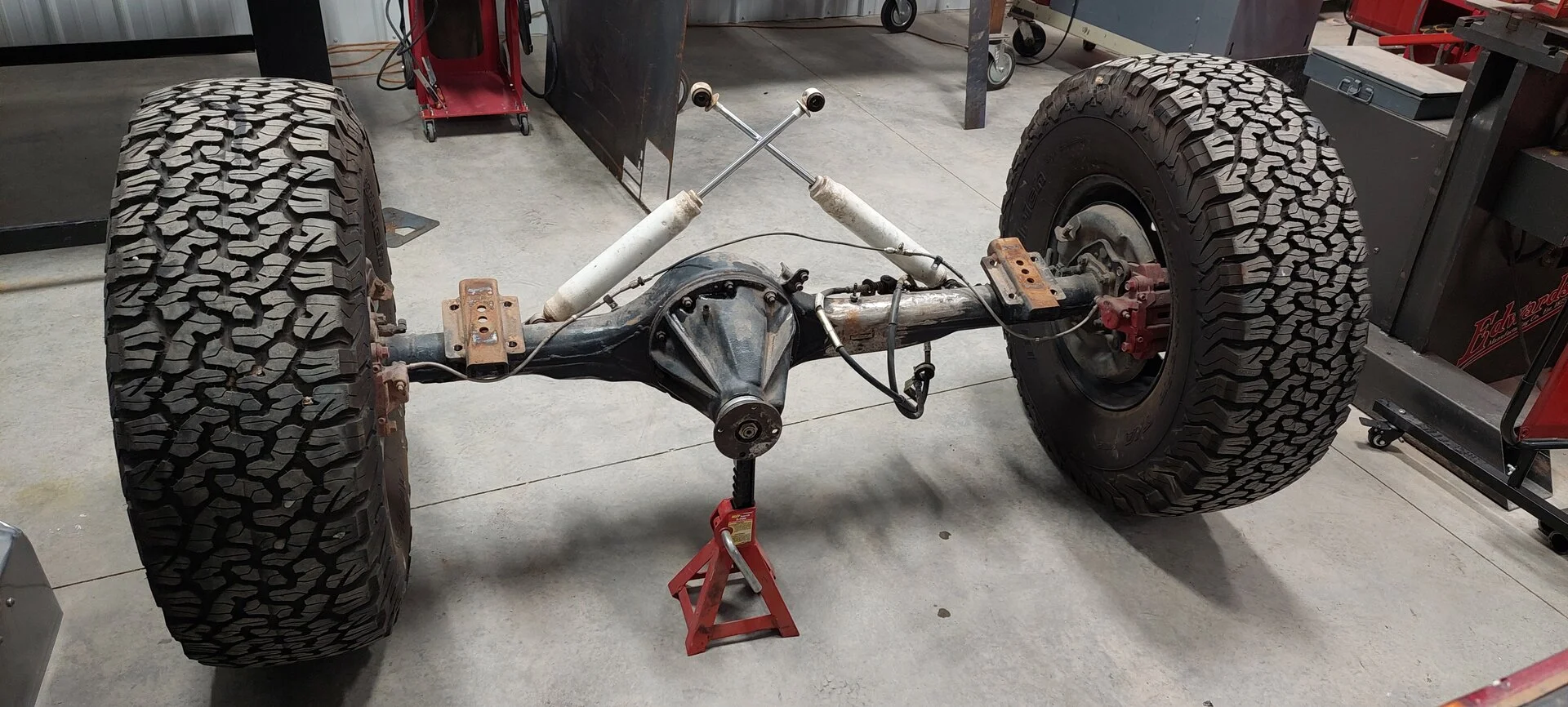

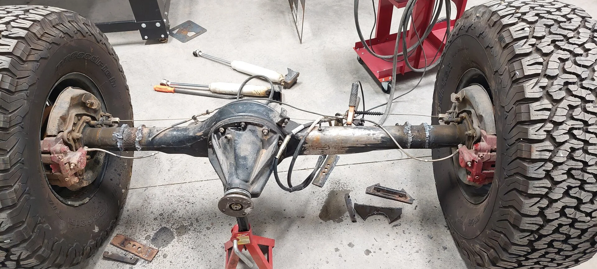

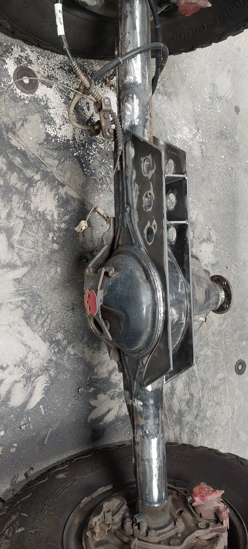

Well, I spent about 1/2 the day cleaning axle brackets and pushing in a new shop project.

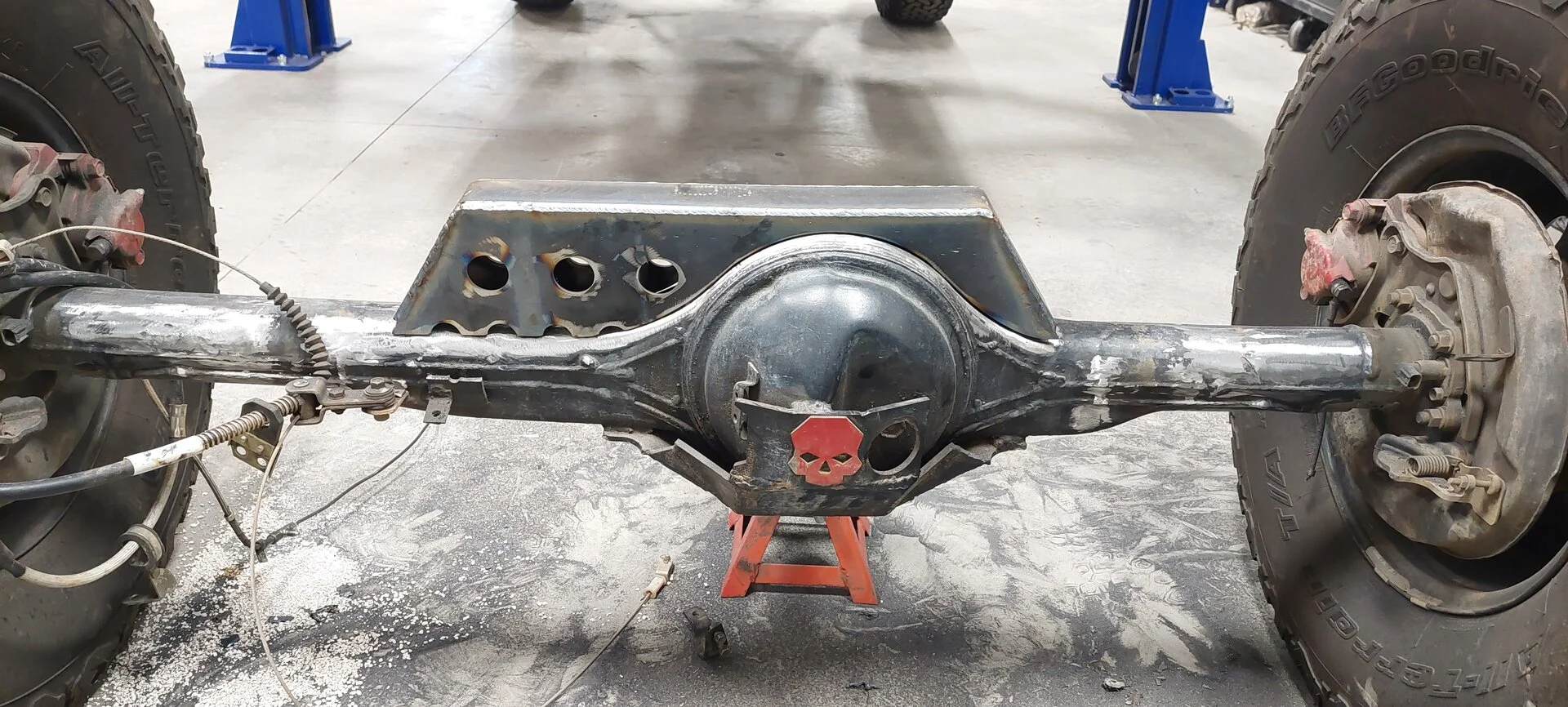

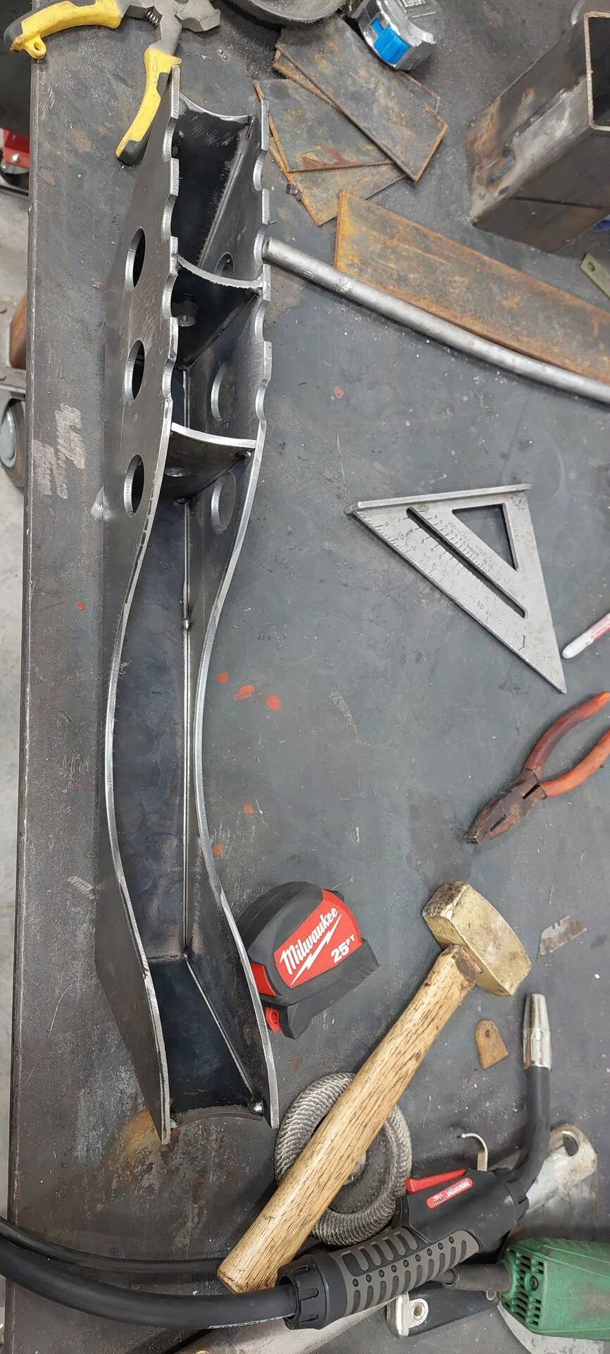

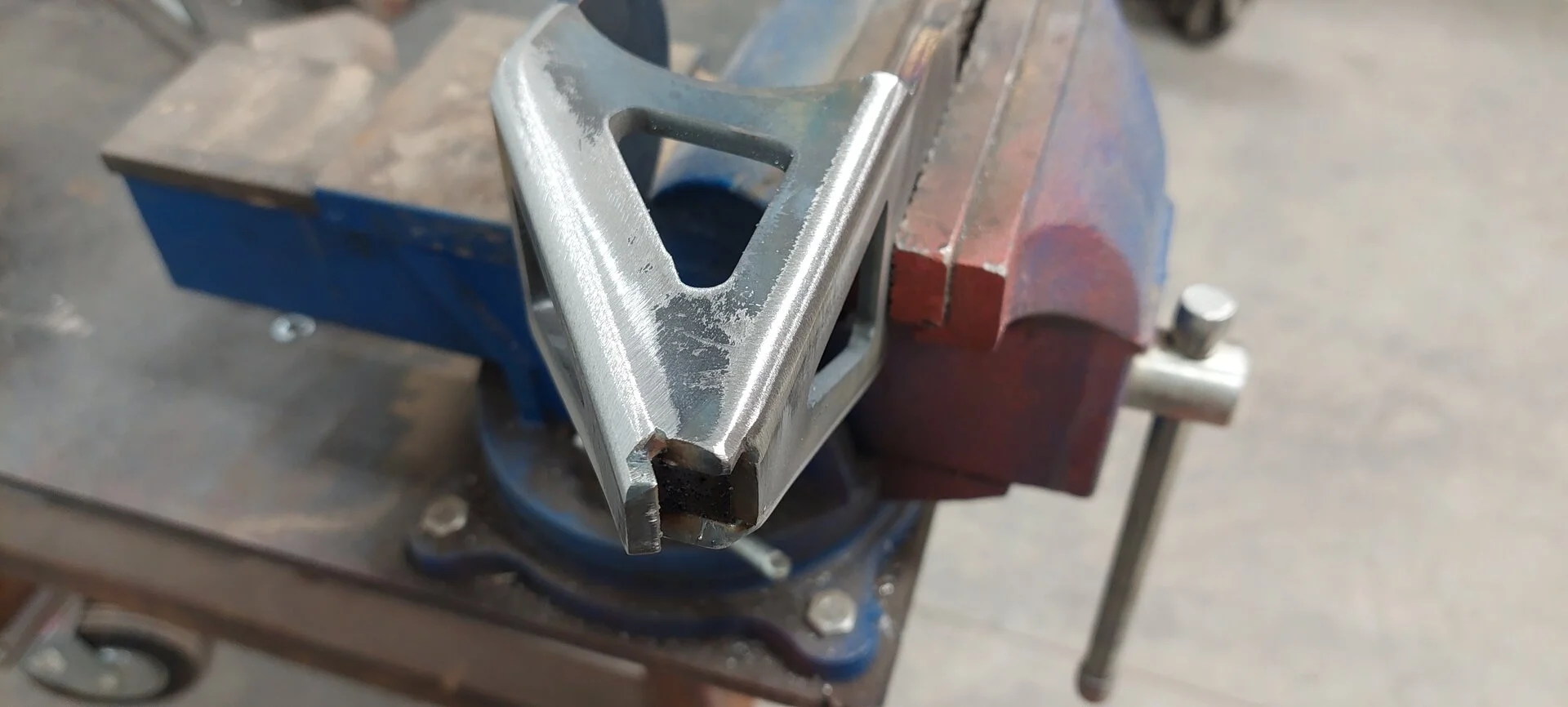

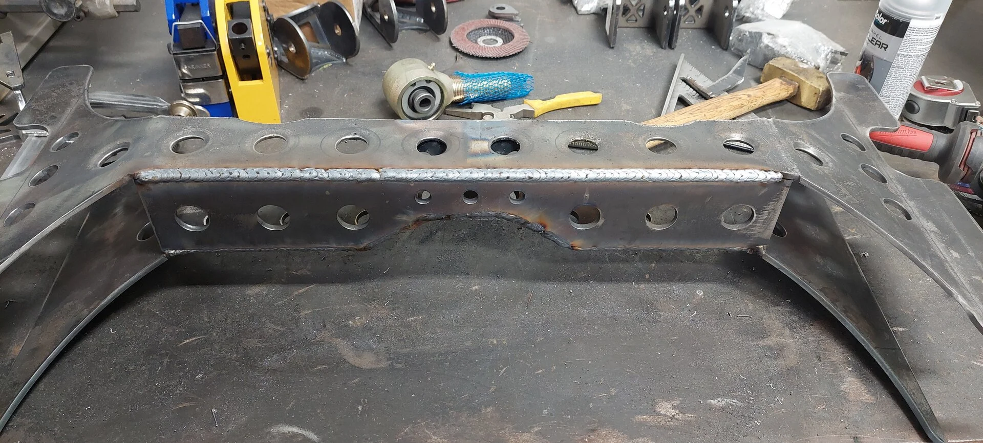

I then started on the truss. I highly debated whether or not to bother trussing the axle, but it made upper link brackets a lot easier.
So, I made a mini one lol. I don't need the stiffness, just a mounting point.
Inital test fit.
Top piece cut and bent.

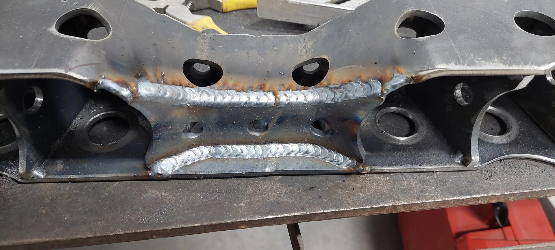

Welded up. I always run outer to outer fitment on joints that I don't want to grind. I can just fill it with a weld and don't need to grind it out at all.
Nice fitment with a little grinding.
Always stitch weld on axles, they can warp on you pretty quicky. I like about a 2" bead with a wet rag to keep the heat from running.
Anyways, welded up.
Next weekend, links will be in for sure.

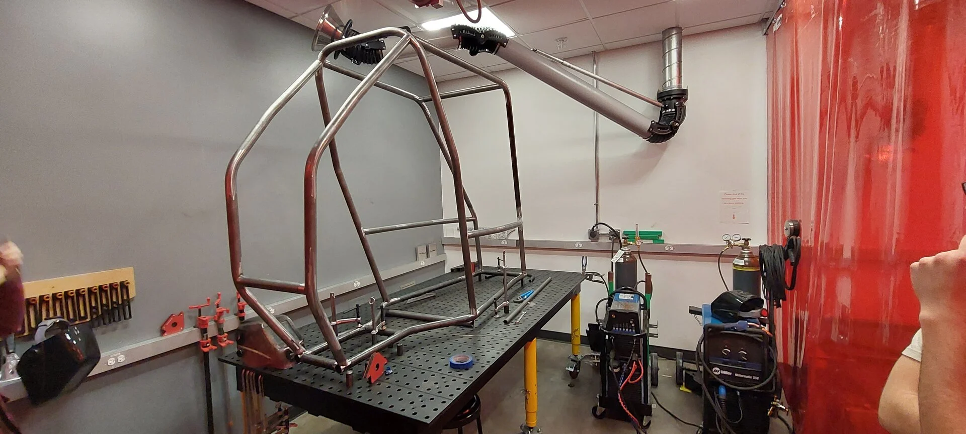

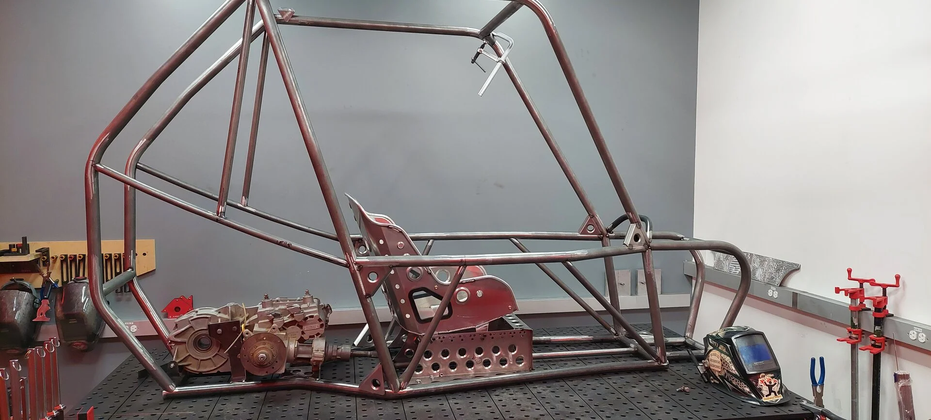

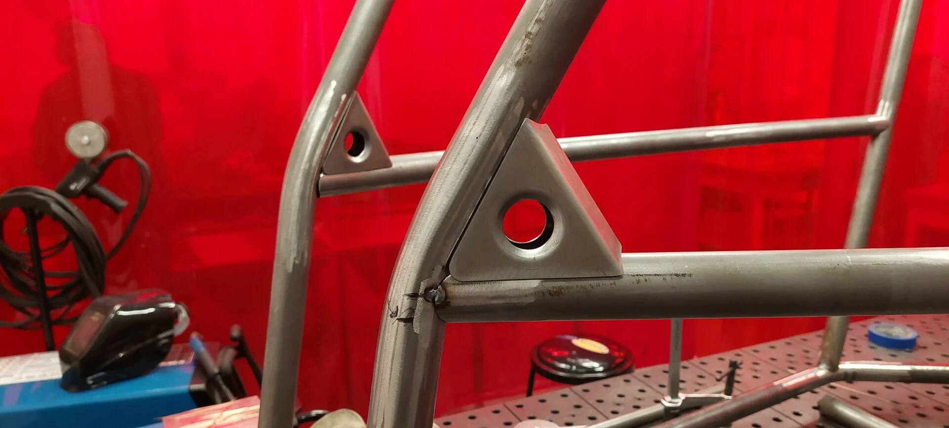

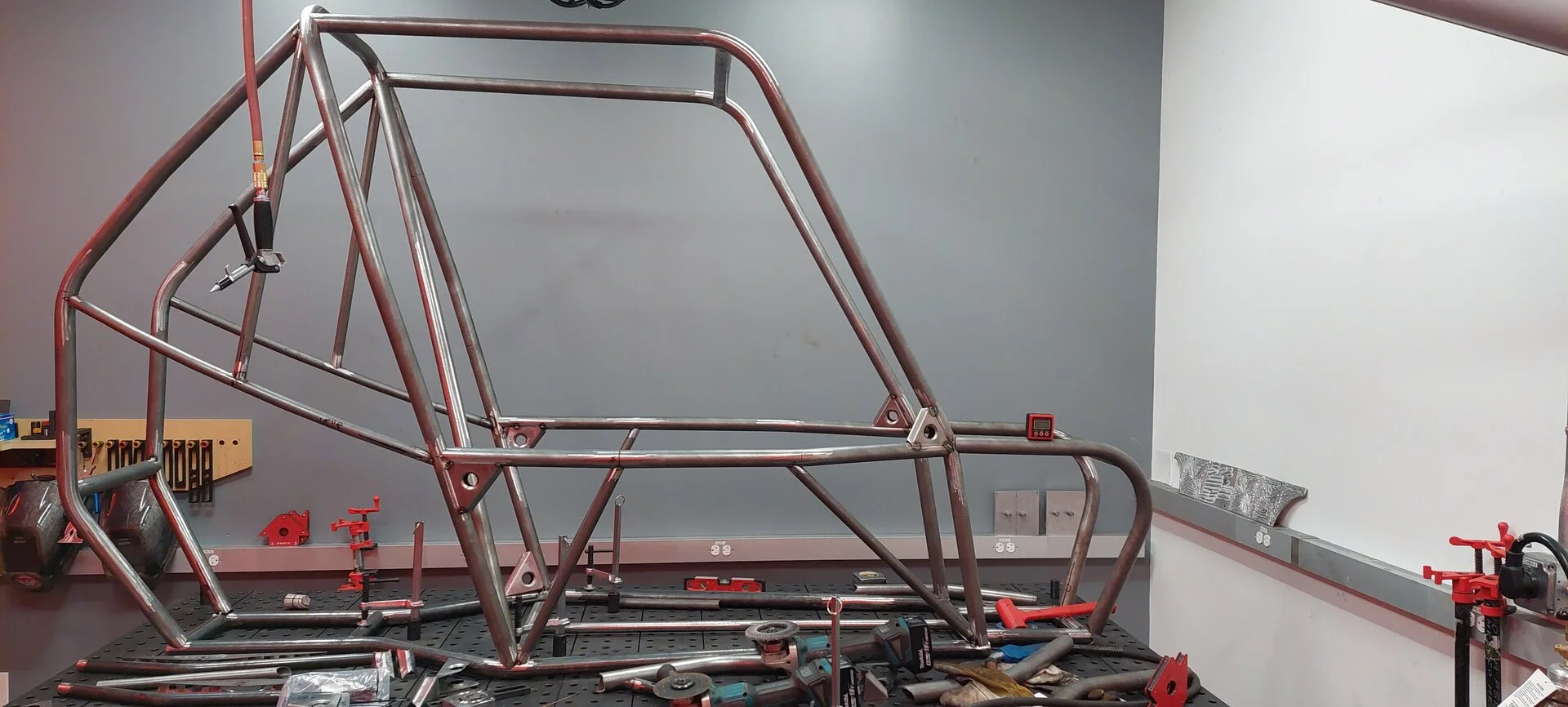

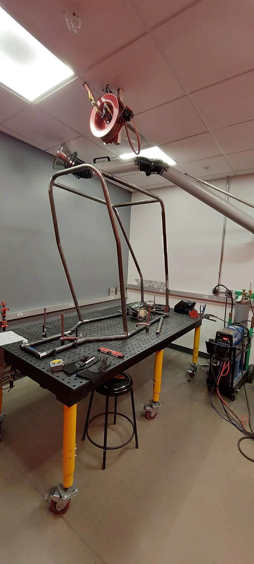

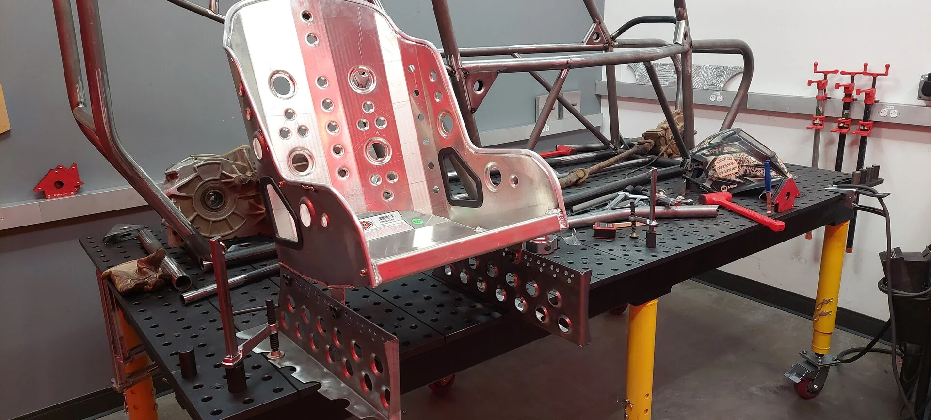

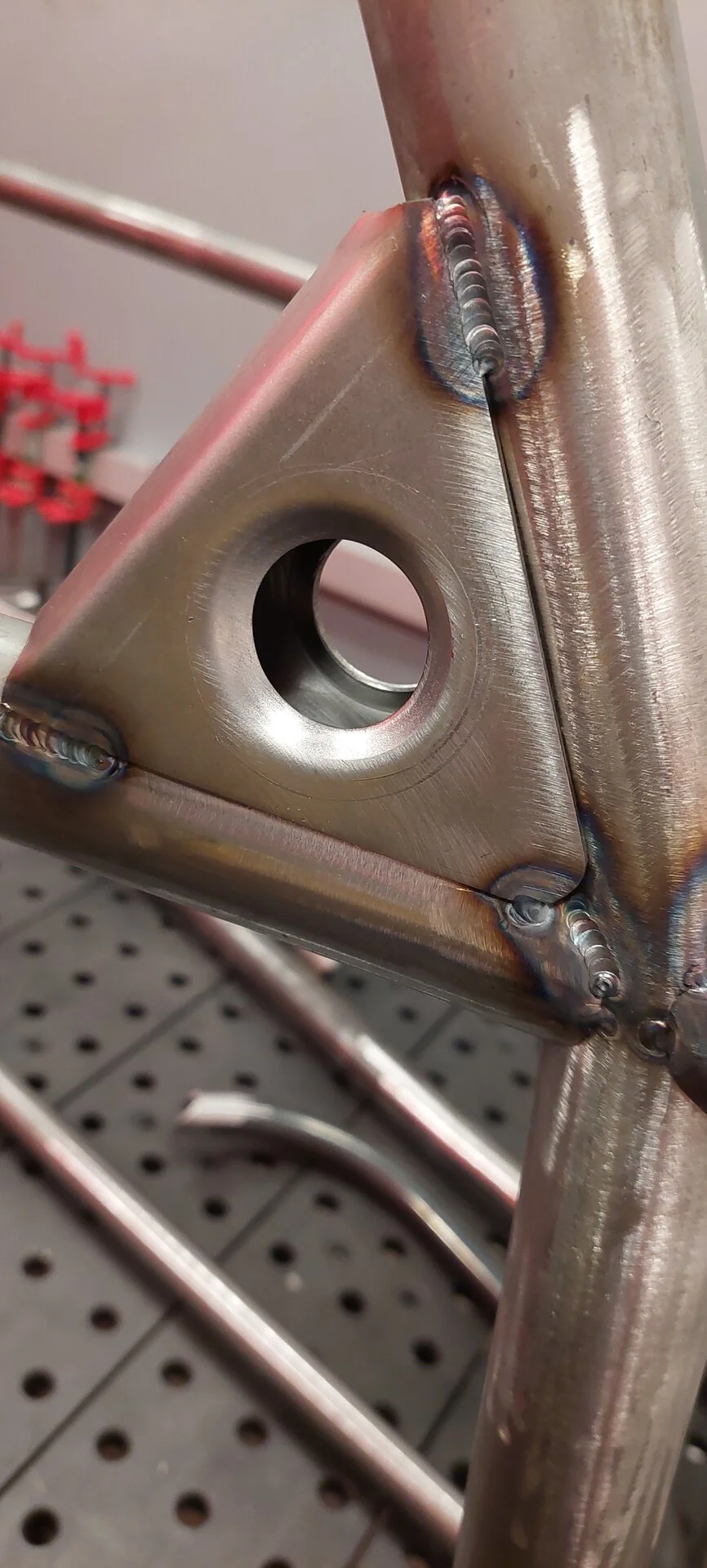

For those that don't know, I'm also president and fab lead of my university's Baja SAE team. I've been working on the SAE chassis a lot as well, and it's been a fun little project.
It's been a good tube project with a lot of tig practice.
