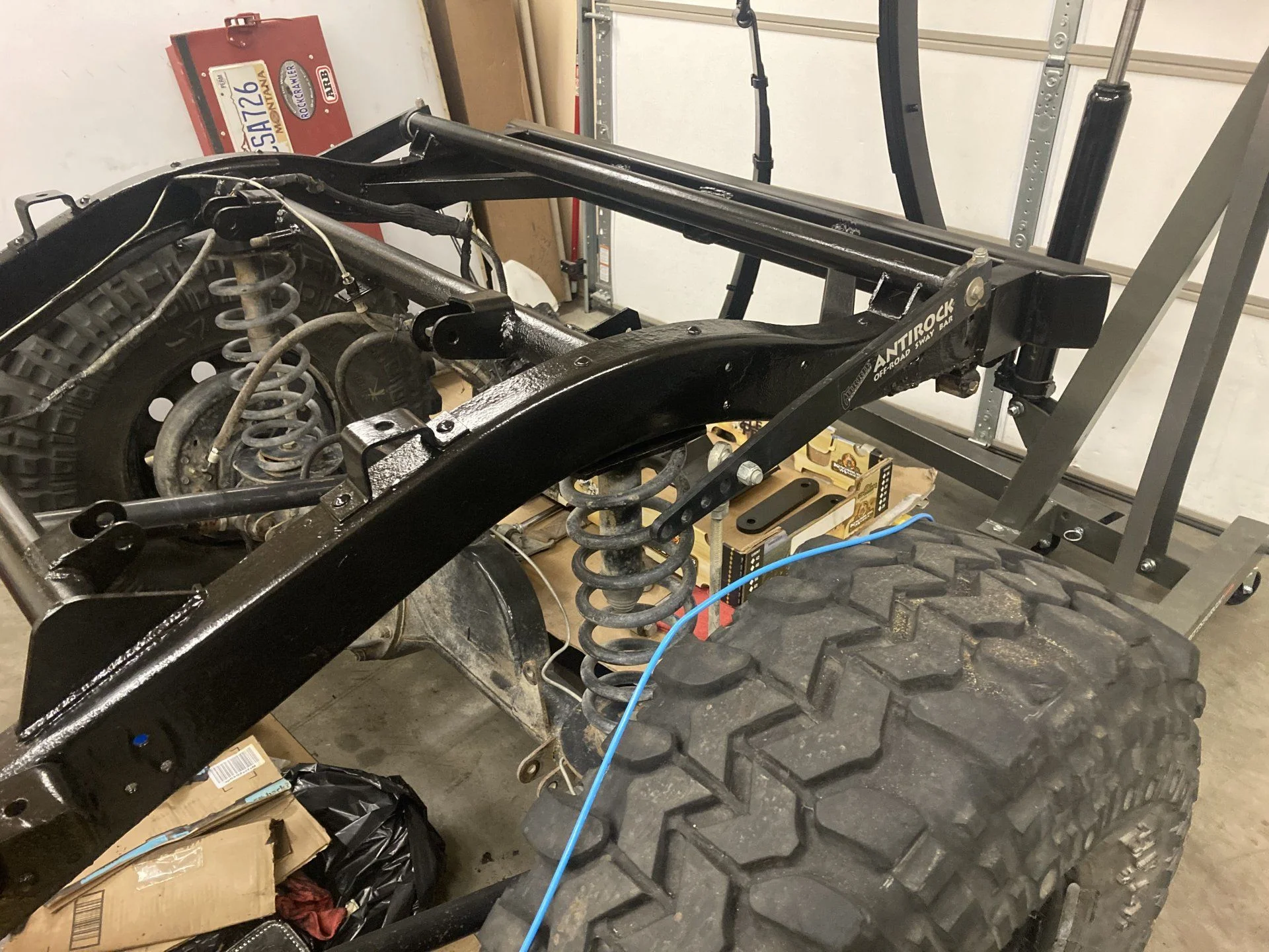

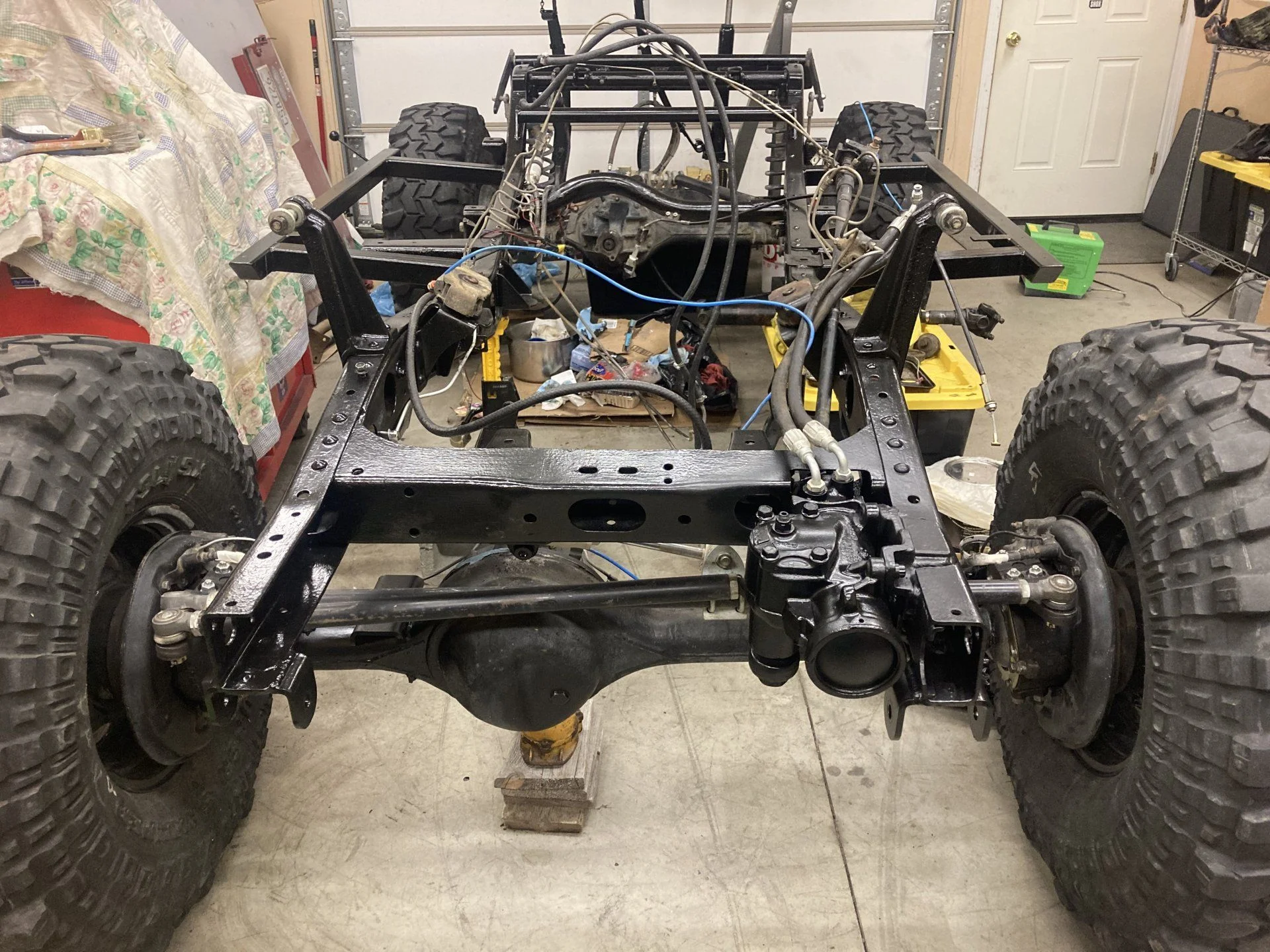

Ok. So I’m just about done with the frame.
I just decided kinda to 3 link the front end instead of the SOA. The rear is 4 linked with coils.
Looking for some guidance and encouragement as well as suggestions on kits available like the one offered from RuffStuff. I want to put the full tub back on and with replacement coilovers and wondering how that will work. Thanks in advance. BTW I will need a fj60 axle housing for the front 3link and coil over

I used a TMR customs kit. I liked it better than the ruff stuff kit because it uses Johnny Joints instead of Hiems.
Here are my numbers.
Cool. Which kit did you go with from TMR Customs?
The johnny joints are rebuildable and greaseable, so much better overall than the heims. Worth the slight extra for the longevity of them.
DJ- would you please post or pm me some photos of your 3 link set up. Thanks. Paul
Pages 13 and 14. Let me know if you want any other pictures.

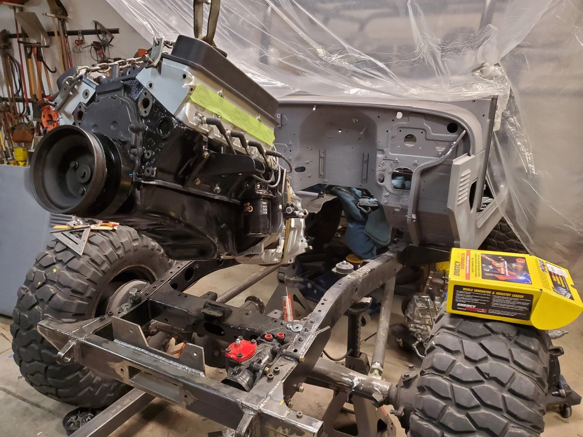

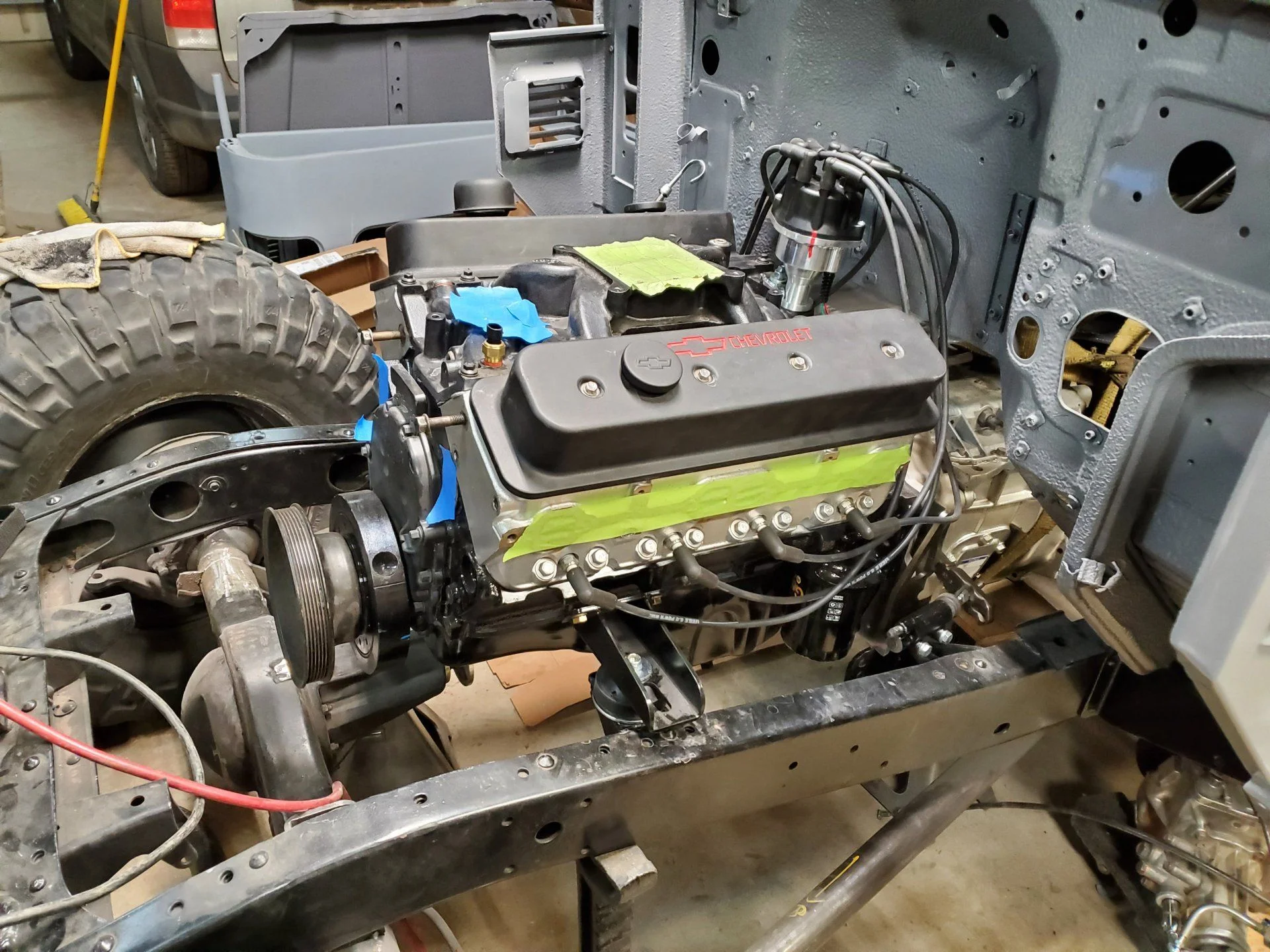

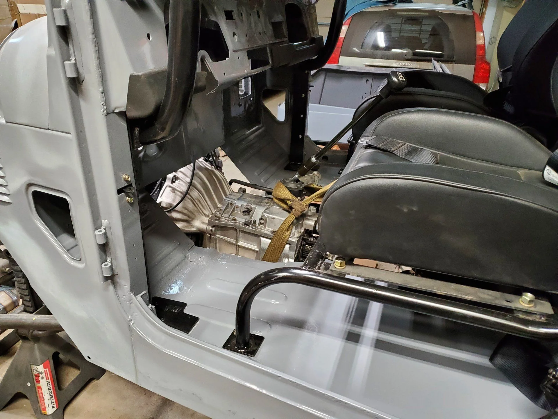

Here is a quick update for the past couple of days.
I got the engine and trans mated, along with with clutch and flywheel, so that is in for good.
That got dumped into the frame.
I went over to @cbmontgo 's house, and poked around his stock 76 to look at smog stuff. Thanks, Carson.
I then got the garage orgnized since it looked like a bomb went off in it. The rush to get everthing painted before it got too cold made everything a mess.
