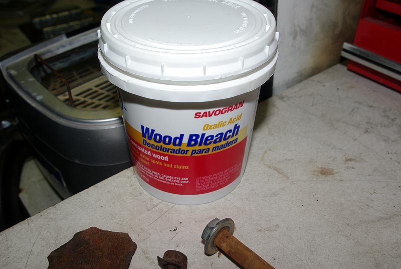

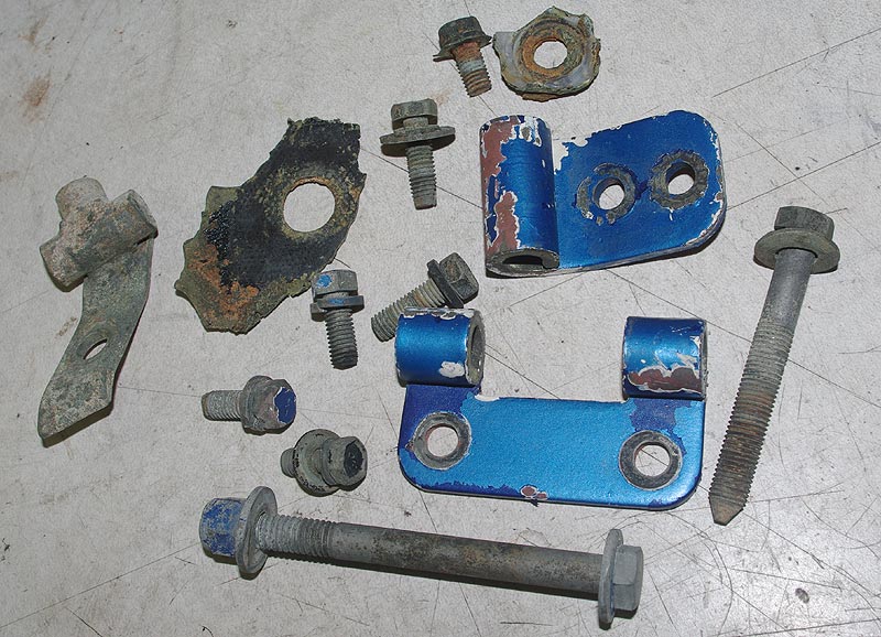

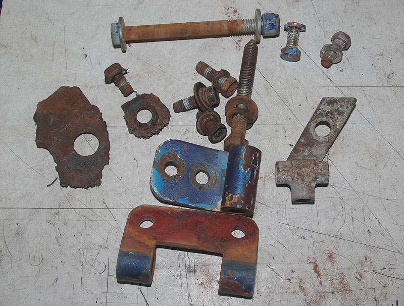

Tried a new experiment today: Got some Oxalic Acid (sold as Wood Bleach), cleaned out the harbor freight ultrasonic thingy, filled with water (~1.5L) and added ~ 1 table spoon of the crystals. Tossed some representative rusty parts in, soaked for the afternoon, clicked the ultrasonic cycle (8 min) whenever one of us walked by/thought about it.
Observations: It strips zinc plating, likely not good for any of the softer metals. Doesn't mess with well adhered paint. Did a great job on the rust, a couple of the parts could have gone a bit longer. Just rinsed them with water, so, great result for little effort.
The ultrasonic thingy has proven to be very handy for cleaning small parts, especially hardware, a pain to clean most other ways. May have to get at least one more, to have them setup with different chems. This one has more than earned it's keep, tons of hours on it, keeps on ticking.:hillbilly:

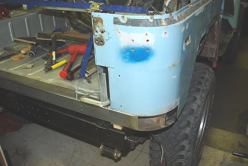

How we left it tonight, ready to be welded in, then time for skin.
It looks to me like the existing sheet metal is slightly inside the line of the new brace?? Mine was like that and it was really hard to correct when welding up the sheet metal. Something to consider. I ended up with a dip in the sheet metal and I had to use some bondo at that location.
Are you going to attach the sheet metal as it goes around the corner?
