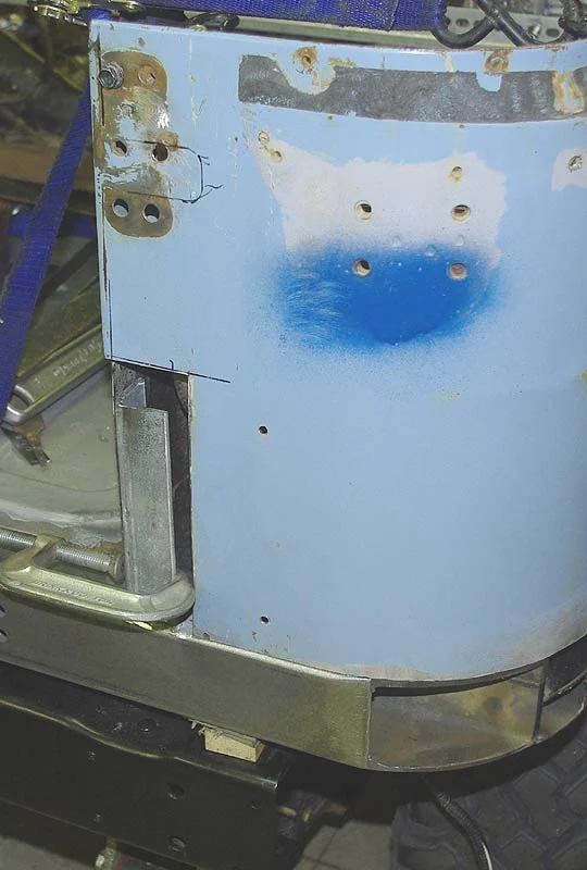

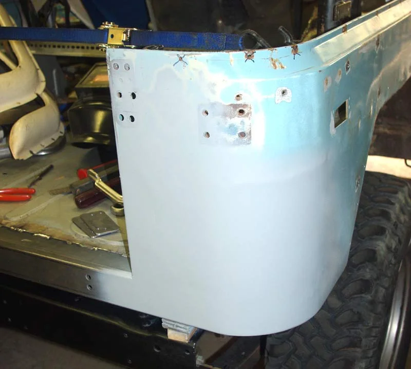

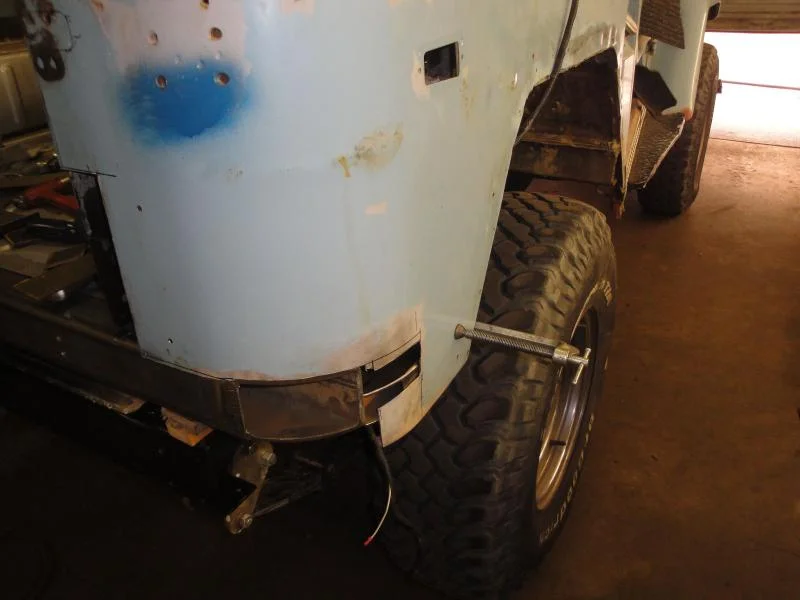

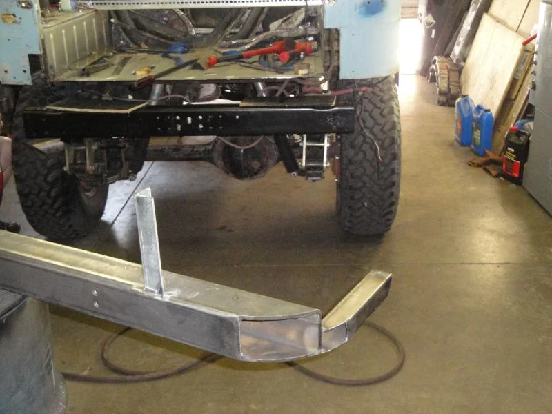

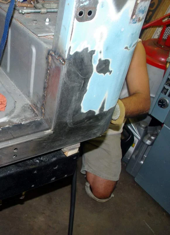

the DSRTRDR is getting some TLC . . .
tons of test fitting over the past few days, then welding
and how it sat tonight before my camera battery gave out

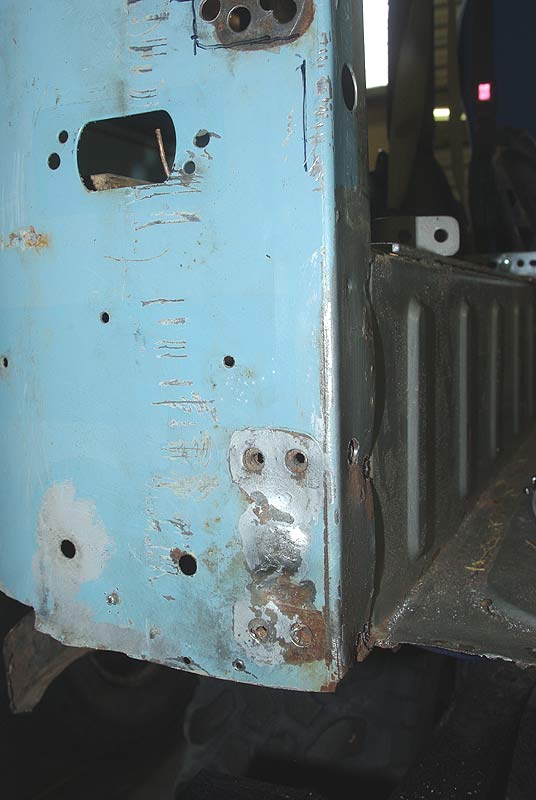

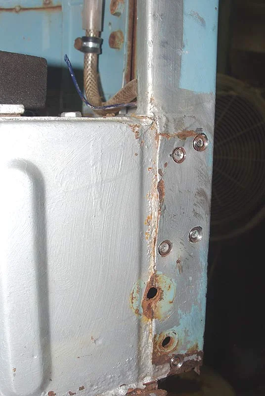

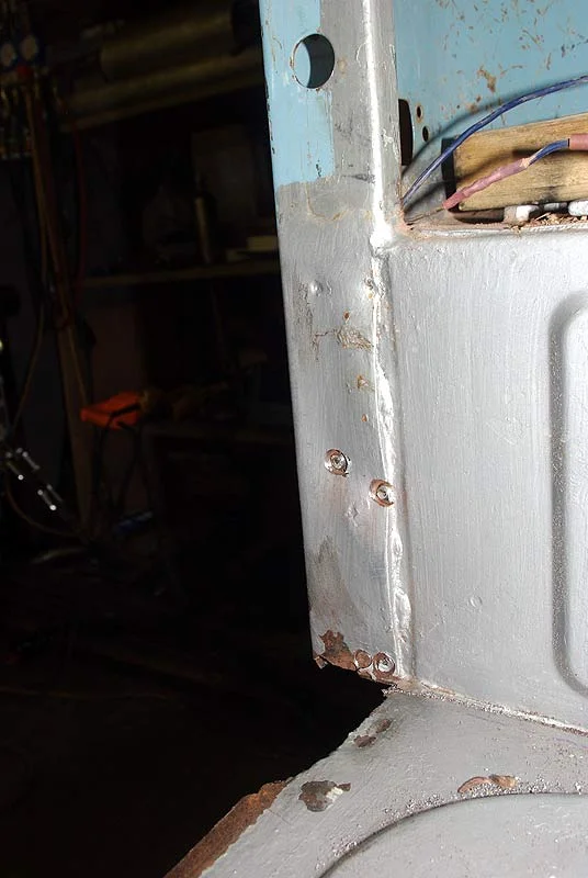

On this type of projects, one of the debates is; how far to go? The gate corners were one of those, something needed to be done, doesn't look solid? The lower dutch door mounts had lots of rust pucker, on the passenger side, a constellation of PO drilled holes. Decided to cut the whole corners out.
Found lots of rust hiding in there, some ~1/4" thick. The opening allowed welding angle supports solidly to the sill.
