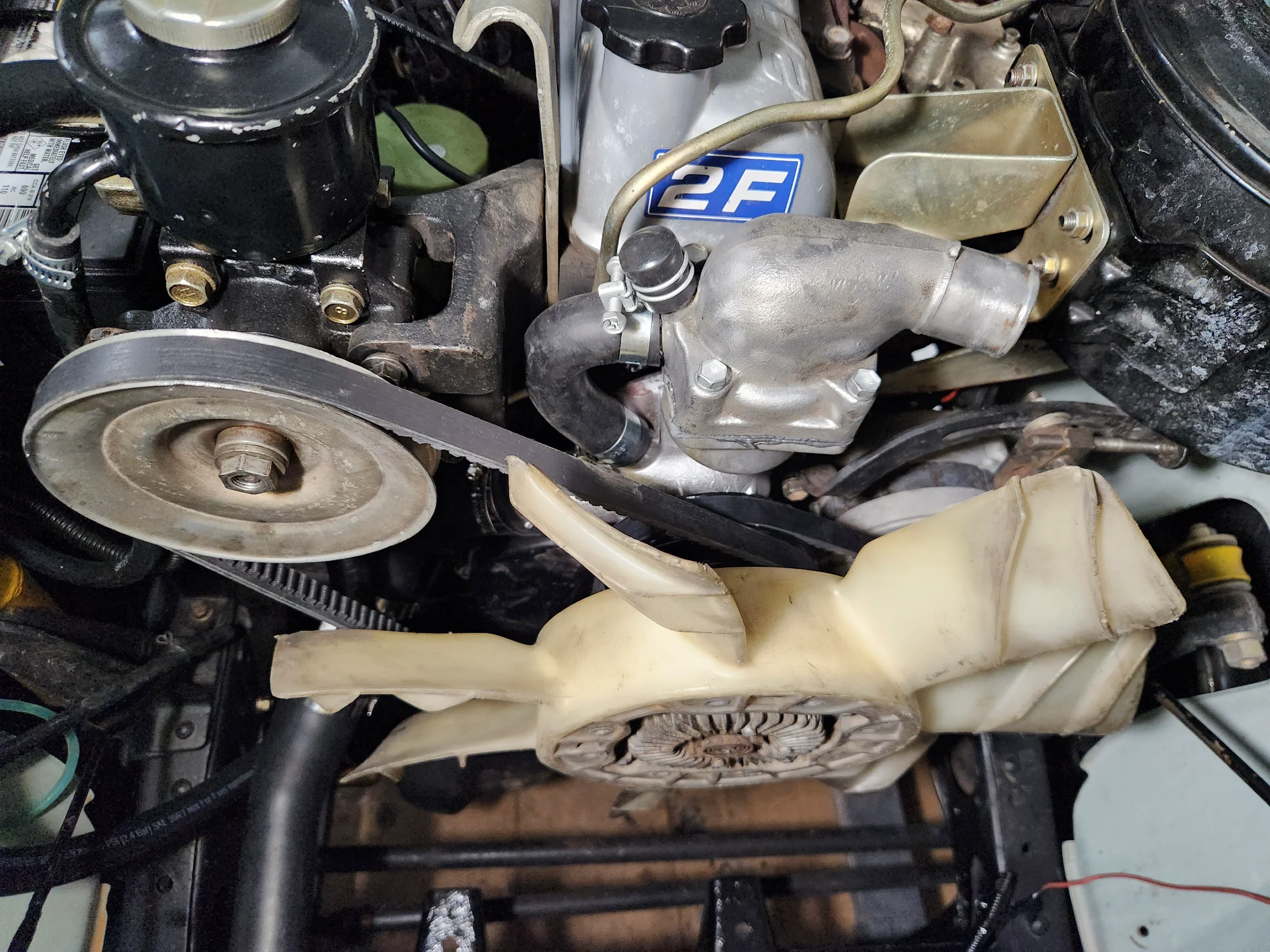

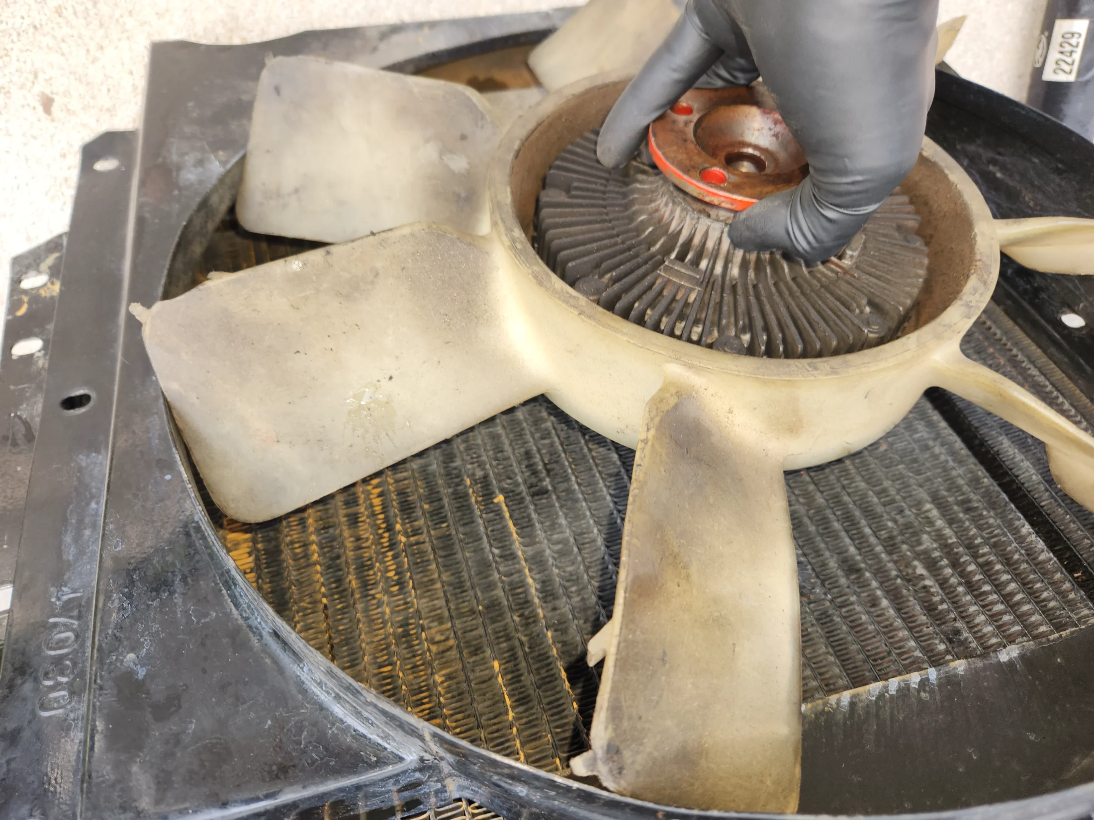

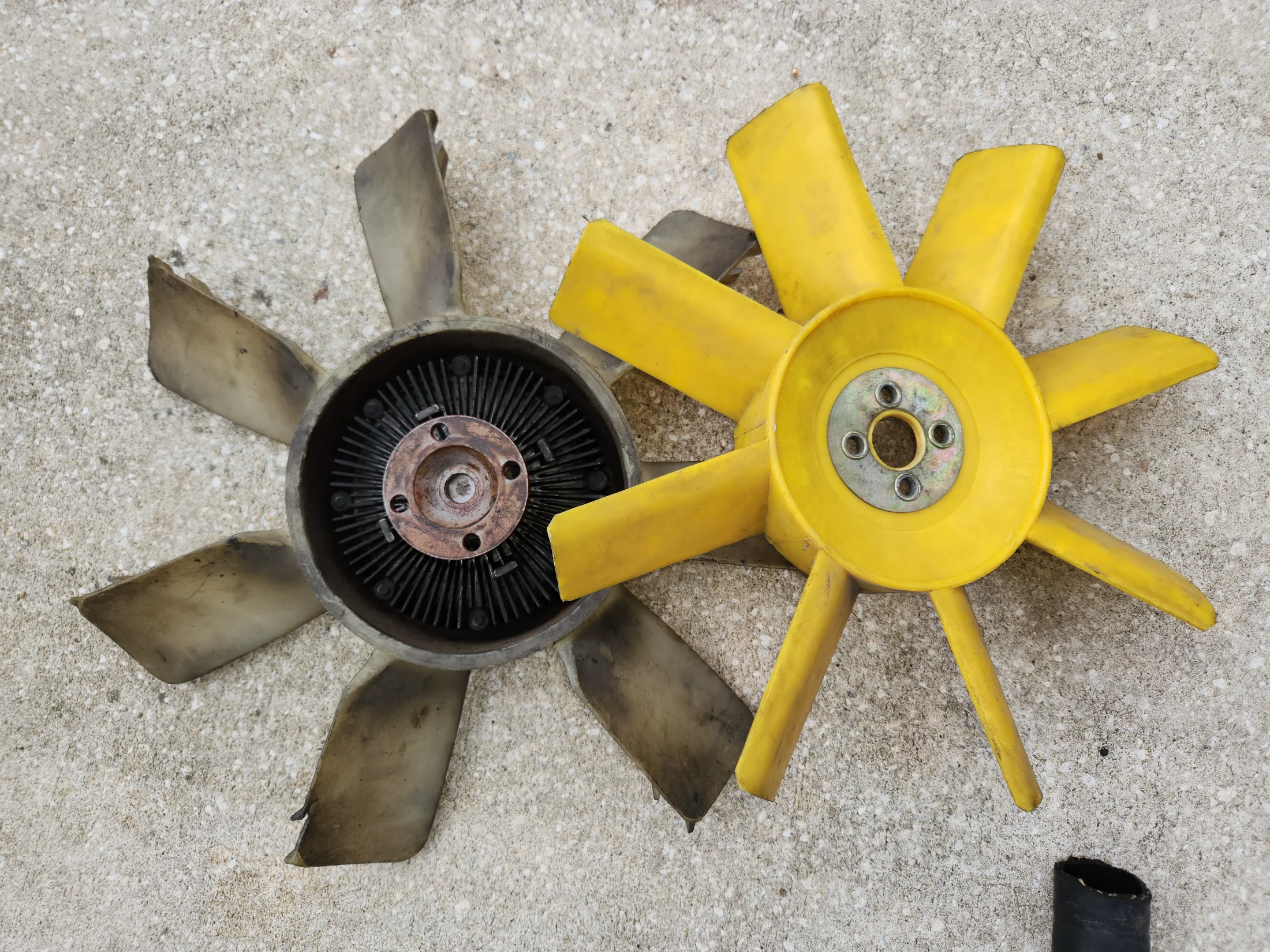

I have a viscous fan and a brand new Toyota water pump in my stash. The plan was to swap out my old, leaky radiator and put the new water pump (replacing the 'GNC' water pump) in with the new hoses, viscus fan, etc.
But not with a third world 'resto'. Nope. So the fixed fan is smaller than the viscus fan, so my shroud doesn't fit. The bolt pattern on the water pump is smaller, so the existing pulley will not work with the new pump. I figure all of this is simply third world toyota vs NAS toyota, so I'll have to get Matt to sort this because he's got the stash of parts necessary to change over to my viscus fan, and it'll take him a few hours, versus me spending days searching for the correct parts..... and many likely not working.
The best part? The existing radiator is different from a factory radiator...... and to make it fit, they cut up the oxbow; which now doesn't allow the toyota radiator to fit. 🤨
So my plan is to reinstall the old, nasty radiator with the new hoses so it'll run. Then as soon as Matt can get her in we'll add the front of the engine to the list. Hopefully he's got an oxbow and fan shroud in his collection and can simply swap out the pulleys from his collection with my new water pump, etc. Otherwise I may have to go electric out of necessity.

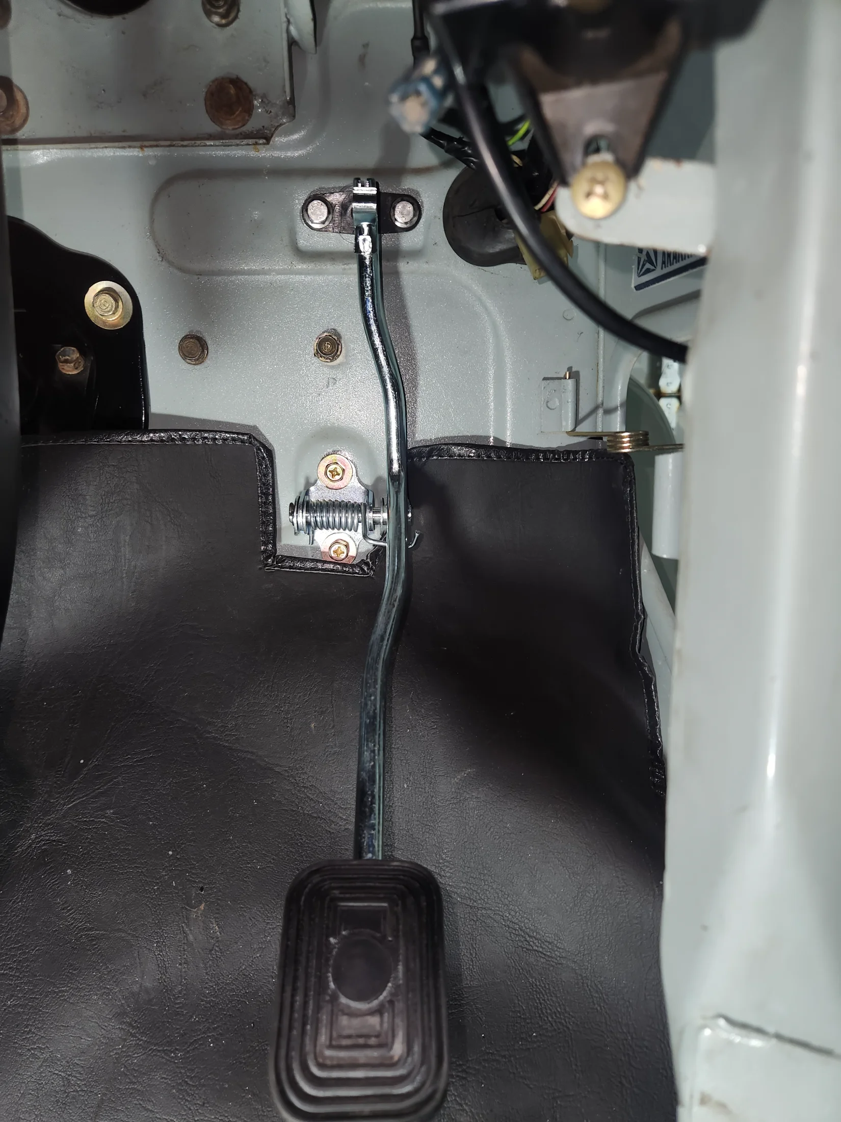

As the band plays Nearer My God to Thee in my garage, I installed my new accelerator pedal and Toyota accelerator cable from City Racer. I also welded the pivot for the accelerator cable-to-pushrod at the base of the carb, which removed LOADS of slop in the throttle.

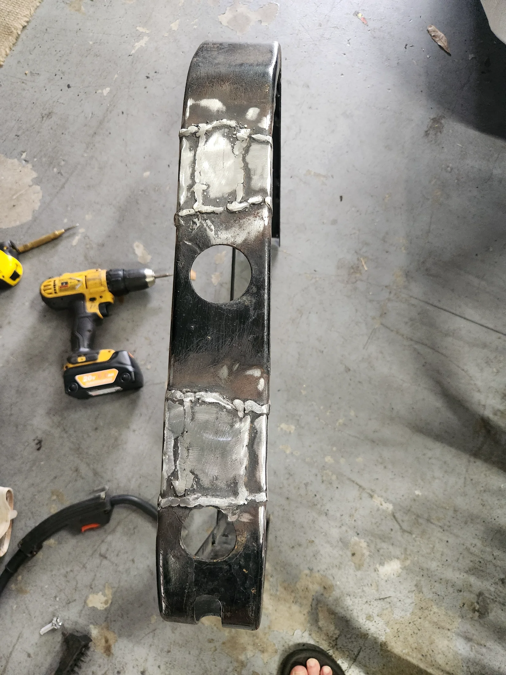

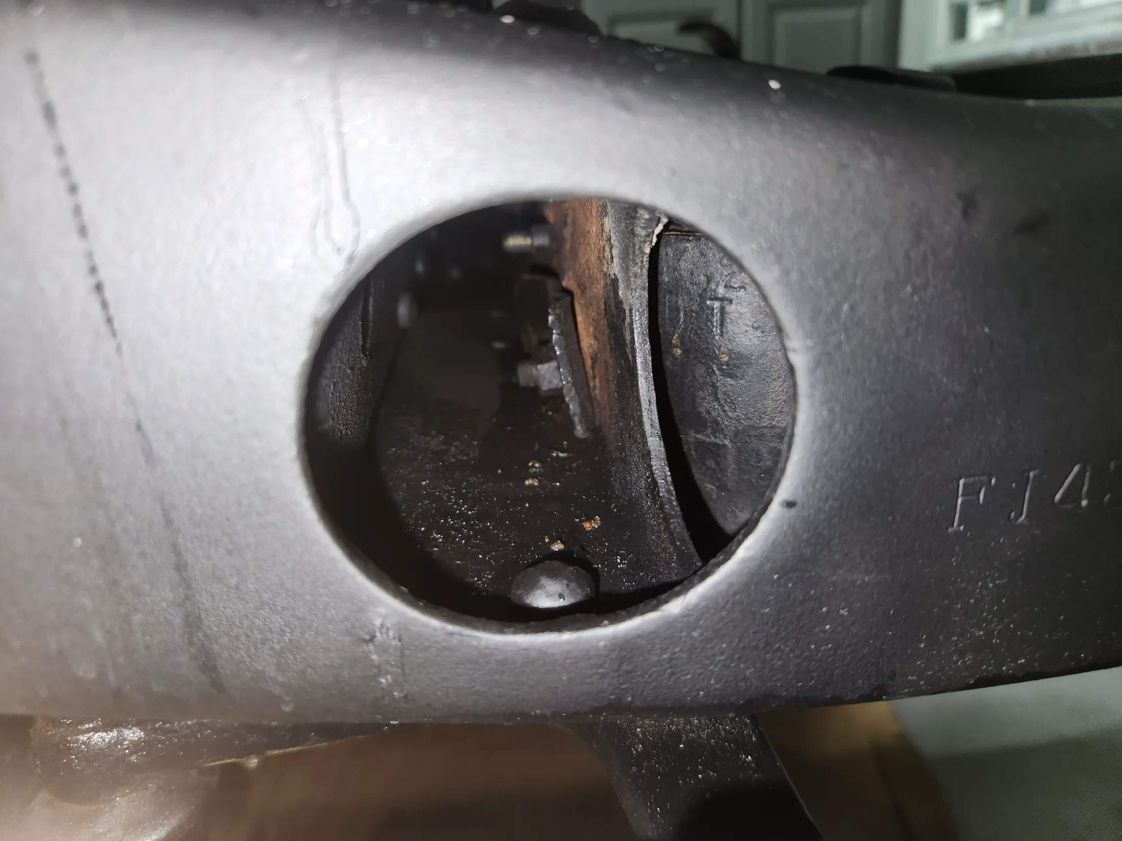

I'm pulling out this Rube Goldberg radiator oxbow (the U-shaped holder for the radiator: I've learnt that what's called an 'oxbow' in Australia is called a 'U-shaped radiator holder' here, but for brevity I will continue to refer to it as an oxbow). While down here, I've discovered another job for @cruisermatt : while he's rebuilding the bell crank, he'll need to reenforce the frame cross member where the original nut pulled free. They used a thick piece of rubber to keep the hand-tightened bolt from pulling free.
It truly is no wonder Pakistan can't pull itself out of poverty with work like this.

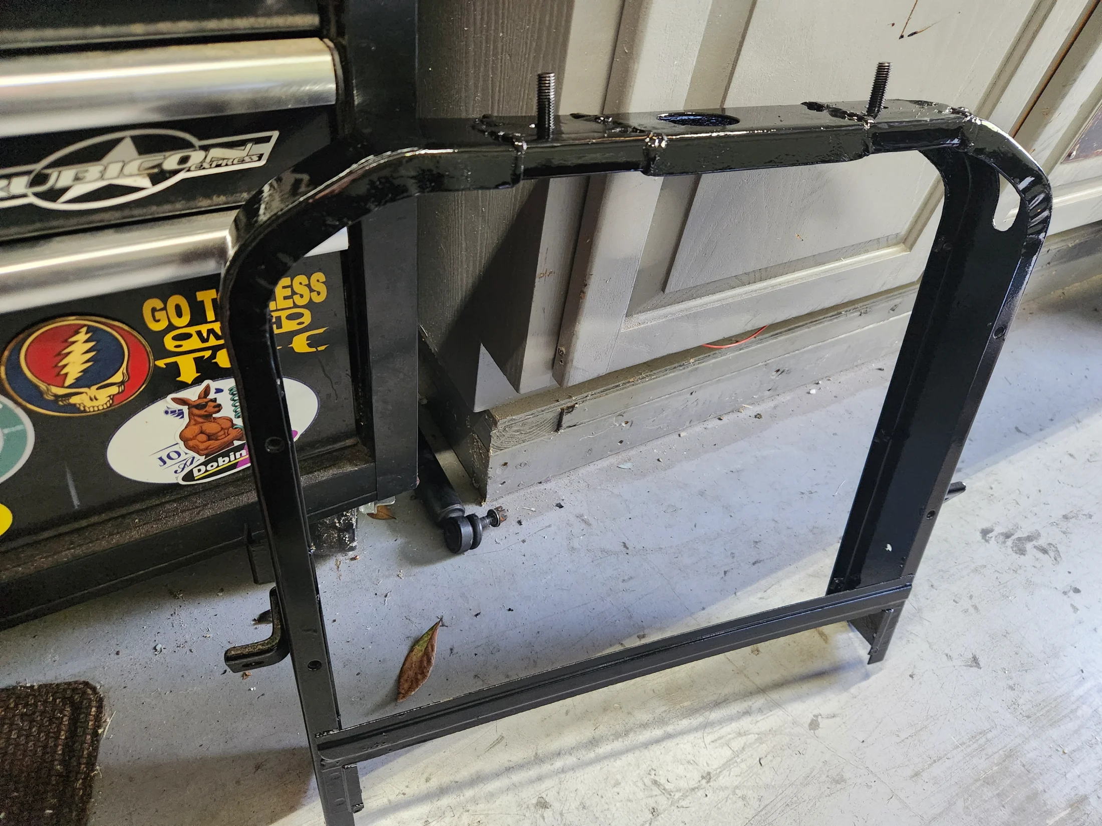

The modified oxbow. My concern: the shroud fit without issue..... is the engine lowered somehow? Not beyond the realm of possibilities....
After looking unsuccessfully for an oxbow and shroud for my 82, I decided to fix the one I had. Of course, after I finished it, @Sharpfj40 contacted me with one he had in Tn. Thank you. But for now I'll use this one and see how it works. I do still need the shroud though.

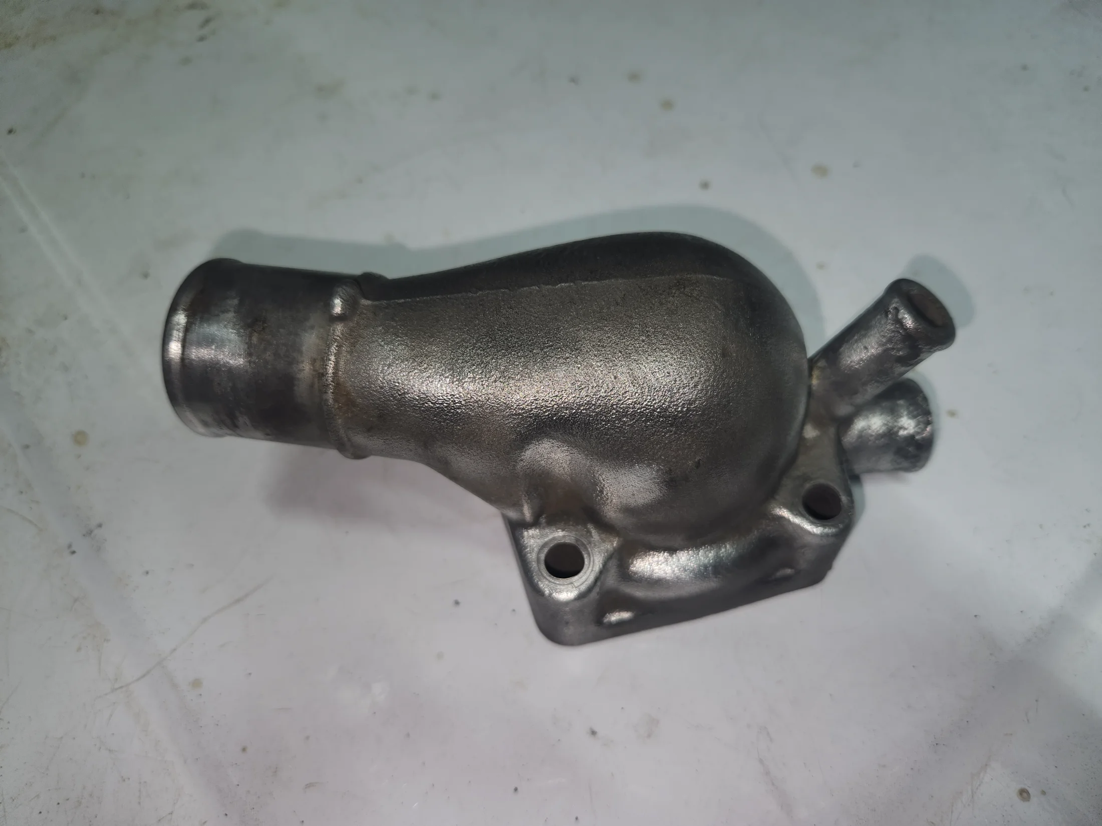

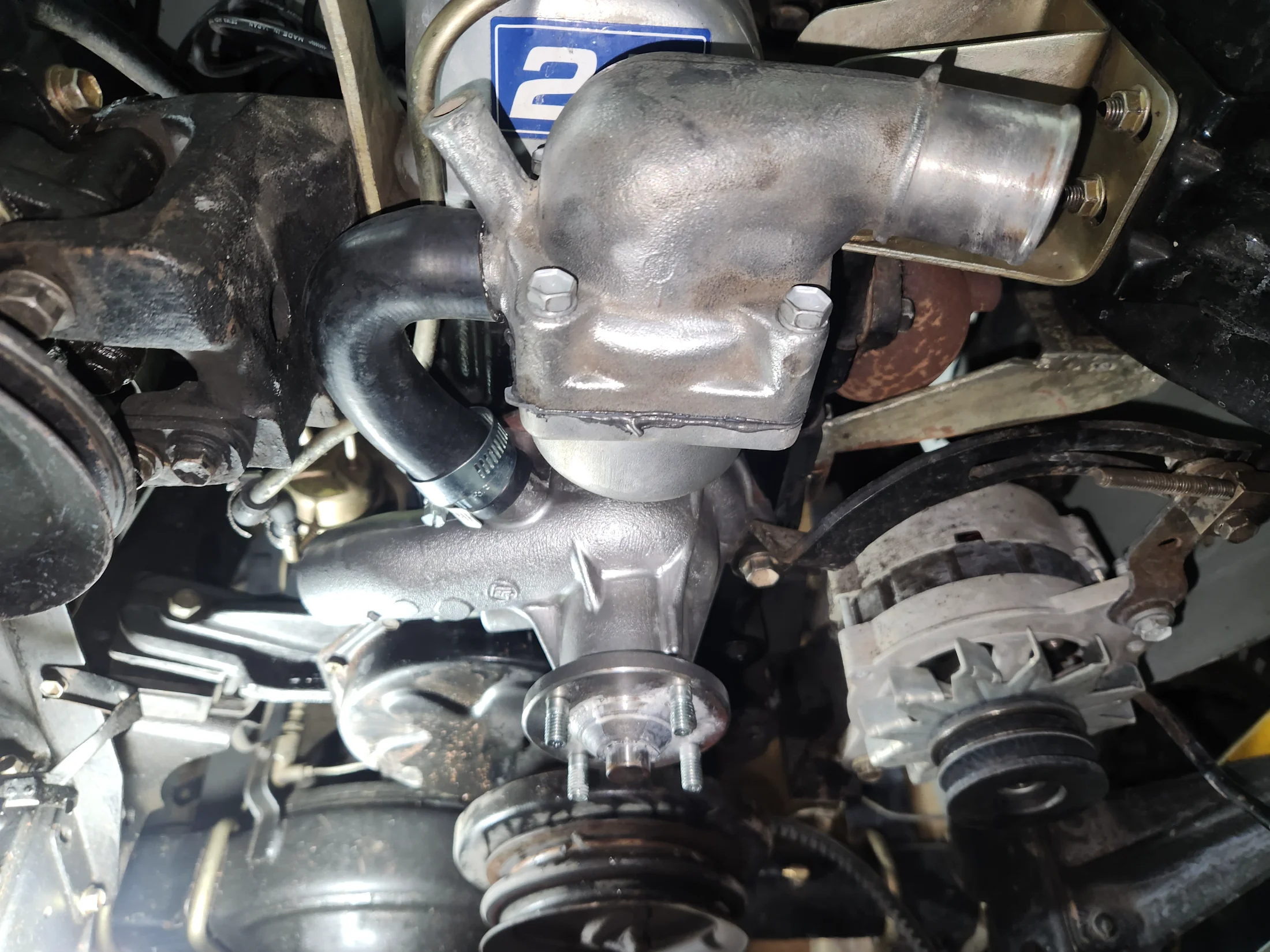

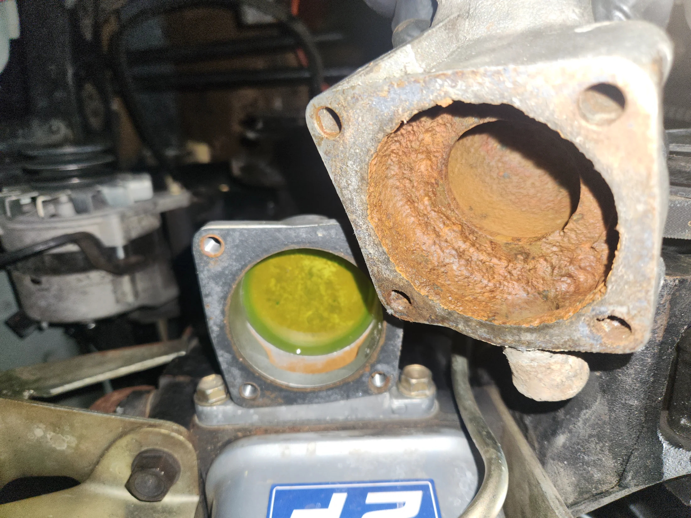

I also installed the new Toyota water pump, thermostat and the housing I had in my stash. Not surprisingly, there was no thermostat in the old, manky housing, and I think I've bebunked the original seller's claim that the engine was rebuilt......

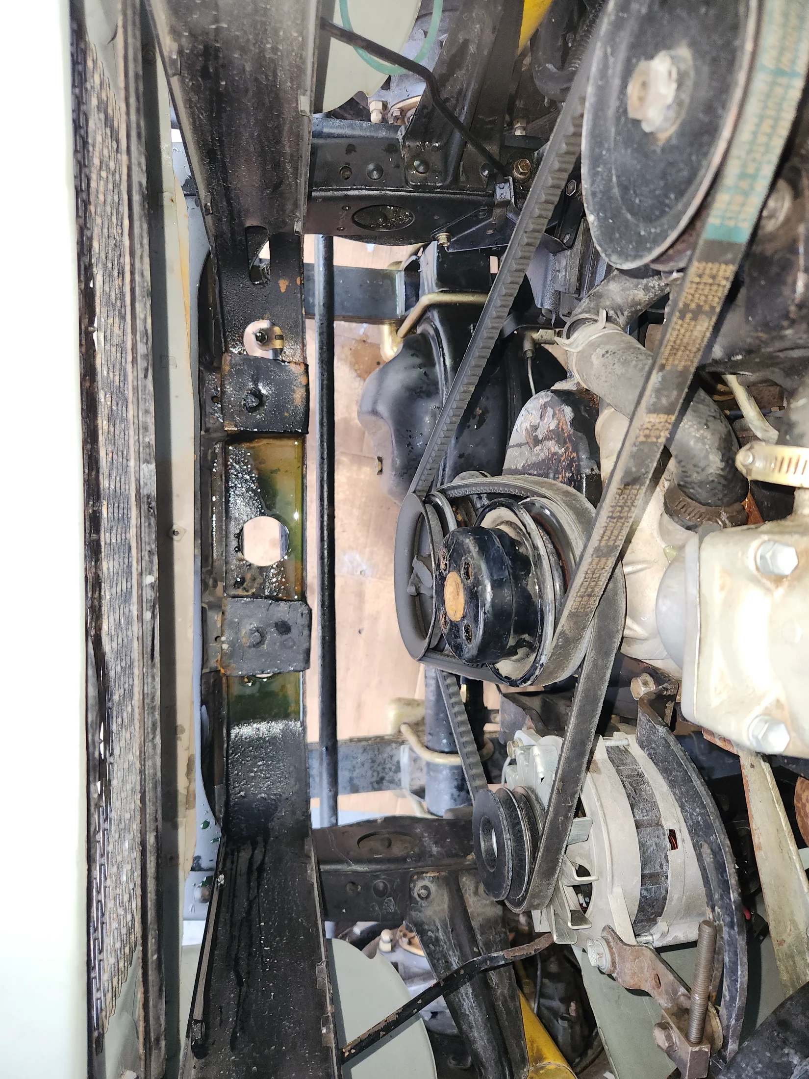

Progress happening slowly. Only had a couple hours to play with her today. Tomorrow I should have the radiator in. I painted the grille mesh as it was manky: looks much better.
Finding new fan belts was a bit tricky, but I finally found them. @cruisermatt may need to change them out with the Air con and toyota alternator, but the old ones were SO crusty that I had to get new ones. Fan belts are SILLY expensive now. Wowser. Hopefully these work with the air con.....
I also put my spare power steering pulley on as the one on there was from...... something. Fits much better now and lines up with the belt much better.
Once the radiator is all back together I'll install the power steering cooler I bought: Very nice. The factory one was removed, but I couldn't figure out why. Then I realised it wouldn't have fit with the modified oxbow, so they must have removed it for that reason; gotta love third world engineering.
