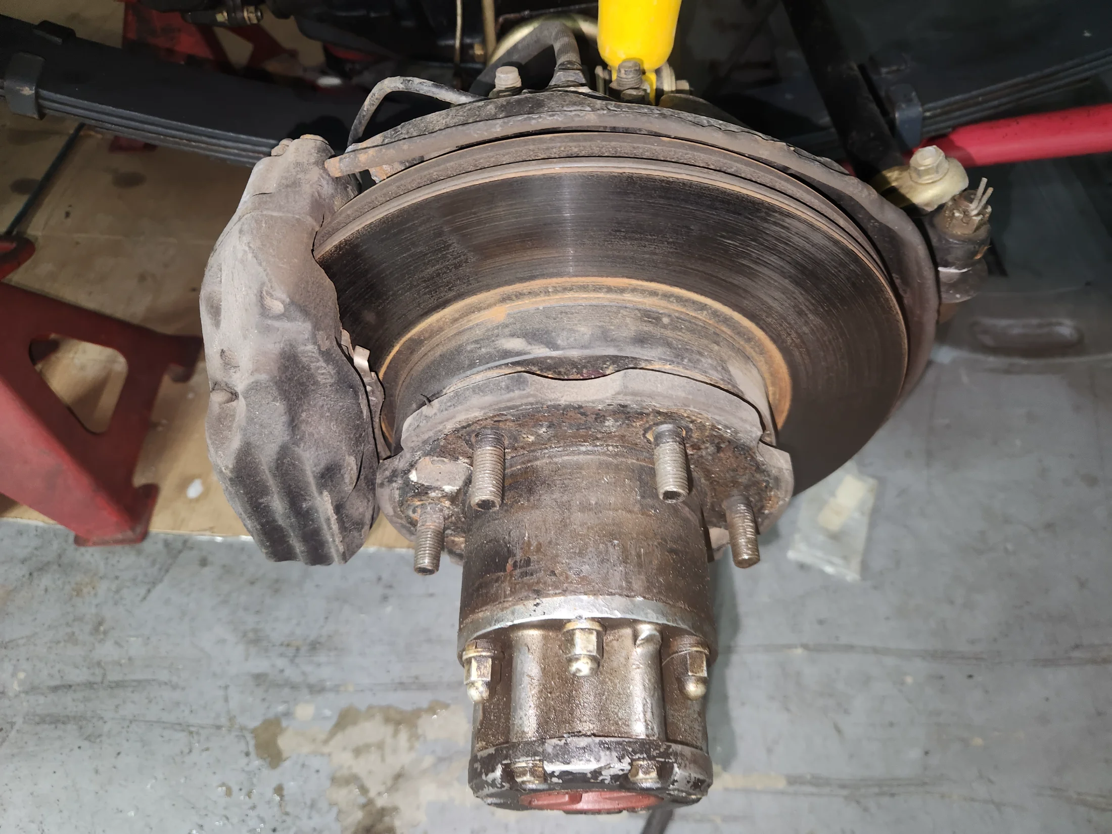

The 'rebuilt brakes' will need to be done too @cruisermatt.....no shocks there. I think I'll just have you do the wheel bearings, brakes, calipers, pipes and hoses all at once with the H55 and tie rod ends. I might as well have you do all of it at once since you'll have the truck and my wife will lose her mind if I do another 'project vehicle' myself. I would love to put 60 series axles under it like I did with my LX, but given how badly I overpaid for this rig I have to stop somewhere...... hopefully I'll have the hand brake sorted before it gets to you.

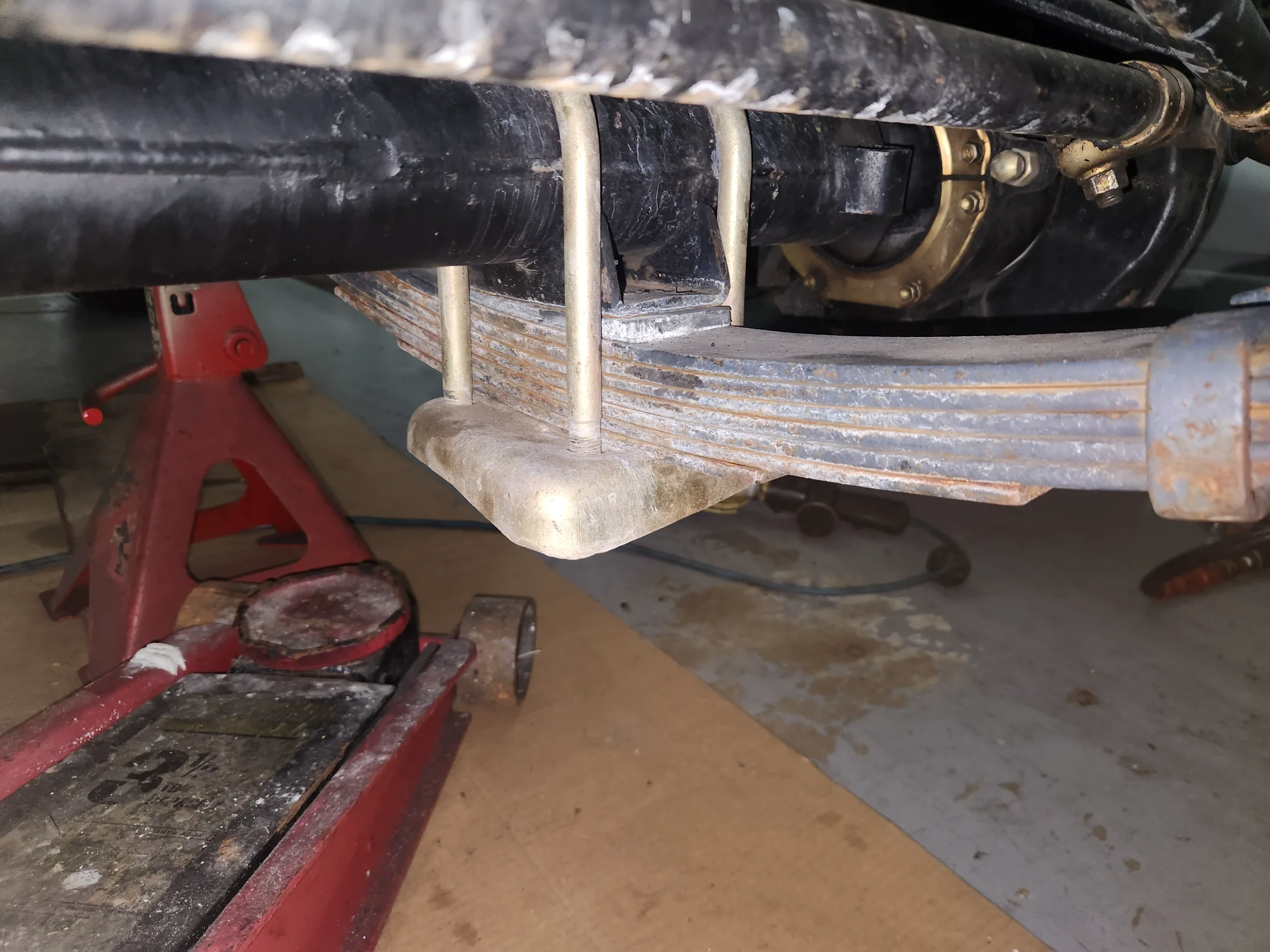

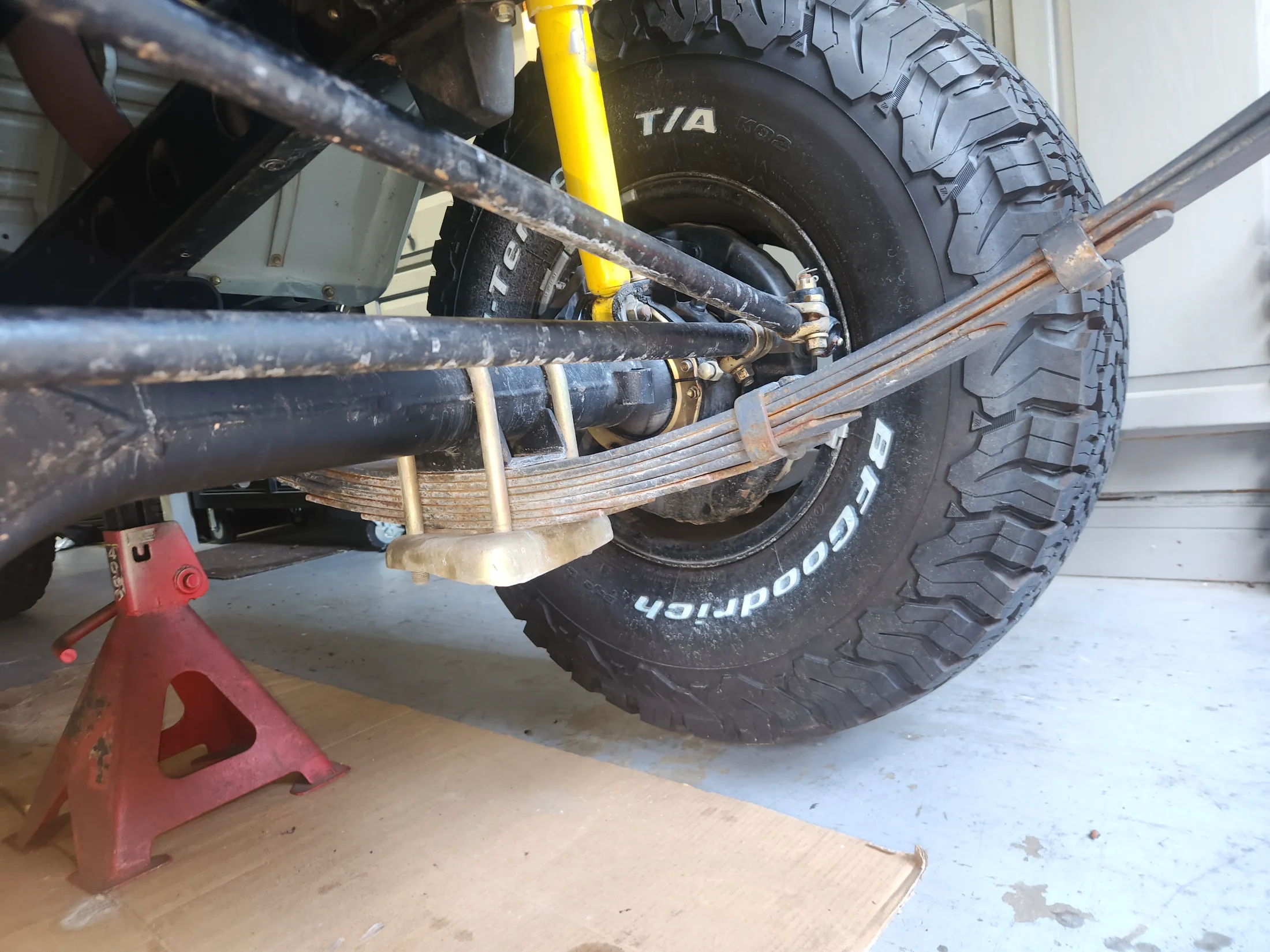

The 2.5° shims are in, so we'll see whether that helps the tracking. I will have to add new springs to my growing list: these are obviously made from an amalgamation of springs from other rigs and they have about 2" of flex using my trolley jack.... that may be my final upgrade before she's done.

I've always put OMEs on my 40s but I hear the Terrain Tamer springs are better. I know that OMEs really went downhill when they stopped manufacturing them in Australia. Interesting note: I bought the OMEs on my LX at ARB in Adelaide. They told me when I bought them that they were the last set of 40 series Aussie-made springs left in Australia. I took them home in the back of my 2003 Diesel Hilux, put them on my 40 in the garage in a day and the 40 rode better than my Hilux from that day on. Any thoughts or preferences?
we started keeping the Terrain Tamer Parabolic kits in stock if that tells you anything. No shipping cost for you :)
They are the most expensive kit on the market short of the Dobinson's with their MRR shocks though.
I have to look in to the size. The rears look like the same as 40 series (definitely not 45/47 size) but I'll need to measure a 40 to be certain. Do the Terrain Tamer springs need shims or are they designed well enough not to need them?

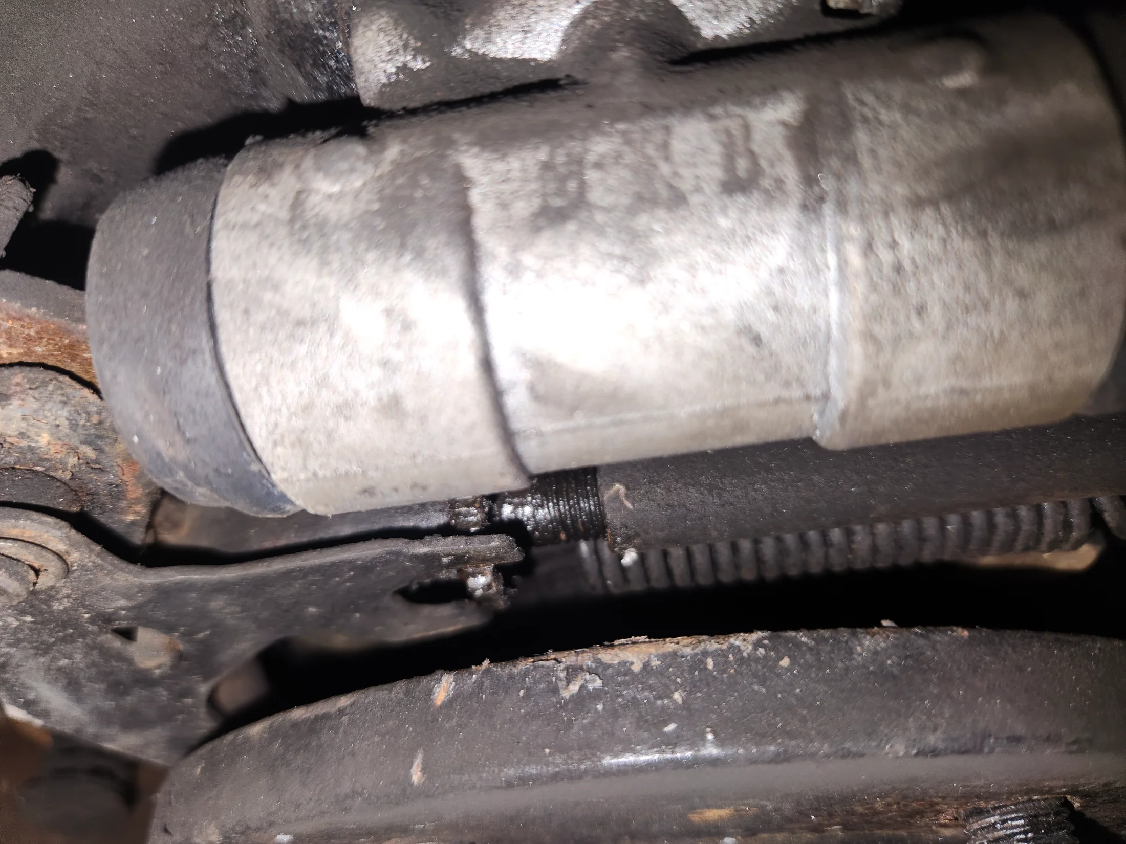

Ok, the rear brake shoes were a good 1/4" from the drum, which I've adjusted out. But it appears that the adjusting rods are installed backwards, because when the handbrake is applied, the adjusting arm seems to loosen the threaded rod rather than tightening it. Can you tell whether these are correct @cruisermatt ? It seems I may need to swap them left to right.
The rear brakes appear to have been 'rebuilt' in same manner as much of the rest of the rig: by painting it.

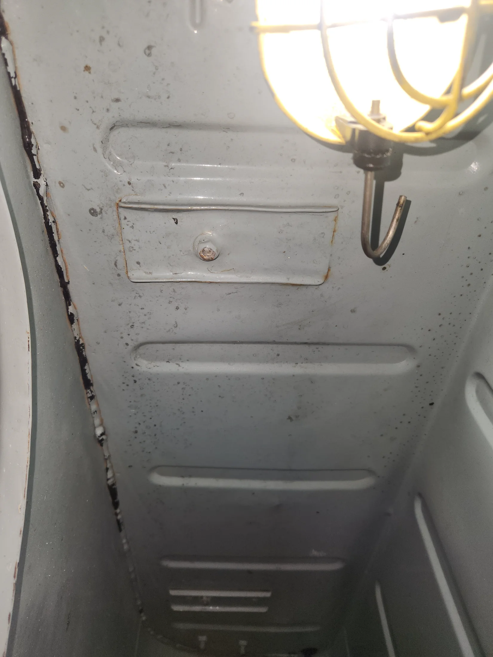

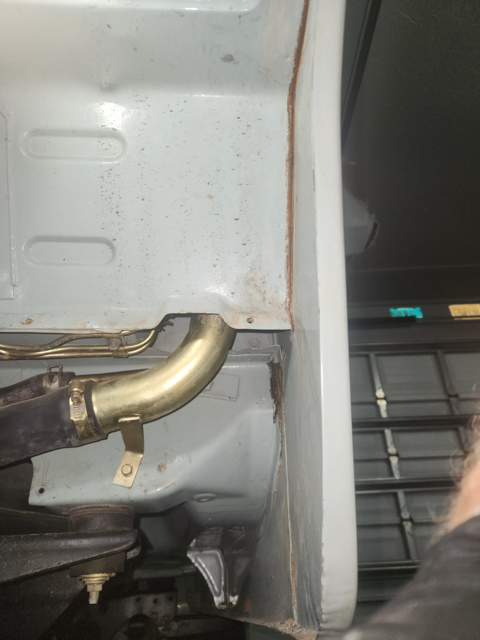

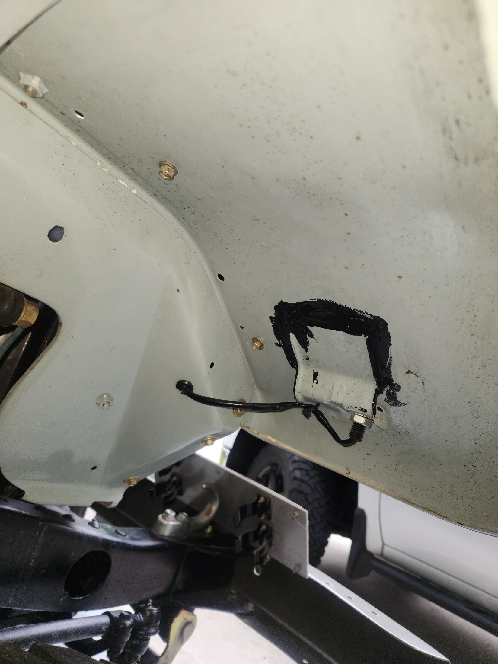

The rear wheel well seam was 'sealed' with black silicon. So I'll be scraping that all out, spraying Extend rust converter in there, sealing it with 3M seam sealer and then raptor lining it.
Sounds like this will be in my future.....
43’s use the same rear springs as 45/47.
We install steel 4-degree shims on all the lifts we do. I even manufacture my own brand of shims now since we needed them so often.

@cruisermatt yes, I guess they do look longer now that I have the rear wheel off.
I may have to wait a few months on the suspension, but we will do all the rest when the Hilux sells. If it sells well.... then maybe I just do it all together. 🤞

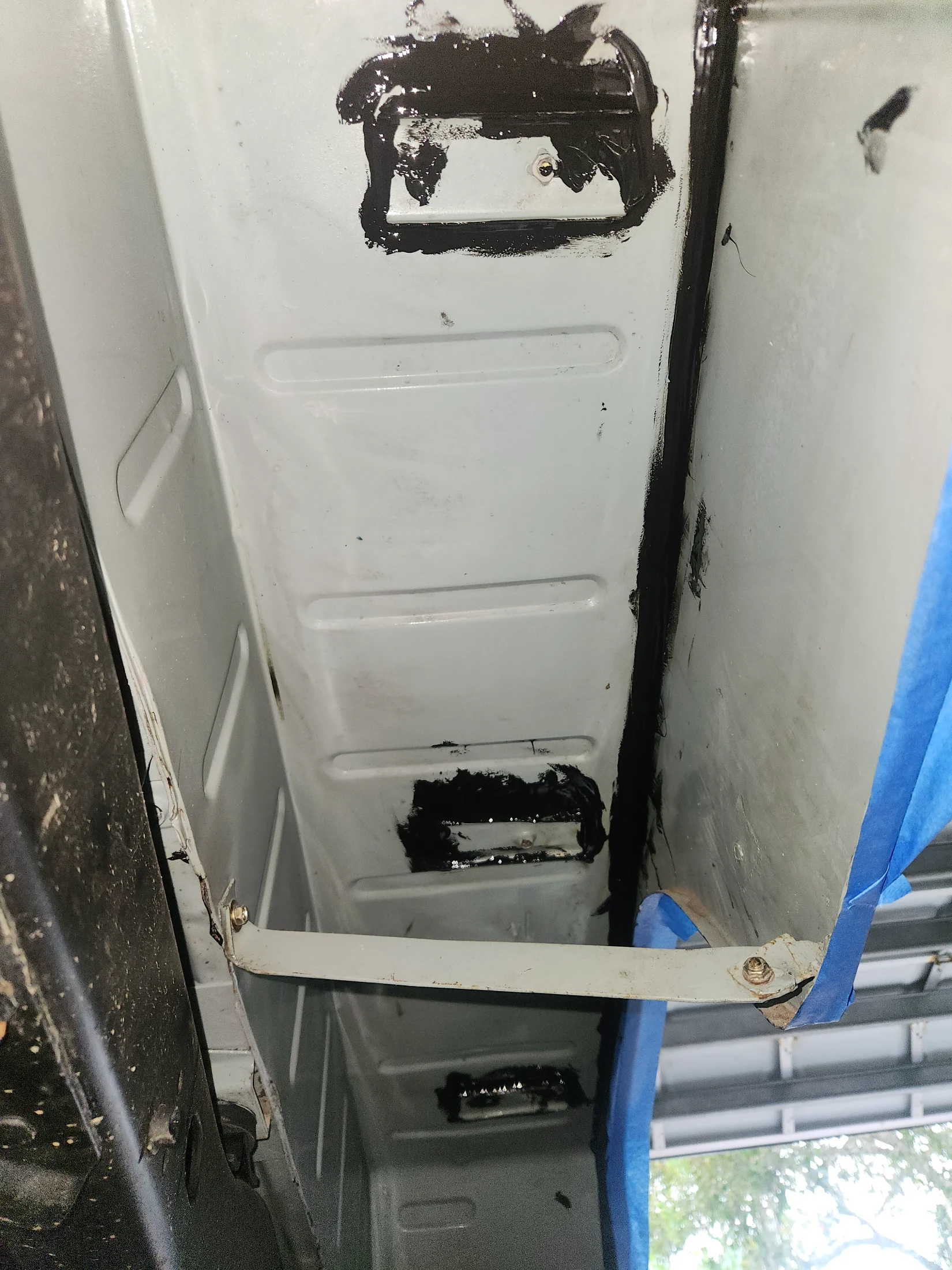

I cleaned up and lubricated the rear brakes and the hand brake now works. I spent about 3 hours scraping the bloody silicon from the underside of the 43: they applied it to bare metal before painting it. Of course, silicon CAUSES rust in metal..... but never mind.
If it costs there was what it costs here then they likely spent more on silicon than on labour: there had to be 5 tubes under there.
After getting it all out, I wire brushed it, scrubbed it with a brillo soaked in isopropyl alcohol and then sprayed Extend into the seams. After that dried, i filled all the seams with 3M urethane seam sealer. When I get back I'll paint the whole underside to seal it a bit better. I'll raptor line it when I do the inside of the tub.

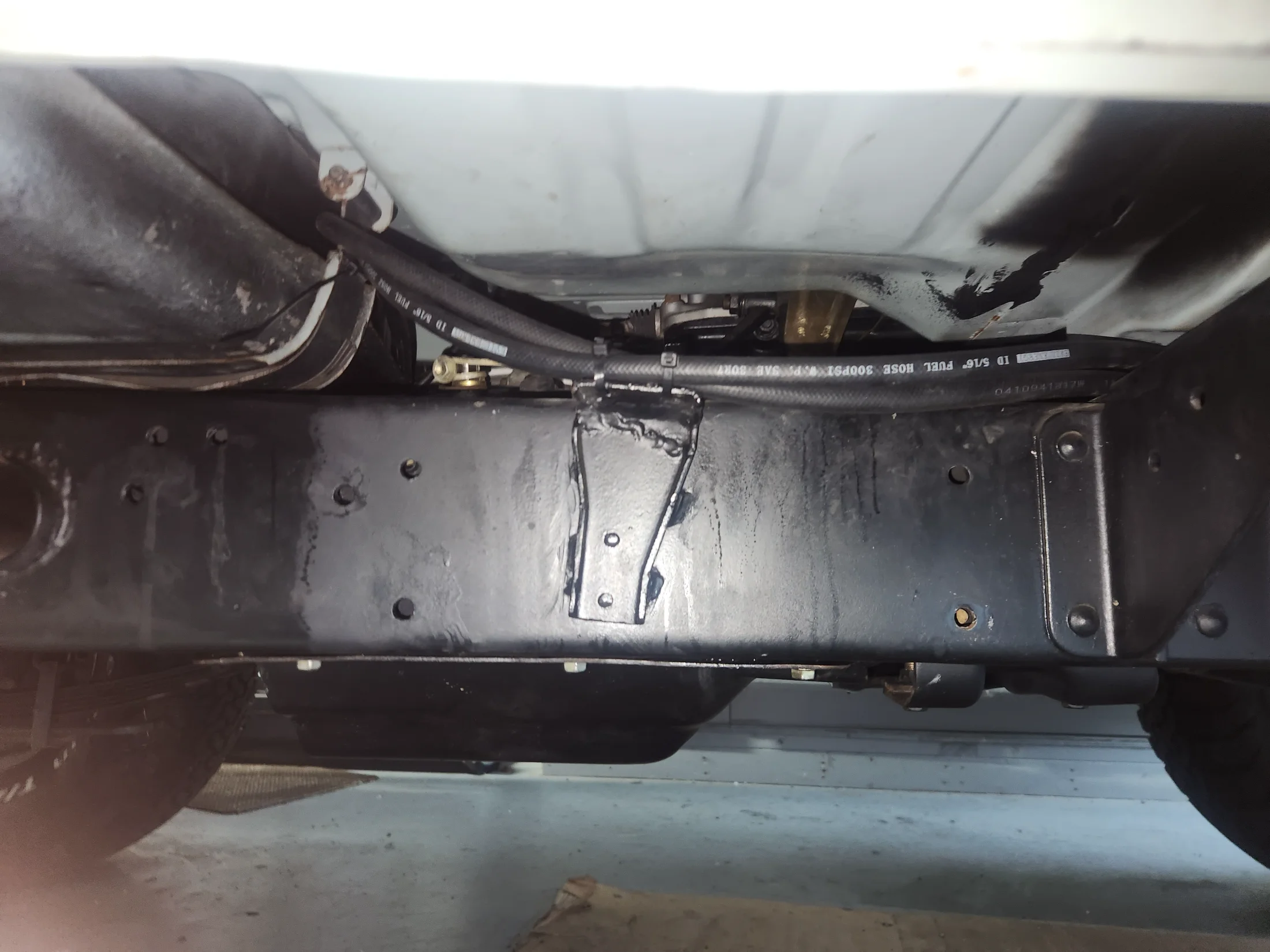

While under there, I removed the cover over the filler and found (I hope) the cause of the fuel smell: the breather hose was only attached to the filler, but was too short to go over the tube on the tank, so they simply butted it up against it.

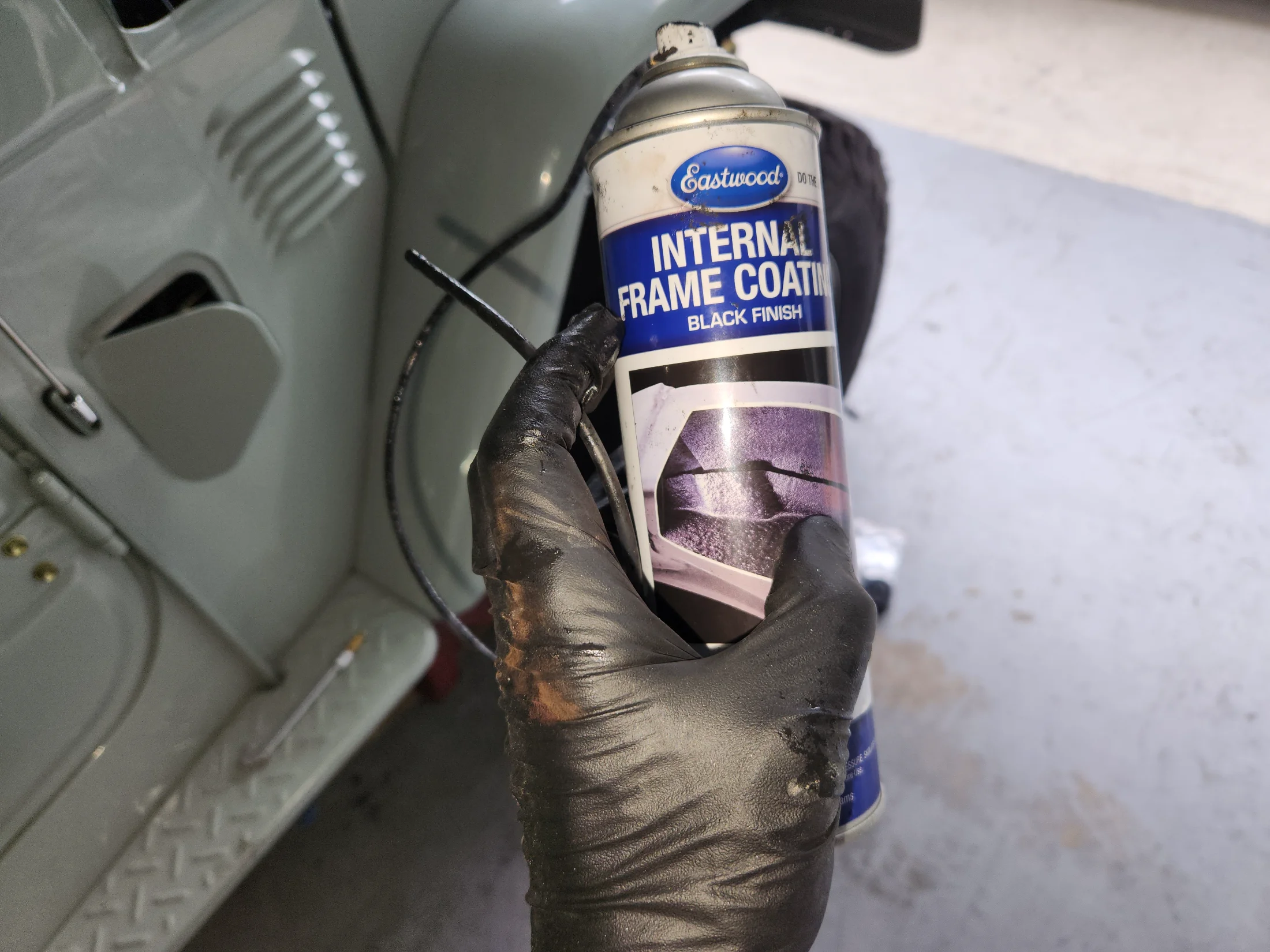

I also painted the inside of the frame rails for good measure.

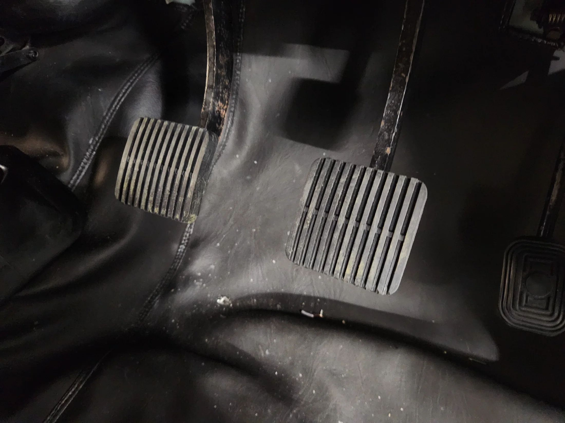

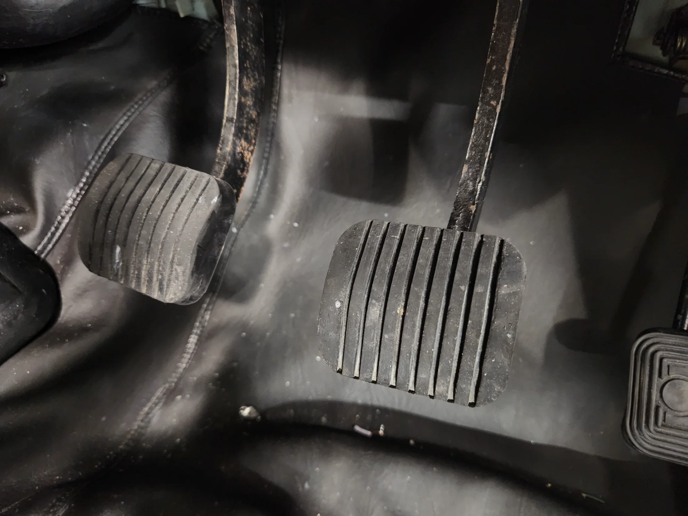

My OCD at work: Project Goldilocks isn't even drivable yet, but I get home from a trip and could not resist removing the awful Chinese pedal pads and putting on the sexy-as-hell factory Toyota pads I got.
When I raptor line the tub I will pull out the pedal tree and rebuild it with new bushings and fresh black epoxy paint.

Now to focus on the 43. Spent the day finishing the paint and seam sealing on the underside and running new fuel lines; the ones on there were mostly original rubber lines (hard as plastic) with bent brake lines to fill the gaps: some with hose clamps, some not. I'll finish the fuel lines tomorrow and maybe start on the radiator hoses.
