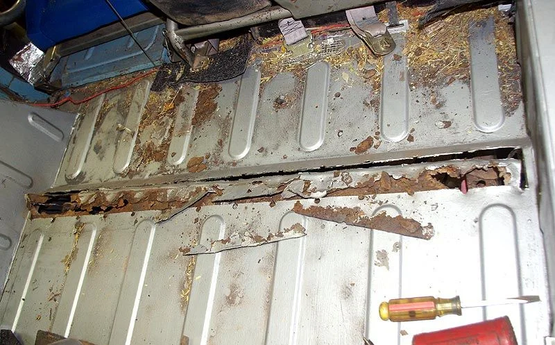

uhhh maybe a shop vac so we can see dirt and dust vs rust! why does most of it look new?

because we wirewheeled it all and applied rust bullet 8 years ago when I got the truck
that middle section already then had some rust bubbles that we decided to ignore back then :hillbilly:
It took me a while :mad:to drill out most of the 28 spot welds on that section. The drill was too big to get into the 4 corners,:bang: and a some of the welds were very hard to locate accurately,:crybaby: so I kinda had to questamate where they were. :doh:Used a fresh 3" cutoff wheel to trim it all out right at the inner edge of the weld holes so we can re-use them for rosette welds to hold the new metal in place. Now that's what you call "recycling"!:cool:This way I only had to cut out the bad steel. Almost all of the rust had stopped short of the welds. :clap: With all of this rust removed and replaced with upgraded steel, Claudia's 40 is DOOMED to a long life of wheeling in the desert southwest.:bounce2::bounce::cheers:
thanks so much for that yeoman's job - those spot welds were from hell, for sure

I should have insisted we just cut that floppy part of the tub off, and tube out the rear. Would have made the H55 dealio much easier, too. :hillbilly:
