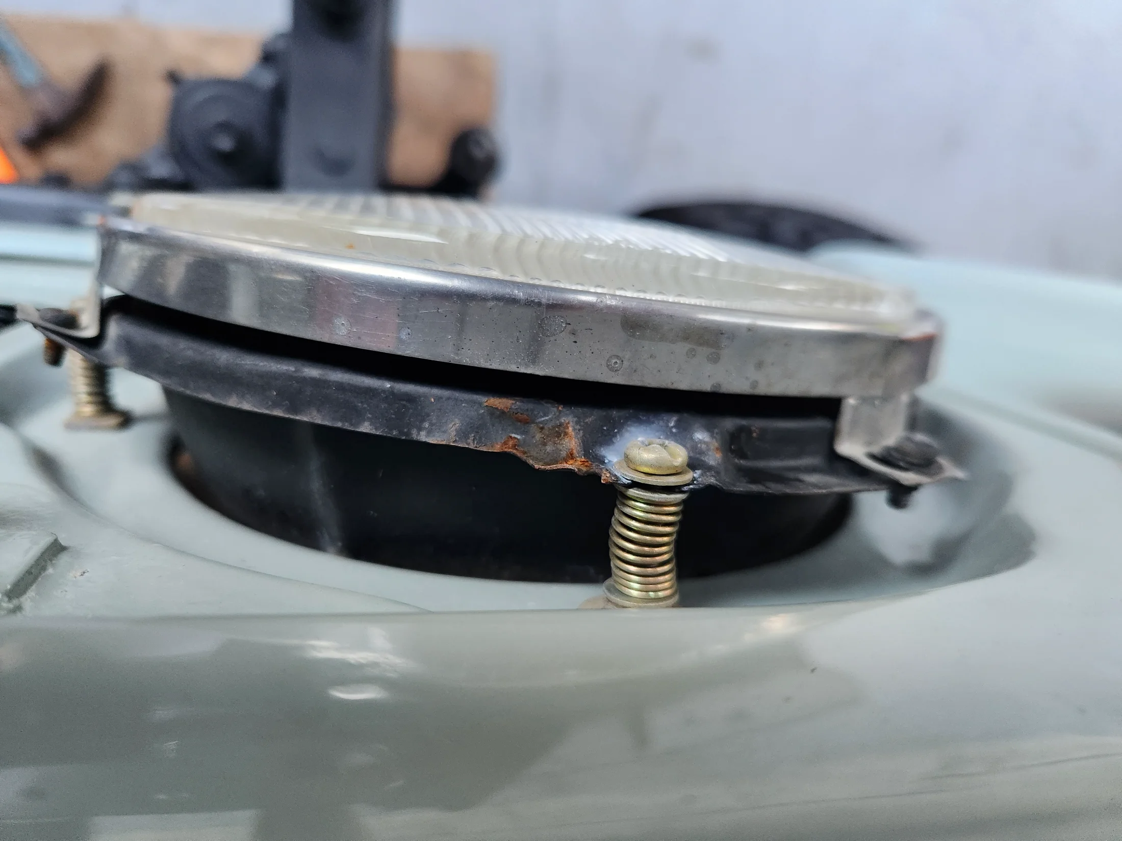

Adaptive headlights?

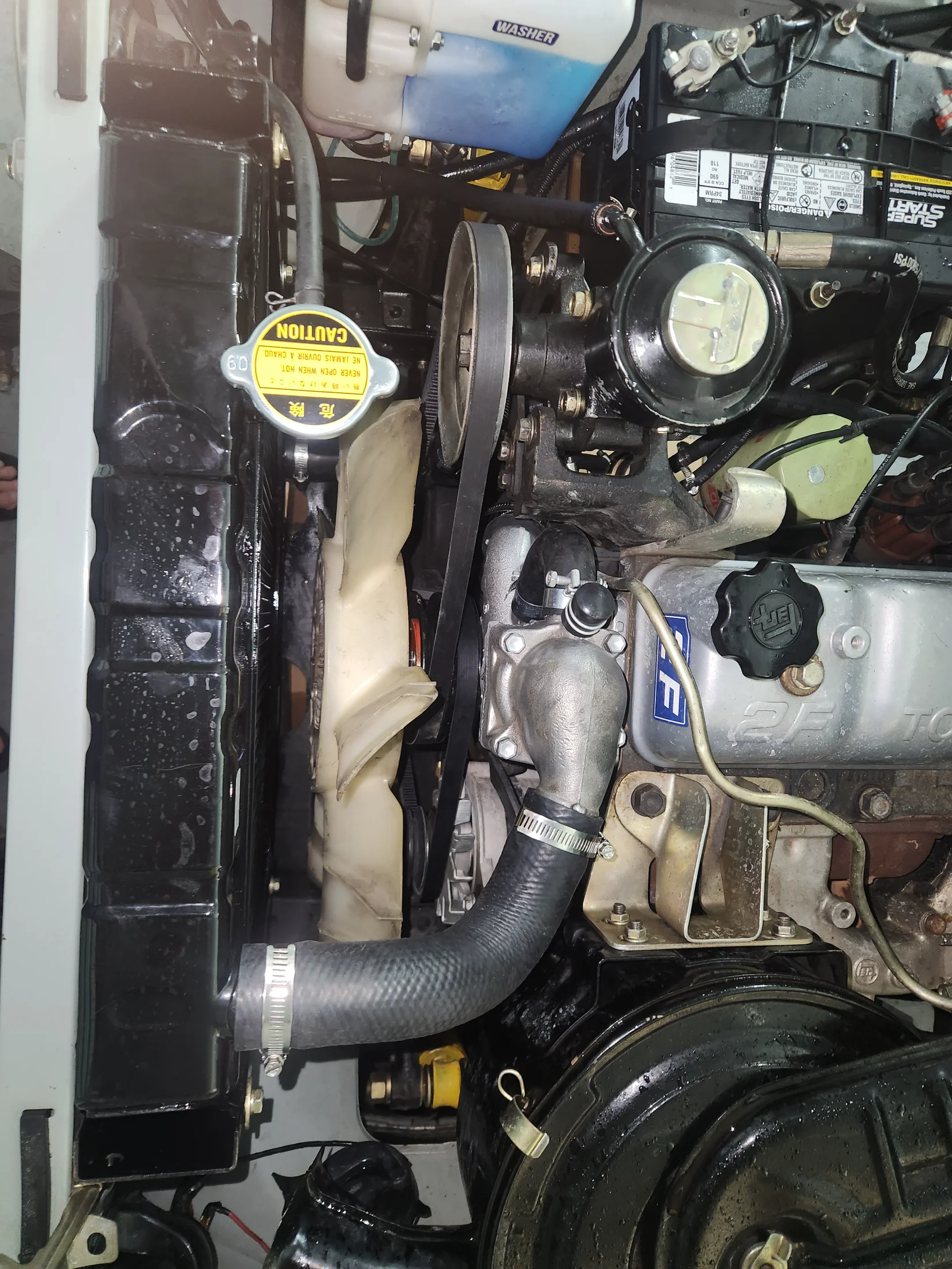

She's all buttoned up in time for my 6 day trip. Coolant is in, no obvious leaks. Clutch fan fits nicely with the new water pump and the pulley from Matt.

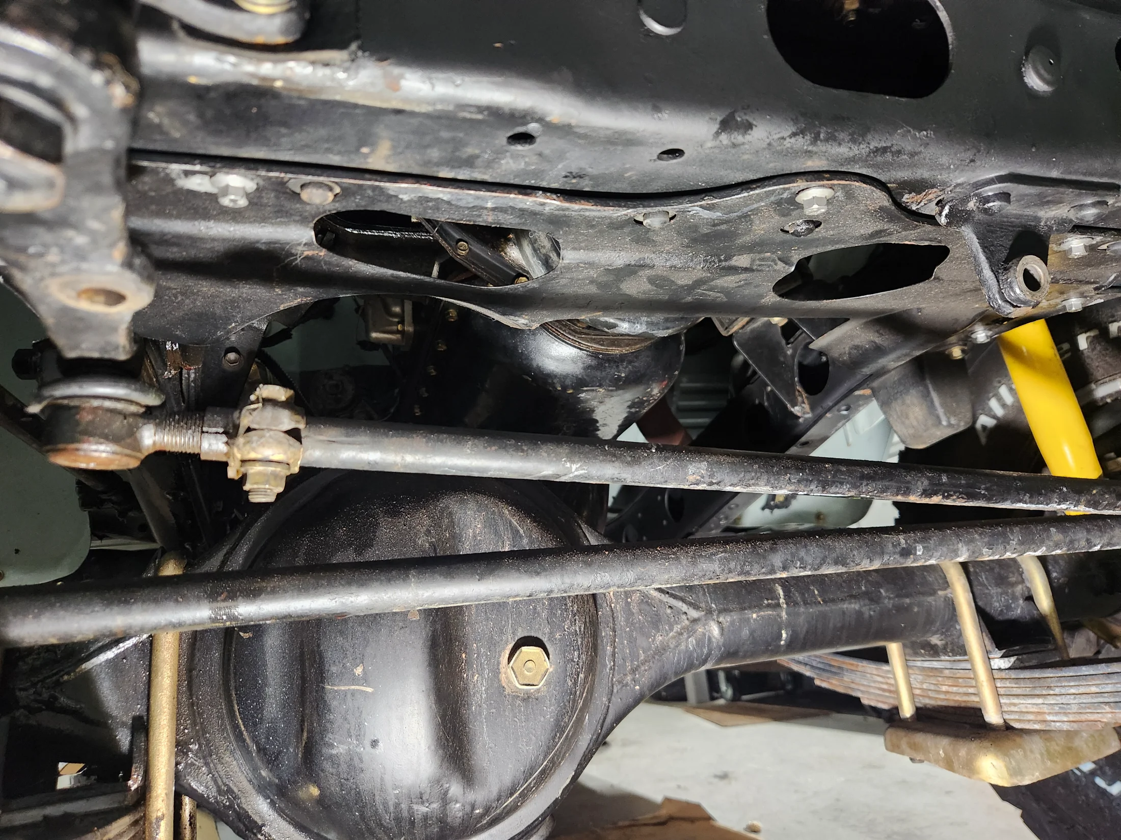

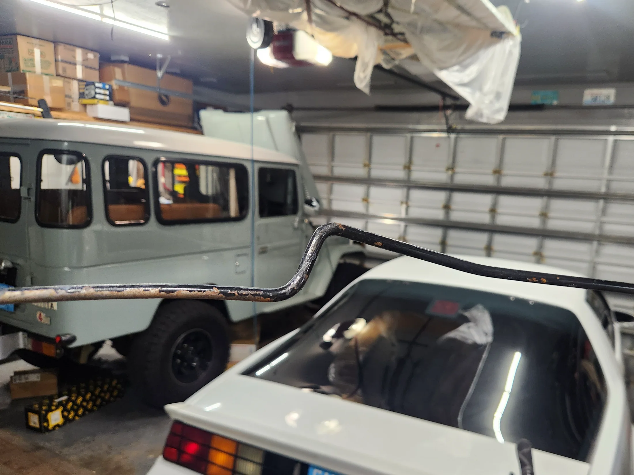

Some interesting Third World alterations: the radiator support rods which tie the oxbox to the frame were altered to accommodate the lowered oxbow. They did it by simply bending a zig-zag in the longer one. I was able to straighten it back to is original shape. Unfortunately they cut the shorter one, so I'll have to weld in an inch of stock to return it to the length it needs to be.
Engine is MUCH quieter now with the clutch fan, but of course I'll need a shroud. Matt may be able to make one out of stainless using his fancy CAD machine. If not, I'll keep looking for a factory one.
