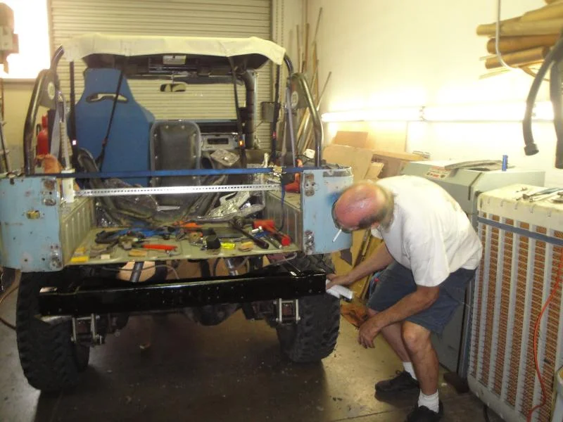

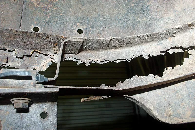

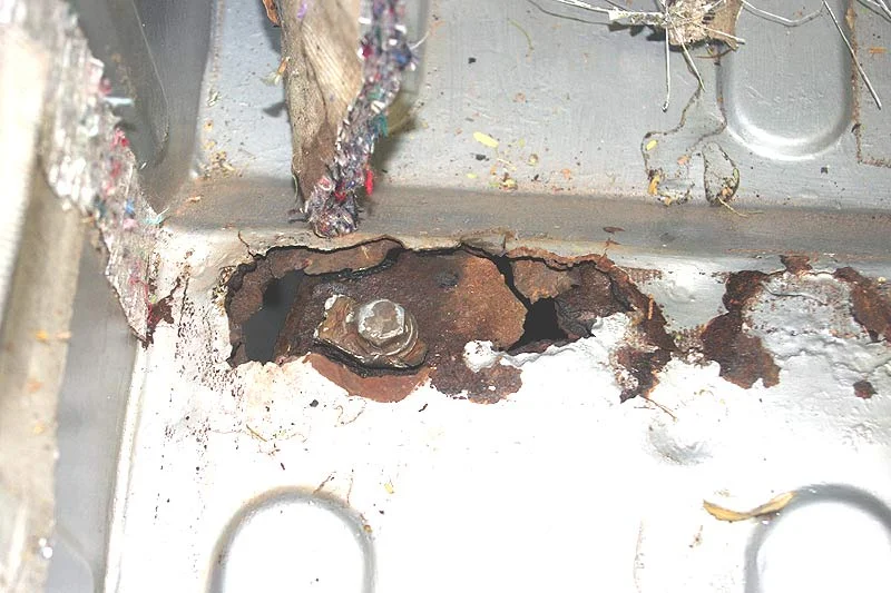

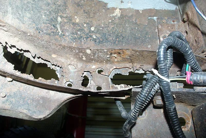

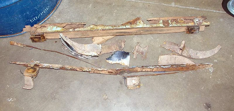

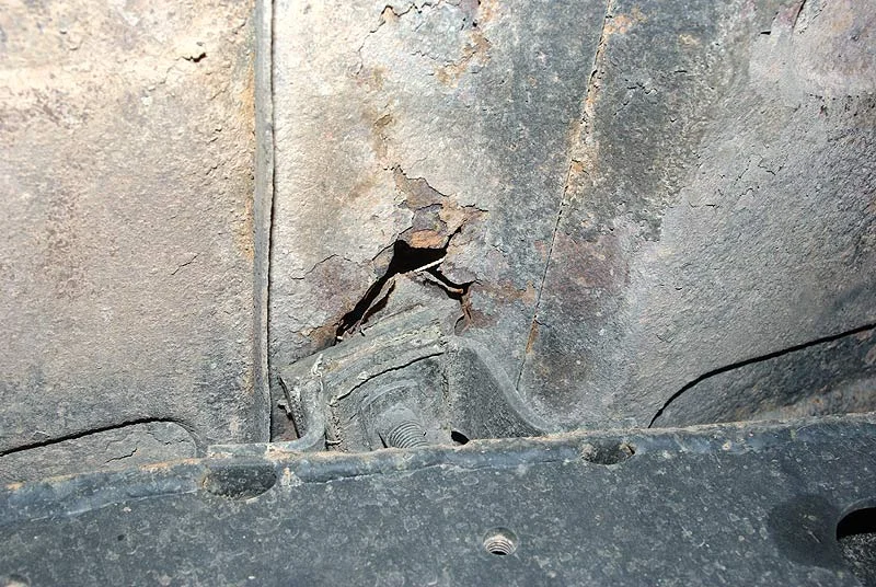

A few more before pix. The trail observation (rear of the tub bouncing around) was confirmed, there was nothing behind the seats holding the tub on. The bed mounts, still haven't removed the bolts.:hillbilly:

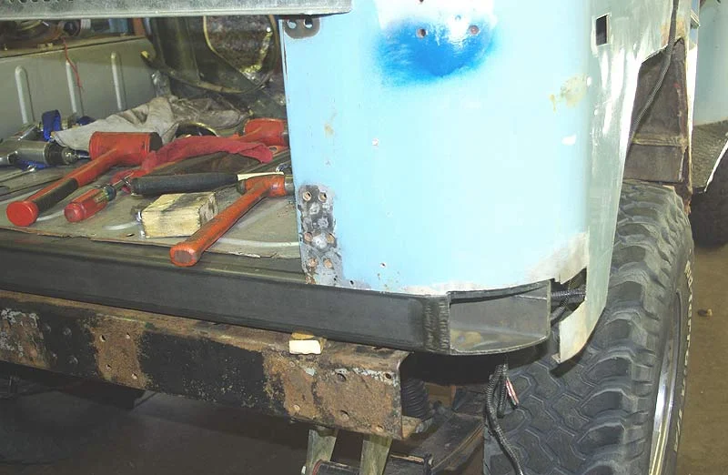

How we left it, Fit is looking good. For the square tube, 1/8" likely would have been good, 3/16" overkill, 1/4" takes a ton of work/grinding to fit. We used 3x3" tube, the stock sill was ~2 1/4" so will net ~3/4" of body lift, the extra room will come in handy for the other planned mods. More metal will be coming off the quarters, just there now to use in fitting.
I really like this solution. I have yet to mount the rear body mounts on mine since I moved the tub over to the new frame. I made my rear bumper so that it is half under the tub and half out. Plagiarism, best form of flattery..going to take some measurements of my own. :grinpimp:

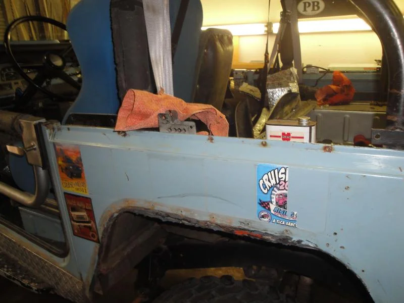

progress was made :)
and yes, I removed all my Cruise Moab stickers :crybaby: I sure hope Rising Sun can re-supply me

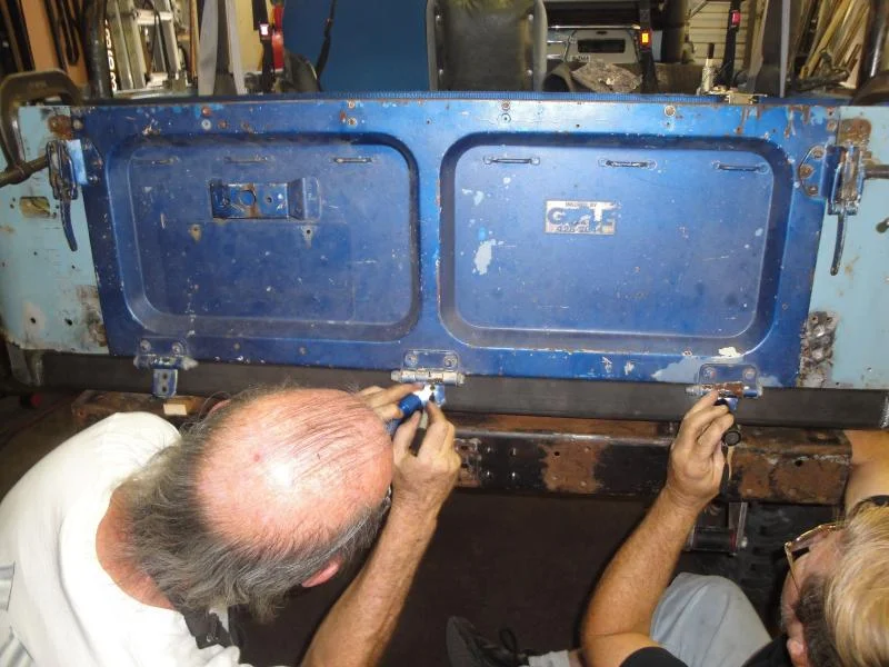

tailgate test fitting and marking for mounting bolt holes

rear frame painted :D
