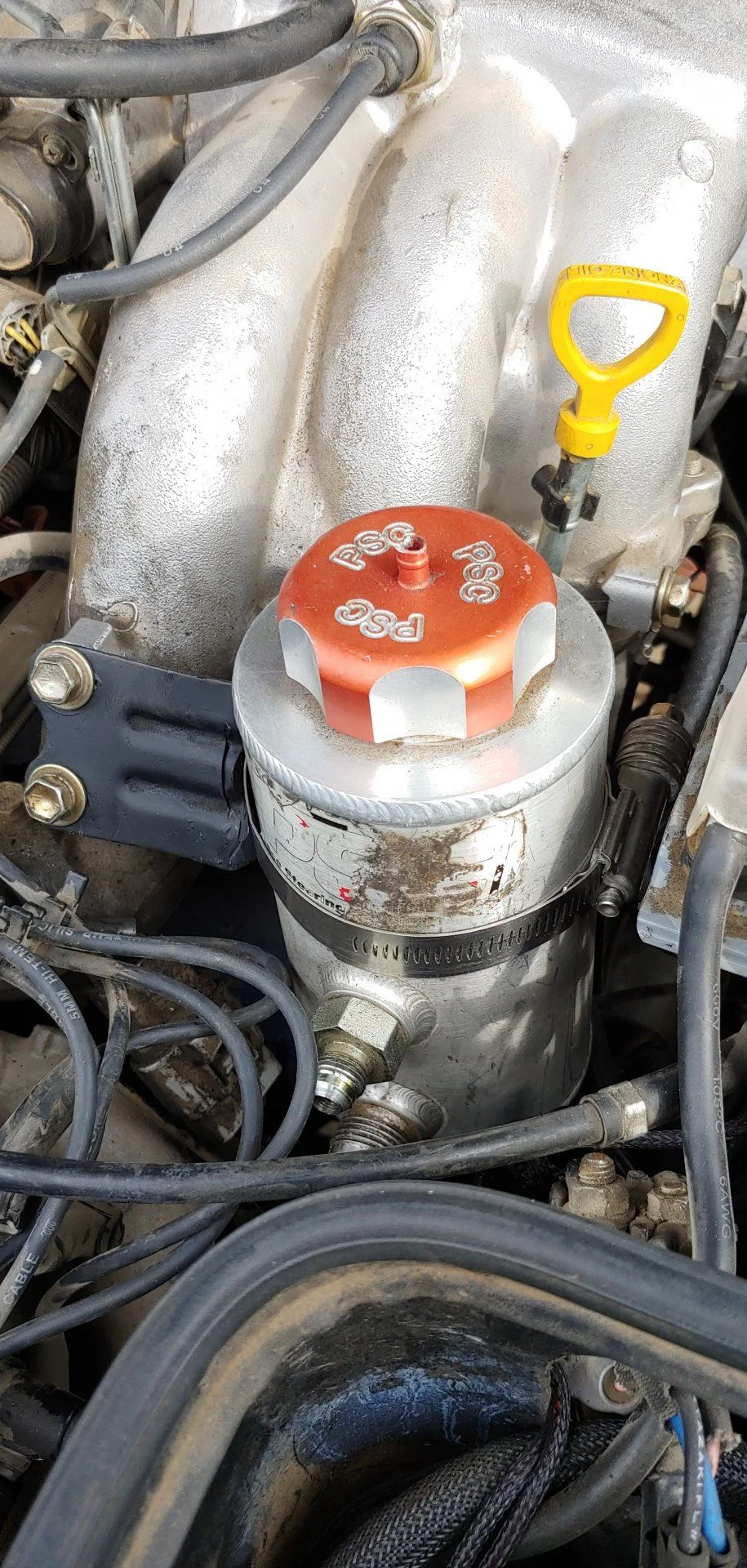

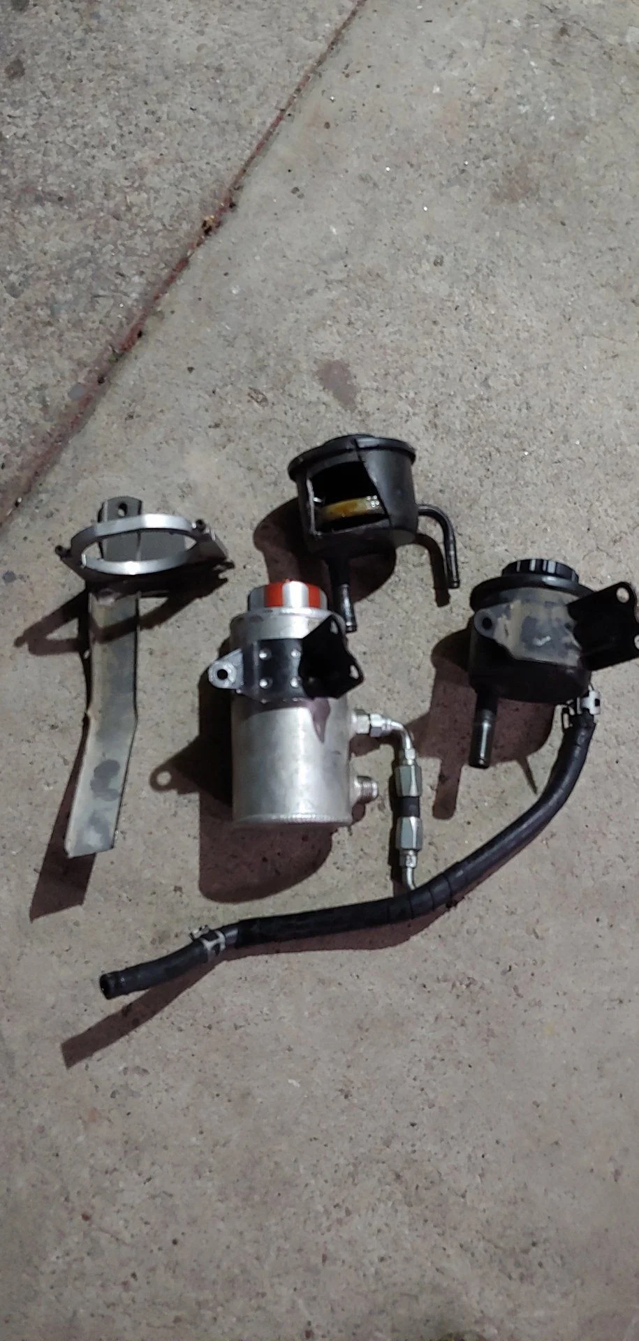

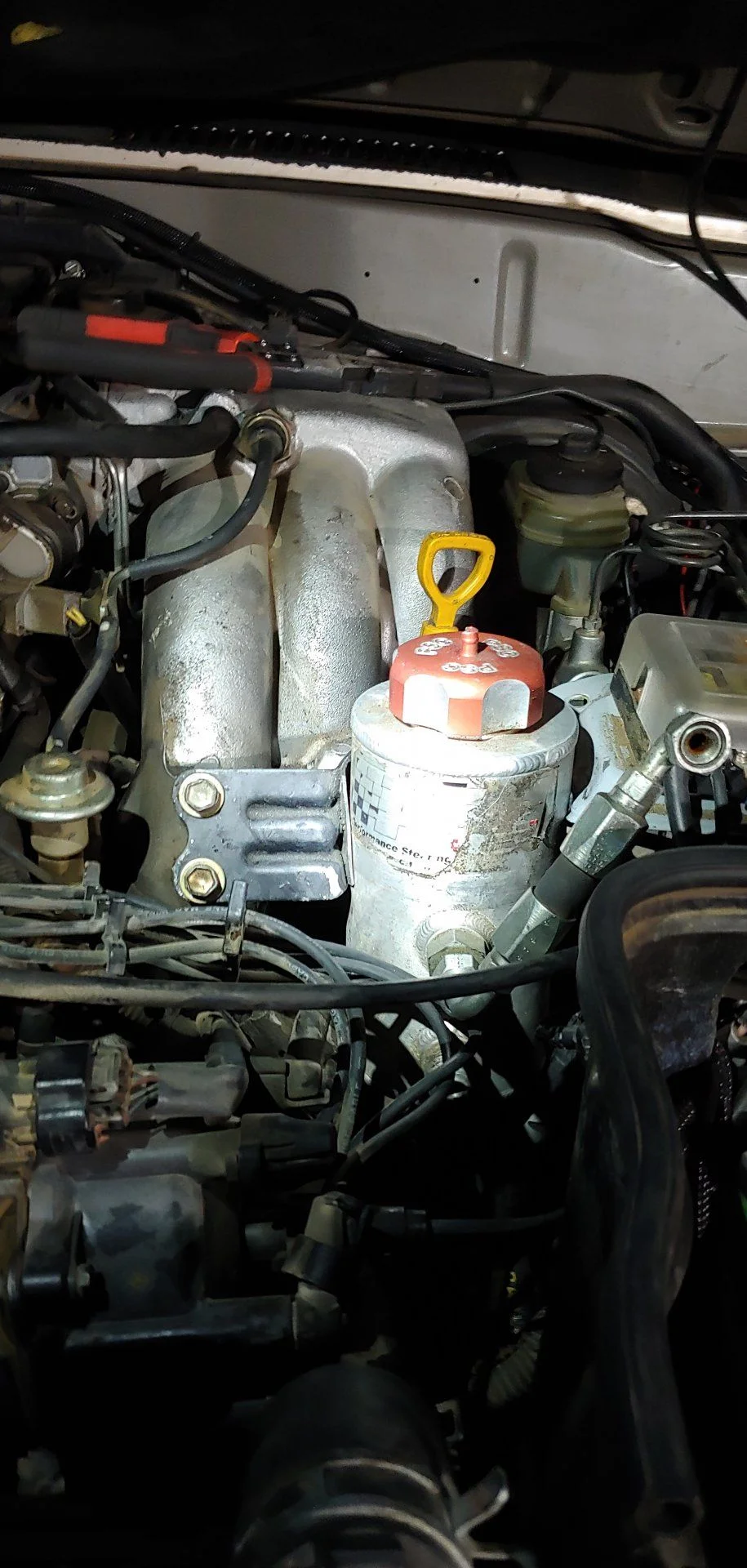

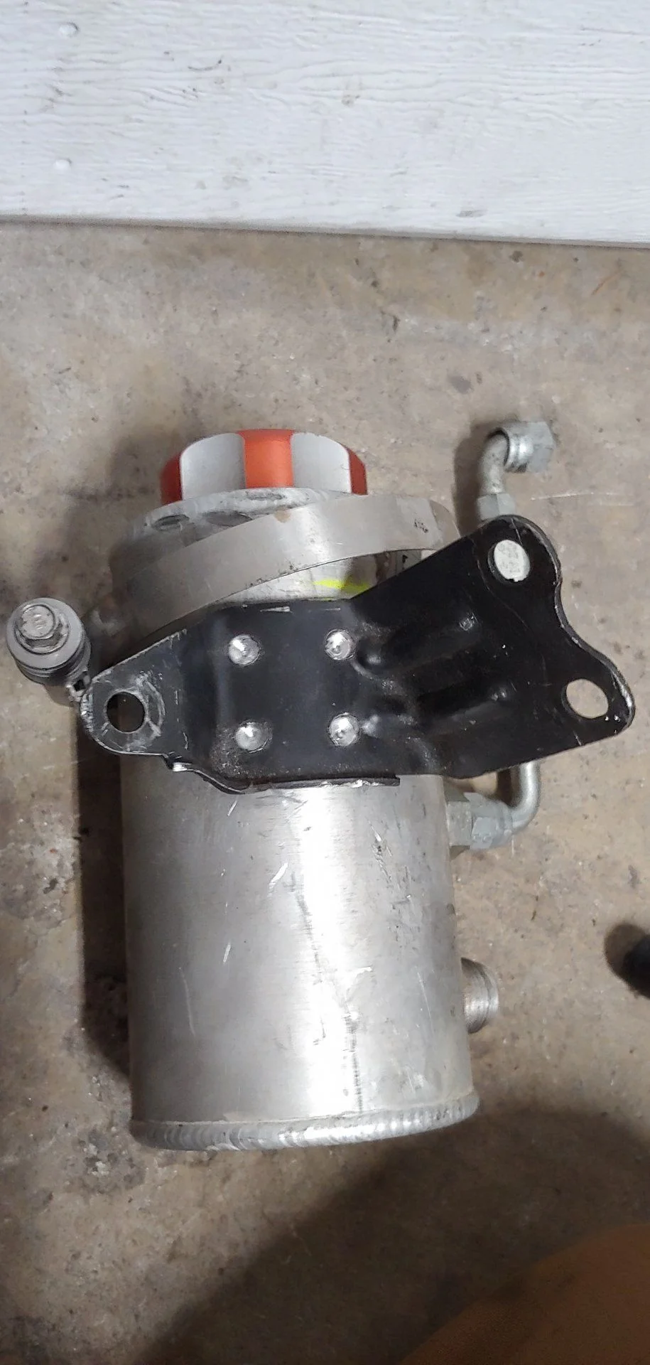

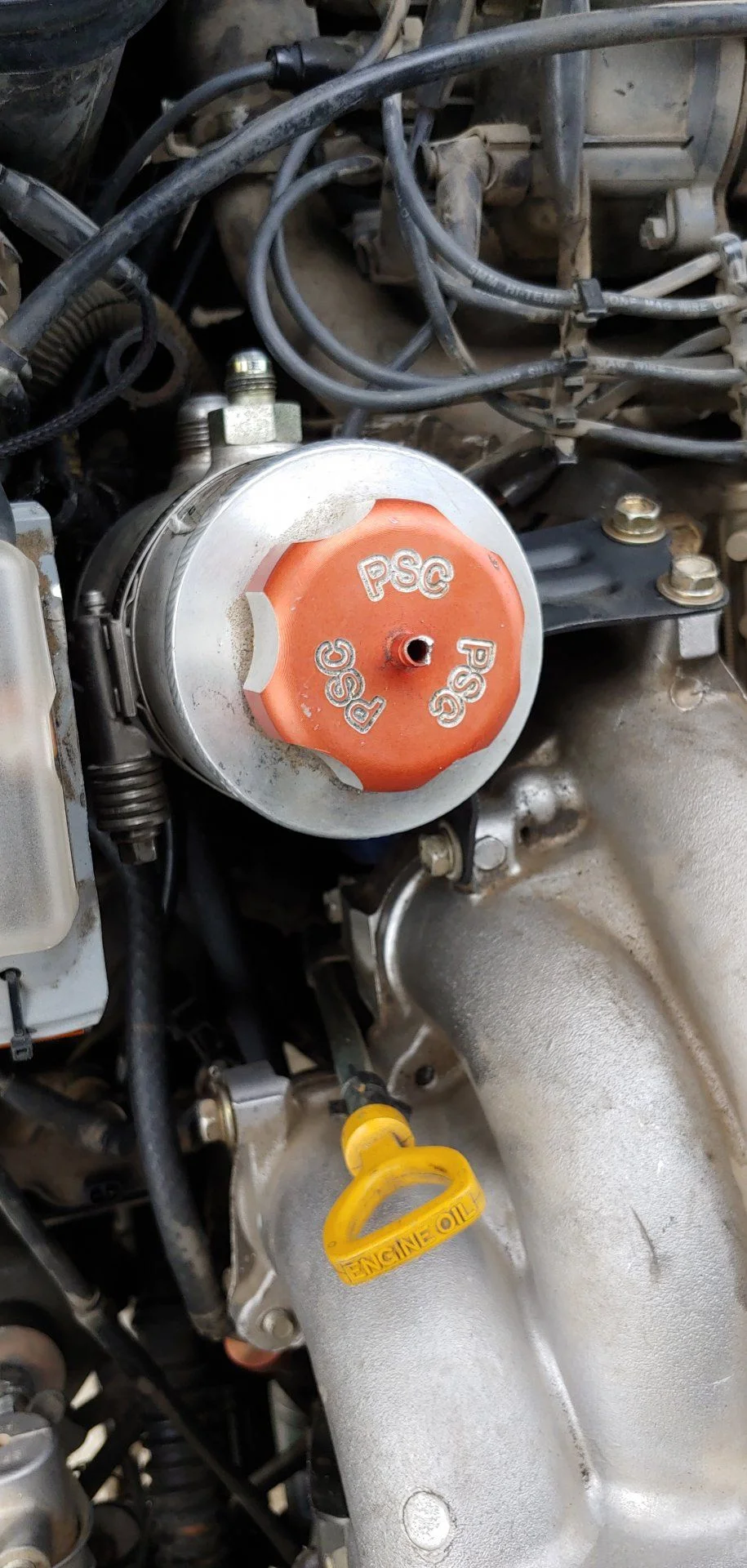

Working on the PSC res. Cut off the OEM bracket to work with the psc bottle.

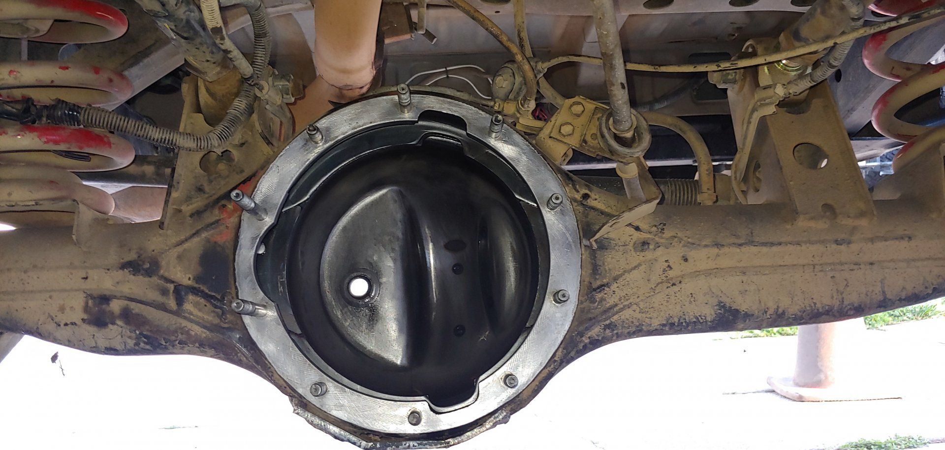

Ballastic Fab lower diff armor.

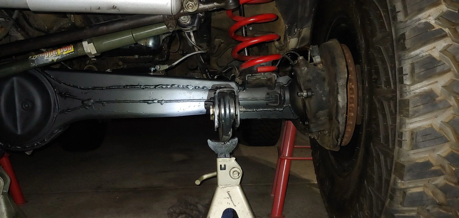

Marlin diff armor not installed yet. Need to cut more off to clear the panhard.
Now the gear oil can be drained and the axles and pumpkin comes out. 5.29 gears are next for install and then a full knuckle rebuild goes back in when ready.

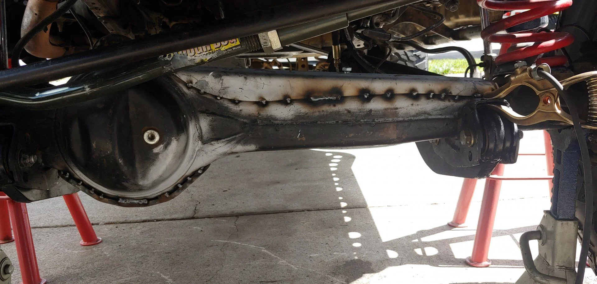

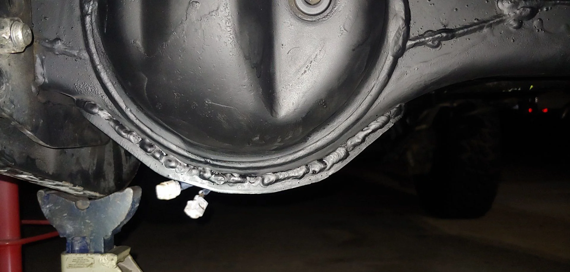

Cut a marlin difd armor and welded it on.

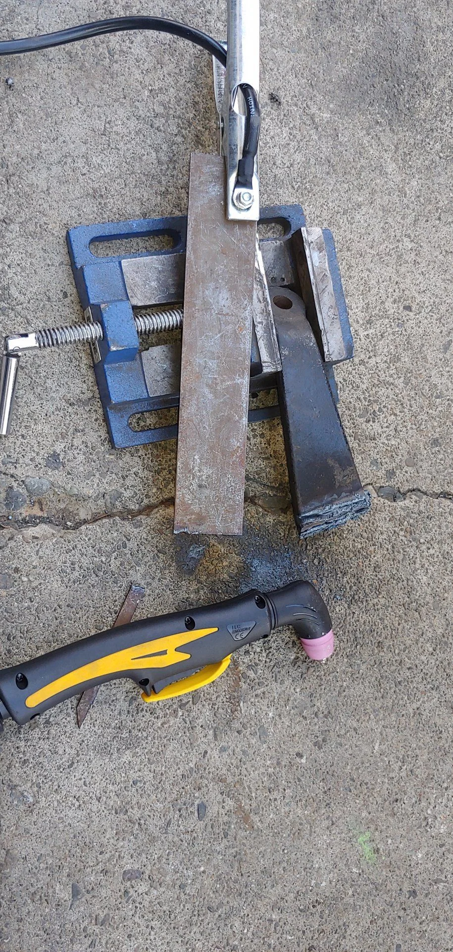

Got a cheap Amazon plasma cutter 240/110 pilot arc and it cuts pretty good. It could only go through 1/3 of that 1inch thick bar. Also got some 4T amazon openbox bottle jacks to replace both cruiser factory worm gear jacks. I weld on 2 squares for more surface area.
Using Rampt Customs, Ballastic Fab and Marlin combo of parts to armor, truss and gusset the 80 housing. This is as much as you can do to beef up an 80 axle housing

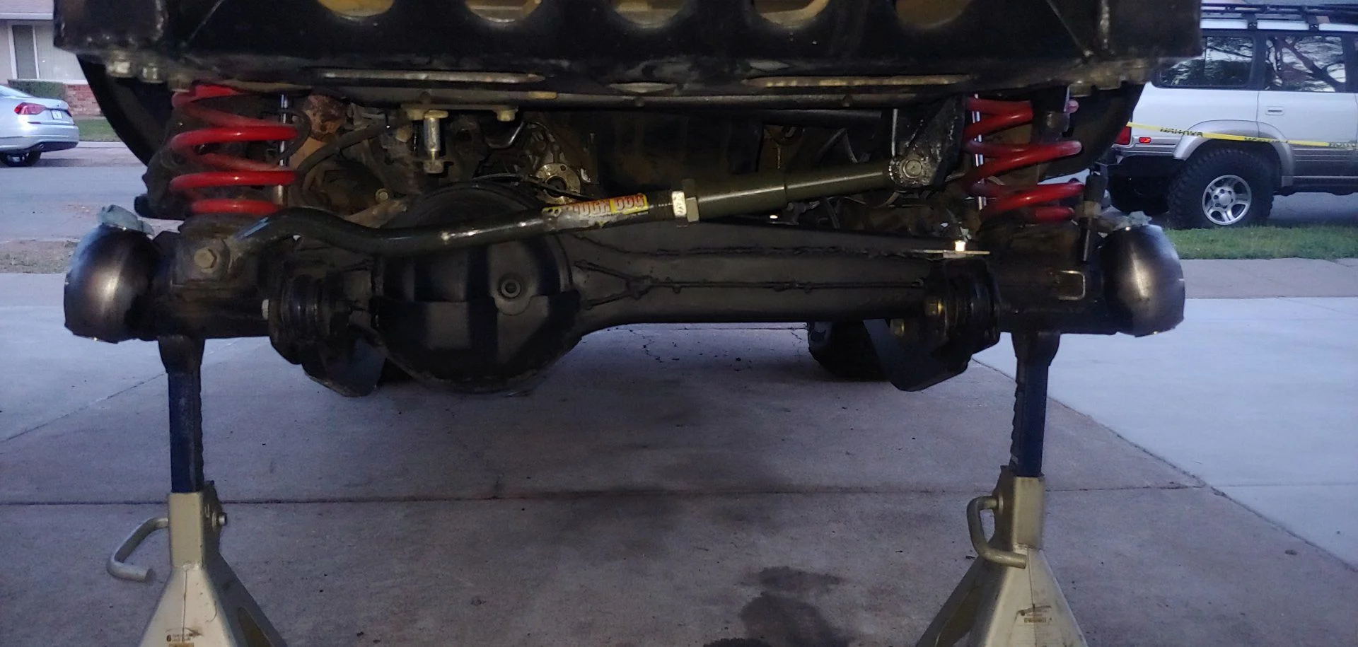

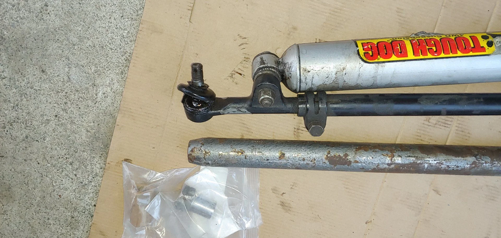

Took off drag link and tie rod.
Found my death wobble problem. Blown TREs in the front drag link.
I replaced the rears with my EMF TREs before Hammers ( EMF saved from my mini truck ).

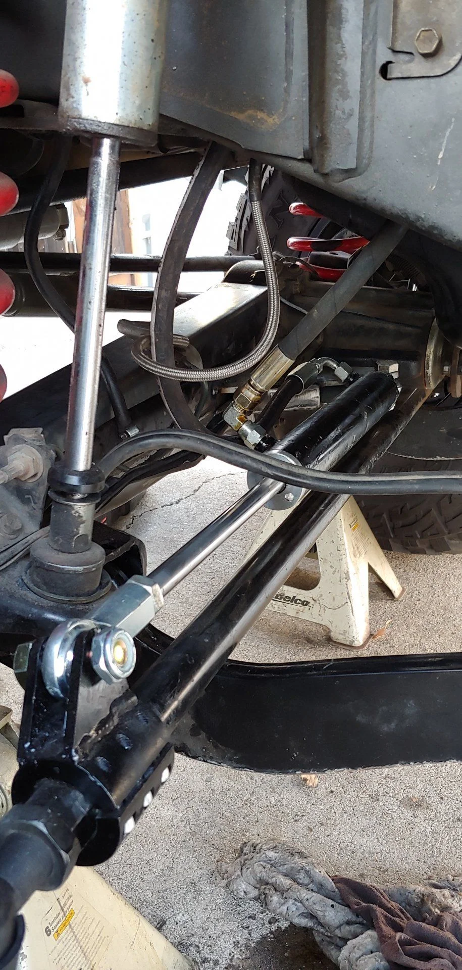

I been waiting to install my EMFs up front but was waiting on hydro install for obvious reasons because you need to replace the entire bar and get rid of the weird 80 TRE that goes to the Pittman arm.
I have a used bar I need to cut to length ans weld on new bungs.

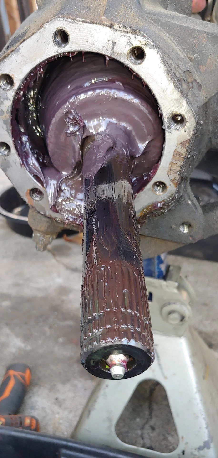

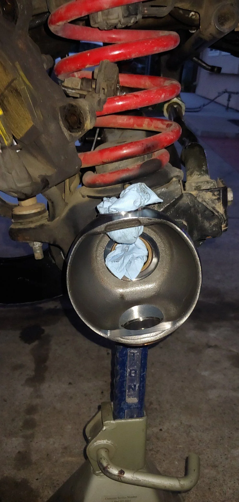

Diff drained, drive shaft removed, diff nuts removed and cracked open. Tomorrow l tear apart the front knuckles and pop out the high pinion 3rd.

Knuckle day and remove the 3rd for 529s install.

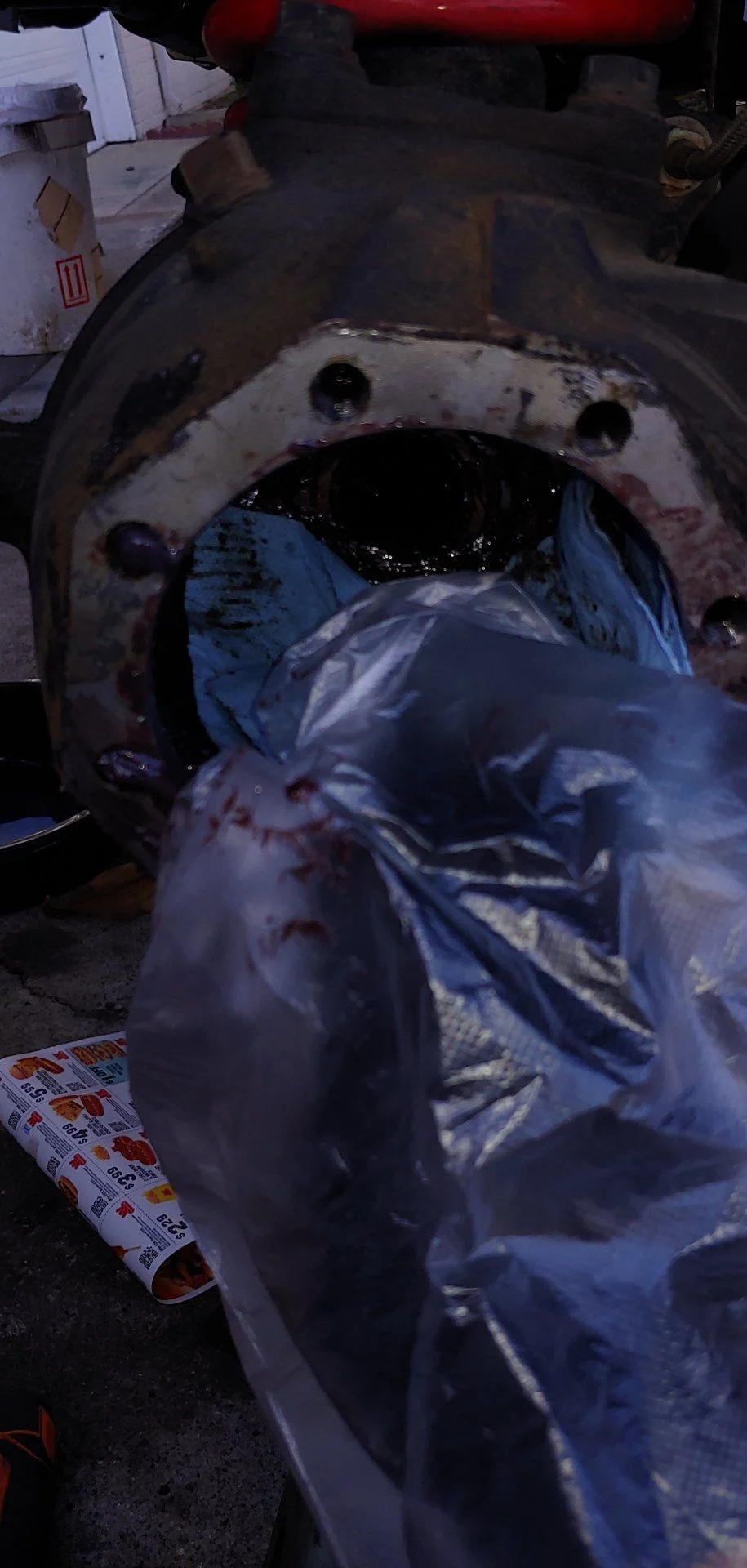

You know whats the best way to remove grease?
1. wear gloves ( obvious )
2. Save produce bags you get from grocery store and bag your hands. You'll need 6 to 10.
3. Scoop with your bagged hands. Flip bag over and rinse and repeat.
4. Use news paper and get the residual grease out.
5. Finish up with brake clean ans shop towels
6. Throw all those bags into one bag and dispose of properly.

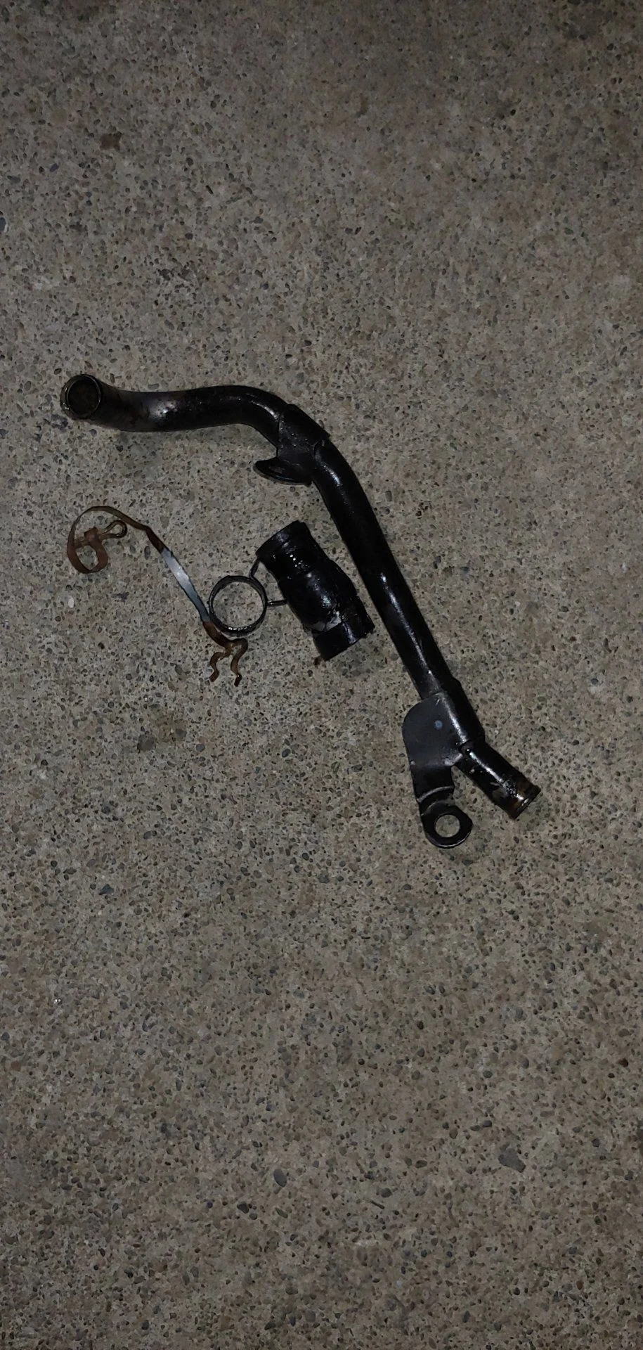

Go buy 2ft of Gates green or white stripe hose and run one continuous hose from head to heater valve. I routed mine just inboard of the brake booster. Less clamps means less possible leaks and an easier procedure.
Drained rear gear oil. Removed FF axles. Popped out 3rd and cleaned the housing.
Struggled with removing PHH for 2.5 hours. I'm missing my XL Gearwrench 120xp 12mm :(.
Would have made reaching the bolt way easier. Ive decided to just bypass it. This is my 4th PHH and no it doesn't get easier with experience. Ugh.

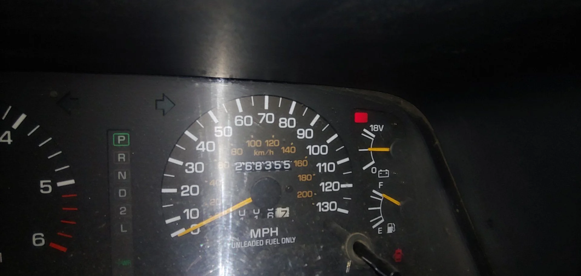

Whats I'm impressive is 268k on an original Mr T PHH! Still looks decent too wasnt really dripping either.
Need to run to the store tomorrow and find some gates green stripe.

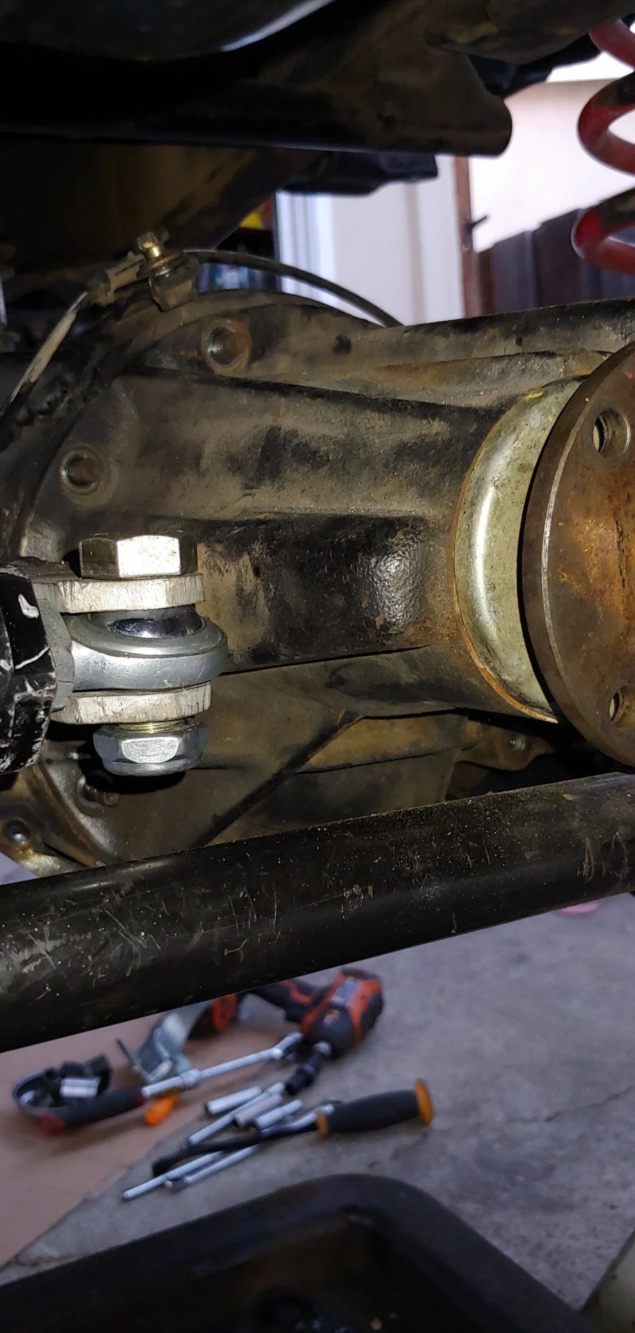

It’s a good idea to tack weld the jam nuts on those upper links if you haven’t already done so. Mine kept coming loose until I tacked them. Lowers haven’t been a problem.
I'll take a look while im under there doing the eimkeith llm.
